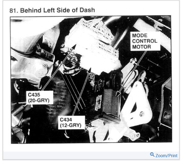

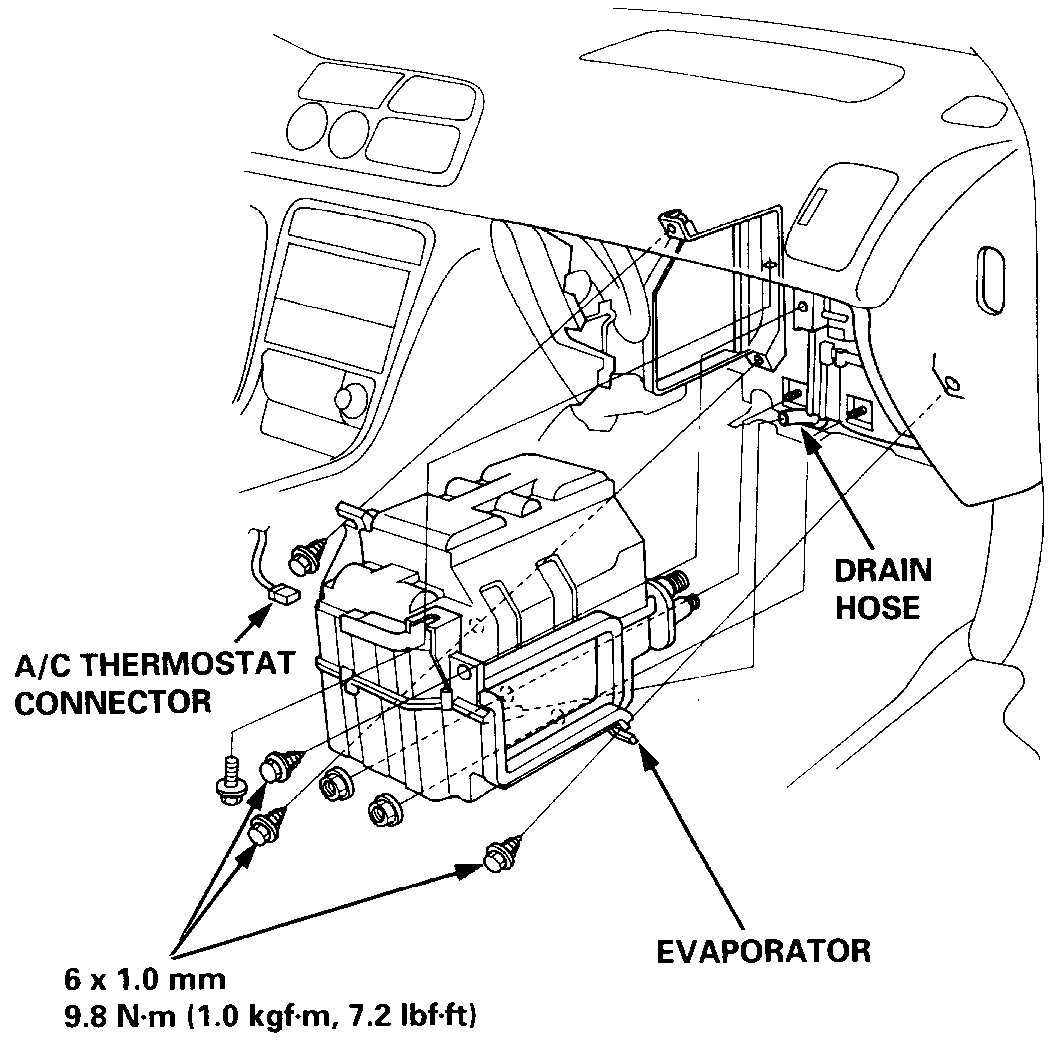

It sounds like you have a mode door actuator that is not working. Here is a guide to help you see what you are in for when doing the job and diagrams below to help you find the location for your car:
Jul 23, 2018 at 3:57 AM

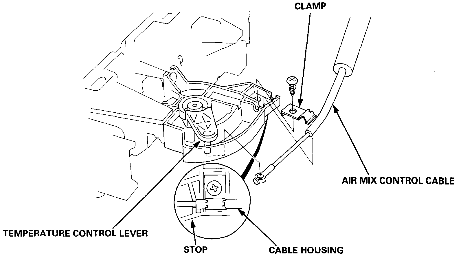

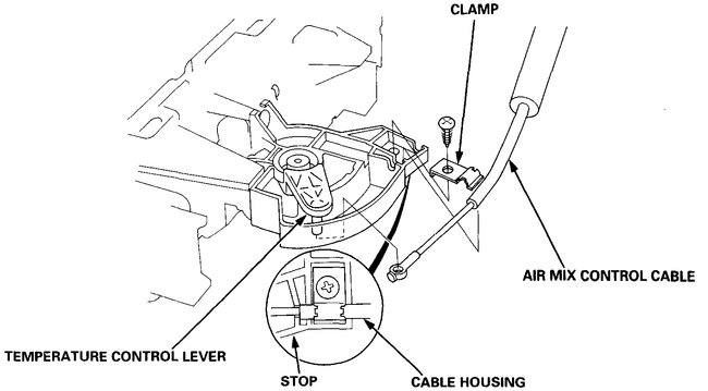

My car does not have an blend door actuator. It has a rod that slides from one side to the other. When it is all the way to the left it is in the AC mode when it is slide all the way to the right it is in the heat mode. It has some kind of band that moves it from one side to the other. I am guessing that the band, cable are what ever it is has broken or came loose. It use to slide from one side to the other without a problem, But now it is on the left side and will not move to the right side. I am thinking that it is not always to the left in AC mode and is allowing heat in , and I believe this is why the AC is not working right. What I need to know is how to remove instrument cover over it , so I can put the band back on or replace it Please send me something to help me see how to do this. Thanks.
Jul 24, 2018 at 5:30 AM
STEVE W.
  • 15,418 POSTS

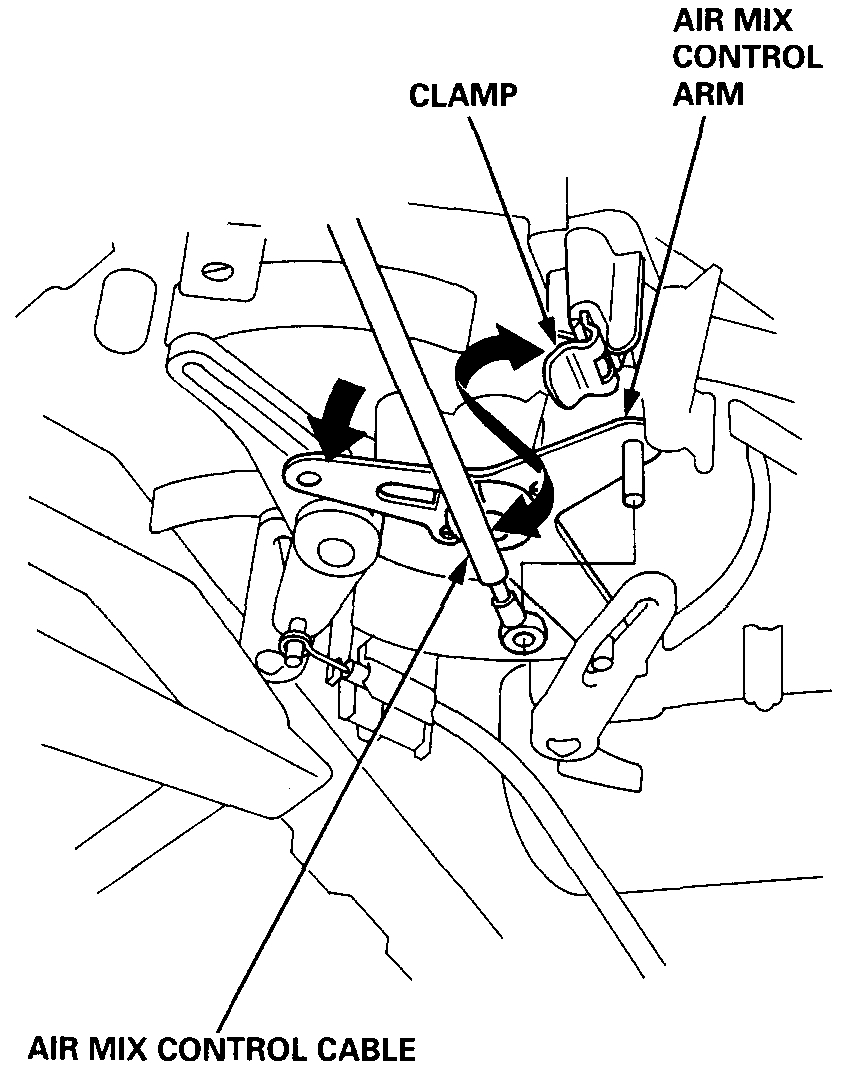

You have a common issue with that vintage. There are two clamps that hold the cable outer housing in place so the inner core can move the mix/blend door. Those clips loosen and fall off or they break the tabs that they snap over and the cable gets loose. You move the lever and the inner core moves the outer housing instead of the blend door.
You can see the clamps in the images attached. The common culprit is the one on the blend door end, but I have seen both ends come loose at one time or another.
There are a couple versions used, one had the lever the other used a dial that moved the lever behind it, the cable set up is the same for both.
You should be able to see the heater end of the cable looking up under the dash. (first picture) That is the end the clamps like to fail on. If the clamp is missing you can get them from a dealer, but check that the tab it goes on is there first. If it is broke you can do the common crossed zip tie repair to hold the cable in place. I do both myself, and have been known to apply some double sided tape as well.

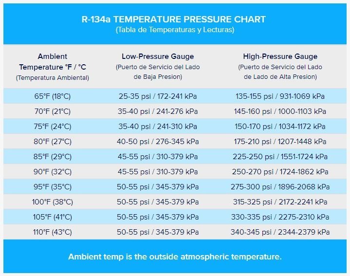

It had bad cable, it seems to be closing fully. As for as the pressures go I do not have pro meters, I used meter that came from Walmart that says not to fill past the green zone do not go into red zone. So I filled it as close to red zone as possible without going into it. This made my car run rough so I used a screwdriver to push the valve in and release pressure until the car was running normal again and the line was still cold to the touch.

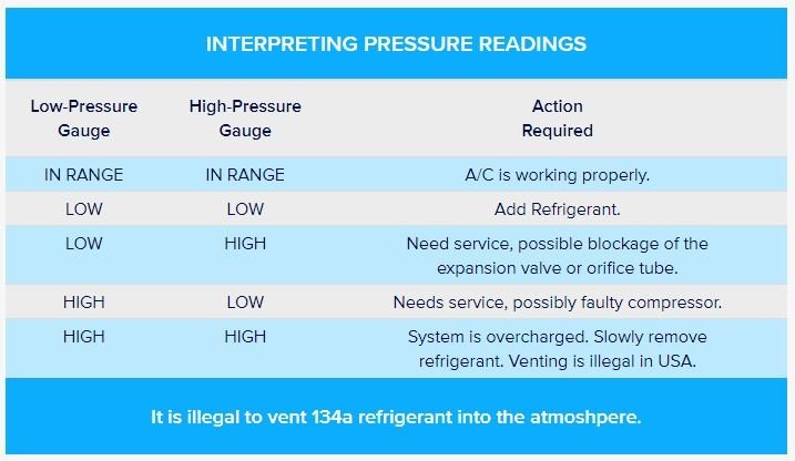

See if you can borrow a set of gauges, some of the parts stores have them as loaner tools. That way you can actually see what the low and high sides are. Did you vacuum the system down after you replaced the parts? If not the air and moisture in the system will cause problems as it will compress. They sometimes have vacuum pumps as loaner tools as well.
Did you also add oil to the system? The "it made the car run rough" may mean that the compressor is damaged if it got slugged with R134A or oil. The pressures would at least show if the charge is correct and if the compressor is working.

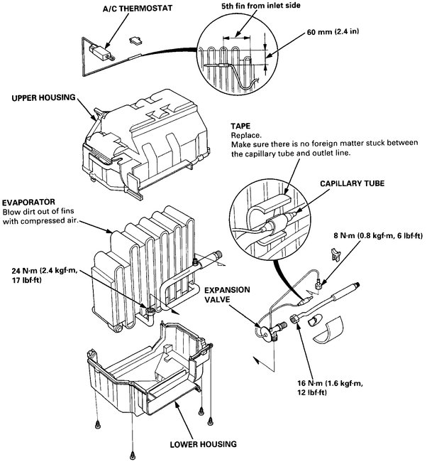

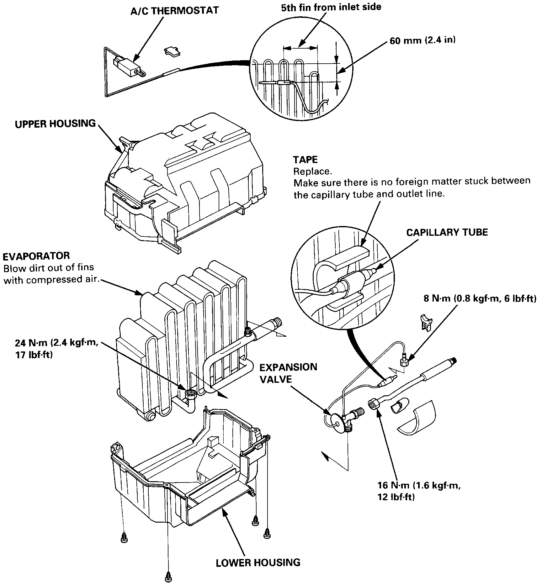

Why were those parts changed out? If it was due to a compressor internal failure and the system was not flushed and tested it may have material from the failure blocking parts of the evaporator core or the expansion valve. The good thing about this car is those parts are easy to remove. See the two later images.

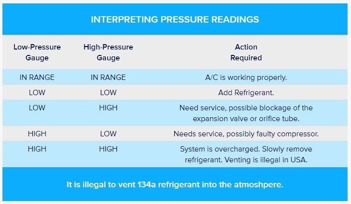

My suggestion would be to use a gauge set to check the pressures first, that will tell you if the compressor is still okay or not. Then recover the R134A that is in the system and vacuum it down. Hold it at full vacuum for at least an hour to pull the moisture and air out of the system, then close the valves and be sure it will hold vacuum. If it holds great, if it leaks the first place I would check would be the line he had trouble with. Then vacuum again if you had to do any repairs. If it holds vacuum. Recharge the system by weight, in this case 22 ounces of R134A while watching the pressures.
If the system is functioning properly it should be showing the 20-30 degree drop.
The first step in all cases will be to use a gauge set to see if the compressor is still okay. You would connect the gauge set to the high and low ports. Then with the AC on max you look at what the pressures are and compare them. Ideally you want to see pressures as shown in the attached image.
This does give a lot of good information on how the system works and using the gauges.

If the heater air mix door is not closed fully, the A/C cooling owuld be affected.
AIR MIX CABLE
At air mix door linkage (bottom right side of heater case), disengage cable housing from clamp and disconnect cable wire from control arm. At heater control panel, select maximum cool position and hold it in this position. At air mix door linkage, reconnect cable wire to control arm. Gently slide cable housing back to eliminate slack, then snap cable housing into clamp. Adjust heater valve cable.
HEATER (COOLANT) VALVE CABLE
1.At heater valve (center of engine compartment firewall), disengage cable housing from clamp and disconnect cable wire from heater valve. At air mix door linkage (bottom right side of heater case), disengage cable housing from clamp and disconnect heater valve cable wire from control arm.
2.At control panel, set temperature control to maximum cool position and hold it in this position. At air mix door linkage, connect cable wire to control arm. Gently slide cable housing back from control arm to eliminate slack, then snap cable housing into clamp.
3.At engine compartment firewall, keep heater valve closed. Connect cable wire to heater valve, gently slide cable housing back from heater valve to eliminate slack, and then snap cable housing into clamp.
