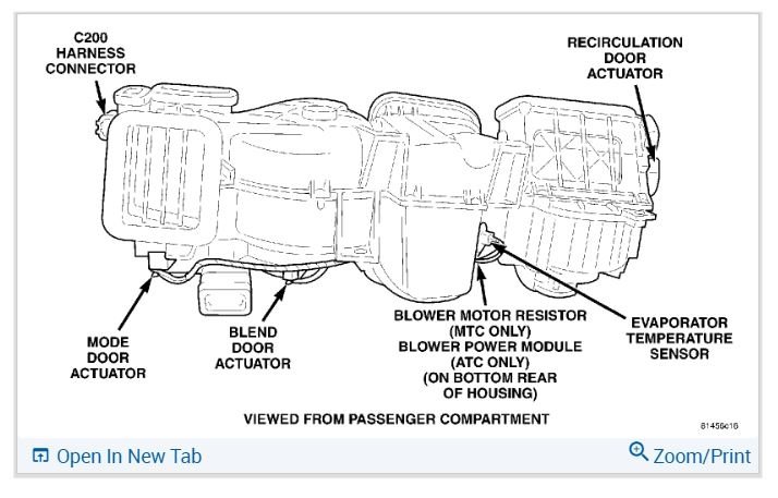

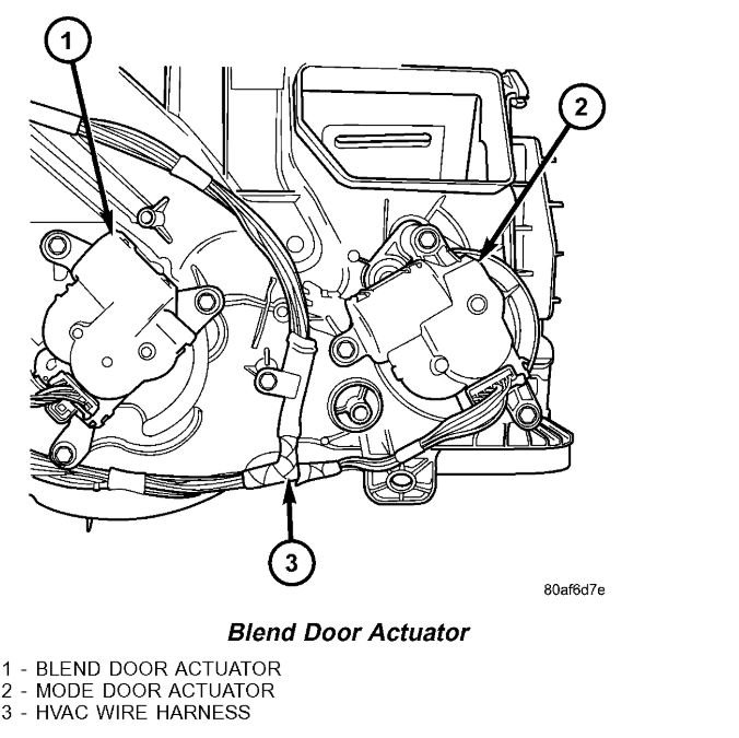

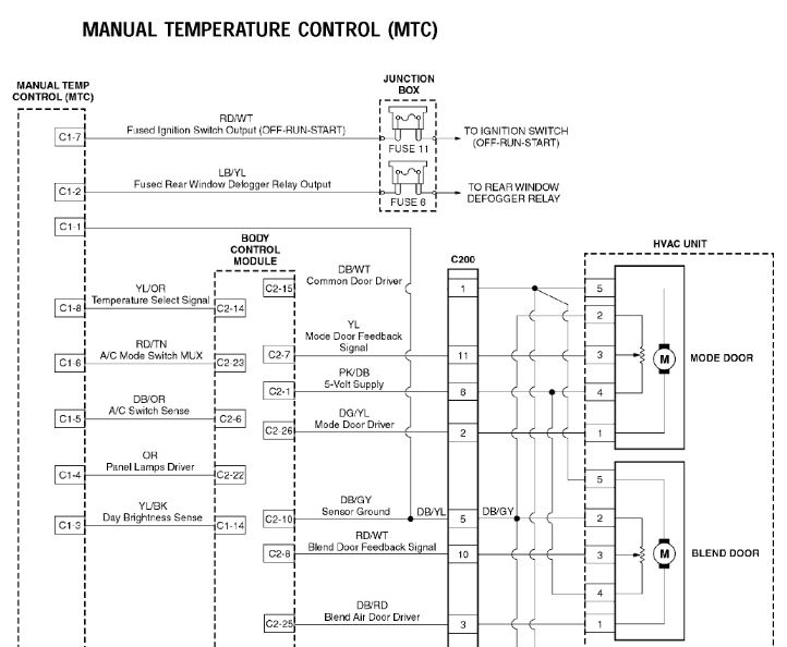

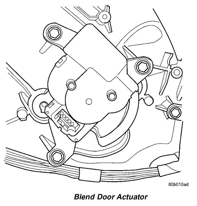

It's possible there's a water leak somewhere around the windshield. I would pull that blend door actuator out and see if it moves when you change the hot/cold knob first to make sure it's working, since you've come this far. It's only 3 bolts. If it's working okay and the door isn't stuck, you may have to get the A/C system checked. A bad expansion valve will limit the pressure on the A/C low side. It's a tricky part to diagnose. Pressure readings will have to be taken.

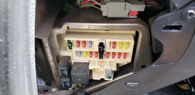

HMAC300
  • 48,601 POSTS
try pulling hvac fuse inside car for 60 seconds with key to see if actuator resets if not it may be the actuator for that side.

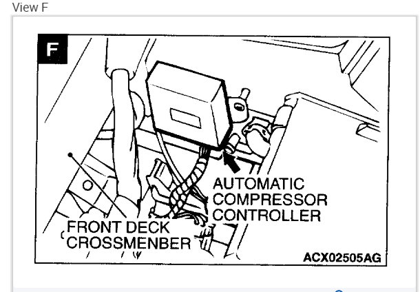

I have a dodge stratus 2003 with weird a/c problems. Bought it a year ago. The a/c started not working so I had the a/c recharge and inspected a year ago and it still had problems right after. The dash control unit was acting up and the a/c would only work when I pushed in on the control unit in the dash. We had that replaced and a/c worked for several days and then didn't work. When I took it in for the 3rd time they couldn't get the a/c to malfunction. I got it back and same afternoon it didn't work. Then it started working when engine was cold but stopped working in hot afternoons. When the compressor came on it would work but the compressor would not come on at hottest time of day. Went through the winter and took it back in spring. through winter compressor would not come on at all. Auto repair place thought they found the problem with a stuck pressure switch and replaced that and a/c worked good for a week. The next week on trip to L A a/c compressor would not come on again when we needed it going by bakersfield. When in LA did not work after two days compressor started working again, but on trip back up to northern calif. started blowing hot again so we left the a/c on and every 15 or 20 minites the compressor would come om for a few seconds and then would go off. As the air temperature cooled, the a/c worked better and better. What seems to be the problem? I am going crazy with this problem.
Jan 13, 2020 at 5:25 AM (Merged)
KHLOW2008
  • 41,812 POSTS

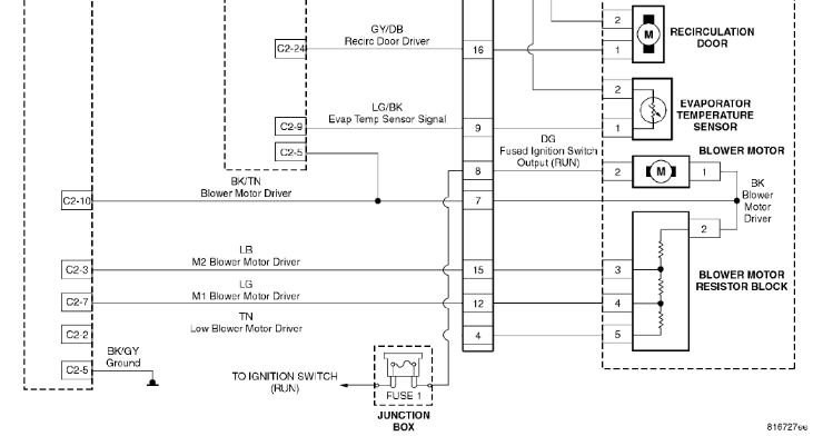

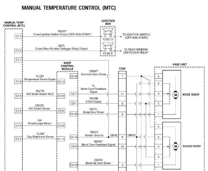

This sounds like the automatic compressor controller is going out which is common here are diagrams to help you change the unit out. But to be sure here is a guide to help check the wiring and a guide to give you step by step instructions.
Check out the diagrams (Below). Please run this test and get back to us.

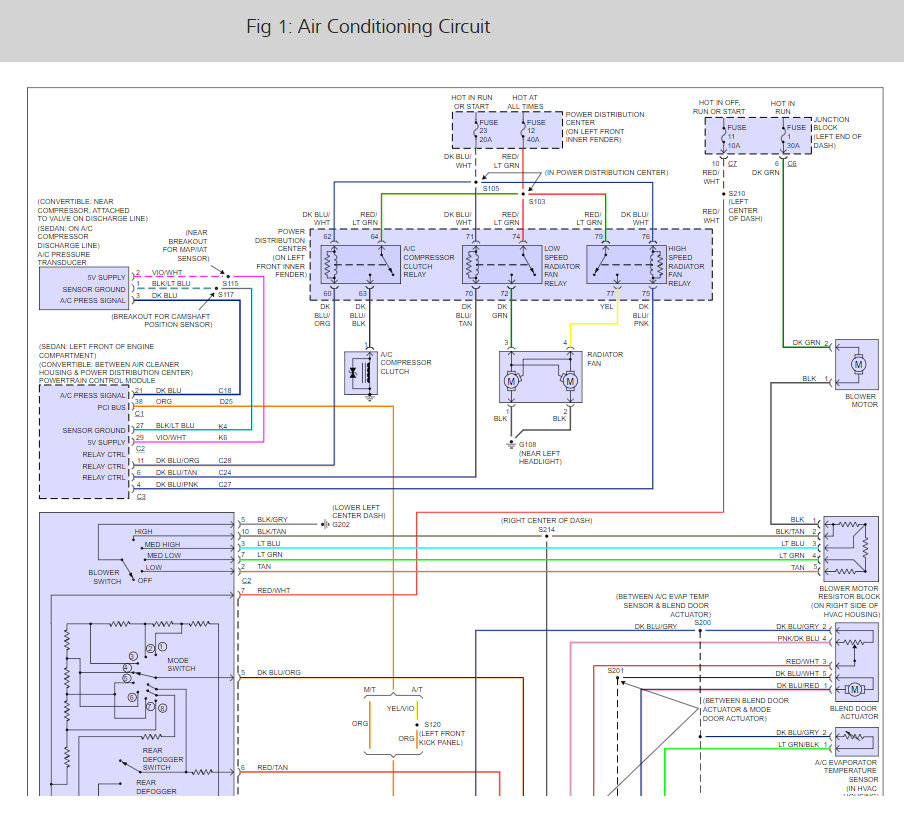

Ac is out. Burnt up belt on the a/c compressor with clutch. The clutch is attached to the compressor. It was bright red, hot, and broke the belt. Bpought new belt and a/c compressor with clutch. Now on the new ac compressor with clutch, the clutch is constantly on, running and is smoking. Trying to ad freeon, it is trying (and did) die. Checked the fuses, not that. The clutch is getting hot still. What is causing this?
MERLIN2021
  • 17,250 POSTS
Check the low pressure switch, it's on the low pressure line, At compressor, If out of R134a, and compressor can run, switch is defective. This will overheat the compressor, no oil running through it!
https://images.2carpros.com/forum/automotive_pictures/62217_stratus_1.jpg
DIAGNOSIS AND TESTING - A/C EXPANSION VALVE The expansion valve is located on the engine side of the dash panel, near the right shock tower. The expansion valve can fail in three different positions (open, closed or restricted). In an Open Position: this will result in a noisy compressor or no cooling. The cause can be a broken spring, broken ball or excessive moisture in the A/C system. If the spring or ball are found to be defective, replace the expansion valve. If excessive moisture is found in the A/C system, recycle the refrigerant. In a Closed Position: There will be low suction pressure and no cooling. This may be caused by a failed power dome or excessive moisture in the A/C system. If the power dome on the expansion valve is found to be defective replace the expansion valve. If excessive moisture is found recycle the refrigerant. A Restricted Orifice: There will be low suction pressure and no cooling. This may be caused by debris in the refrigerant system. If debris is believed to be the cause, recycle the refrigerant and replace the expansion valve and receiver/drier.
