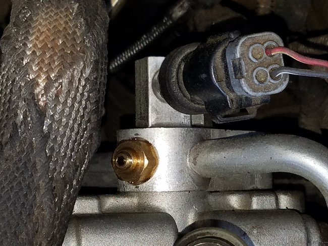

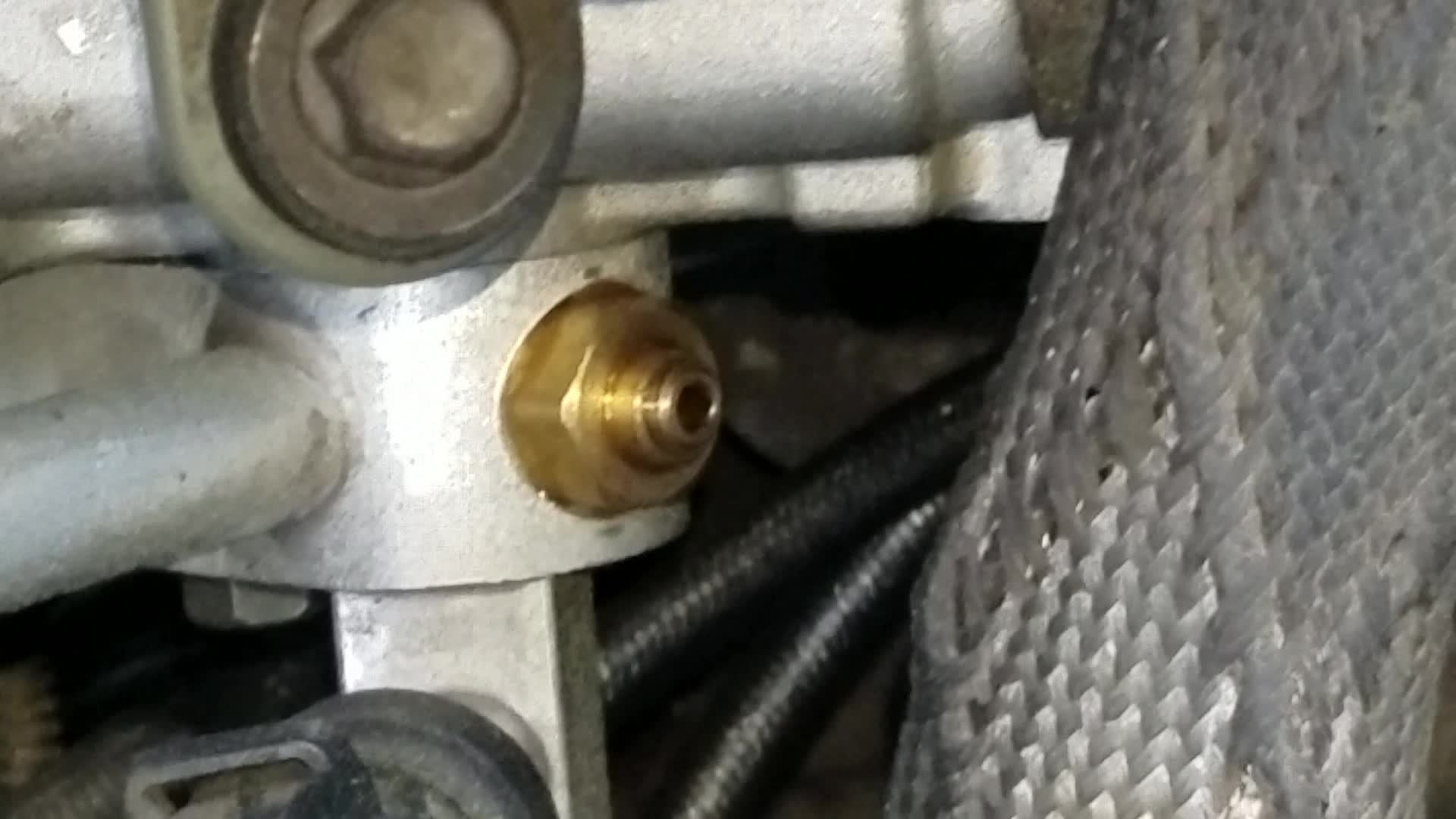

A/C expels Freon (I assume) when compressor engaged, through a small brass fitting on the manifold hose block connected to compressor. Clutch only engages for maybe 2 seconds about every 30 seconds. Couldn't see the gas expel unless have the RPM's up, then see white fog expelled like a nitrous purge. Every A/C part was just replaced with new parts, including hoses. System was vacuumed for an hour, small amount of oil added (because some ran out when removed plug and installed manifold hose), and freon added to spec. A/C worked and blew cool air a couple times for a week (wasn't quite warm enough to run A/C much). Now no cool air, and this symptom. I read possible restriction somewhere, orifice tube is only place I can think. Any other areas or tests to run?

Picture attached. can clearly see that this is a valve (brass colored) on the aluminum manifold hose block that is attached to rear of compressor. The compressor engaged as it should when initially charged. But we never ran engine above idle with hood up, so we never saw this "purge" on first day. It's my belief that after a few days of light use, enough Freon has purged out where now the compressor only engages for a couple seconds ... a few more cycles and I expect it won't engage at all anymore.

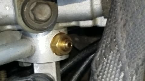

Also attached a short video of it purging. Compressor only engages for a split second every few seconds ... when you see the short purge, that is when compressor is engaged. Holding accelerator at about 2,500 RPMs.

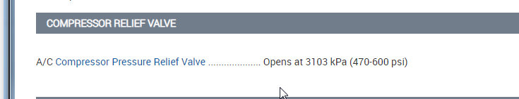

Oh. Got it. That really helps. This is the pressure relief valve. So you do have a pressure issue which is a possible restriction but we need to start from the beginning.
You are correct that it is leaking over time but that is due to the compressor either not shutting off and the pressure keeps building until the PCM cuts it off or the freon drops to the low level where it just short cycles.
This relief valve vents at 470-600 PSI so we need to fill the system to the proper charge and then get the pressures.
We need the pressures with the system off and then with it on. Watch the compressor clutch and see if it cycles. It should shut off and then turn back on ever 20 seconds or so. If it doesn't shut off, you need to turn the system off once the high side pressure reaches 375 PSI. This will prevent you from loosing more freon.

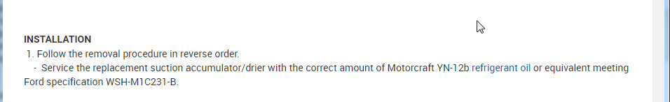

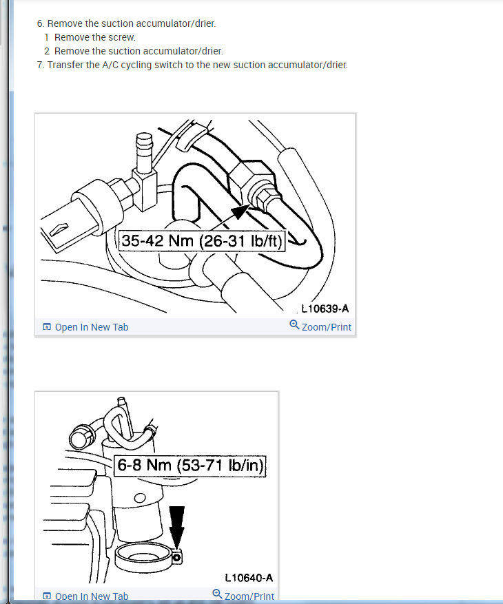

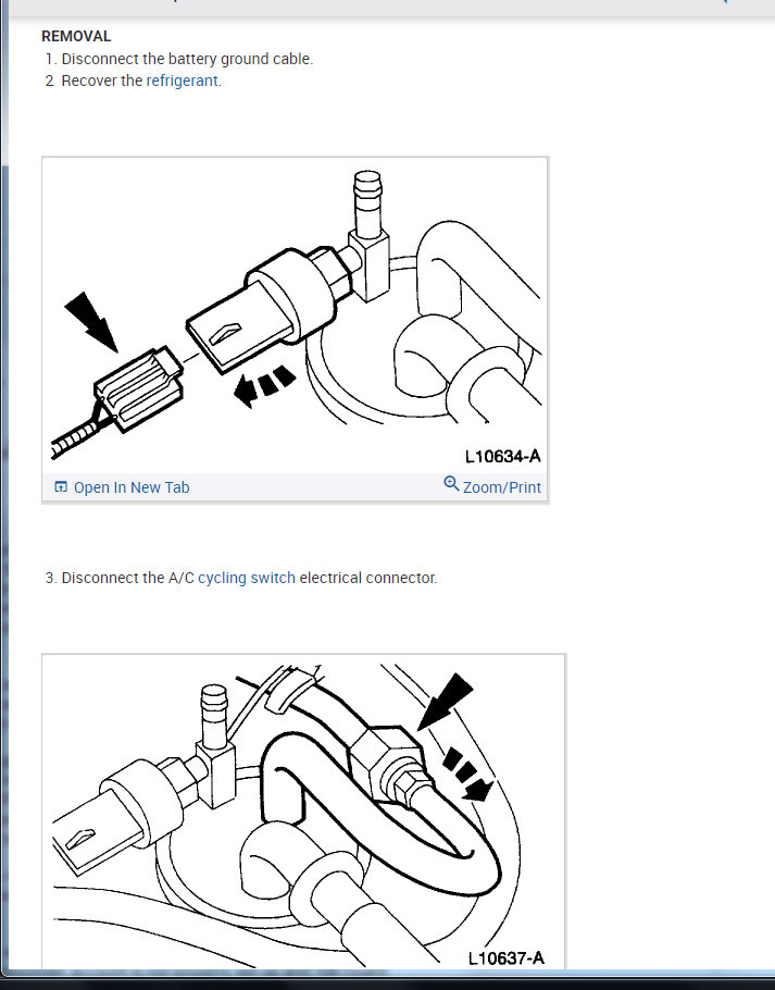

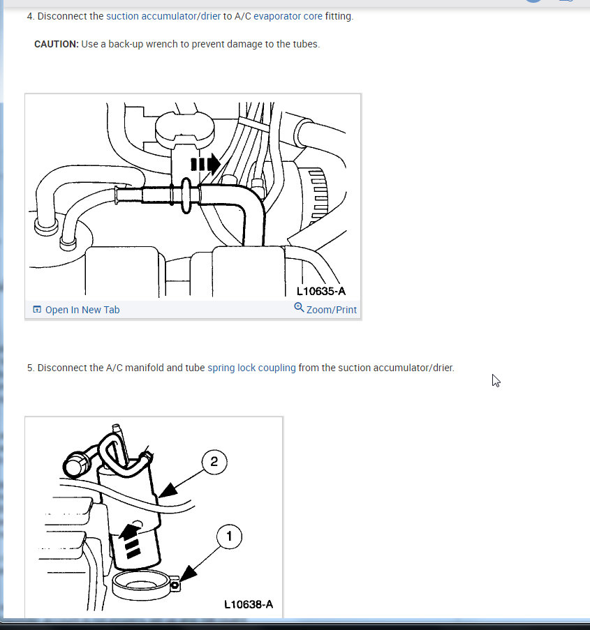

Wow. Great update and analysis. Back flushing will work for all components except the accumulator. These will not flush so I would replace this anytime you have metal in the system even if it was new.
Below is the process for this if you need it. Thanks again for this information. It will surely help others in the future. Thanks

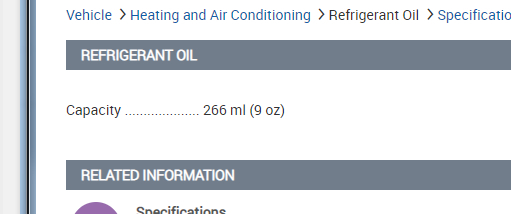

Awaiting new condenser, but received replacement compressor and drier. These compressors have a big sticker that states "contains 7oz of PAG46 oil, more needed if have rear AC" ... my 1998 Explorer calls for 7oz of oil in system, so I assumed all was well. I opened new compressor today dumped and measured oil - I got almost 3oz after 20 minutes of draining and rotating unit to pump oil out. No wonder the last one imploded! A mechanic friend suggested that I add some oil to the other components, that the Freon actually kind of "rides" on the oil and it's good to have a bit throughout the system. So this time I will personally add 1oz to condenser, 1oz to evaporator, maybe a tad into the manifold lines, and remainder of 7oz into compressor. Maybe will get to reinstall this coming weekend.
Apr 21, 2021 at 9:46 AM
Sounds like your friend is or was trained by an old school tech. As long as the right amount of oil is in the system, it doesn't matter where it goes however, most of it should be in the compressor. However, you are correct as that is why it failed.
Lastly, the manual says 9 oz so if that compressor comes with 7 then just put 2 more in some of the other components.

Replacement parts all finally arrived and installed. Backflushed the lines and evaporator with AC solvent flush and air. Filled compressor with most of oil (added some to condenser and evaporator), connected everything, vacuumed, added freon, all was looking good, then. Blow-off valve started up again! High pressure not even up to 200 PSI yet.
So we figured that valve must be bad - it's on the manifold hose block so it wasn't replaced with compressor. Evacuated Freon and dug the original valve out of trash swapped. Repeated everything and looks like we got A/C now!
Turns out that valve was adjustable (could see the tiny allen wrench shape in it after removal) - it was not tightened down as much as should have been. No way for us to know how tight is correct so the original factory valve will have to do. As usual, $100's of trouble over a 20 cent part that has info available on and you can't even buy individually.
