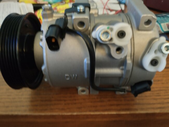

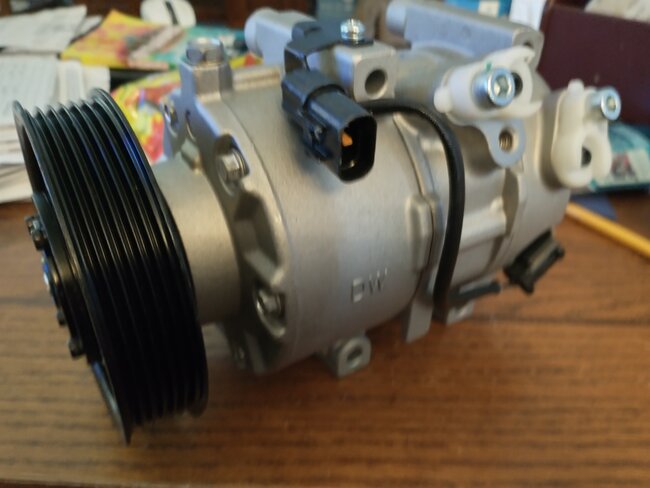

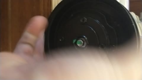

Thank you. Yes, the clutch is always engaged on both the old compressor and new compressor. Now I did apply 12 volts to the switch on the new clutch and you can hear a click, but there is no movement on the front whatsoever, such as a clutch engaging. As mentioned earlier the operation of the compressor on the same, make and model of car (2015 Genesis Coupe 3.8) that has a working A/C shows the entire front of the compressor turning continuously whether the A/C is on or off. There is no visible cycling of the compressor that is visible. Could this be an internal clutch of some sort? I've checked the clutch via VIN number and the clutch I received is the right clutch. I should also include that with the belt off the idler pulley on the installed compressor turns pretty easily. Doesn't feel like there is any real compression or engagement, whereas on the new one there is noticeable resistance when turning the spindle by hand, but that could be because I have not removed the plastic plugs out that come on the compressor, which may be causing the resistance.

Attached are a couple pics of the new compressor and my turning of the new compressor. Thanks again

It is actuating internally when you hear the click. Although the pulley/clutch are engaged, the connection is happening internally. Does the original one do the same?

Keep in mind, the clutch isn't a traditional setup, it's a variable displacement compressor.
There is a movable plate within the compressor that can rotate and change the volume of the compression chamber, adjusting the amount of compression continuously from zero to the full amount. That is what you are hearing inside.

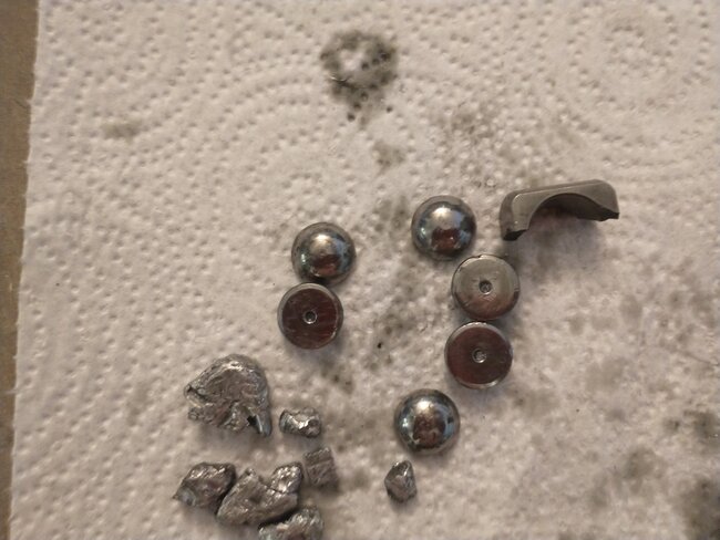

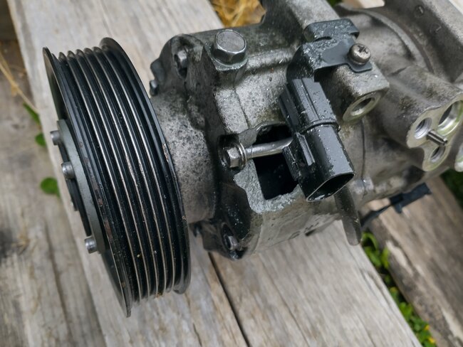

Good evening,
Well, to follow up I took the compressor out of the car and there was a hole in the top of the compressor and when I turned it upside down to get the oil out all kinds of shiny metal objects fell out things fell out of, lol. I actually think I may have knocked the hole in it myself when I was trying to remove the alternator, but I know I didn't cause any other stuff that fell out. I'm enclosing pictures. I'm now waiting for the receiver and dryer to some in. I know I need to flush the system but am unsure of the way to do that. Any advice on that? Thanks

  • 109,867 POSTS
Wow! That's the problem. I don't think I've ever seen a hole that big. Make sure to flush the system. Let me know.
