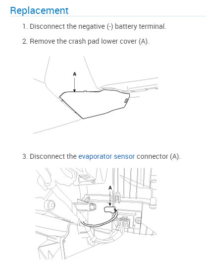

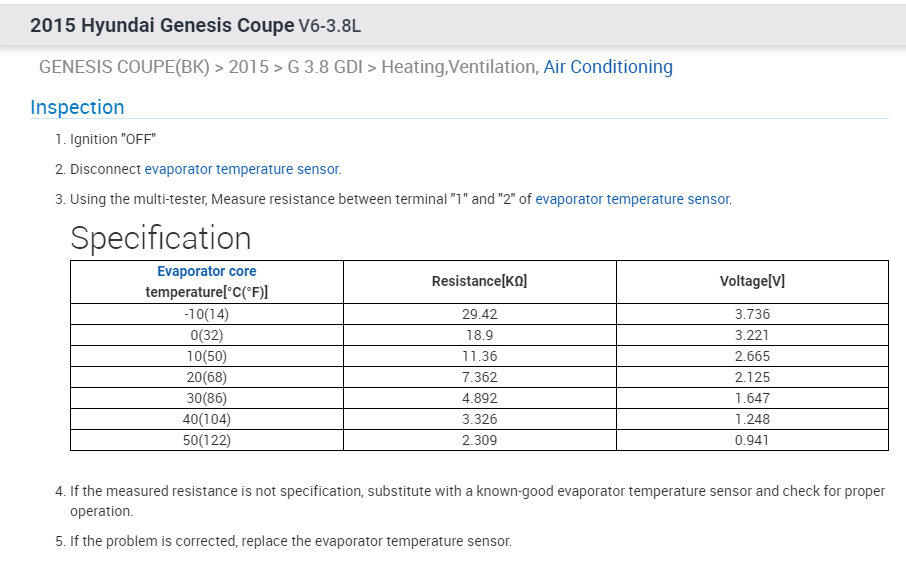

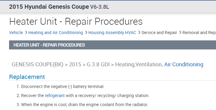

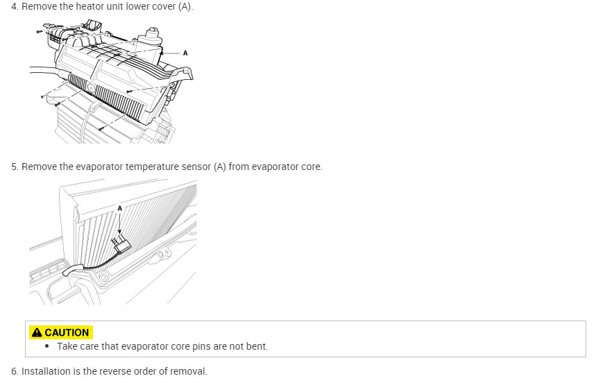

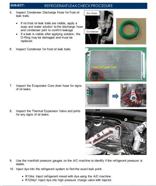

The evaporator is under the dash on the passenger side of the HVAC box. For access, the heater core will need to be removed. I attached the directions below.
However, take a look through the first three pics. That is a technical service bulletin specific to your vehicle for locating a leak. You may find them helpful.

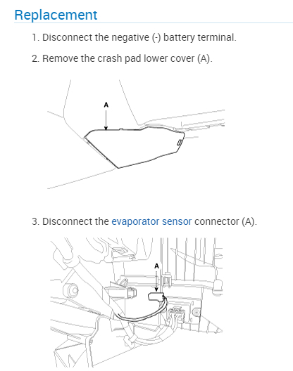

The remaining pictures are the directions for replacing the evaporator temperature sensor. The sensor is attached to the evaporator. There are no specific directions specific to just the evaporator, so this will get you to it.

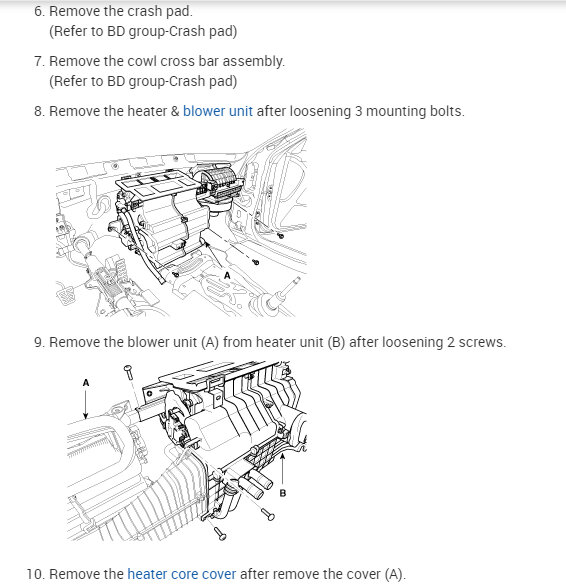

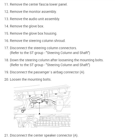

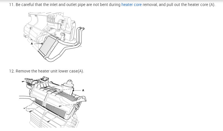

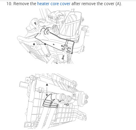

Thank you for the information. Do you know where I might be able to gather the information needed to replace the Evap? I'm guessing the entire dash is going to have to come out which is something I've never attempted before. Done just about everything else, but never a dash removal. Thanks again for the information.
Mar 27, 2023 at 7:39 AM
  • 110,241 POSTS

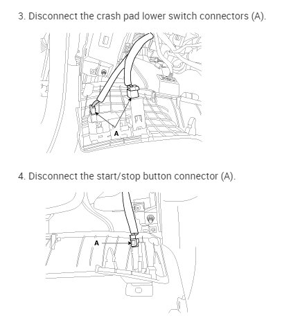

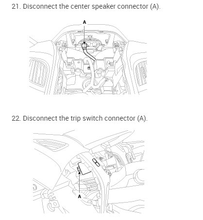

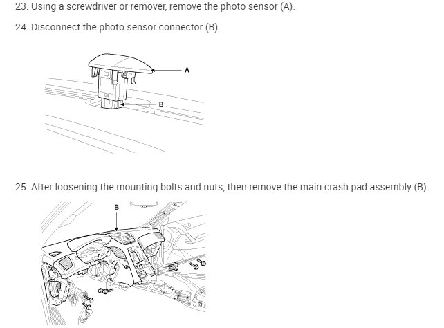

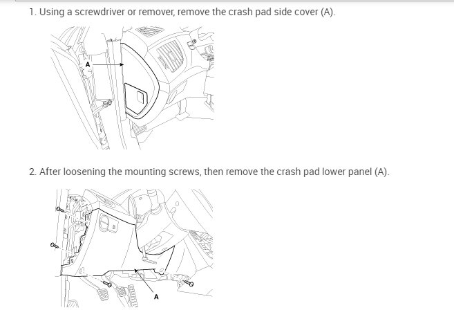

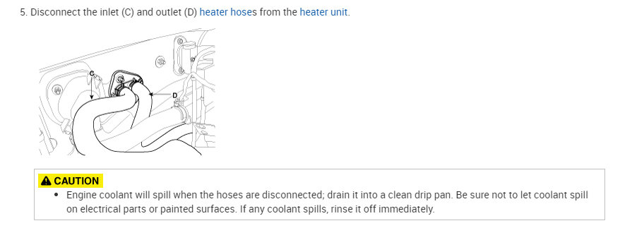

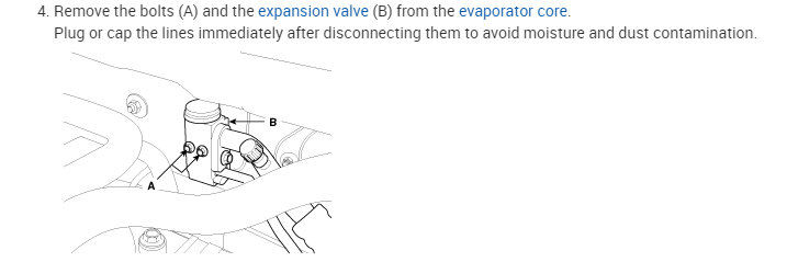

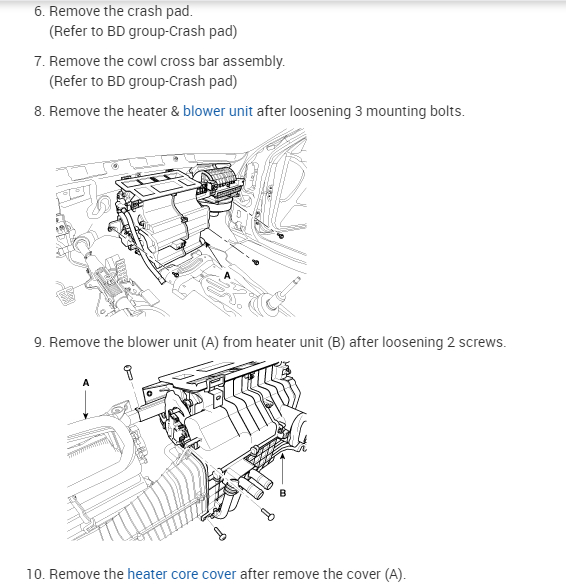

I went through two manuals that had no directions for the evaporator core, but I did find them. LOL, they are listed with the heater core removal. Ugh!!!
If you look at the first eight pics below, they are the directions. Note that I highlighted something in pic seven.

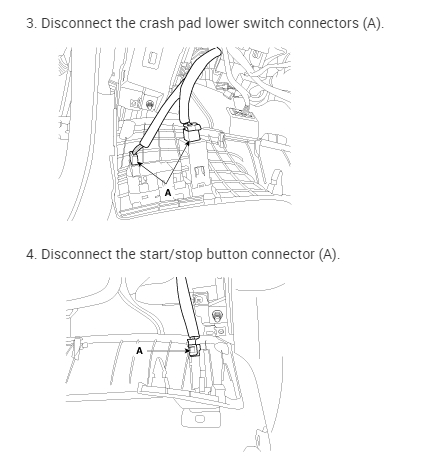

Now, the directions indicate the removal of the dash pad to access it. All I can tell you is this. The remaining pics are the directions for the removal and replacement of the dash pad. Try not to be overwhelmed.
Pics 8 - 11 are the directions for the removal of the lower dash pad. I'm hoping if you remove that along with the glove box, you should have access. If you don't, the remaining pics are for the main crash pad.
Let me know if this helps.

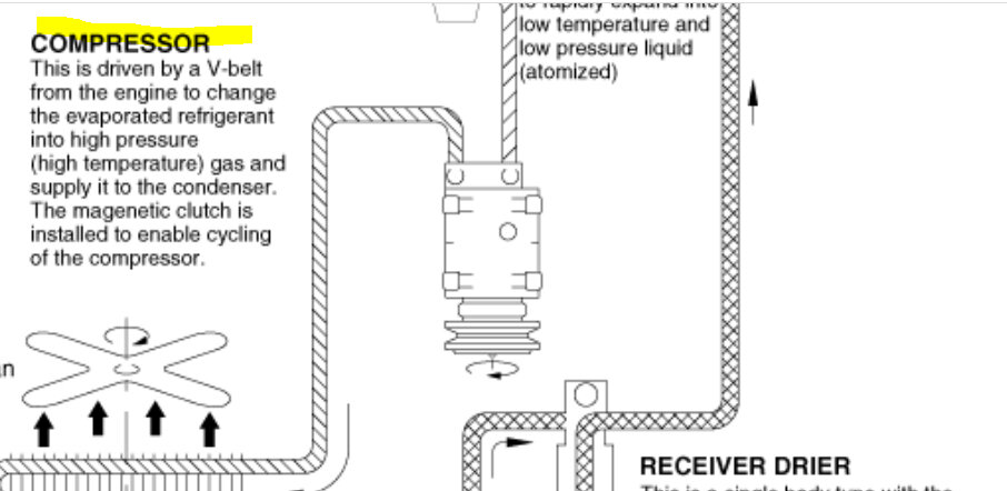

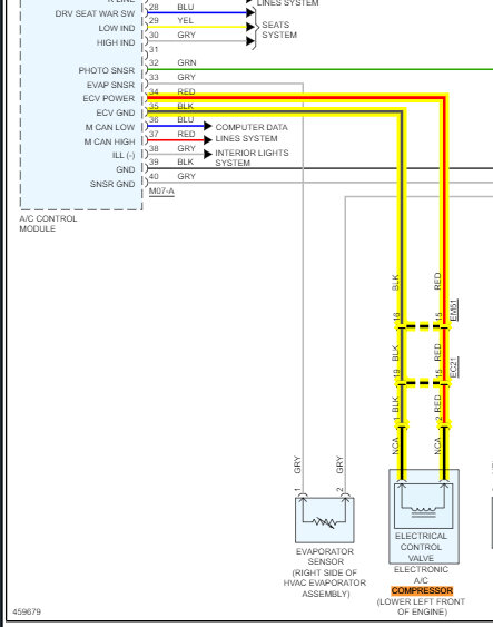

Is it possible for you to get pressure readings from both the high and low sides of the system? If you can, could you let me know the static pressure (system off for a period of time), both pressures and the outside temperature when checked?
According to the manual, it has an electronic clutch. See pic below. If it is turning the compressor, we have a different issue.
See pic below.

If it is spinning that easily with the clutch engaged, something is broken. As far as a relay, the schematic doesn't show a compressor clutch relay on this vehicle. Control of the compressor is done via the A/C control module.
joe
See pic below.

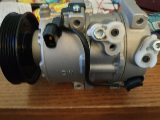

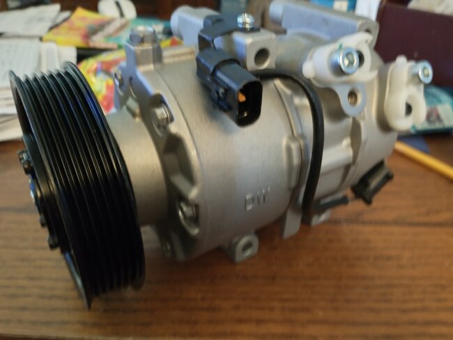

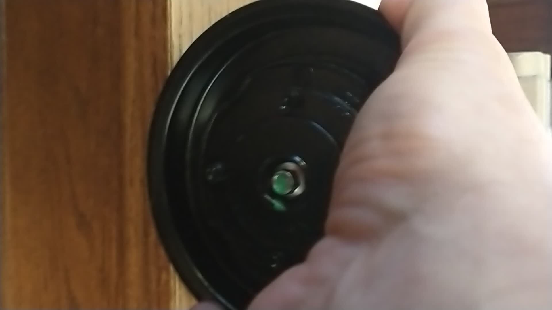

Thank you. Yes, the clutch is always engaged on both the old compressor and new compressor. Now I did apply 12 volts to the switch on the new clutch and you can hear a click, but there is no movement on the front whatsoever, such as a clutch engaging. As mentioned earlier the operation of the compressor on the same, make and model of car (2015 Genesis Coupe 3.8) that has a working A/C shows the entire front of the compressor turning continuously whether the A/C is on or off. There is no visible cycling of the compressor that is visible. Could this be an internal clutch of some sort? I've checked the clutch via VIN number and the clutch I received is the right clutch. I should also include that with the belt off the idler pulley on the installed compressor turns pretty easily...doesn't feel like there is any real compression or engagement, whereas on the new one there is noticeable resistance when turning the spindle by hand, but that could be because I have not removed the plastic plugs out that come on the compressor, which may be causing the resistance.
Apr 22, 2023 at 12:07 AM
SWILSON3828
  • 112 POSTS
Attached are a couple pics of the new compressor and my turning of the new compressor. Thanks again
Apr 22, 2023 at 12:11 AM
  • 110,241 POSTS
It is actuating internally when you hear the click. Although the pulley/clutch are engaged, the connection is happening internally. Does the original one do the same?

Keep in mind, the clutch isn't a traditional setup, it's a variable displacement compressor.
There is a movable plate within the compressor that can rotate and change the volume of the compression chamber, adjusting the amount of compression continuously from zero to the full amount. That is what you are hearing inside.

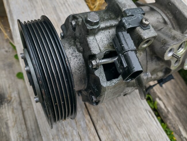

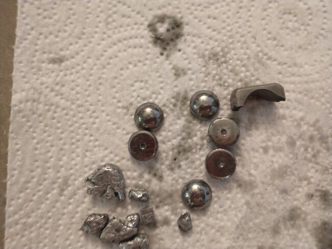

  • 10 POSTS
Good evening,
Well, to follow up I took the compressor out of the car and there was a hole in the top of the compressor and when I turned it upside down to get the oil out all kinds of shiny metal objects fell out things fell out of, lol. I actually think I may have knocked the hole in it myself when I was trying to remove the alternator, but I know I didn't cause any other stuff that fell out. I'm enclosing pictures. I'm now waiting for the receiver and dryer to some in. I know I need to flush the system but am unsure of the way to do that. Any advice on that? Thanks
Apr 26, 2023 at 10:08 AM
SWILSON3828
  • 112 POSTS
Sorry, I think I replied to this only my friends account, so I'm going to reply again.
So, i got the compressor off and there was a big hole in the top of it. Turned it upside down and all kinds of metals stuff came out, lol. I'm now waiting for the receiver and dryer to come in. I know I have to flush the system but have never done that. Any advice on the proper way to do it? Thanks
Apr 26, 2023 at 10:30 AM
  • 110,241 POSTS
Wow! That's the problem. I don't think I've ever seen a hole that big. Make sure to flush the system. Let me know.
