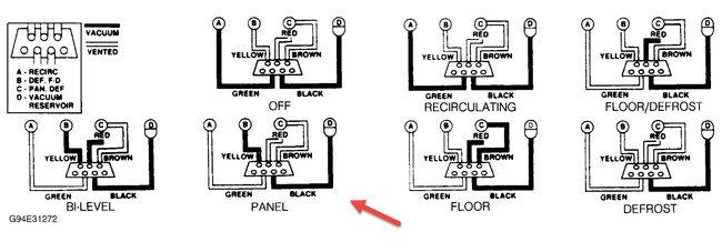

A/C does not blow out of my front vents
GORDON H. ADKINS JR.
  • 1996 DODGE RAM
  • 5.2L
  • V8
  • 2WD
  • 145,000 MILES
When selected my A/C blows out of my defrost and floor vents but not my front vents. I have checked that I do have pressure at my actuator and I fixed a broken vacuum line under the hood going into the cab on the passenger side.
Thursday, July 6th, 2017 AT 9:19 PM
HMAC300
  • 48,601 POSTS

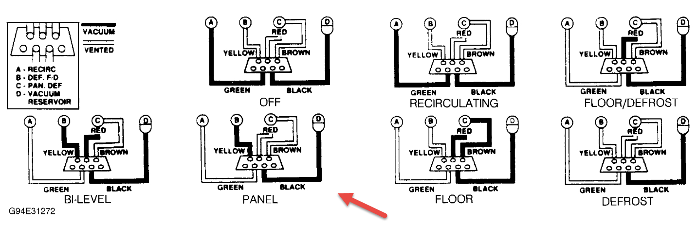

Check for a vacuum leak at arrow. It can be leaking from control to that vacuum motor or the motor may not be working or a line fell off. See picture.
