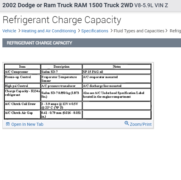

I have a 02 dodge ram 5.9L engine quad cab I wanted to know how much refrigerent the a/c system holds?

Ok I found it. Sorry for the wait. If it's a 1500 then it holds 26 oz. A 2500 or 3500 holds 32 oz.

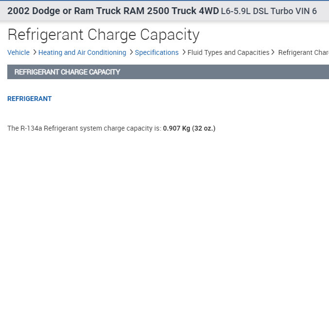

For the gas engines it takes 29 oz and for diesel 32 oz.
