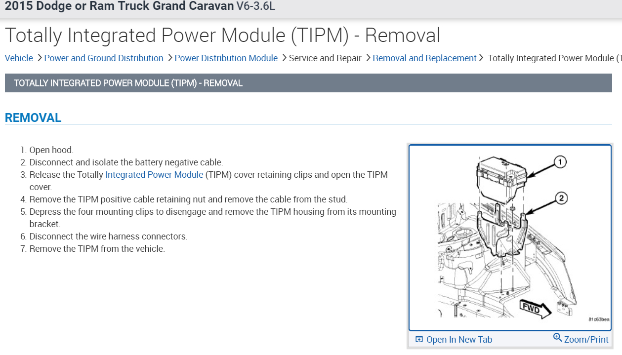

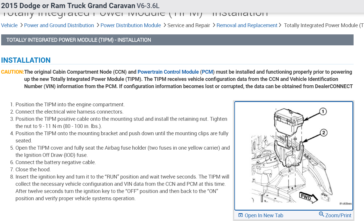

Hi, there is blinking light on button which turns on rear window heat after start for about a minute. There is no fan blow until the blinking stops, then AC starts and works fine after that. My web searching resulted in info that it is some error code, light trying to tell us that something is wrong with the system. However mechanic plugged computer in and there was no error code. He tried fix that by replacing control panel parts (or all of it). What has changed it is not blinking and delaying every time but every third, fourth star,t but first start of the day usually blinks with delay.Forgot to mention that this issue started after alternator failure and replacement. Recently I discovered that front of the car doesn't heat,only cold air blows while rear is working fine.
Nov 25, 2019 at 10:02 PM
  • 55,224 POSTS
When the mechanic did the scan did he use a CAN scanner which is the future of car repair? This runs through all system. here is a video of the job being done. You can get a CAN scanner for about $50.00 on Amazon.
https://youtu.be/InIlnsjOVFA

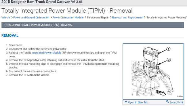

This sounds like the TIPM is out which is common here is how you replace it which is easy because it self initializes. Check out the diagrams (below). Please let us know what happens.

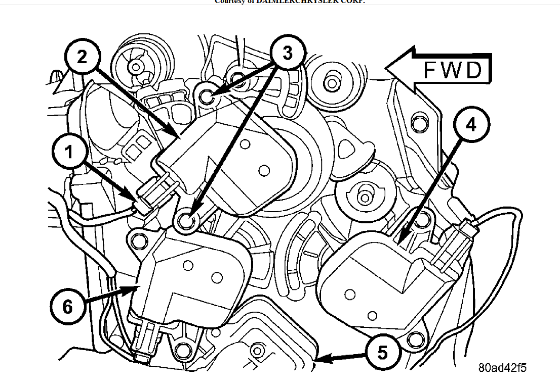

Hi, I'm afraid the heat blend is motor controlled. At one time a cable was used to open the blend air door, now there are two motors that must be calibrated using a scan tool(computer). Unless you have no coolant in the cooling system, you have already done the best you can, the dealer has the DRBIII that is needed for checking fault codes in the a/c and heater system and for testing or calibrating one or both electric motors used for directing air across the heating coil. But check that you have coolant available for heating first, ok.

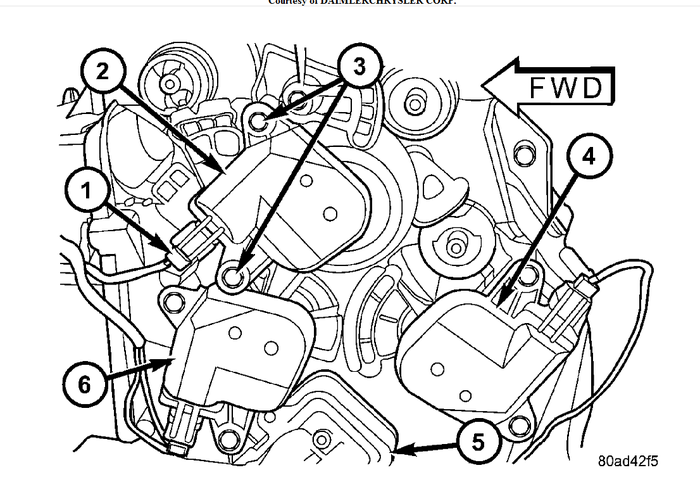

HMAC300
  • 48,601 POSTS
check to see if both heater hoses are hot if they are check the actuators in the heater. if ihoses not hot check thermostat. if it's an actuator it's item 4 or 6 depending on your ssystem. ti cold also be the control which it would need to be scanned to find the problem.
