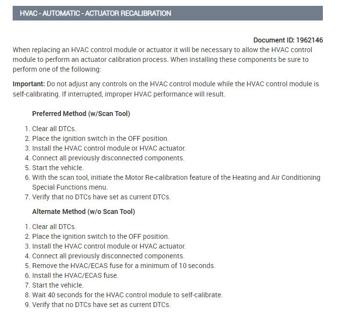

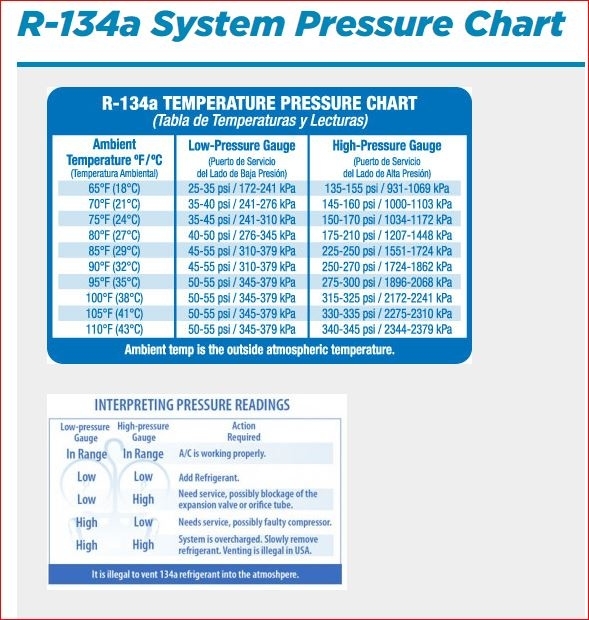

We need to back track just a little bit to make sure we are not missing something. First we need to hook the gauge set up and see what the pressures are for the high and low side with the system off and then with it on.
We could just have a weak compressor or even a restriction so let's start with making sure that side of the system is operating or we will need fix this.
I attached a chart below that will help with looking at pressures and what they should be based on ambient temperature.

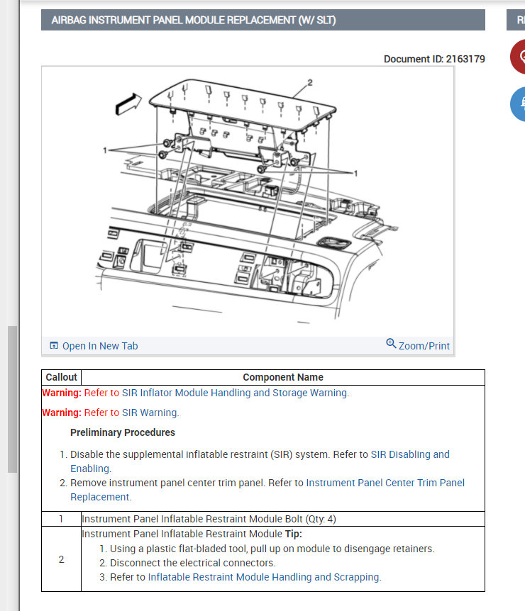

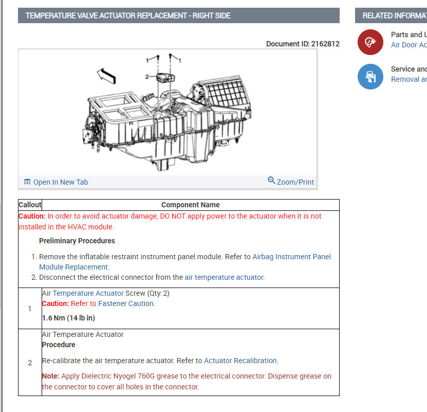

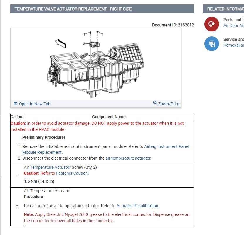

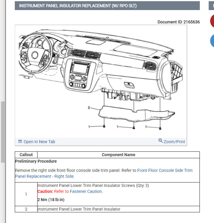

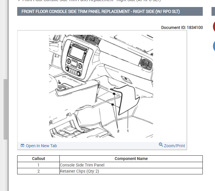

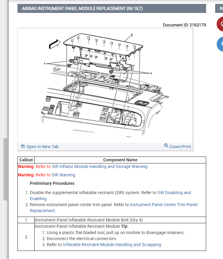

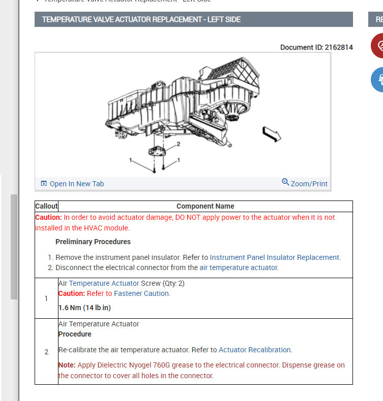

Next you do have two blend doors with a dual climate system. I am going to attach the process below for how to replace them but here is a video on this truck up to a 2007. Your truck is going to be similar.
https://youtu.be/Eqf-H3COtSo
I am also attaching the process below (last page) for how to recalibrate the doors.
If I am going to guess, I suspect we have an issue with the compressor operation or Freon pressures so let's start with that and go from there.

So with my gauge set and vacuum pump, and being located slightly west of Baltimore city, I'm able to pull around 27 inches of vacuum on an A/C system. Of which I did, and this system holds for steady for hours with no drop in vacuum. I refilled the system with R134, and when running, my low pressure side pulls down to right around 35-40 PSI on an 80 degree day. High pressure side runs around 170-175 PSI, which is why I'm pressure sure the compressor is good. Being that its electric, it's one of the trickier systems I've worked on, since I'm used to revving the engine up to around 2,000 RPMs to achieve the coldest temperatures I can, but this one seems to pull down without me doing that, and it doesn't make a difference anyway.

One thing you can do without a high end tool can be done with any scan tool that can read live data, use it to check what the ambient temperature sensor shows as the current outdoor temperature, then compare that to the dash display and verify it is within a degree or two of a known correct thermometer. If it is then try this reset, Turn the key on, now press the AC and Recirculate buttons down and hold them for at least 5 seconds. That will reset the modules internal memory to be sure all the sensors agree. I like to do that when the vehicle has been setting a while, preferably inside out of any sun or heat as that get's the sensors all closer to the same temperatures. Once reset see if anything has changed, I have seen them get confused and the control module thinks it like 40 degrees outside when it is 60, causes interesting things to happen. Beyond that a scan tool to see what the HVAC is seeing would be next. One other thing you might try would be a hard reset of the system. I have seen that "repair" many issues as well. The easiest way is to disconnect the battery and let it set for about 5 minutes, then reconnect it, this erases the KA memory though so you may need to drive it a bit so it can relearn idle and shifting, and if there is ANY issue with the hybrid side don't do this. Instead find the HVAC fuses (39 and 70) in the under hood fuse panel and pull them for 30 seconds. This will normally reset the system. Test again. If no change then grab a scan tool and see what it shows, some of these can fail and set a code that doesn't show anywhere but on a scan tool.
