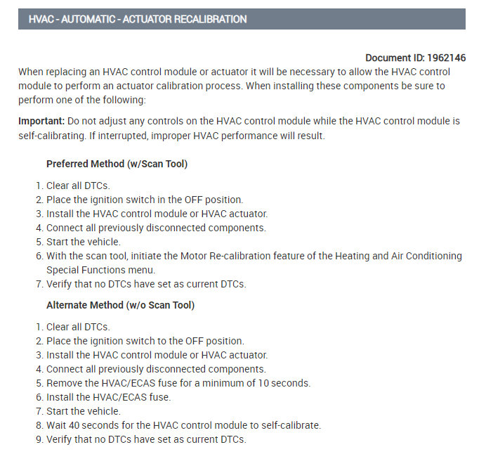

Defrost door are out of calibration. No scan tech2. How to reset and calibrate have system with no scanner? Thanks
Oct 6, 2017 at 11:34 AM
STEVE W.
  • 15,202 POSTS
From the book -
Do not adjust any controls on the HVAC control module while the HVAC control module is self-calibrating. If interrupted, improper HVAC performance will result.
Clear all DTCs.
Place the ignition switch to the OFF position.
Install the HVAC actuator.
Connect all previously disconnected components.
Remove the HVAC control module fuse for a minimum of 10 s.
Install the HVAC control module fuse.
Start the vehicle.
Wait 40 s for the HVAC control module to self-calibrate.
Operate system and verify that no DTCs have set as current DTCs.

What is the procedure for calibrating the actuators after they have been replaced? I have automatic dual climate control. I am assuming that the actuator notch has to be in the center position. And that any codes should be erased. Is it best to disconnect the battery or can the HVAC fuse be removed then reinstalled? There is some confusion as to the correct method.
thanks
Apr 30, 2021 at 1:03 PM (Merged)
Good evening.
Here is how you can recalibrate the blend door actuators
RE-CALIBRATING ACTUATORS

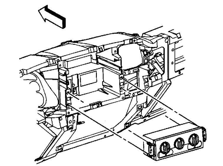

When replacing the HVAC control module it will be necessary to allow the HVAC control module to perform a calibration process. When installing the HVAC control module be sure to perform the following:
IMPORTANT: Do not adjust any controls on the HVAC control module while the HVAC control module is self-calibrating. If interrupted, improper HVAC performance will result.
1. Place the ignition switch to the OFF position.
2. Disconnect the scan tool.
3. Install the HVAC control module.
4. Connect all previously disconnected components.
5. Start the vehicle.
6. Wait 40 seconds for the HVAC control module to self-calibrate.
7. Verify that no DTCs have set as current DTCs.
When replacing the HVAC actuator it will be necessary to allow the HVAC control module to perform a calibration process. When installing the HVAC
actuator be sure to perform one of the following:
Preferred Method (w/ Scan Tool)
1. Clear all DTCs.
2. Place the ignition switch in the OFF position.
3. Install the HVAC actuator.
6. With the scan tool, initiate the Motor Re-calibration feature of the Heating and Air Conditioning Special Functions menu.
Alternate Method (w/o Scan Tool)
1. Clear all DTCs.
2. Place the ignition switch to the OFF position.
5. Remove the HVAC/ECAS fuse for a minimum of 10 seconds.
6. Install the HVAC/ECAS fuse.
7. Start the vehicle.
8. Wait 40 seconds for the HVAC control module to self-calibrate.
9. Verify that no DTCs have set as current DTCs.
This guide can help as well

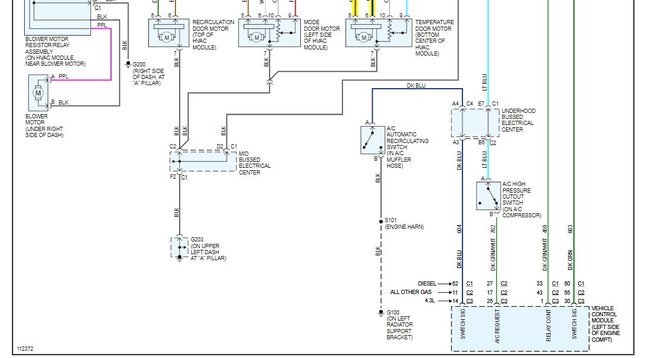

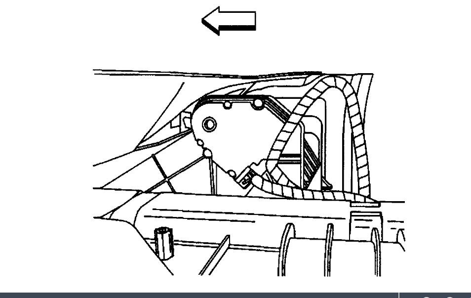

I installed a new blend door actuator. I have tried at least 7 different ways to reset the actuator but all have failed. The problem is cold setting produces heat. Hot setting produces cold.

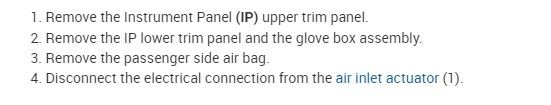

Good afternoon,
After replacing with a new actuator, you remove the HVAC1 fuse for 2 minutes. Then turn on the key and install the fuse. Leave it for 3 minutes. That is the procedure for calibration.
Did you replace the actuator? This guide can help
TONYH3
  • 8 POSTS
I replaced the actuator. Then went through the procedure of pulling the fuse for 2 minutes and turning on the key(not starting) and then installing the fuse and waiting for 3 minutes. Same result twice. I tried once turning key off after calibration, then starting engine to test controls. The second time I just started engine and tested the controls after calibration. The actuator did the same thing: cold setting was hot and hot setting was cold.

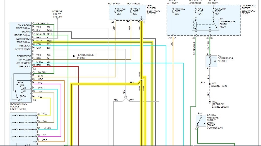

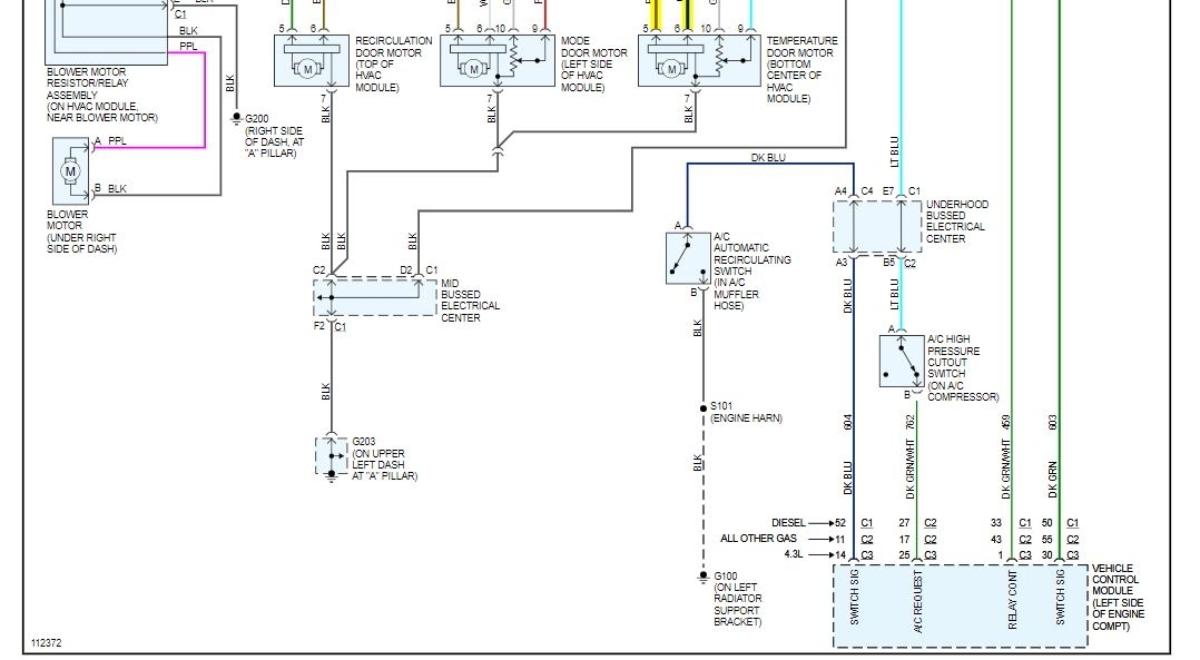

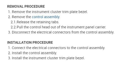

Okay, it is not the actuator. You will need to test for power to the actuator to be sure it is getting a signal from the control head.
With the key on, you need to test for 12 volts at the actuator motor. The color is on the diagram I attached.
Start there.
TONYH3
  • 8 POSTS
I checked pins 5 and 6 on the connector and have 11.7V.
Okay, you have a low battery in the truck.
Is that with the actuator hooked up or disconnected?
TONYH3
  • 8 POSTS
Disconnected.

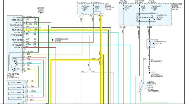

TONYH3
  • 8 POSTS
I also started engine and have 14.64V.
Only one of the wires should have power, not both.
I would suspect the control head is not working correctly or the wiring is shorted together between the actuator and the control head.
TONYH3
  • 8 POSTS
You are correct. Using a common ground, with key on, pin 5 has 12.4V, while pin 6 has a low or no mV value. So there is no shorting.
Then how did you come up with voltage on both pins?
TONYH3
  • 8 POSTS
I assumed the voltage across both pins was what you were looking for. Sorry.
No, that is good. The fact you have system voltage tells me there is no short.
It looks like the control head.
TONYH3
  • 8 POSTS
Thanks Roy. I will move on to that.
You are welcome.
Always glad to help.

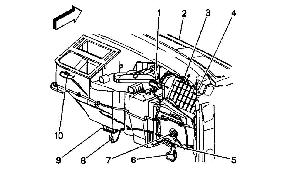

We need to back track just a little bit to make sure we are not missing something. First we need to hook the gauge set up and see what the pressures are for the high and low side with the system off and then with it on.
We could just have a weak compressor or even a restriction so let's start with making sure that side of the system is operating or we will need fix this.
I attached a chart below that will help with looking at pressures and what they should be based on ambient temperature.

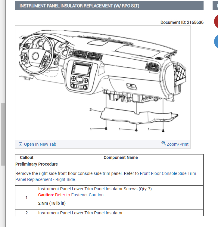

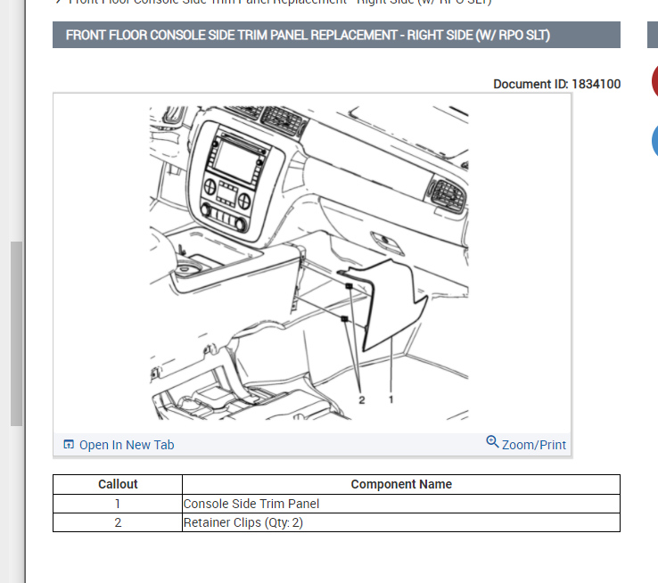

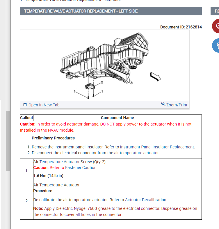

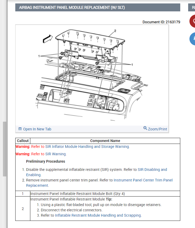

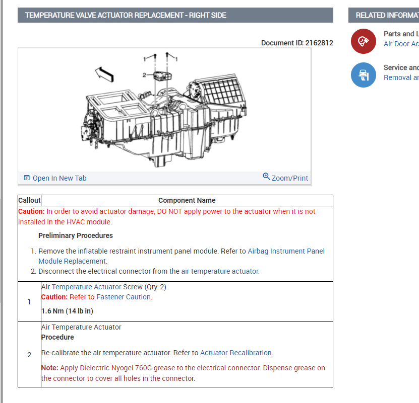

Next you do have two blend doors with a dual climate system. I am going to attach the process below for how to replace them but here is a video on this truck up to a 2007. Your truck is going to be similar.
https://youtu.be/Eqf-H3COtSo
I am also attaching the process below (last page) for how to recalibrate the doors.
If I am going to guess, I suspect we have an issue with the compressor operation or Freon pressures so let's start with that and go from there.

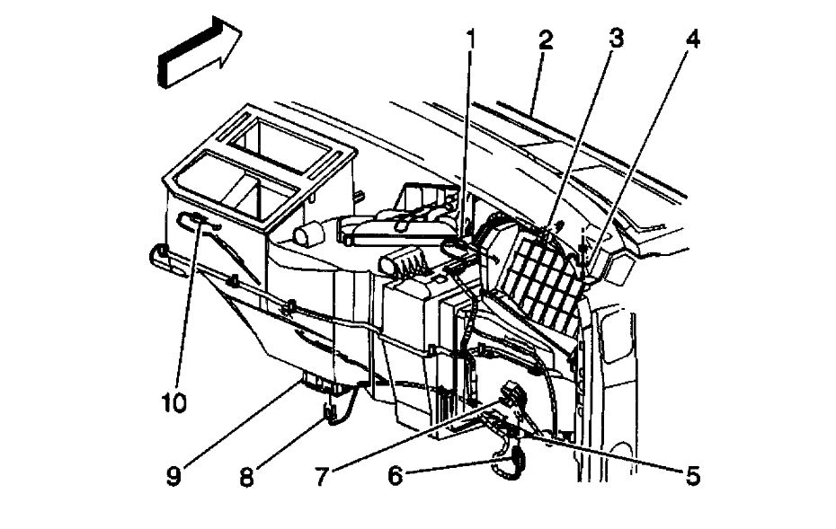

The display is for the set temperature. So if you set it to say 72 degrees the system will run the AC and heat to maintain that temperature. Set it to 60 and it does the same. What most of them do to measure the temperature is to use an aspirator sensor. It's basically a thermistor with a tiny fan that draws cabin air over it. Yours is in the headliner near your head. They can get hair and crud in them and cause problems and when they fail usually by defaulting to a set temperature of about 70 degrees.
However yours also has a host of others and all of those can cause it to default to that same temperature. In your case I'm thinking one of them has a problem and is defaulting to that set temperature. That is because of the way you said that hotter outside temperatures made the AC work better. The higher ambient temp would tend to make the system try to cool more to get back to that set temperature.
Ambient Air Temperature Sensor - under the hood, used for HVAC and engine controls.
Inside Air Temperature Sensor Assembly - in headliner
All of these are located in the HVAC ducts
Upper Left and Right Air Temperature Sensors
Lower Left and Right Air Temperature Sensors
Upper and Lower Air Temperature Sensors (used with the automatic controls)
Unfortunately you need a higher end scan tool like a Tech 2 to be able to talk to the HVAC controller and see what it shows for the sensor temperatures.
One thing you can do without a high end tool can be done with any scan tool that can read live data, use it to check what the ambient temperature sensor shows as the current outdoor temperature, then compare that to the dash display and verify it is within a degree or two of a known correct thermometer. If it is then try this reset, Turn the key on, now press the AC and Recirculate buttons down and hold them for at least 5 seconds. That will reset the modules internal memory to be sure all the sensors agree. I like to do that when the vehicle has been setting a while, preferably inside out of any sun or heat as that get's the sensors all closer to the same temperatures. Once reset see if anything has changed, I have seen them get confused and the control module thinks it like 40 degrees outside when it is 60, causes interesting things to happen. Beyond that a scan tool to see what the HVAC is seeing would be next. One other thing you might try would be a hard reset of the system. I have seen that "repair" many issues as well. The easiest way is to disconnect the battery and let it set for about 5 minutes, then reconnect it, this erases the KA memory though so you may need to drive it a bit so it can relearn idle and shifting, and if there is ANY issue with the hybrid side don't do this. Instead find the HVAC fuses (39 and 70) in the under hood fuse panel and pull them for 30 seconds. This will normally reset the system. Test again. If no change then grab a scan tool and see what it shows, some of these can fail and set a code that doesn't show anywhere but on a scan tool.
