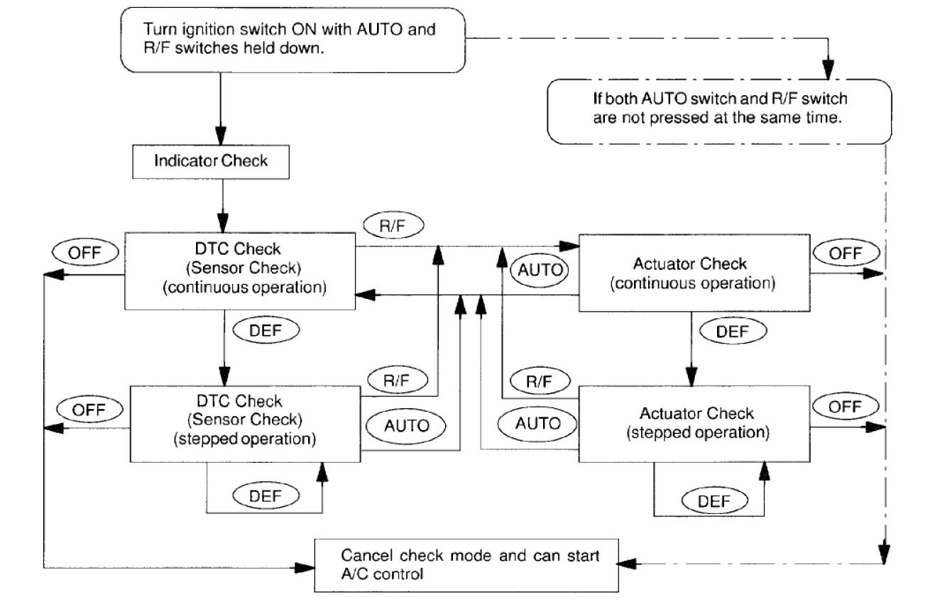

The diagrams illustrates how to retrieve trouble codes of the A/C system. Give it a try and let us know if there are any codes.
+1
Saturday, October 10th, 2020 AT 9:29 AM (Merged)
LINDSAY NEAL OBERG
What is the R/F switch?

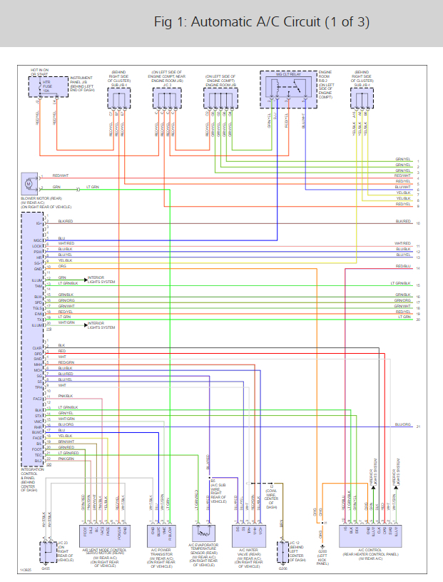

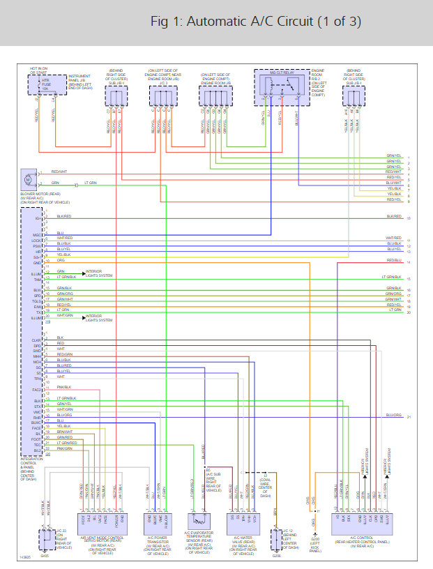

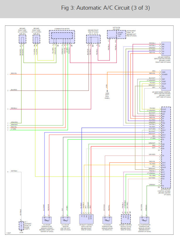

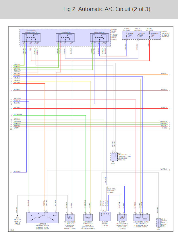

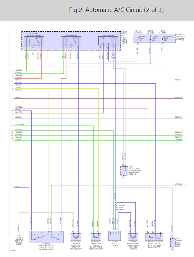

Check out the diagrams (below). Please run this test and get back to us. Let me know if you need larger diagrams for the wiring.

In answer to the R/F question, it is the Recirculate/Fresh Air button. So it is saying, to put the A/C system in diagnostic mode, without ECM test equipment, hold the Auto and that R/F button down concurrently while starting the Sequoia (or Tundra) and, as the flowchart posted above shows, it will put it in DTC mode. The temperature screen will show the Diagnostic Trouble Code, which you can Google or download a service manual to troubleshoot. As to the issue we have, the panel buttons and fan control knob do not respond at all, even when starting. Your finding the sticky rear control button was great! I replaced the relay. The controls still do not respond. I was about to get a new A/C control board until I read your note, Lindsay (albeit a couple years ago so you may not see this, but hopefully it'll help others). I am cleaning the rear sticky buttons now and [fingers crossed]. Thanks! :)
