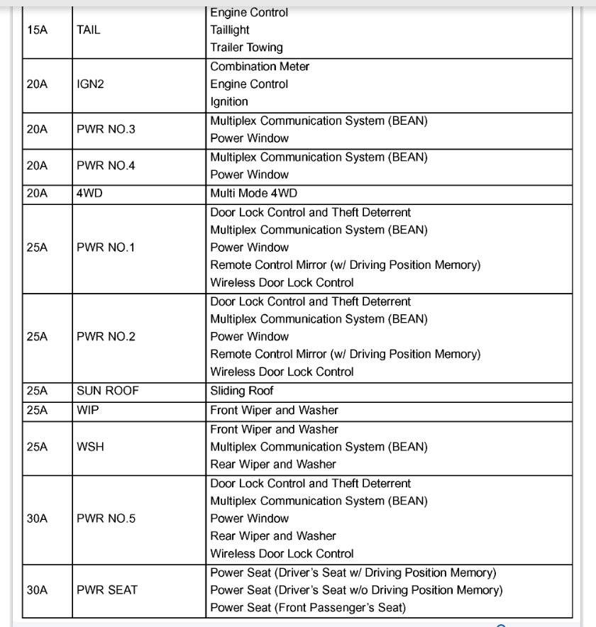

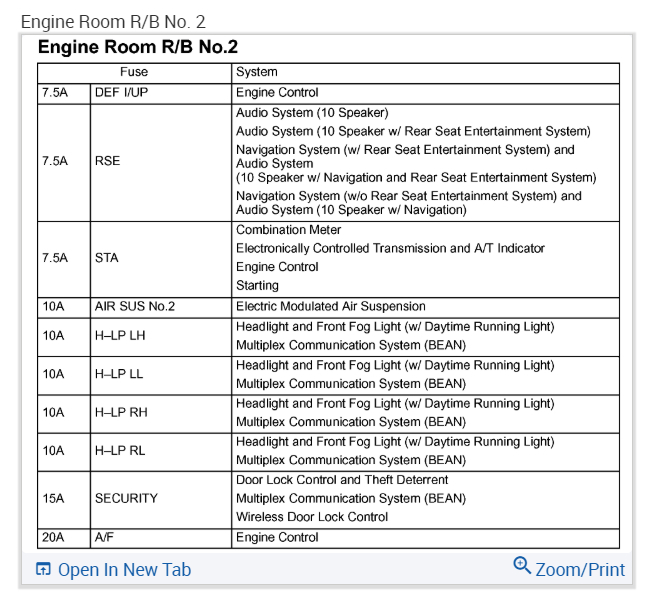

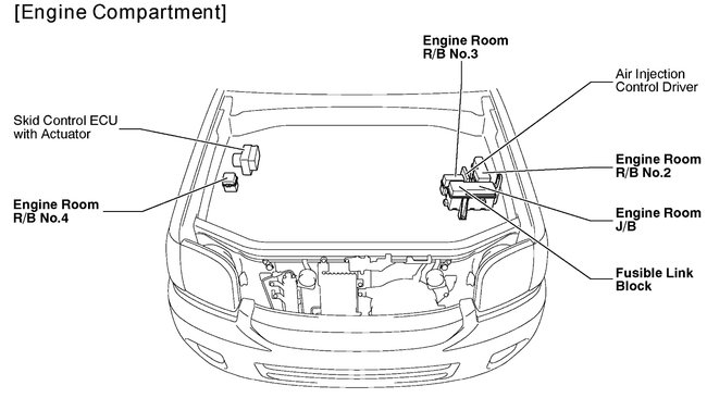

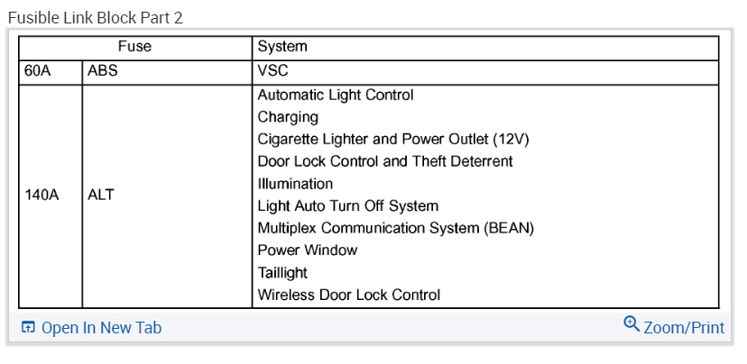

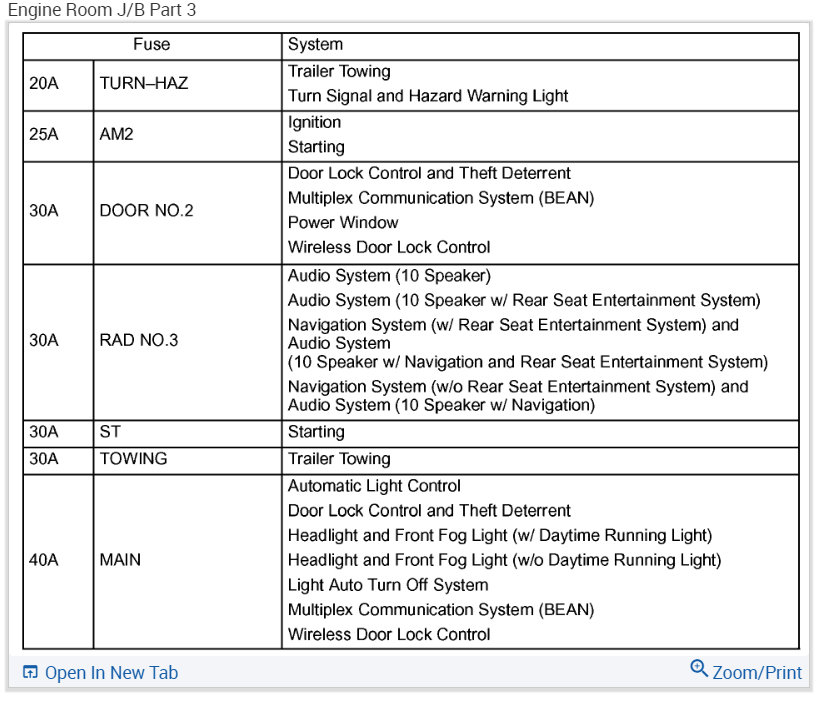

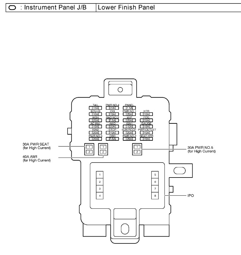

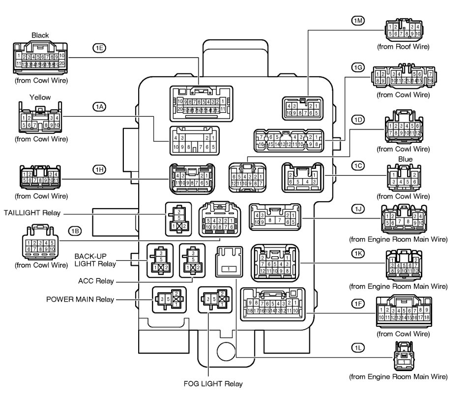

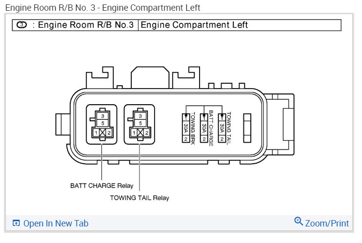

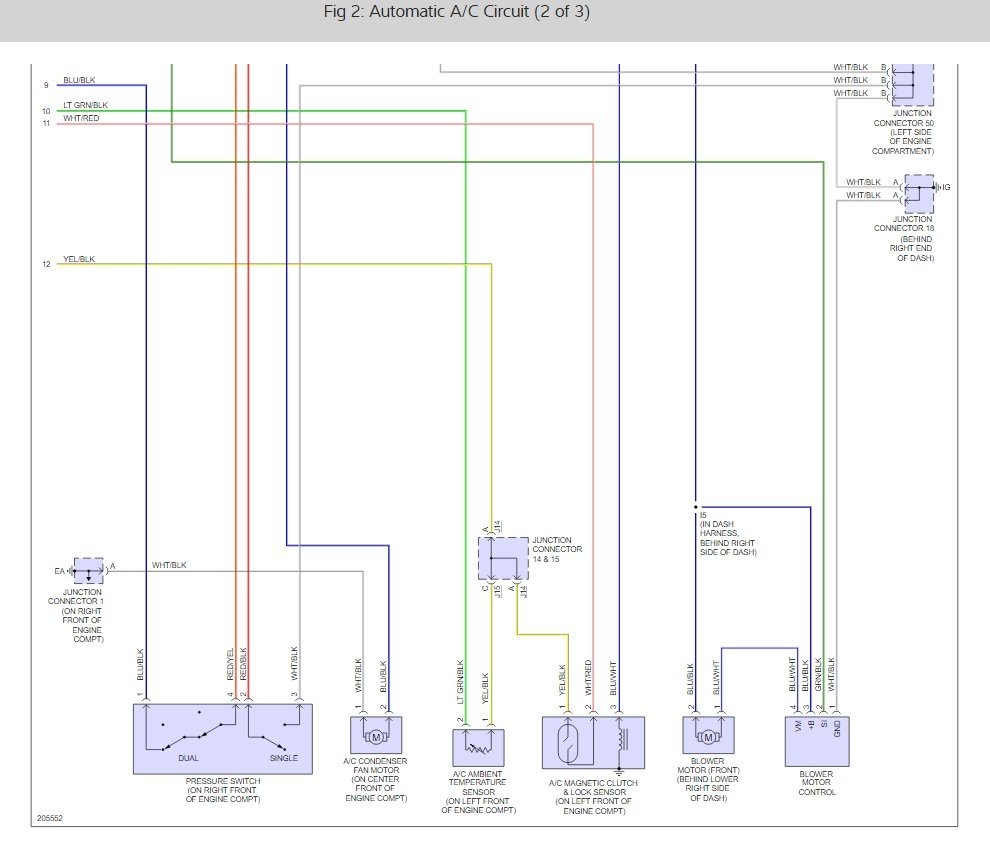

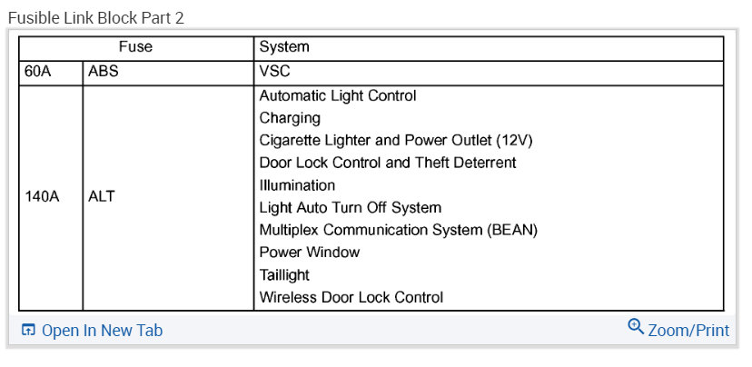

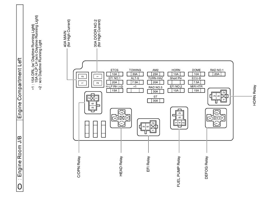

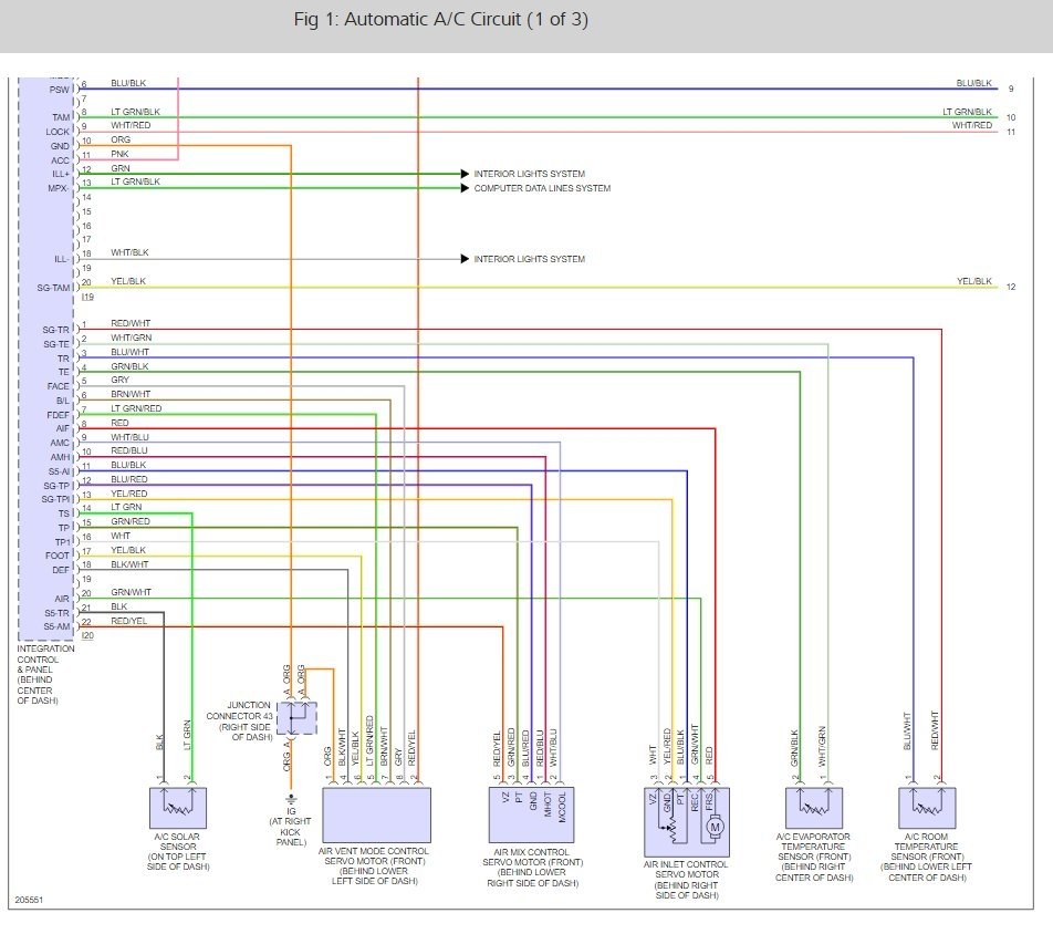

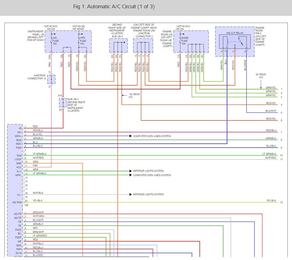

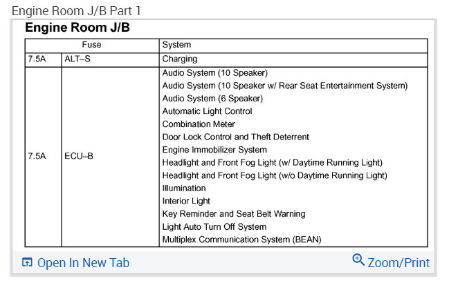

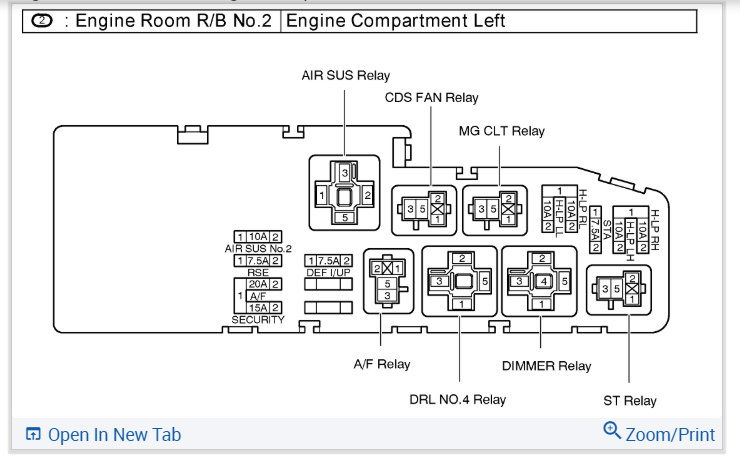

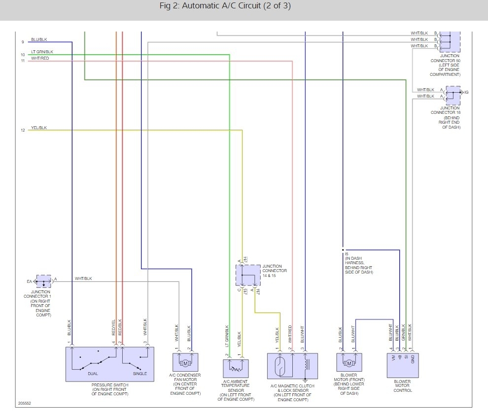

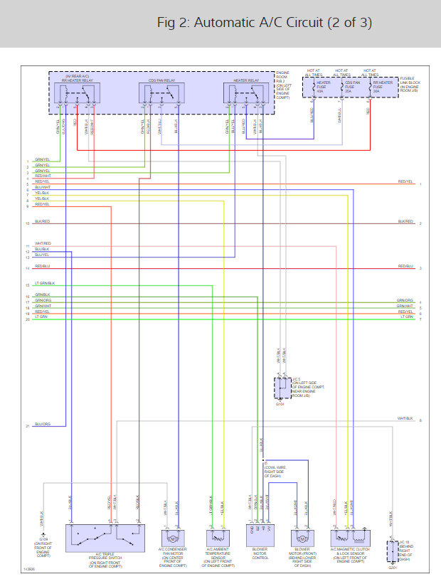

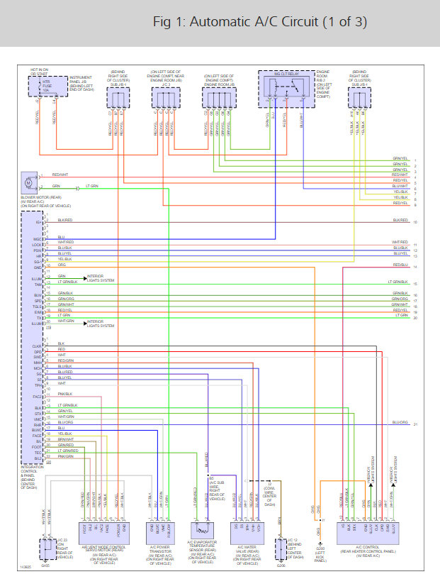

Is sounds like a fuse or the MG circuit control relay. Here are some guides and diagrams (below) to help you do some testing and get the problem fixed.
and
Check out the diagrams (Below). Please let us know what you find.
Jul 12, 2017 at 4:15 AM
BELTFED
  • 7 POSTS
Checked fuses and MG relay. all good so far

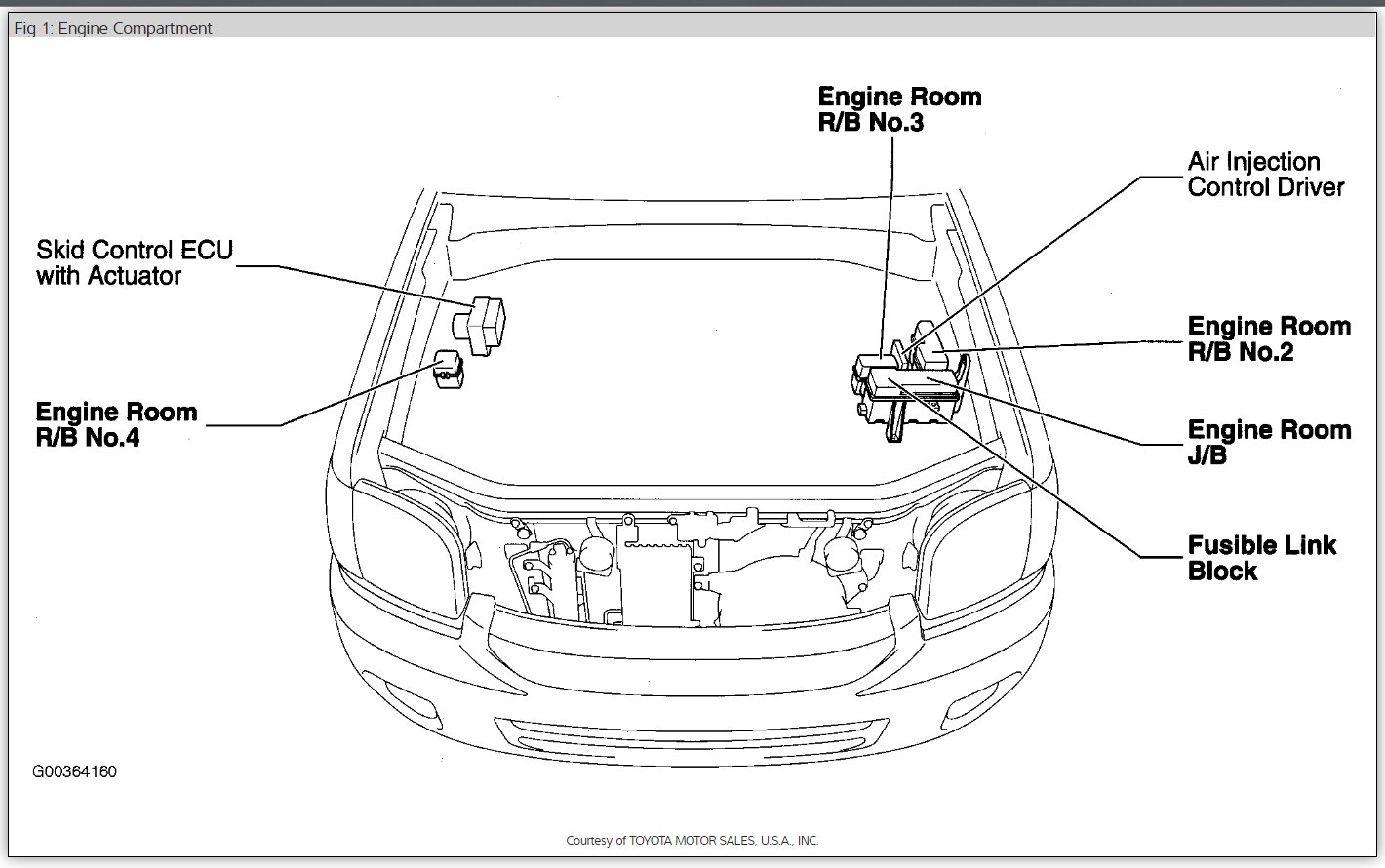

Does the system have power?
Check the A/C fuses:
Test the A/C control panel:
Check the A/C blower motor:
Inspect the A/C compressor:

Checked connection at compressor. No power
Jul 14, 2017 at 4:42 AM
  • 55,433 POSTS

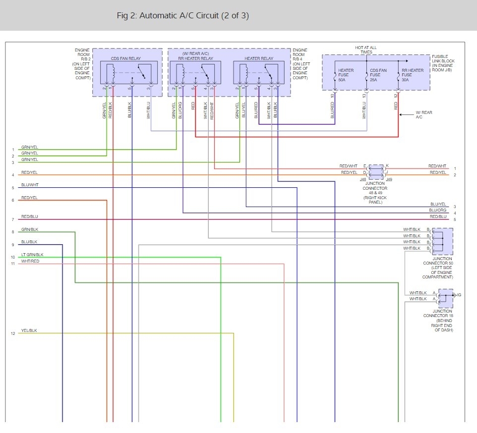

If the fuses are good and the relay is good, then you will need to check the wiring.
If this checks out then the controller is bad and needs to be replaced.
Please run some tests and get back to us we are interested to see what it is.

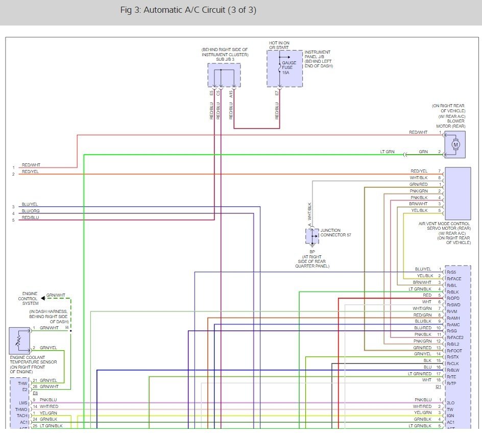

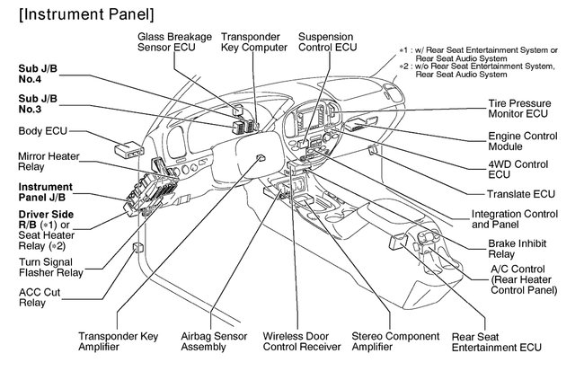

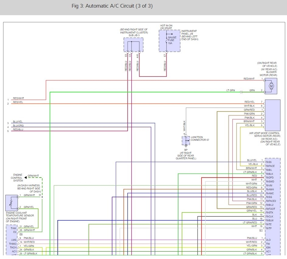

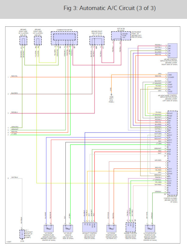

Is this referred to as the a/c integrated control panel? The a/c went out at the same time as the coolant temp gauge. After researching, it appears the coolant temp info is also sent through the same a/c integrated control panel. Does this make sense?
Jul 17, 2017 at 4:51 AM
  • 55,433 POSTS
Yes it sure does, it sounds like the control panel is bad.

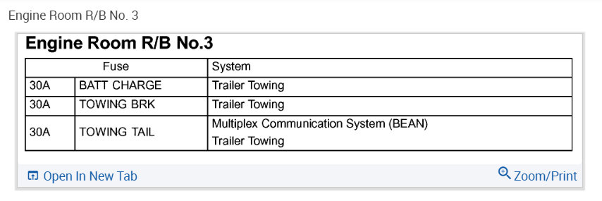

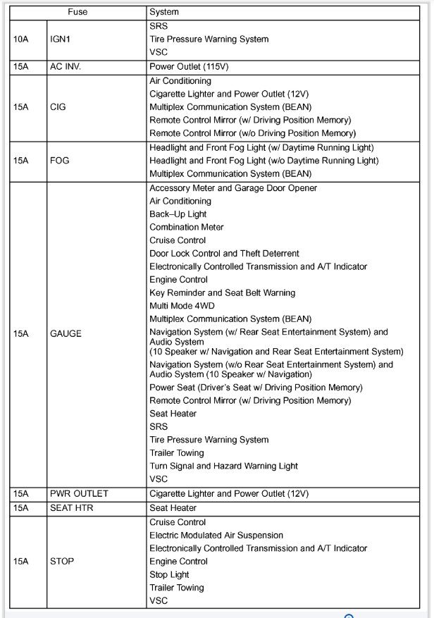

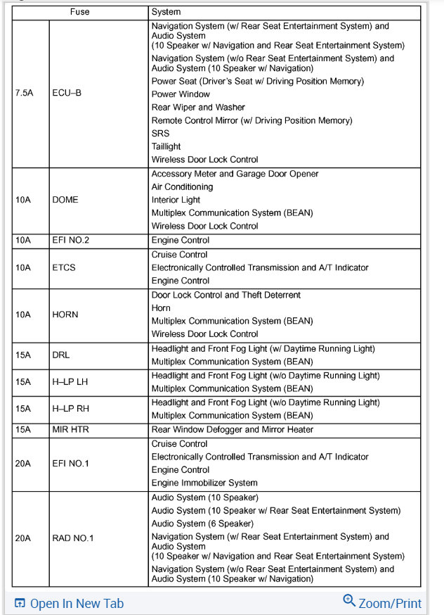

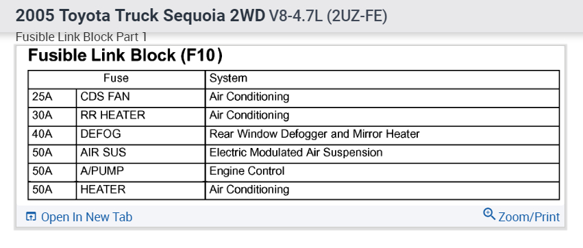

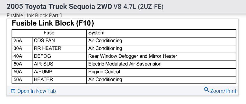

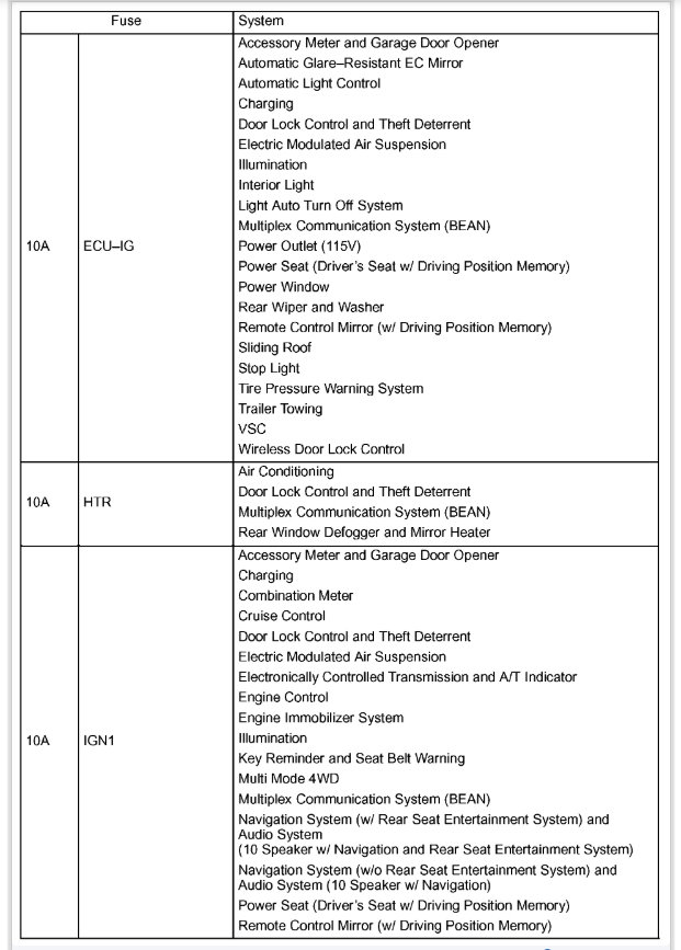

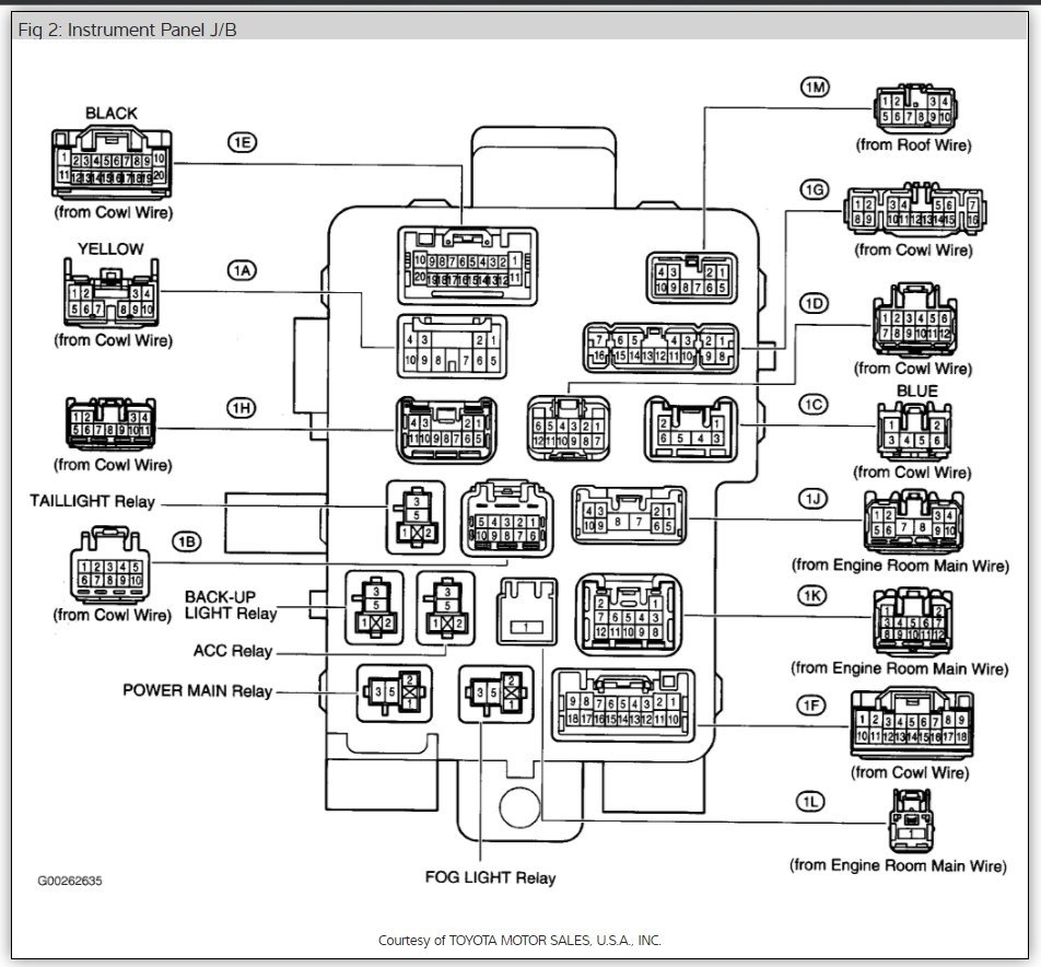

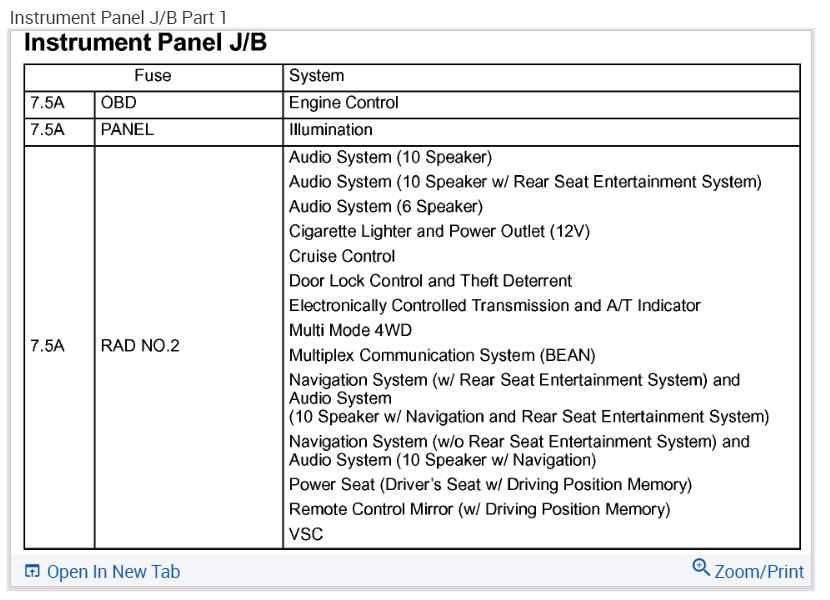

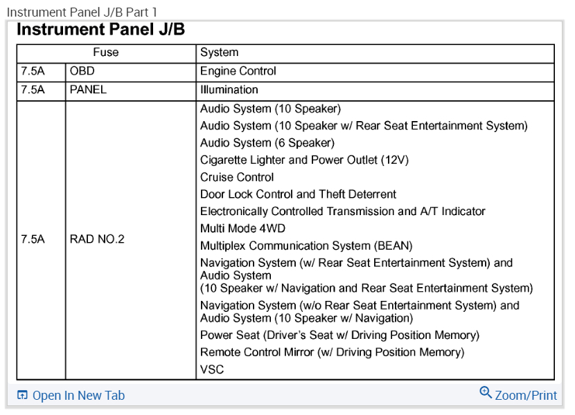

We need to check for power at each of the system fuses not that the fuse is good the test is for power at the fuse. here is a guide and the fuse locations. Htr, CIG, Dome, Heater, RR heater and COS fan.
Aug 19, 2019 at 9:13 AM
DAVID SPRIGGS
Took it to a shop today, gave them both units and explained the situation. They got back to me today and said that the harness is not giving power to the unit. So they found a short/broken wire near the connector and fixed it, everything works now.

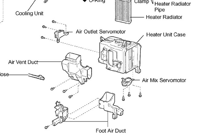

When I turn the temperature control **** to max cold...the heater control valve goes all the way to the top and cold air blows. When I adjust the temperature off of "max"...even by just one degree...the heater control valve goes all the way to the bottom and hot air blows. So it seems that it is either all up or all down. I assume it should vary to allow cooler or warmer temperatures to come through heater core. I guess the heater control valve is ok and the control cable is ok. So is my problem the temperature control electronic parts are something different?
Oct 10, 2020 at 2:29 AM (Merged)
HMAC300
  • 48,601 POSTS
in american cars they are actuators but in yours they are servo motors. I've included a pic see if they are working corrrectly, especially the air mix one
JIMDONSMITH
thanks for the quick response. Is there a way to determine if the problem is the servo or the actual control ****??
HMAC300
  • 48,601 POSTS
if it's vacuum turn the control toheat and see if you are getting vacuum. if you are and it's not working then it's the servo.if it's electricyou'll have to do the same but use a test light or vom
JIMDONSMITH
Ok. I still have no clue. I changed the air temperature control and the problem remains. What regulates the air mix servo? If it is only working from all hot or all cold...then a relay, resister or some sort of module must tell it to stop in the middle to allow the air to mix to "warm". Any information would be greatly appreciated.
HMAC300
  • 48,601 POSTS
it's controlld by the control unit that says hot/cold. if it's vacuum it's how much is sent to it and if it's electrical ther ewill b a module inside teh control unit for it.
JIMDONSMITH
OK....got it figured out. When I took car to dealership to have them repair the ignition switch, they unplugged the thermistor and never plugged it back in. It was located under the driver steering wheel behind the temperature sensor vent. I plugged it back in and it works perfectly. Thanks.

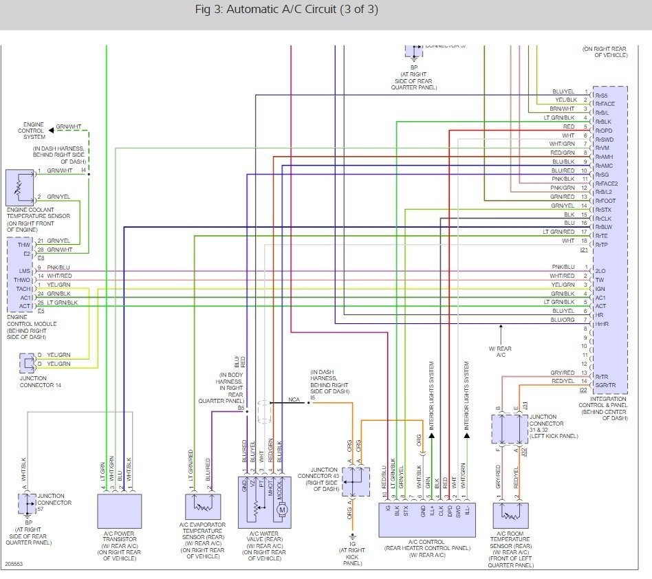

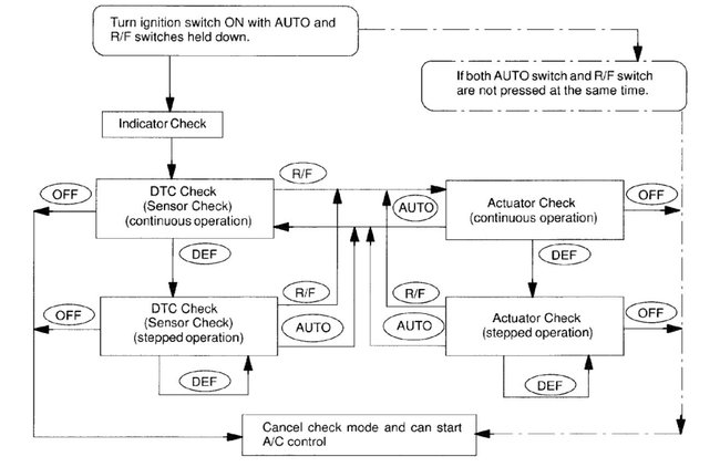

The diagrams illustrates how to retrieve trouble codes of the A/C system. Give it a try and let us know if there are any codes.
LINDSAY NEAL OBERG
What is the R/F switch?
  • 55,433 POSTS
Good question not sure. I would test the power and grounds.
Check out the diagrams (below). Please run this test and get back to us. Let me know if you need larger diagrams for the wiring.

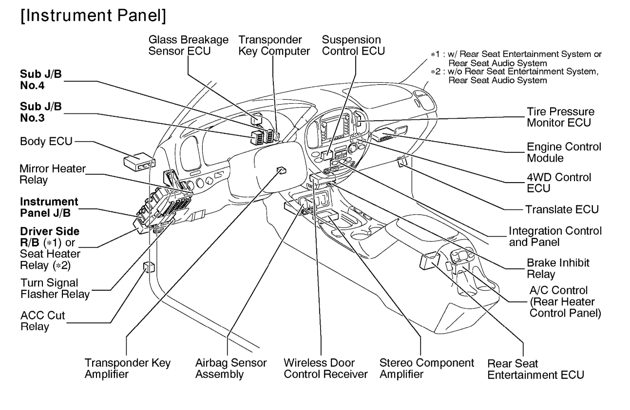

Fixed it. Rear climate control panel had some sticky buttons. Cleaned them up and front AC controls work.

Hi Lindsay. Not sure if you will see this message, as I don't think I can message you directly. But as I followed this thread, I couldn't determine what you actually did. I have the same problem. Did you simply clean the controls on the rear control panel?
  • 55,433 POSTS
Yes, the button will stick down causing the system not to work. You can clean them with soap and a damp towel. Can you please shoot a quick video with your phone so we can see what's going on? that would be great. You can upload it here with your response.
CURTISWEBB
Hi Ken, yes, it was the sticky buttons. I've cleaned them and the system now works. :)

In answer to the R/F question, it is the Recirculate/Fresh Air button. So it is saying, to put the A/C system in diagnostic mode, without ECM test equipment, hold the Auto and that R/F button down concurrently while starting the Sequoia (or Tundra) and, as the flowchart posted above shows, it will put it in DTC mode. The temperature screen will show the Diagnostic Trouble Code, which you can Google or download a service manual to troubleshoot. As to the issue we have, the panel buttons and fan control knob do not respond at all, even when starting. Your finding the sticky rear control button was great! I replaced the relay. The controls still do not respond. I was about to get a new A/C control board until I read your note, Lindsay (albeit a couple years ago so you may not see this, but hopefully it'll help others). I am cleaning the rear sticky buttons now and [fingers crossed]. Thanks! :)
