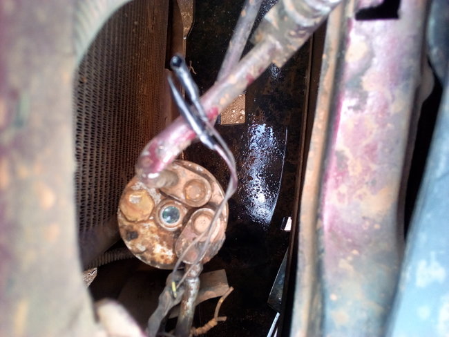

Hello Roy, thanks for all your support in troubleshooting my AC fault. I have been away for a couple of days, came back home today. I started the car and same thing AC clutch kick on. After several search for AC pressure switch, I found two wires close to the horn and dryer connected to each other I disconnect the wires and my AC compressor clutch released now my AC is no longer blowing cold. Could this be the wires for the P.switch? with my DMM test,one of the wires tested 4 volt and the other a ground probably from the ECU. Please how do I get my AC back chilling?
Aug 26, 2018 at 4:03 AM
Can you attach a picture of what you see?
Aug 26, 2018 at 6:25 AM
PROSPER DAVIDS
  • 27 POSTS
Those are the two wires they were connected to each other for what reason. I do not know I separated them and wrapped them with electrical tape to avoid any short circuit. If I connect them together, my AC clutch stays on.
Aug 26, 2018 at 8:49 AM

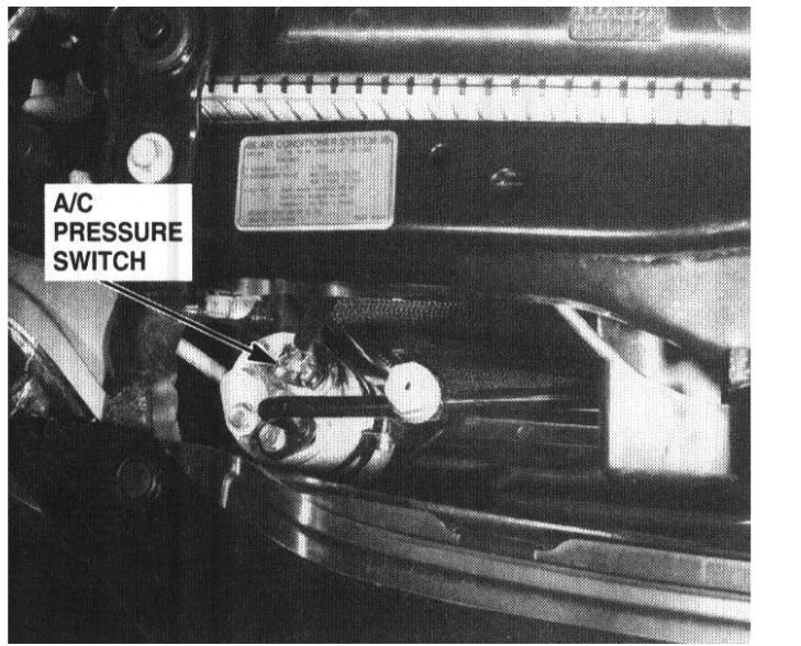

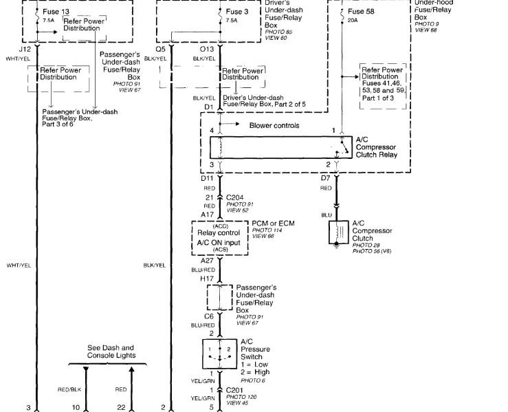

There should be a pressure sensor there. They were jumped to get the AC to work. When you disconnected them, you disabled the compressor.
You will need to get the low pressure switch and a pigtail for the switch and then connect the wires to that.
Aug 26, 2018 at 3:31 PM
PROSPER DAVIDS
  • 27 POSTS
Thanks a lot. I have left home for work to return by weekend I will get the pressure switch and the pigtail. Should I fix it on the dryer or along the pressure line? Thanks a lot I really do appreciate your prompt responses.
Aug 27, 2018 at 12:29 AM
The switch is on the line.
