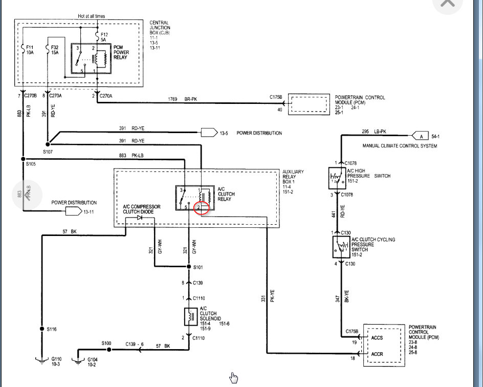

I just want to make sure we are on the same page because you are saying the signal wire but this is not a signal wire from the relay to the PCM. So in the attached diagram where it is circled is where you are getting -12 volts? If so, switch your leads and tell me what the voltage is.
This wire is not a 5 volt reference wire. It is actually a control wire where the PCM is grounding the relay which energizes the relay that pulls it closed. So if you have 12 volts then that proves out all the way back from the control module through the two switches, through the PCM and to the relay. You need 12 volts here when the AC is on to close the relay and turn on the compressor.

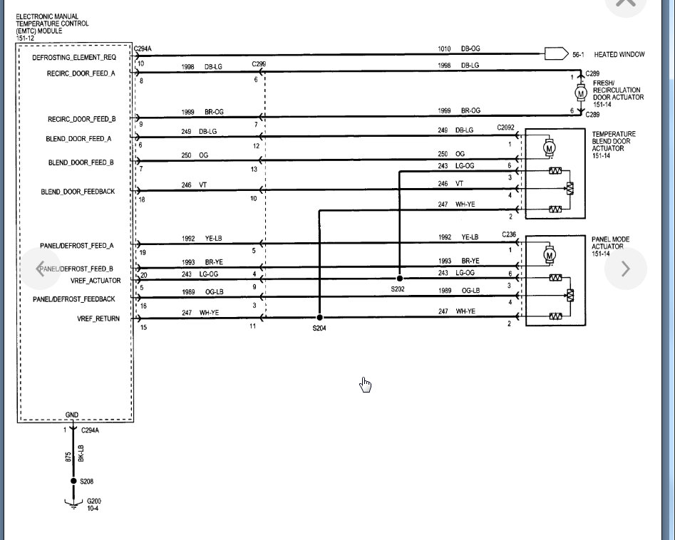

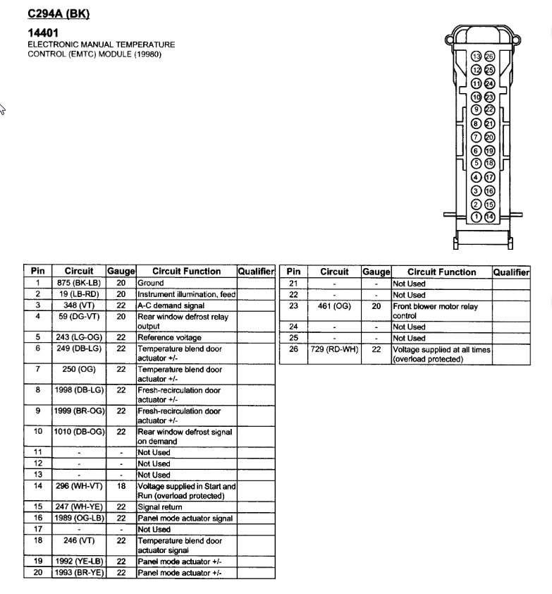

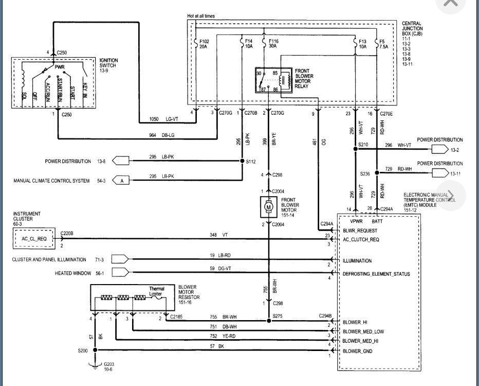

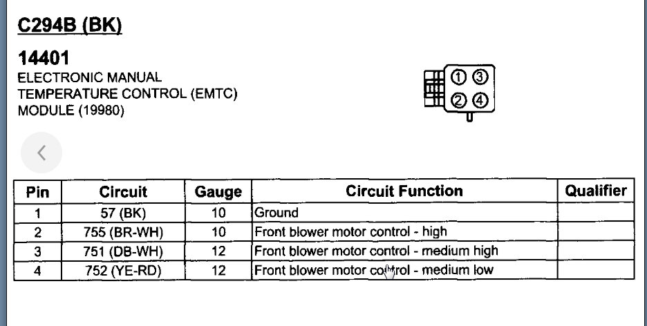

I also attached the connector views for the manual HVAC and the wiring diagrams.

Yes, the location you circled in red. I thought it was direct from the HVAC control module and the ground side was from the PCM. I can now see in the diagrams I was incorrect. I'm getting -12 at that location on the compressor relay with the MAX AC switch on, the system charged, and a new low pressure (cycling) switch. I'm going to work on the truck tomorrow with the diagrams you have provided. I thought the relay only needed 5v to close but I see you are saying it needs 12v.
