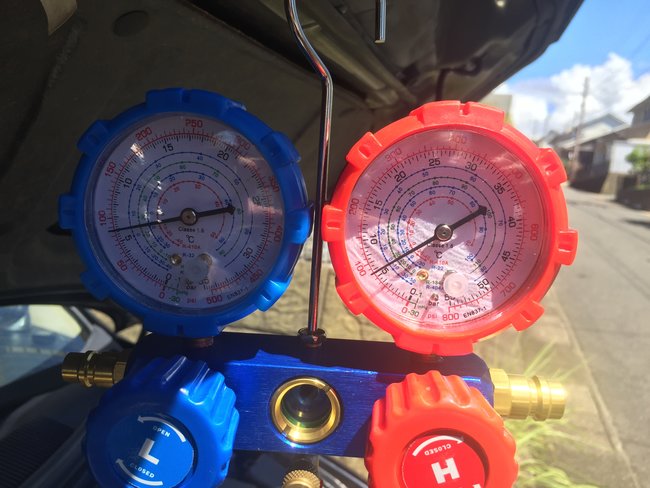

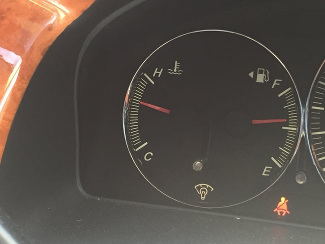

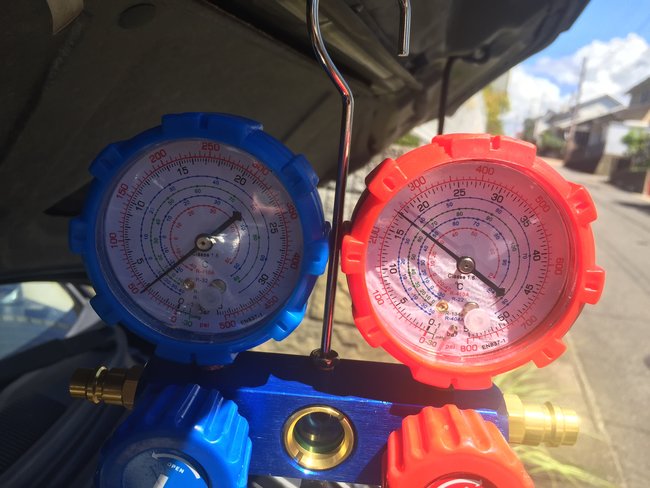

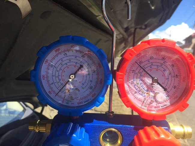

Sorry for taking so long to reply. I had to order a gauge and it took forever to get here. I have taken some photos of the readings on the gauge at idle (700 rpm) and at 1500 rpm. And just in case I am also including one with the AC off. I was not able to get a reading when the clutch disengages while it was running. However, when it occurred on a recent drive, I took a picture of the engine temperature if this helps. Also when there are no issues with the system it blows out very cold air.

If the third picture is with it running, that is why it is not working or cutting out. The low-pressure switch will cut out the compressor at 20 lbs and below.
What about the high side pressure? I told you I needed both sides?

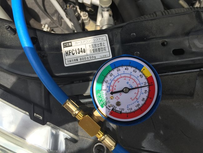

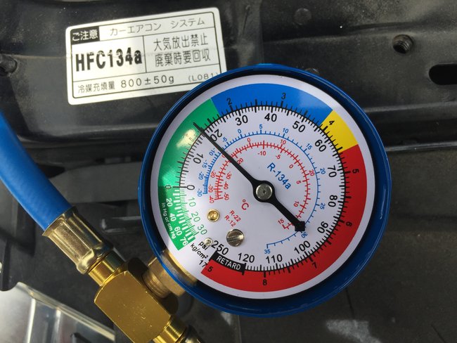

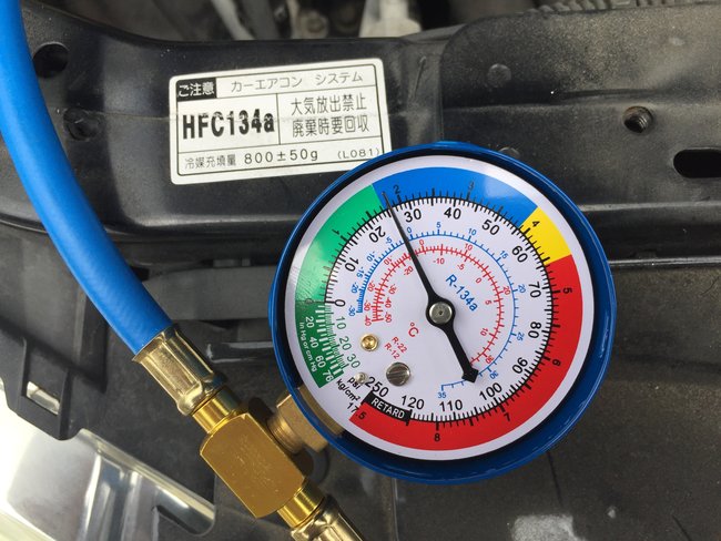

I was finally able to get the measurements. I have attached the pictures. They are in order.
1) Engine off.
2) Idle .
3) 1,500 RPM.

Okay, I would start by removing the Freon and evacuating and charging the system with the correct amount of Freon.
From the readings you provided, either it is low in Freon or the expansion valve is bad.
