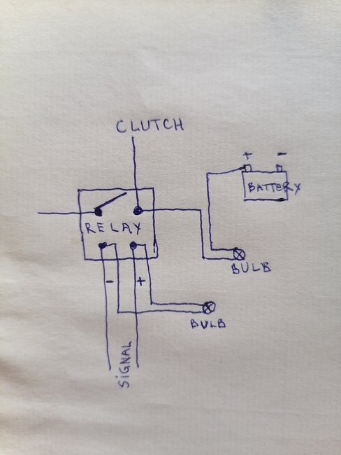

Tonight, I plan to make some electrical inspections (to be sure if the clutch connector and relay are okay).
I'm going to connect small bulb to the clutch relay power supply and lead it to the cabin (with thin wire) to be able to see if the system cuts out the power to the relay, or maybe the relay cuts out itself.
Aug 25, 2023 at 4:50 AM
WISH30
  • 124 POSTS
I quit my plan with bulbs, because I made some connection as showed on the diagram (with small dash bulbs) thinking that when relay receive power first bulb will turn on, and also the second at the same time when it is connected to ground with the closed contact of relay.
(That plan was to check if the relay is losing power from the system, or it is losing contact on switching terminals)
But in reality, something is not as I planned in theory. When I turn the ignition both bulbs turned on, and when started AC, both bulbs turned off :)
Next idea was to try with swapping horn and clutch relays and give some try of couple of days to see if problem still occurs, BUT it was also not possible in practice as in theory, the clutch just turned on and off immediately and then did not come on again. The relays are the same model, but of AC is blue color 30A and of horn is brown color 20A.
Then I turned back to the original position, so today I plan to mechanically open the clutch relay and gently clean the switching contact points and give it a try for a couple of days. If the problem still occur, will ask some AC mechanic to measure the high pressure if it is in the normal range.

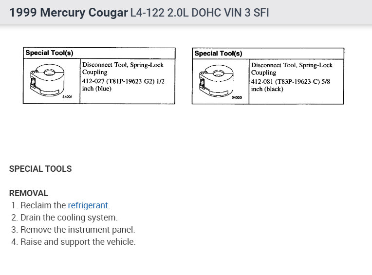

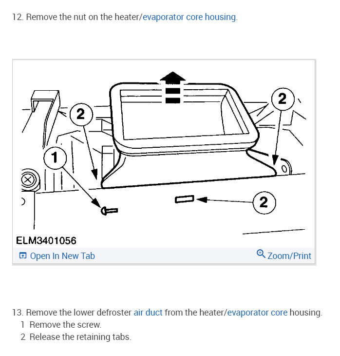

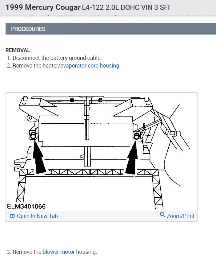

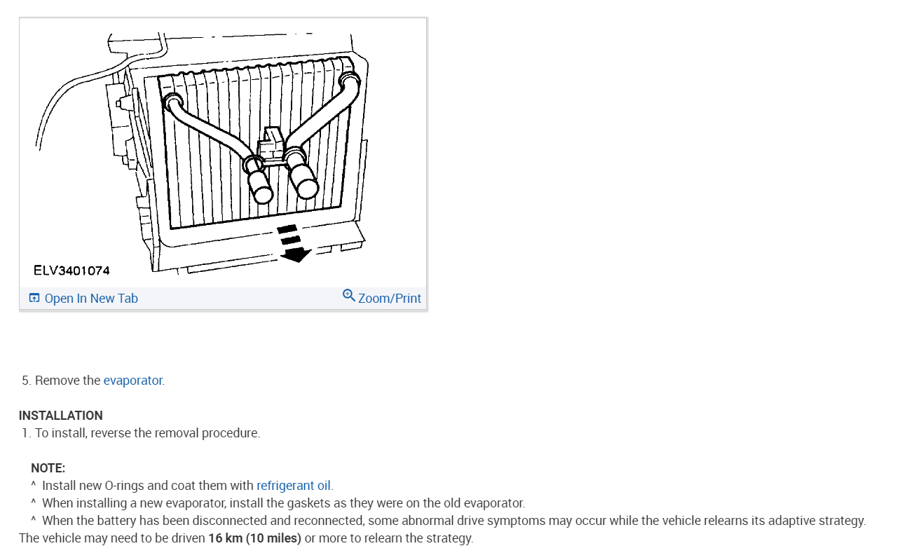

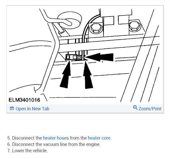

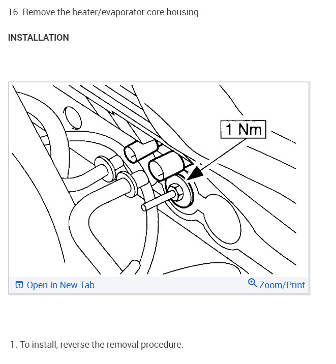

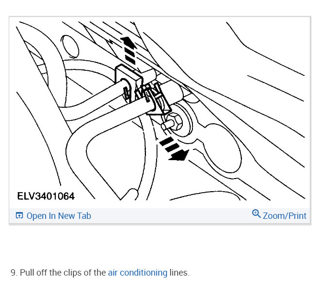

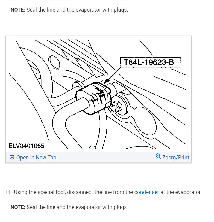

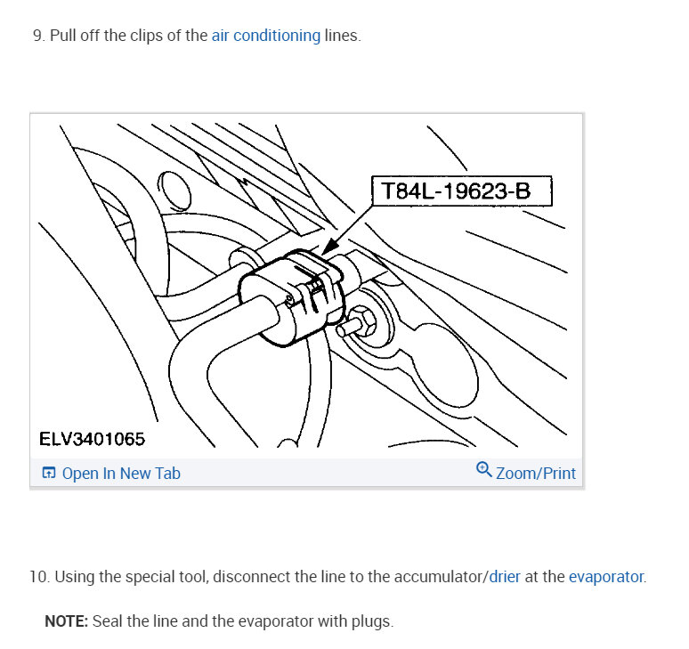

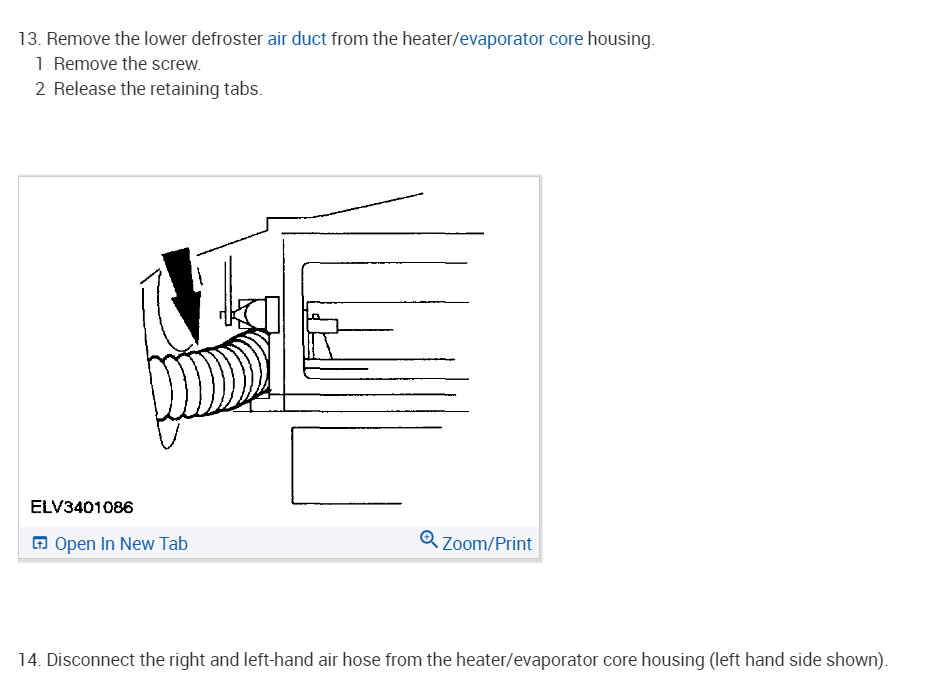

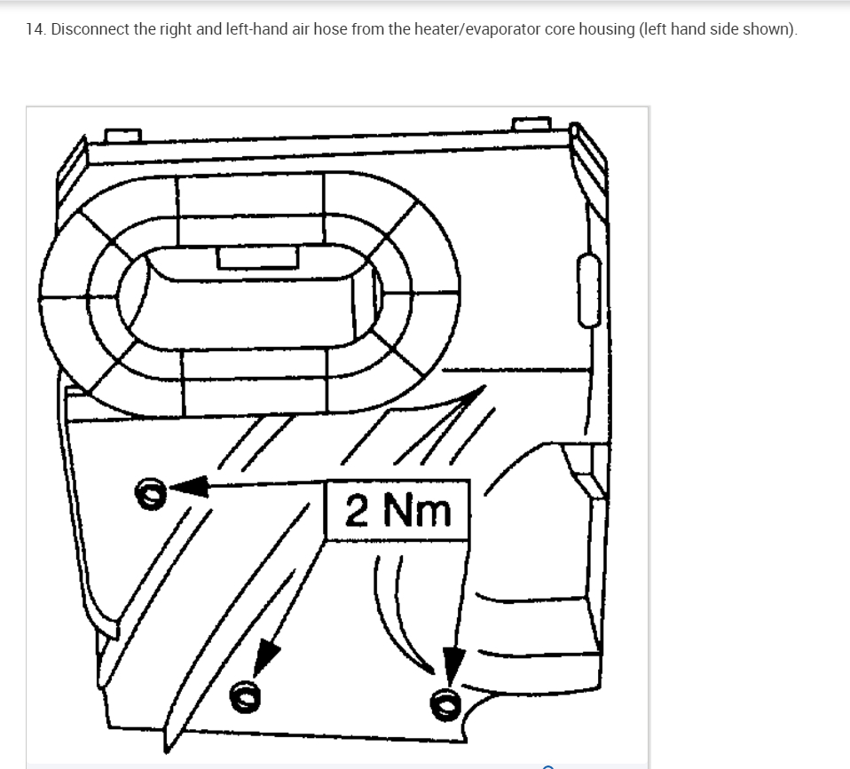

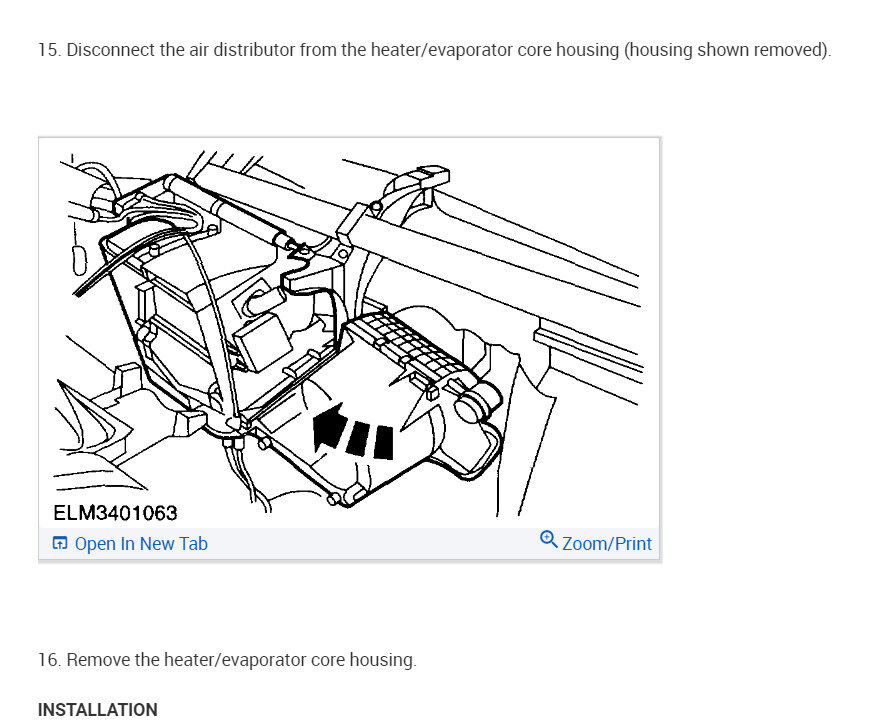

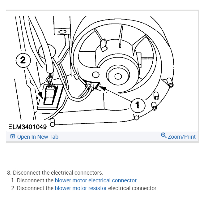

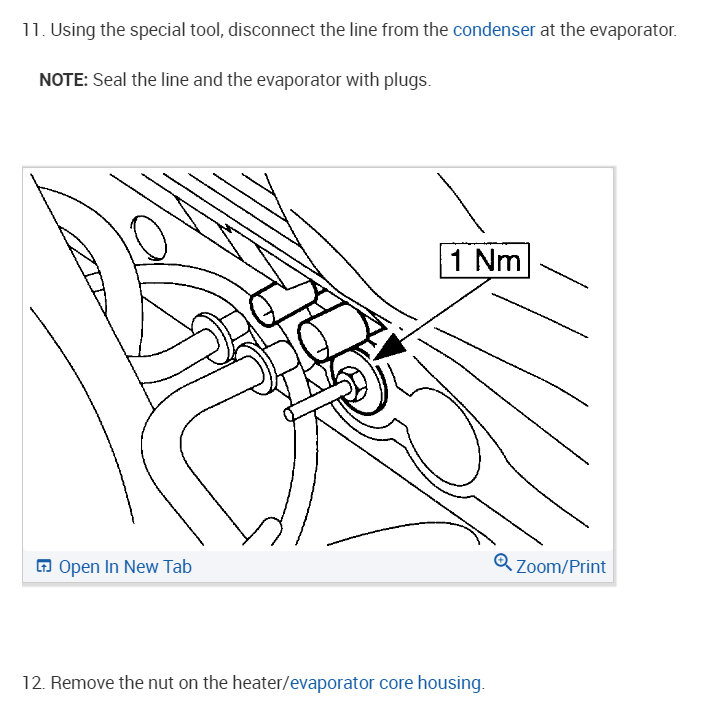

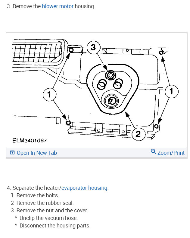

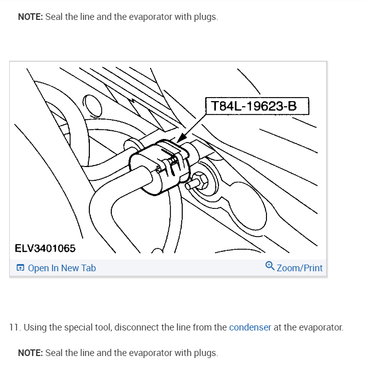

In the between-time I would like to ask you if you have evaporator location or removal steps diagram, because if they tell me the same, next step must be to try to reach the evaporator and bring the car to a mechanic to be replaced.
I often think to sell the car, but now I am deeply underwater, because I bought it $1,500, and could sell it not more than $1,200 300, but in these 3 and a half years I spent over $3500 to get nothing :(
Sep 15, 2023 at 1:33 AM
  • 55,399 POSTS
Yep, that is rough, here is how to remove the evaporator. Check out the images (below). Please let us know how it goes.

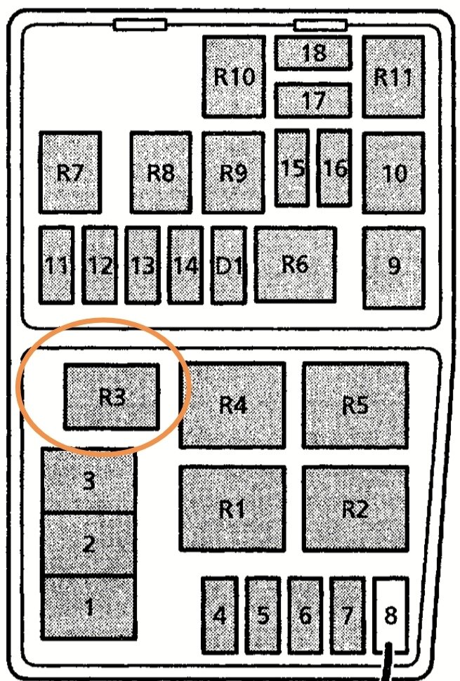

It was daytime and a lot of traffic, I am not 100% sure. Tonight, I drove in very calm conditions because there is almost zero traffic at night, and the cycling is the same, about 10 seconds when driving, when stop it is continuously running on idle. So, my logic is that it cannot be true that "evaporator is freezing so that's why compressor shuts off" because if it freezes, it will also freeze on idle. I have no more idea what to inspect anymore.
Sep 23, 2023 at 10:35 AM
WISH30
  • 124 POSTS
Any advice on what step can I make on my own? I have no more where to take the car. :(

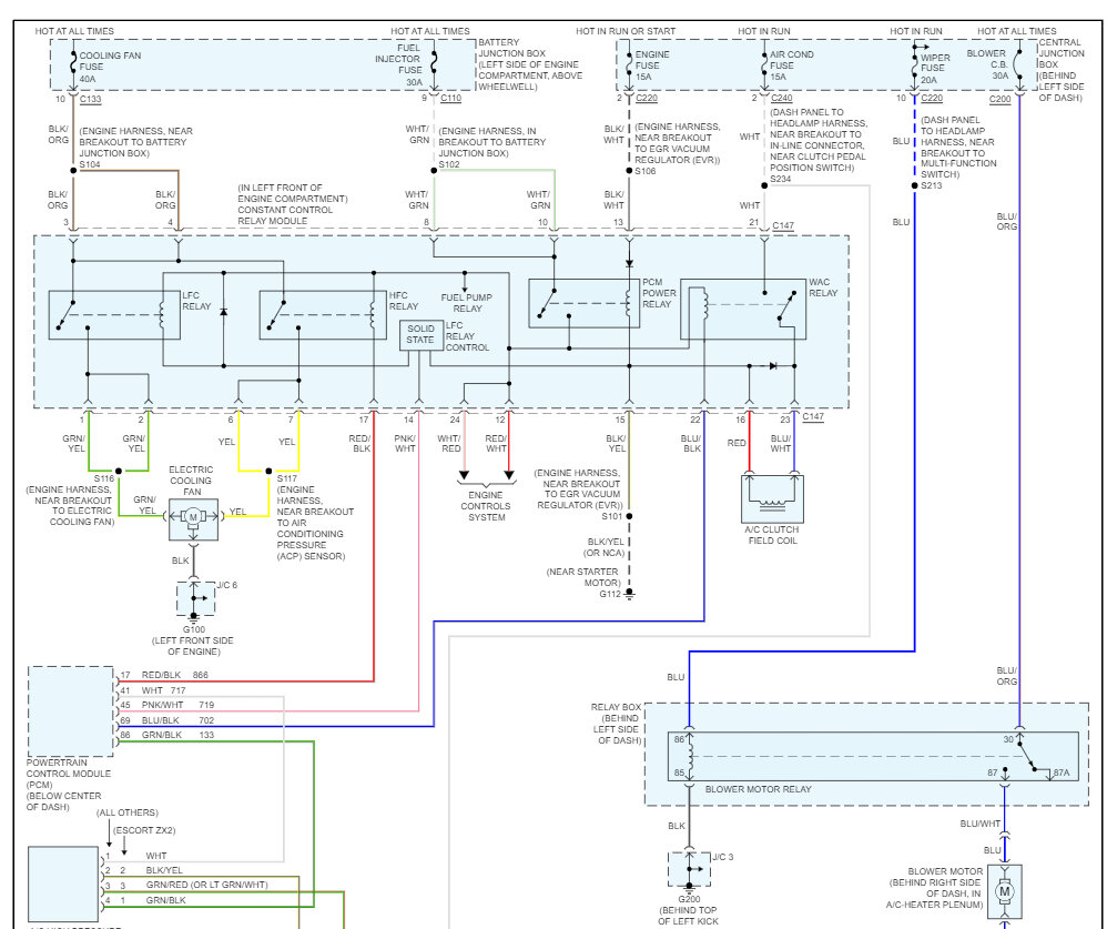

This period I didn't drive the car, but tonight I will make the same inspection again.

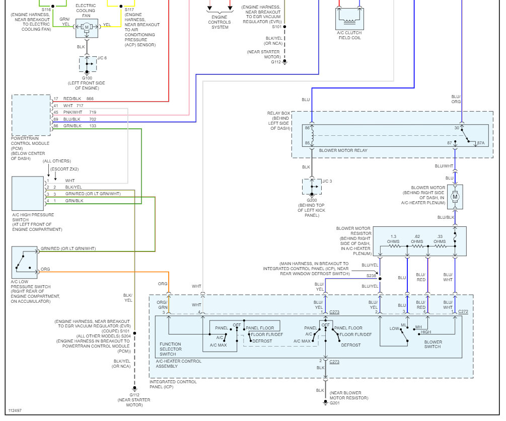

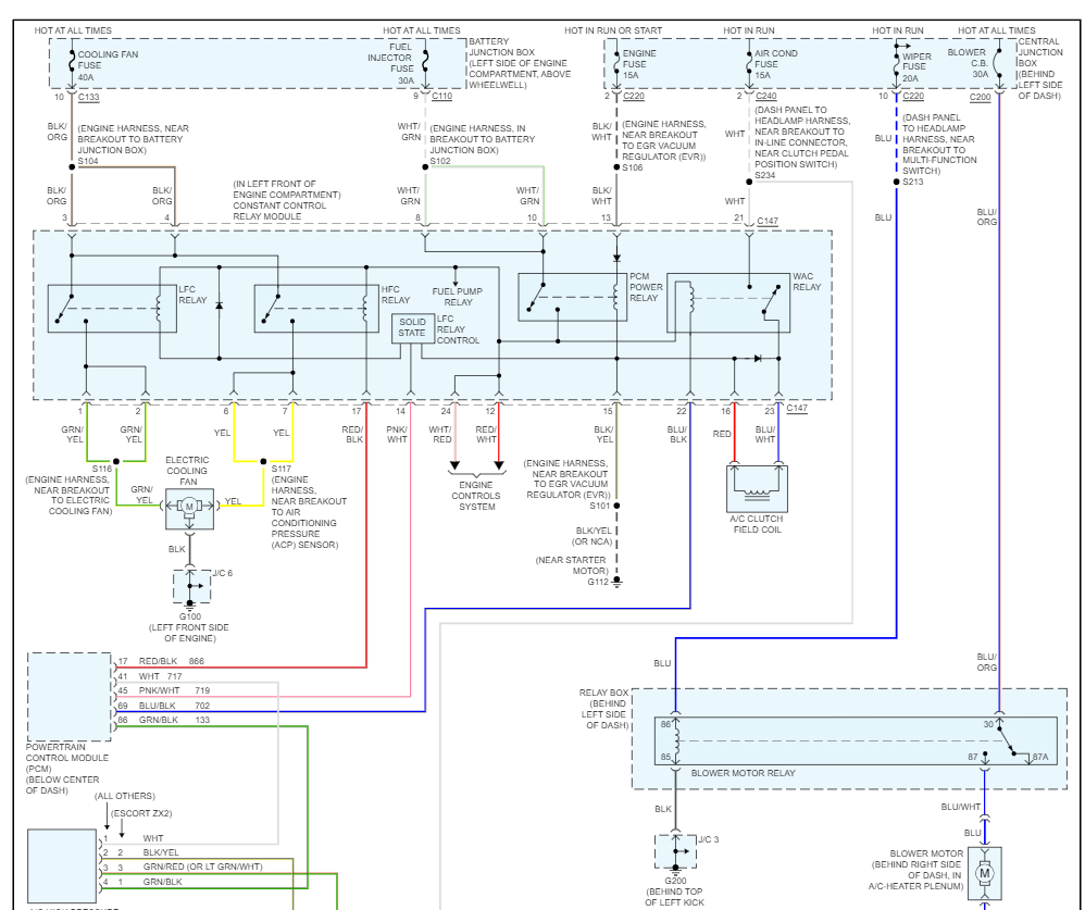

Outside temperature was 16°C (if that matters something). My small dash bulb is wired to the power source of R3 that is a clutch power relay. It is normally closed, so when energized it opens the contact.
Ignition on and bulb lights, push A/C button and bulb shuts off, the compressor runs.
Tested on both options (temperature set to hot - 25°C and temperature set to Lo), when stay in place on idle, the bulb stays off and clutch is energized all the time, start drive, it cycles on every 9-10 seconds.
Also made a test in place on idle, pressing the gas pedal, clutch shuts off after 2-3sec.
Ran the car in free motion (idle) on down warded street, clutch stay on.
Ran again on down warded street in gear (2-3) without gas, clutch still on. Pressing gas, start cycling.
In a moment of time, I got some conclusion on my mind maybe there is some reason in WOT circuit, but as I can search, there is no WOT relay on diagrams (thought it could be the same relay with both functions but different sources of control).
In the attachment there is a diagram picture of the power distribution box.
Please stay with me just a little more time in these hard moments for me, I don't have anyone to consult. It is not about the perfection of this scrap of a car, but about solving something so simple that it looks like a big mystery to our electricians and mechanics.
Thanks in advance and best regards from North Macedonia!
Oct 12, 2023 at 6:36 AM
  • 55,399 POSTS
It could be the relay for the compressor, or the compressor clutch. Have you changed out the AC compressor relay?
