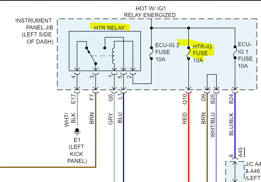

Interestingly, the relay and fuses are in the vehicle. See pic 1 below. Note: It says htr fuse, but that also powers the ac switch. Battery voltage to the compressor is then provided via the AC amplifier.
Let me know what you find.
See pic below.

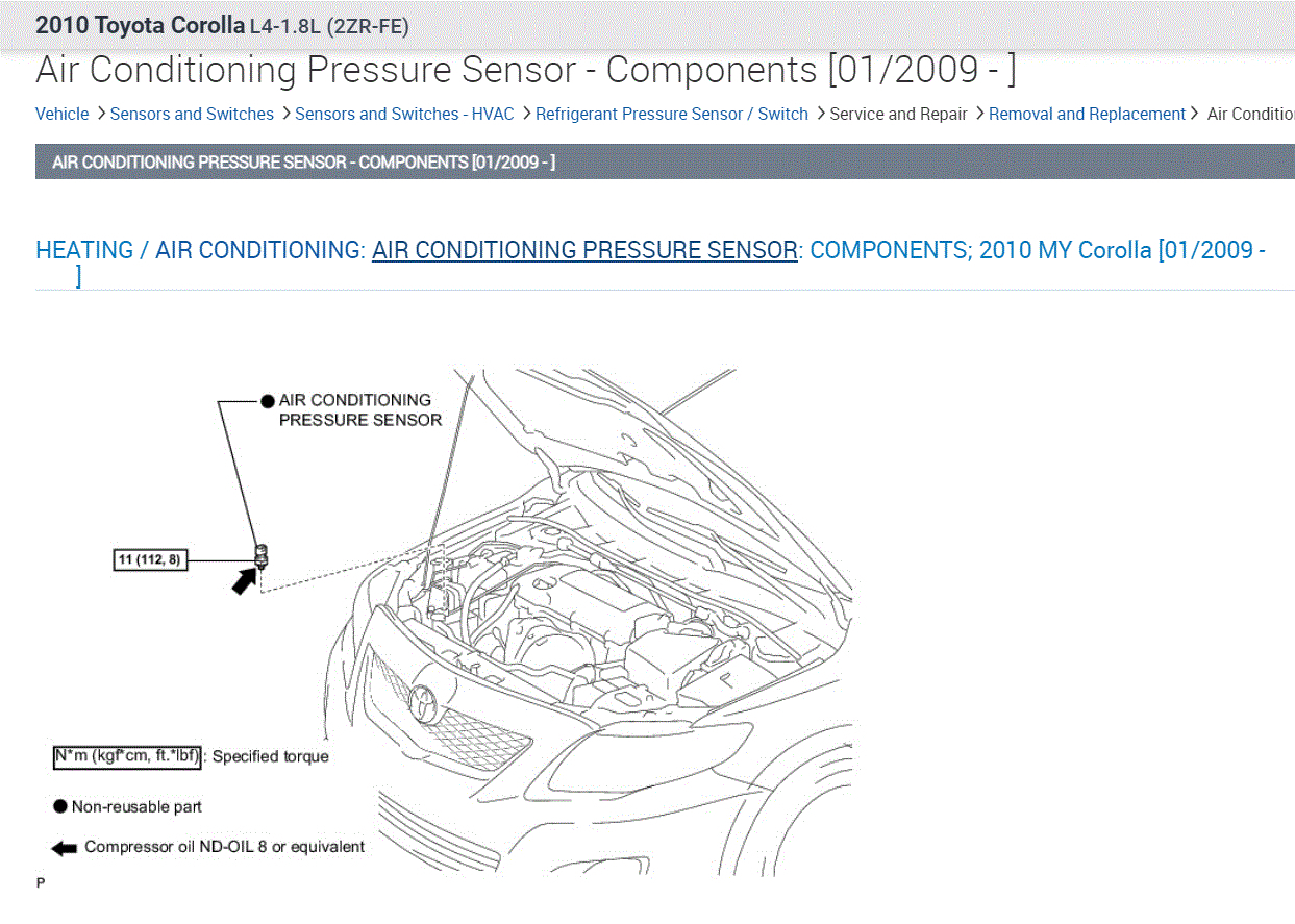

I've learned that a malfunctioning low-pressure switch can cause the clutch to not engage at all. In the engine compartment I found the high-pressure switch on the liquid line, but I do not see a low-pressure switch on the vapor side. I found the drier attached to the condenser coil and learned that it holds a desiccant bag. Isn't there supposed to be an accumulator on the suction side? If so, I don't see it in the engine compartment. Could the accumulator be on the passenger side of the firewall with a low-pressure switch coming off the accumulator? I've looked for this information online and haven't found it yet. Can you help me find the location of the low-pressure switch?

I believe there is only one pressure sensor if I recall on this vehicle. I attached a pic below.
Is that the one you are referring to?
Also, if you are getting power to the compressor and it has ground, something there has failed. Some of these don't have a traditional clutch, instead, there is a clutch solenoid that actuates the system.
