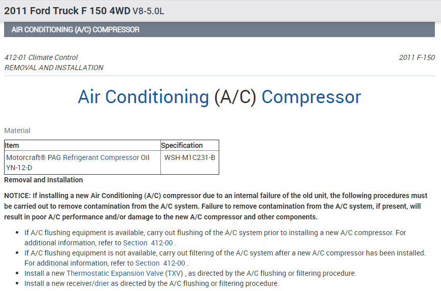

I would like to replace my ac compressor as it it defective. I would like to use the AC. Is it possible?
Mar 21, 2017 at 1:45 PM
DANNY L
  • 5,648 POSTS
Hello, I'm Danny.

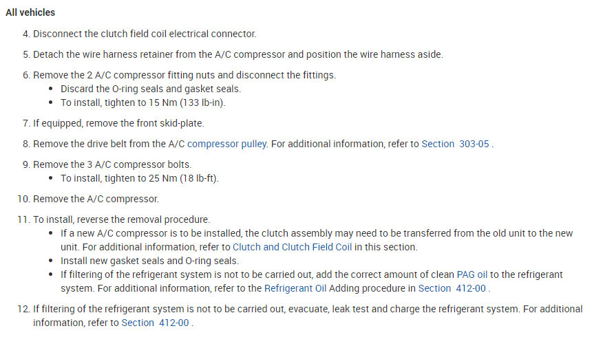

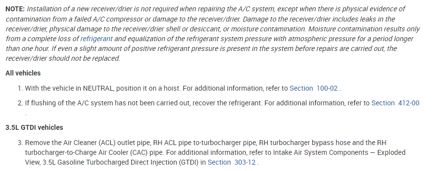

Here is the information you requested, Yes, It's possible and we're here to help. After removing and replacing the ac compressor you will need to vacuum the system and recharge as well. Here are tutorials showing how to replace the compressor and vacuum-recharge the system:
https://www.2carpros.com/articles/replace-air-conditioner-compressor
I've attached picture steps below on how to remove and replace the ac compressor on your truck. Hope this helps and thanks for using 2CarPros.
