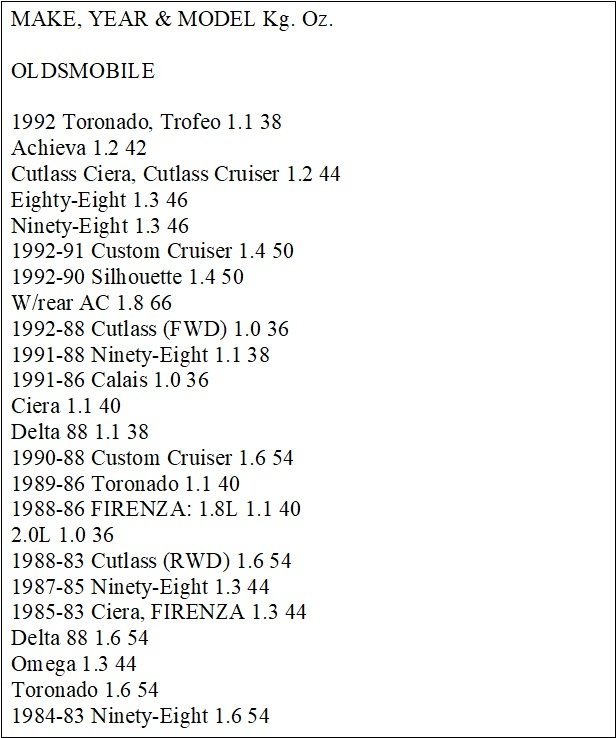

How much r134a Freon am I supposed to put in a Cutlass Cierra Oldsmobile?
Compressor kicks on after I put one pound in, but I'd like to know how much goes into it.
Mar 30, 2022 at 5:14 AM
CARADIODOC
  • 34,369 POSTS
This chart shows 40 ounces. This model should have come with R-12. Only put in R-124 if someone previously retrofitted it. If that has been done, you'll find the correct ports to fit the charging hose. The oil will have been replaced too to one that's compatible with R-134.
