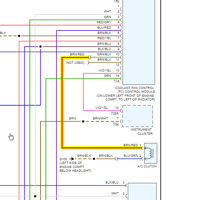

A/C compressor not coming.Change fan control relay .That is mounted under the battery. I check all the fuses okay. A/C system charge up with Freon. Still not working. what could be the problem?
May 21, 2020 at 6:13 PM
We need to start with checking for power at the compressor clutch. If you have power when the A/C is on then most likely the compressor has failed. However, if you have no power then either a power supply issue or you could have the system overfull. If that is the issue the pressure switch could cut off the compressor. Also, there is a chance that the pressure switch is the issue.
Let's start with checking for power and go from there. Here is a guide that gives more detail on this issue:
May 21, 2020 at 6:24 PM
WESTRUCK
  • 55 POSTS
Thank you. The pressure switch fixed the problem.
