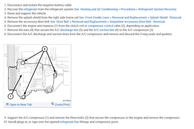

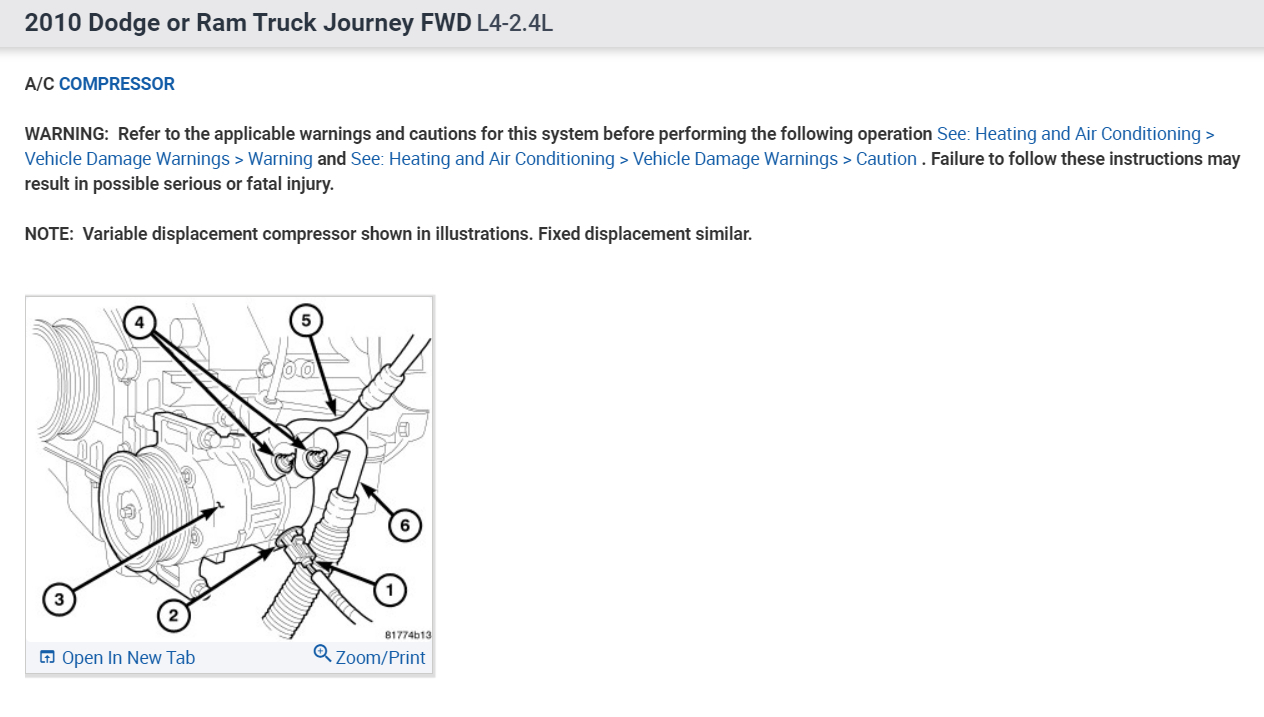

Hi, I am just wondering how you would remove an A/C compressor on this vehicle.
Nov 6, 2022 at 7:54 AM
  • 55,770 POSTS

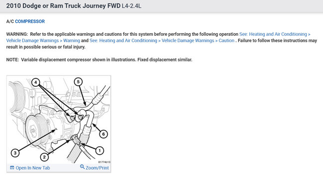

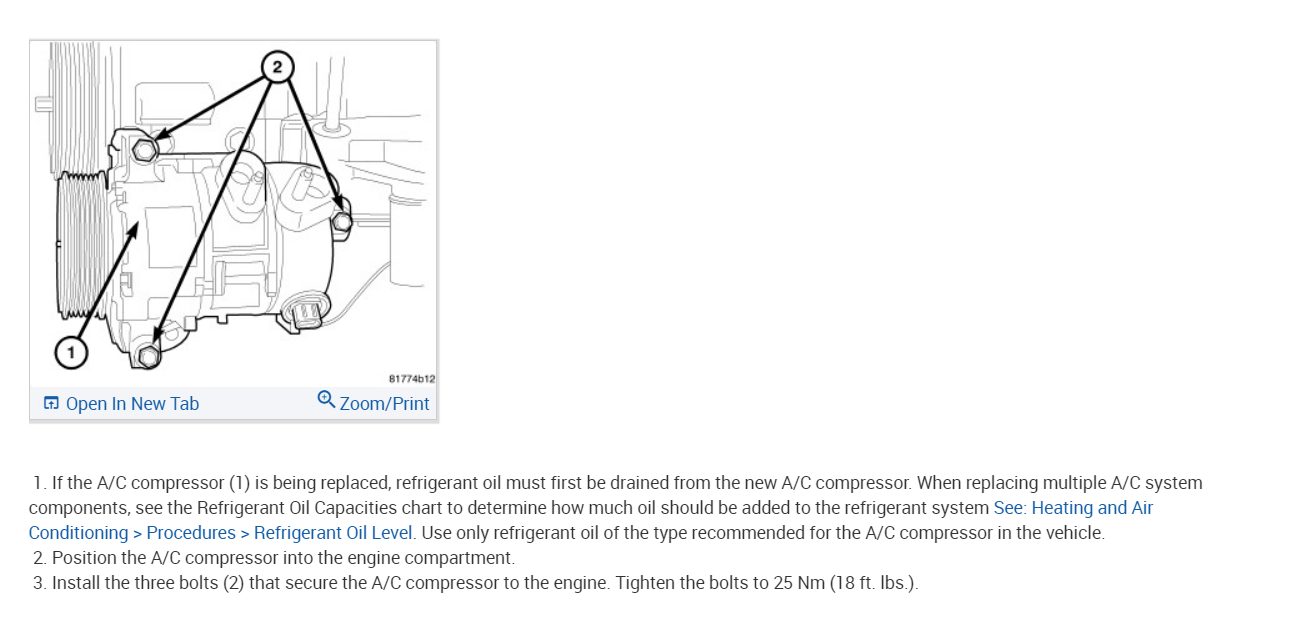

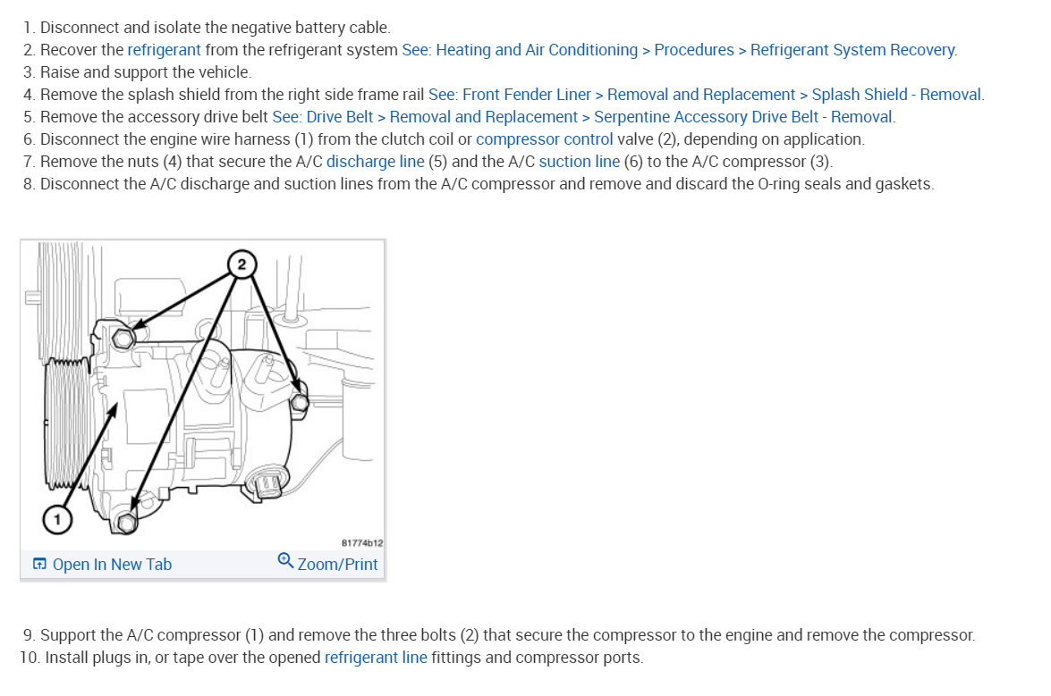

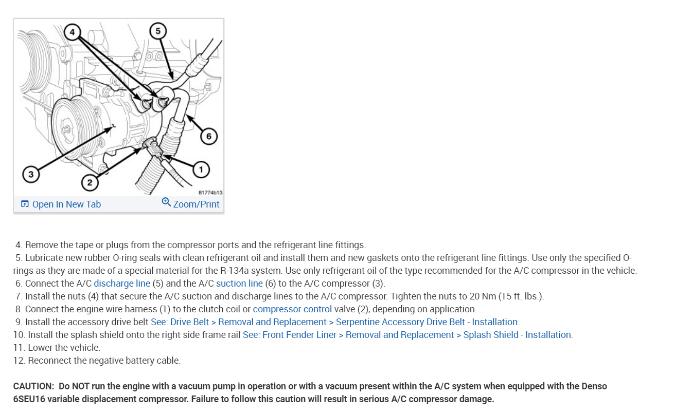

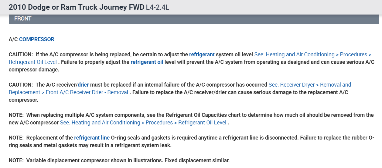

Here is a guide to help walk you through the repair with instructions in the images below so you can see how the job is done on your car. Also included is how to vacuum down and recharge the system as well.
Here is the generic guide:
https://www.2carpros.com/articles/replace-air-conditioner-compressor
Vacuum down and recharge video.
https://youtu.be/4EqdrBVb0sY
Check out the images (below). Please let us know if you need anything else to get the problem fixed.
