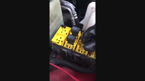

My vehicle listed above A/C Clutch is not engaging without bypassing it using a paperclip in the Relay. This allows it to blow cold. The A/C Clutch Relay Fuse under the hood was replaced and didn't fix this issue. The vehicle had A/C when I bought it and it was fixed once. Had a leak and was patched with no additional work added. After it was patched, it blew cold, but it took a while to get there. Approximately 2-5 minutes. My guess is there isn't enough Refrigerant 134a to allow the ac to kick on (A/C High/Low switch but I don't want to refill it for it not to work still.

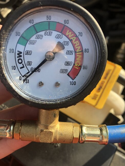

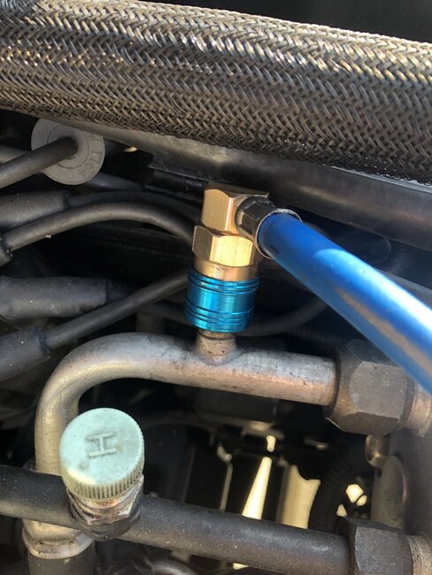

Howdy, thank you for the reply. My vehicle also has an overheating problem at the moment. I've changed the broken electrical fan, but it didn't fix the problem as well as changing the thermostat and the temp sensor near the thermostat on the engine block. My next guess is a clogged or calcium built up radiator as it's hot but it's not in the red on the overheating scale. This overheating only really happens when you push the engine or when it's really hot out. Back to the A/C Problem. I've checked the A/C Pressure with the engine off and the pressure is reading as low as it goes. I'm assuming this means a leak, correct? I've attached a video and two photos, one of the connection, one of the pressure, and one video of how the ac can be jerry rigged to work.

Yep, you jumped the relay. Since there is no pressure in the system, the relay won't actuate because the low-pressure switch is telling it not to.
Have you tried recharging it?

If you recharge it, the system should turn on when the minimum pressure is reached. The only thing is, if there is a leak, we didn't fix it.
