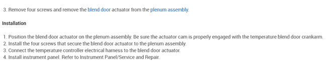

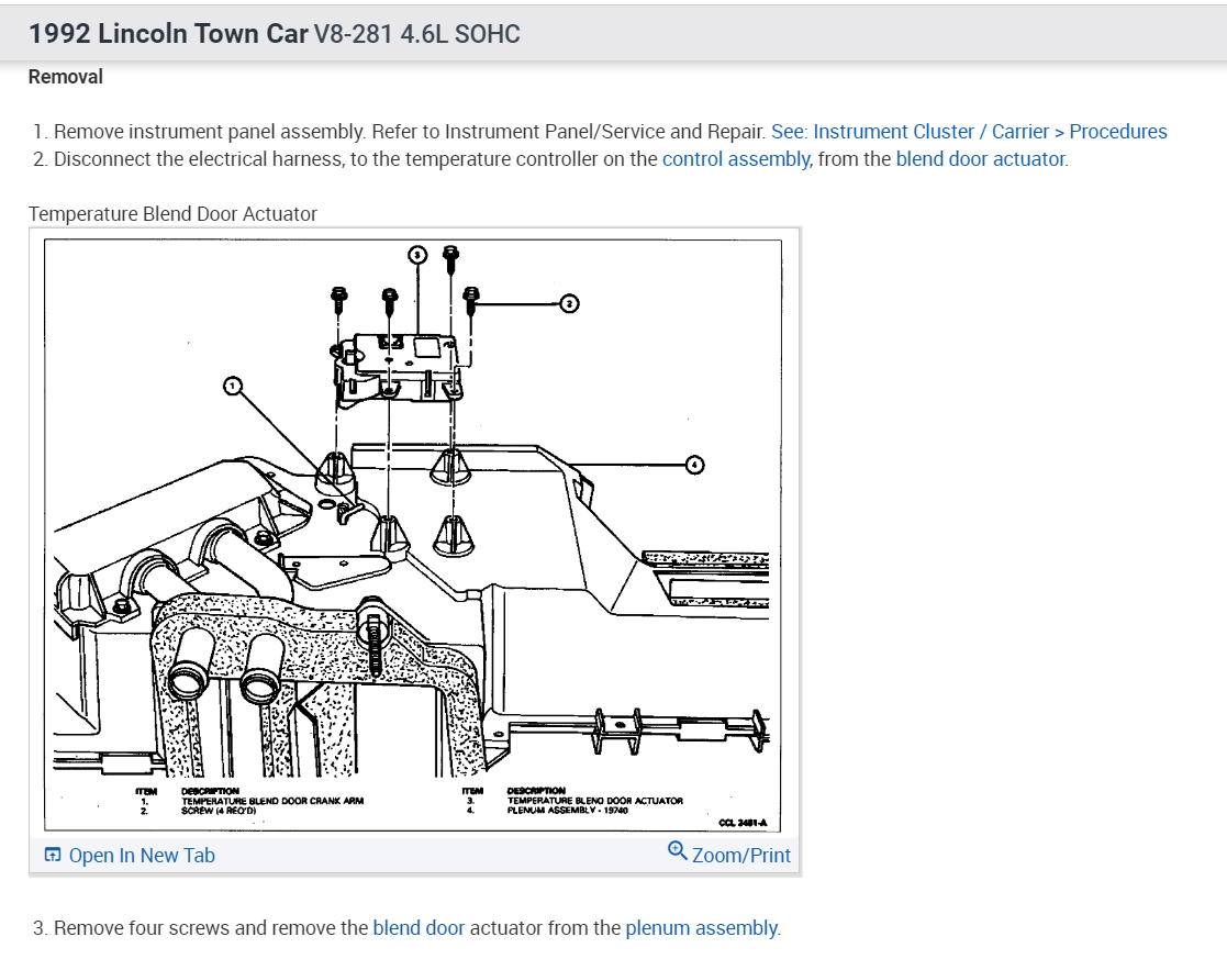

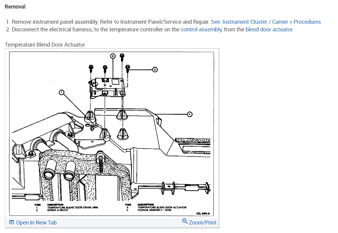

It sounds like you have two problems, first the fan clutch needs to be replaced, and the temperature blend door actuator is not working correctly.
and here is the blend door location so you can swap it out. Check out the images (below). Please let us know how it goes

Thanks for your advice, Ken. So, it turns out that the fan clutch was bad and needed to be replaced after all. So, I ordered the part and replaced it. Unfortunately, the A/C is still not blowing cold air. You mentioned the temperature blend door actuator was not working correctly. Is there a way to tell if this is properly working? When the heat is turned on, hot air blows out.
Jul 2, 2023 at 4:19 PM
  • 55,456 POSTS

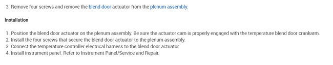

Here is the location of the temperature blend door actuator, I would please your hand on it and work the control to see if you can feel it working/moving? If not, I would replace the unit. Check out the images (below). Please let us know what you find.

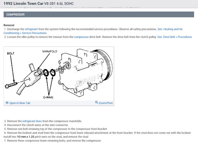

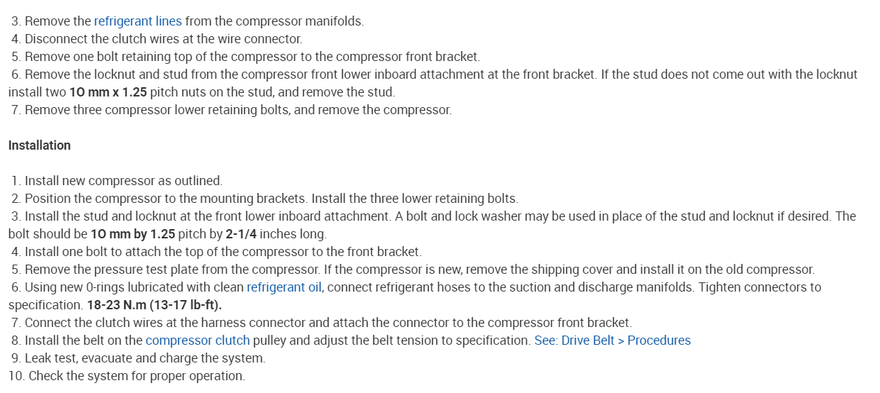

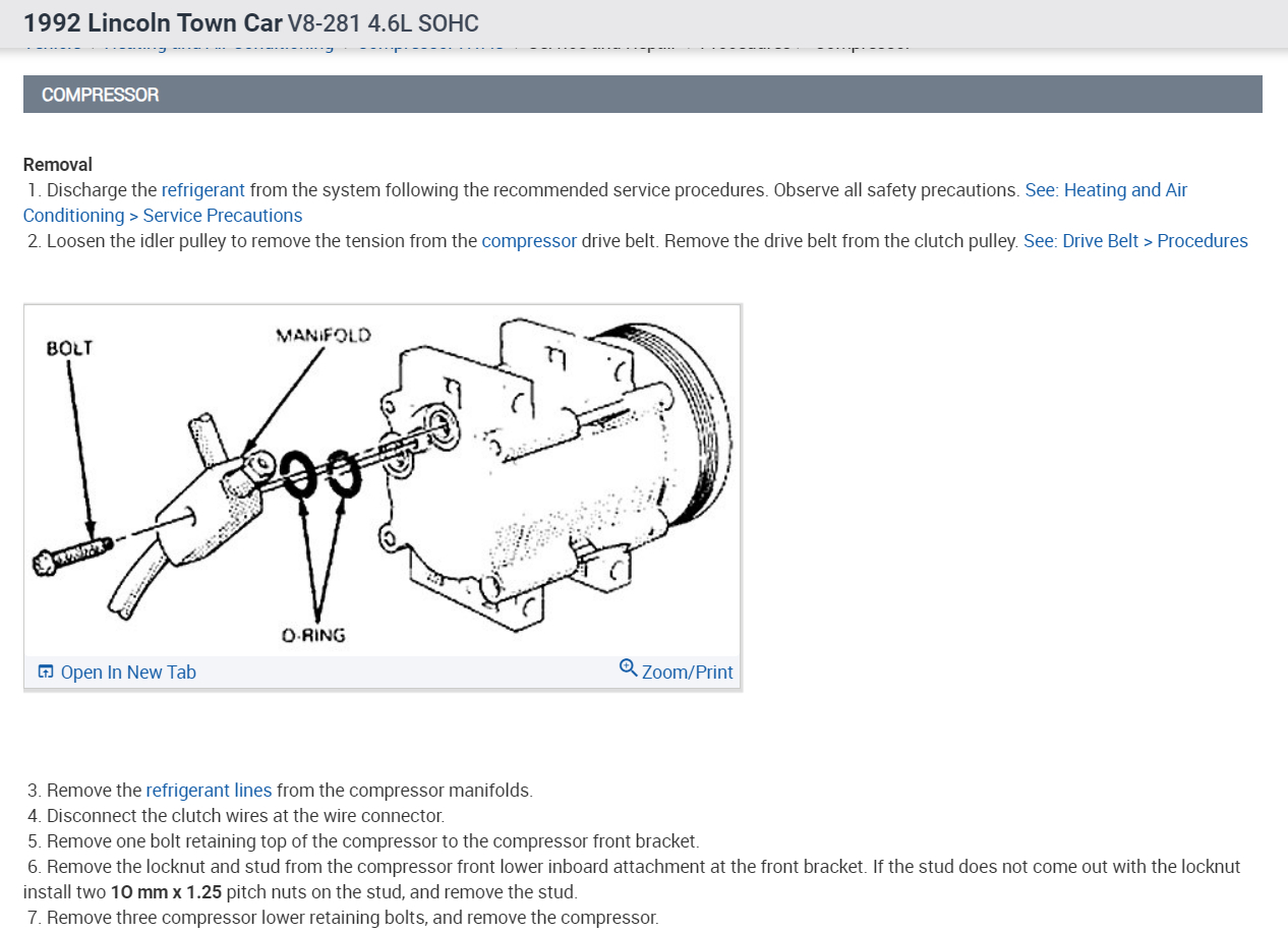

Those pressures are telling us the compressor is bad. Here is a generic guide to help you step by step with instructions in the diagrams below to show you how on your car:
https://www.2carpros.com/articles/replace-air-conditioner-compressor
And this video will show you how to vacuum down and recharge the system:
https://youtu.be/4EqdrBVb0sY
Check out the images (below). Please let us know how it goes.
