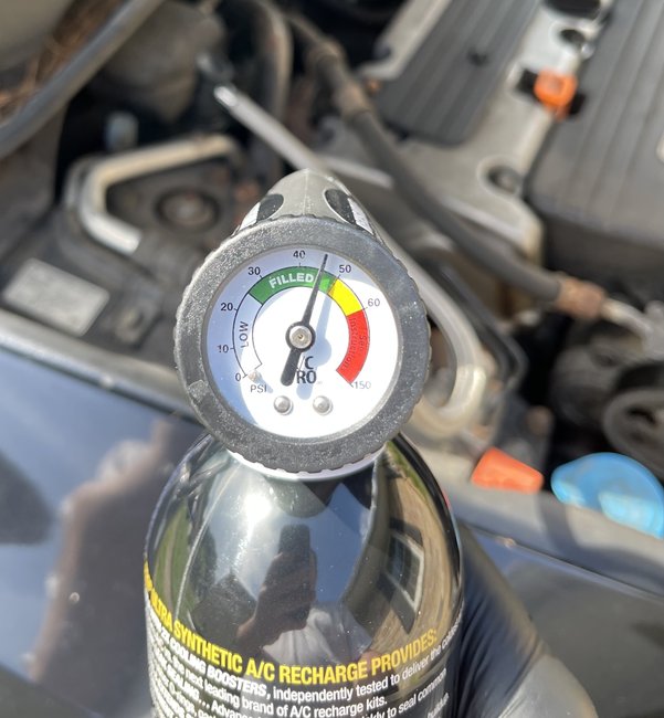

I wasn’t able to check the exact readings because I was just using the ACPro ACP-100 Ultra Synthetic R-134a Car Refrigerant Kit with gauge. It was just barely in the green zone so even though it said don’t bother adding any of it is in that zone at all, I still just added a tiny bit, so it was just above 30 PSI.

Absolutely, check it. As far as the pressure you had on the low side, 30 PSI, I need to know what the outside temperature was when you had that reading. If it was warmer than 70 degrees, you are likely low on refrigerant.
Let me know what you find and what the temperature was.
Aug 7, 2022 at 2:27 PM
KORY FISHER

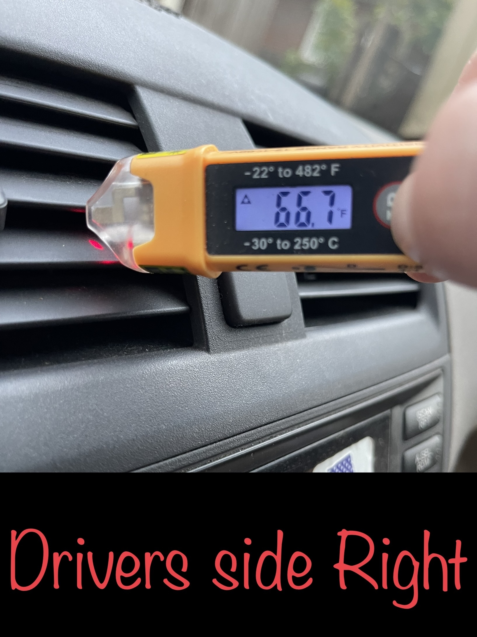

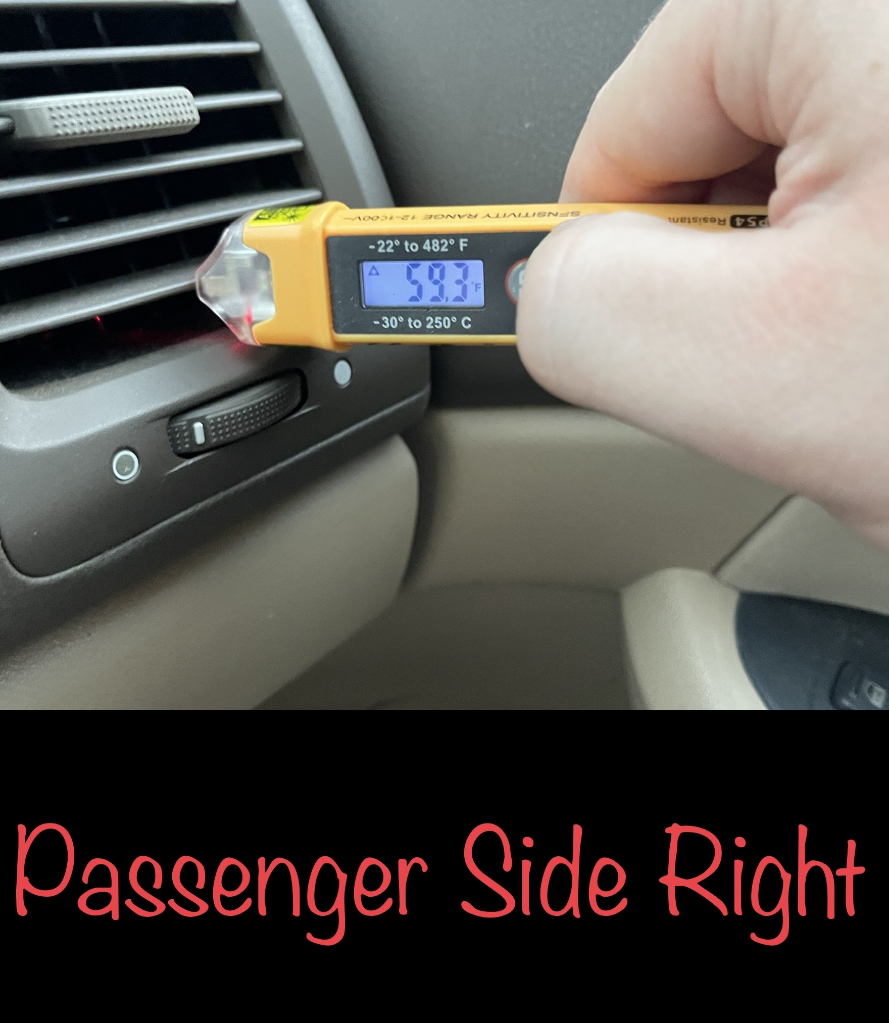

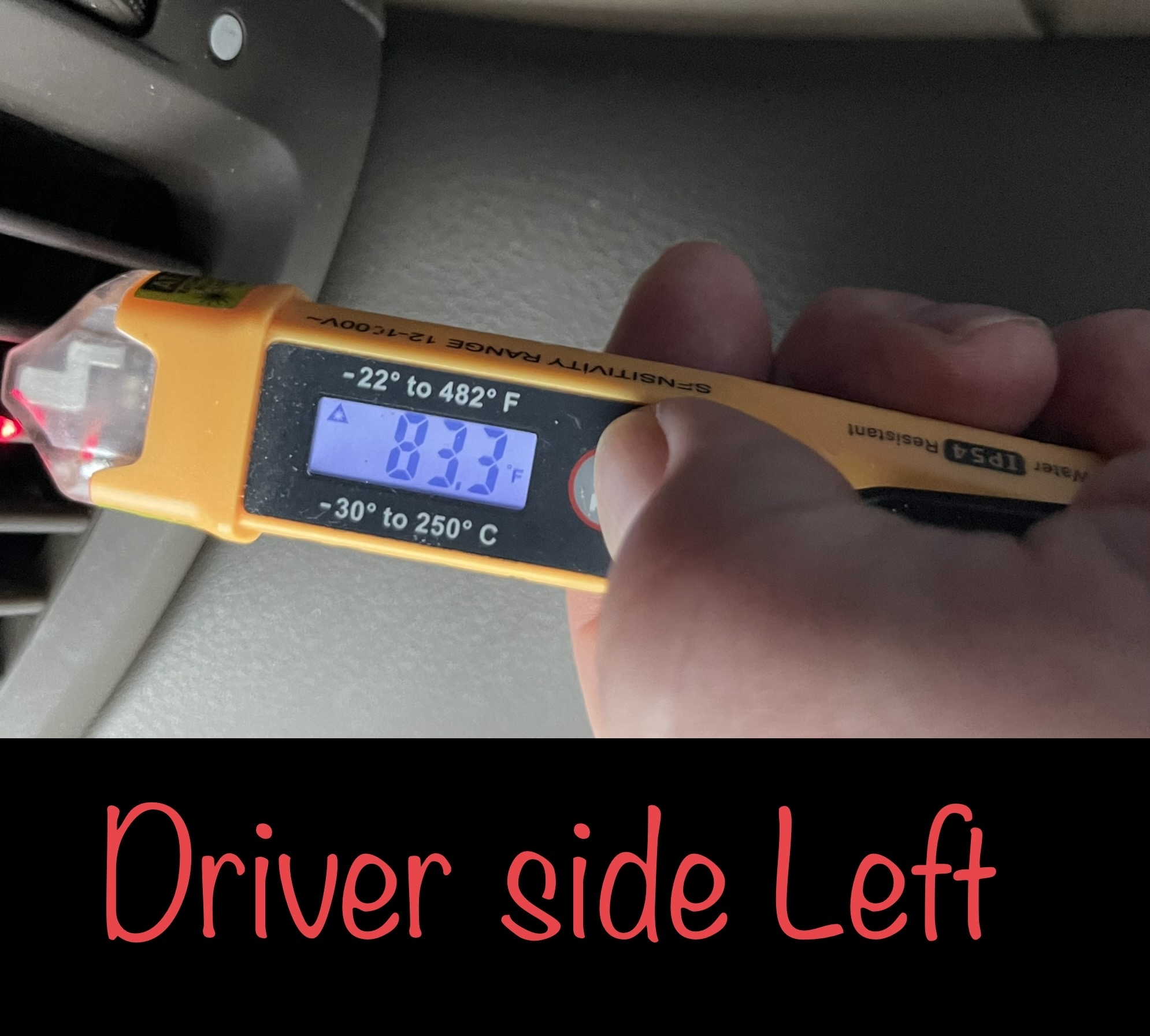

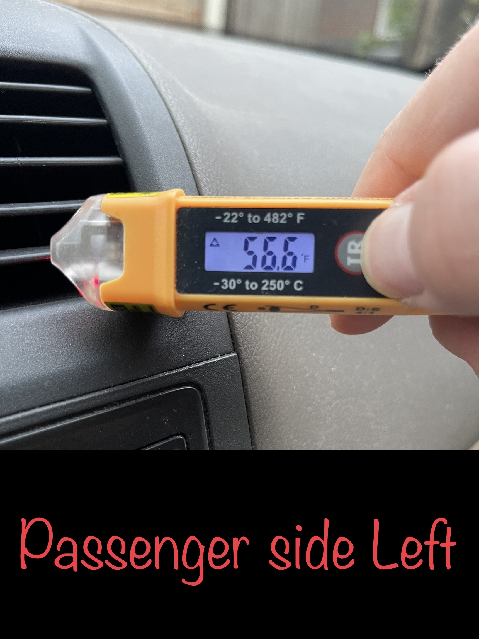

Sorry, I have been busy but I’m attaching pictures of the reading on the low side. I have no way to check high pressure. It is 93° with 50% humidity and heat index off 102°. I’m going to a attach pictures of temperature coming out of vents later.

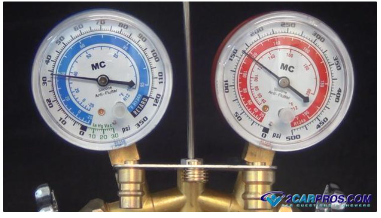

That is good for the low-pressure side at the temps you mentioned. The problem is this. Without knowing the high-pressure side, I have no idea if there is something plugged providing a false reading on the low side. Have you tried contacting a parts store to see if they have an A/C manifold kit they lend out?
See pic below.

Wow, that is a big difference. Basically, nothing from the driver's side gradually improves across the dash.
