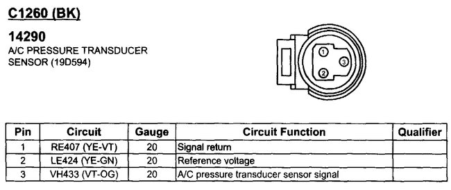

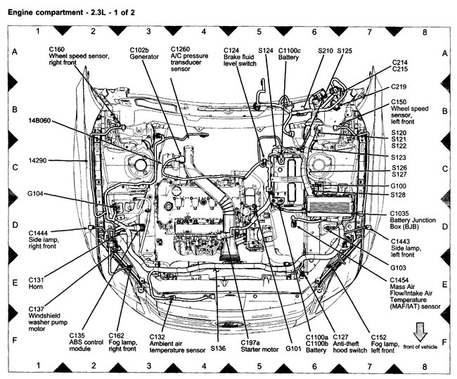

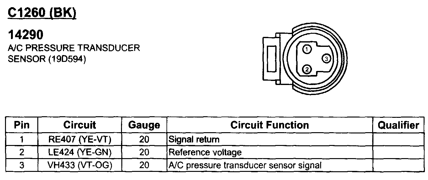

Has the high pressure transducer switch been checked?
The A/C high pressure switch is used for additional A/C system pressure control. The A/C high pressure switch is either dual function for multiple speed, relay controlled electric fan applications, or single function for all others. If pressure is too high or low, it results in the A/C turning off, preventing the A/C pressure from rising to a level that would open the A/C high pressure relief valve. I attached two pictures. First is the location (best I could find, sorry) and the second is a picture of the connector and what each wire is for.
Also, here is a link that discusses different reasons why an AC may not be working. If you page through it, you'll come to the section that discusses the pressure switch I mentioned. Also, and very important, it discusses static pressure. That is the pressure in the system when the compressor is not on and the engine is off. Static pressure that is too high or low will cause the system to not run. If it has not been checked, do that.
Take a look at this and let me know what you find. I hope something here helps.

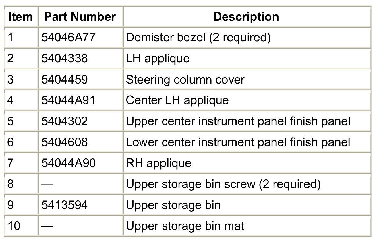

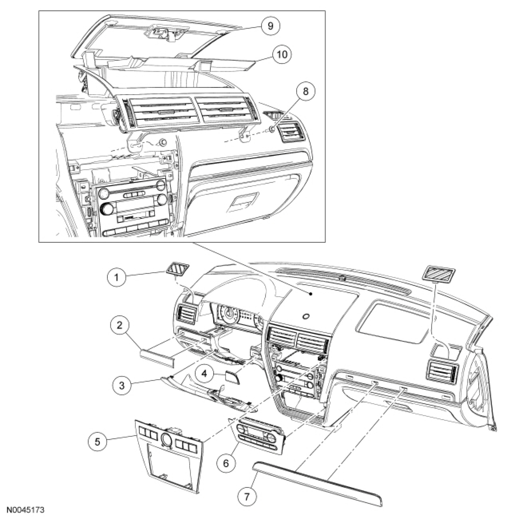

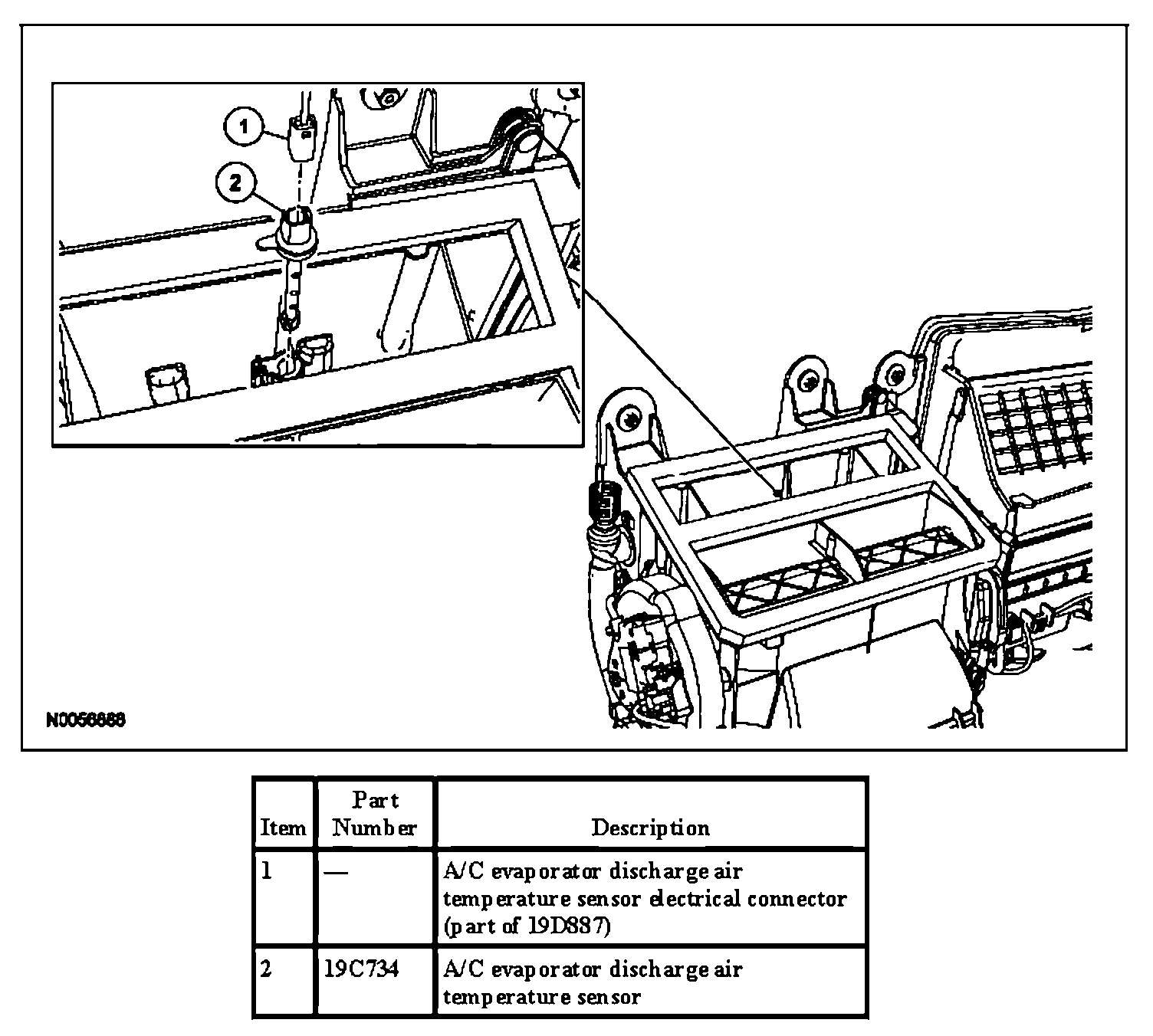

The EVAP discharge temperature sensor can be an issue. And yes, a pain to get to. I have attached a picture of its location. The directions listed below are what is provided. They left the difficult parts out. And yes, half the car has to come apart.
Here is a definition of the component:
EVAPORATOR DISCHARGE AIR TEMPERATURE SENSOR
The evaporator discharge air temperature sensor contains a thermistor which receives a reference voltage from the PCM. The thermistor then varies the resistance to the reference voltage based on the evaporator discharge air temperature. The resulting voltage is returned to the PCM where it is interpreted as an evaporator air discharge temperature reading.
The PCM maintains evaporator core temperature and prevents icing of the evaporator core, by disengaging the A/C compressor clutch when the evaporator discharge air temperature sensor reading falls below acceptable levels, and by engaging the A/C compressor clutch when the discharge air temperature rises above acceptable levels.
The evaporator discharge air temperature sensor is located inside of the heater core and evaporator core housing in the air-stream leaving the evaporator core.

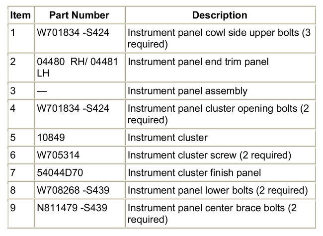

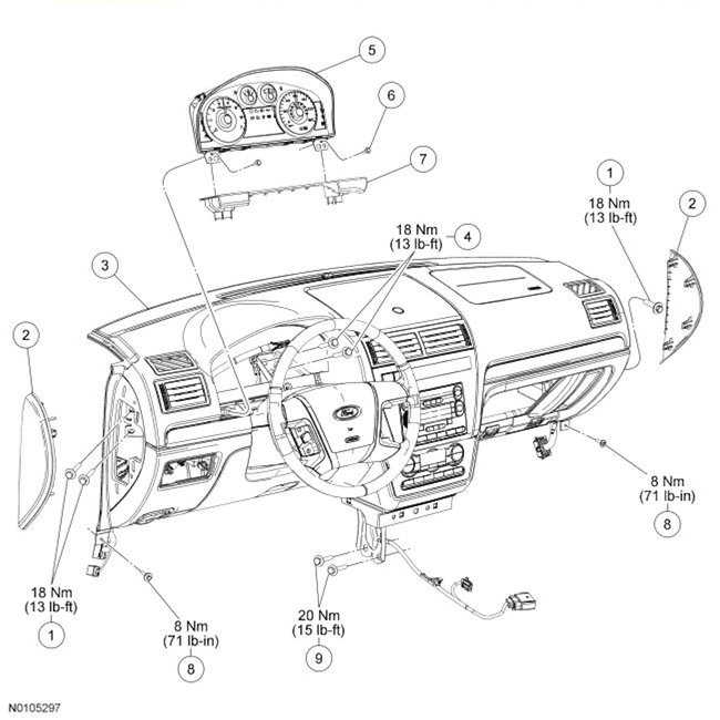

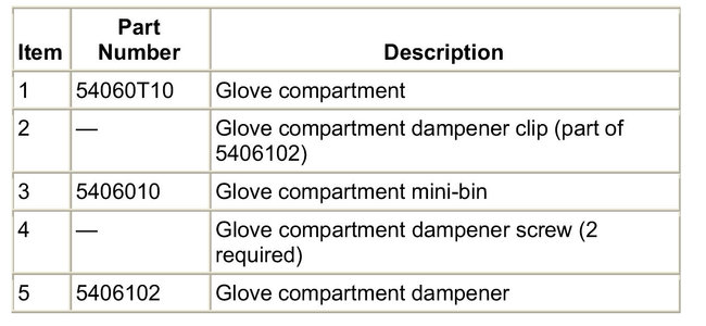

Removal and Installation
1. Remove the instrument panel. Please refer to: Body and Frame, Interior Moulding/Trim, Dashboard/Instrument Panel. See: Dashboard / Instrument Panel > Removal and Replacement > Instrument Panel - Exploded View
2. Detach the A/C evaporator discharge air temperature sensor.
3. Disconnect the A/C evaporator discharge air temperature sensor electrical connector.
4. Remove the evaporator discharge air temperature sensor.
5. To install, reverse the removal procedure.
______________________________

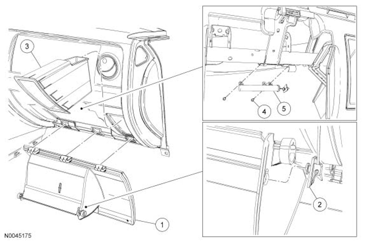

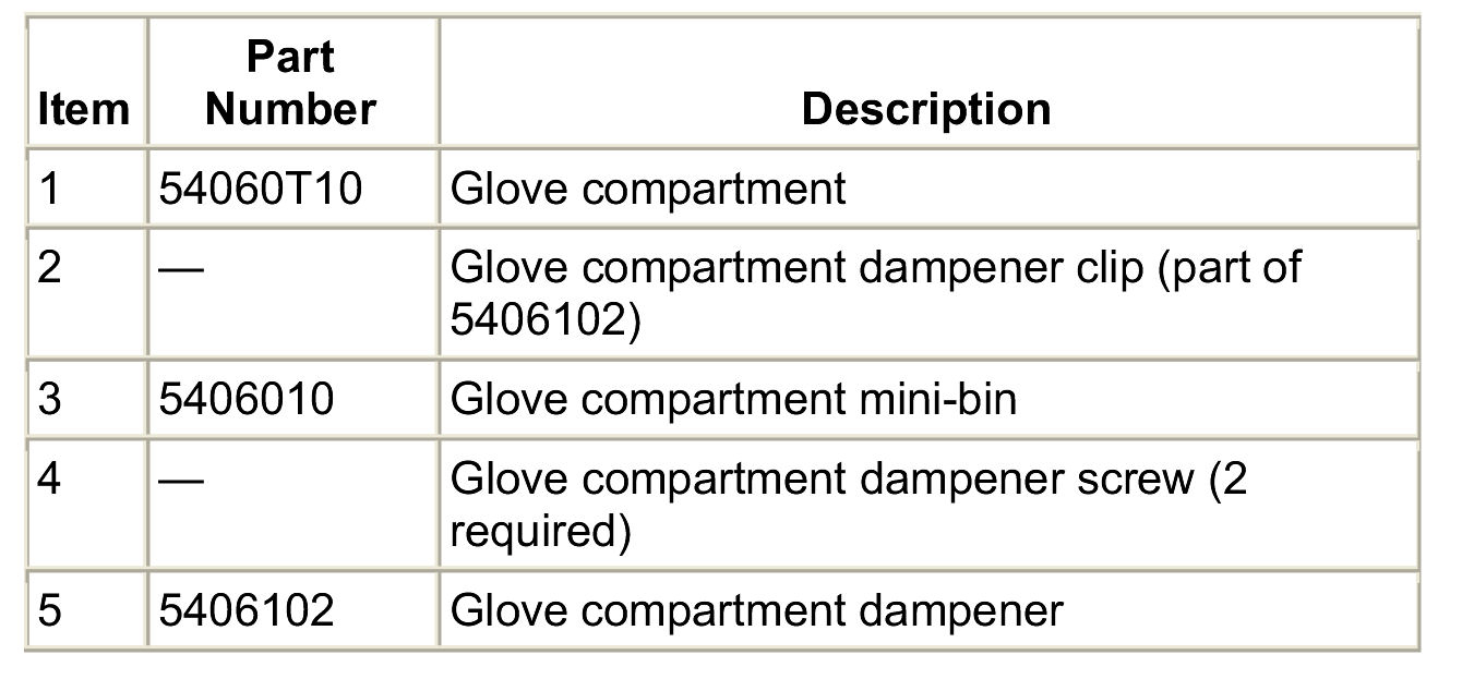

The last 6 pictures show how the instrument panel comes apart. I thought I would add them just in case you decide to give it a try.
Let me know if any of this helps. Also, if you could provide the static pressure readings of the system, it may prove beneficial.
