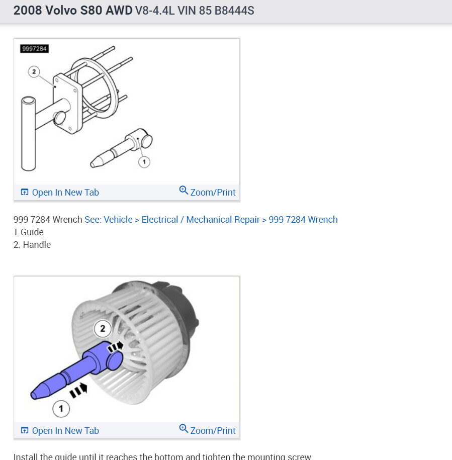

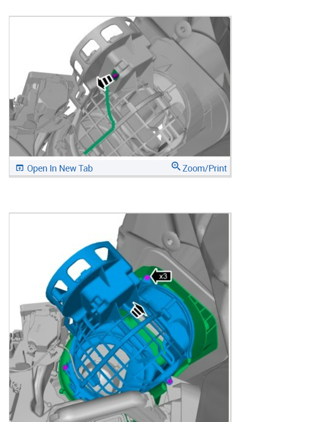

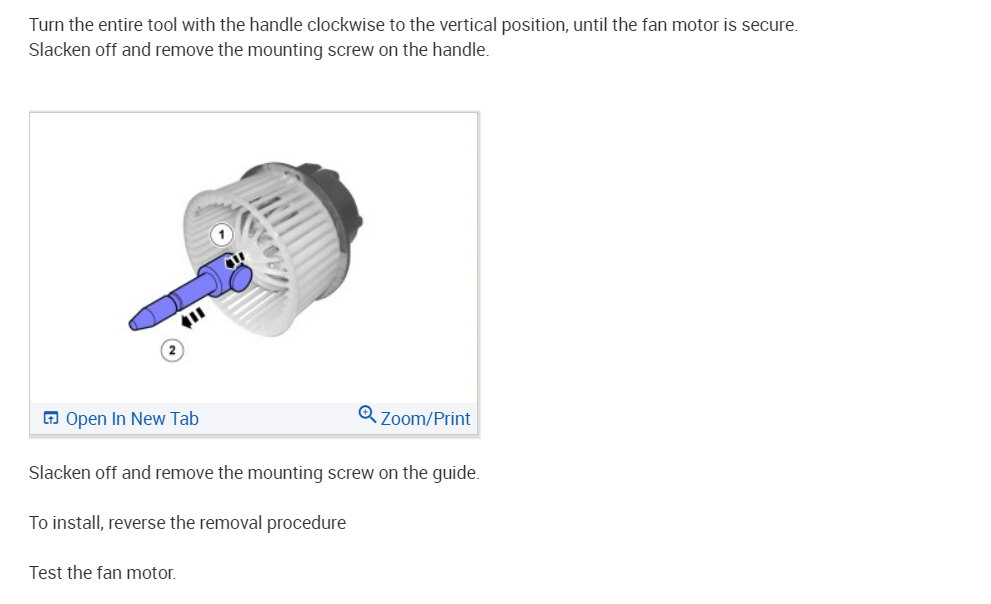

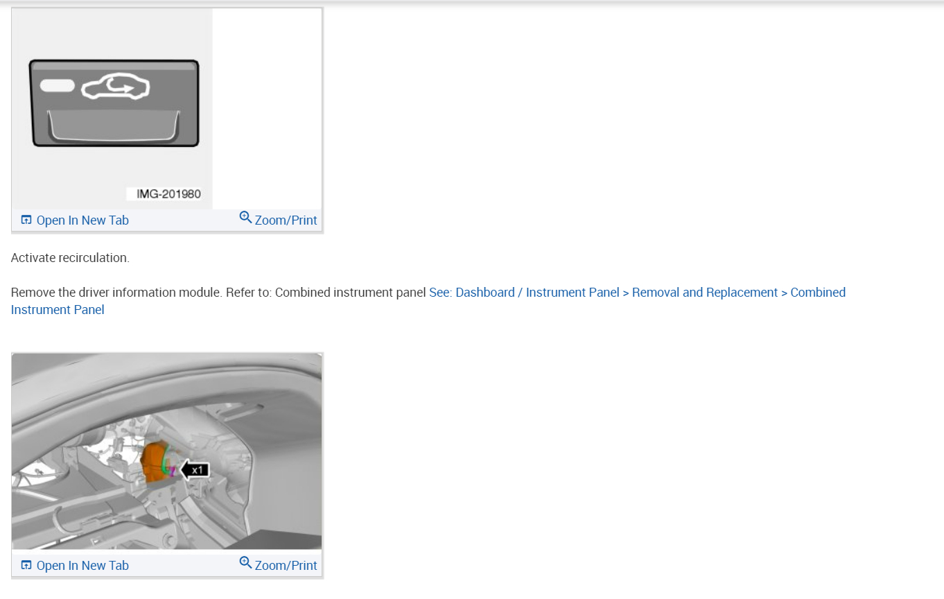

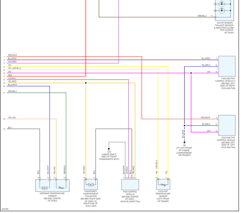

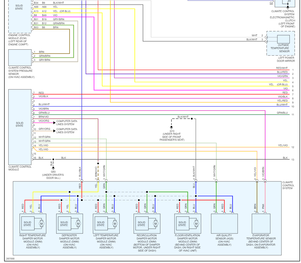

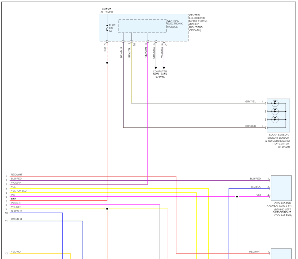

How can I tell if it's the resistor or the blower itself?
May 22, 2023 at 5:36 AM
  • 55,721 POSTS

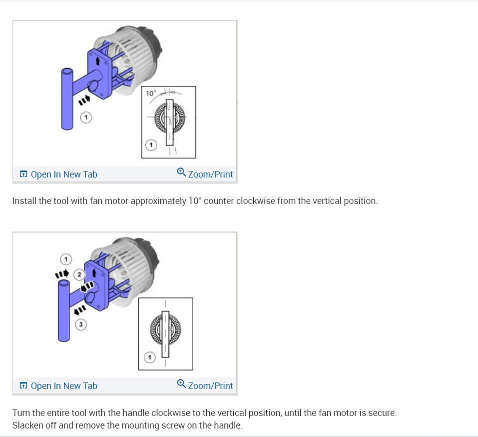

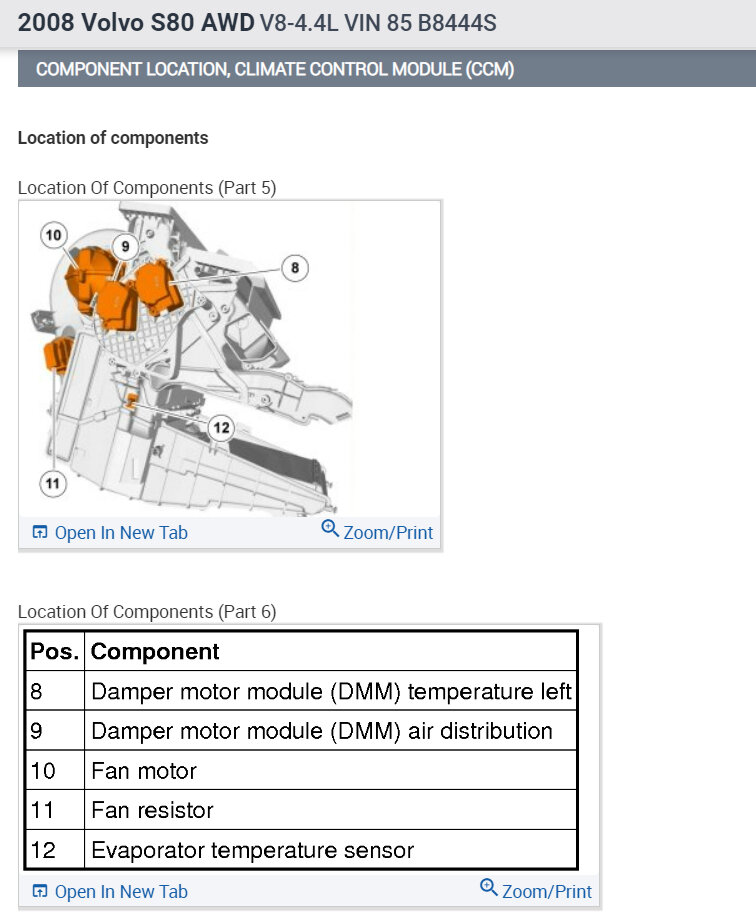

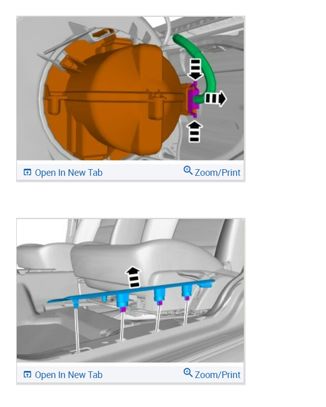

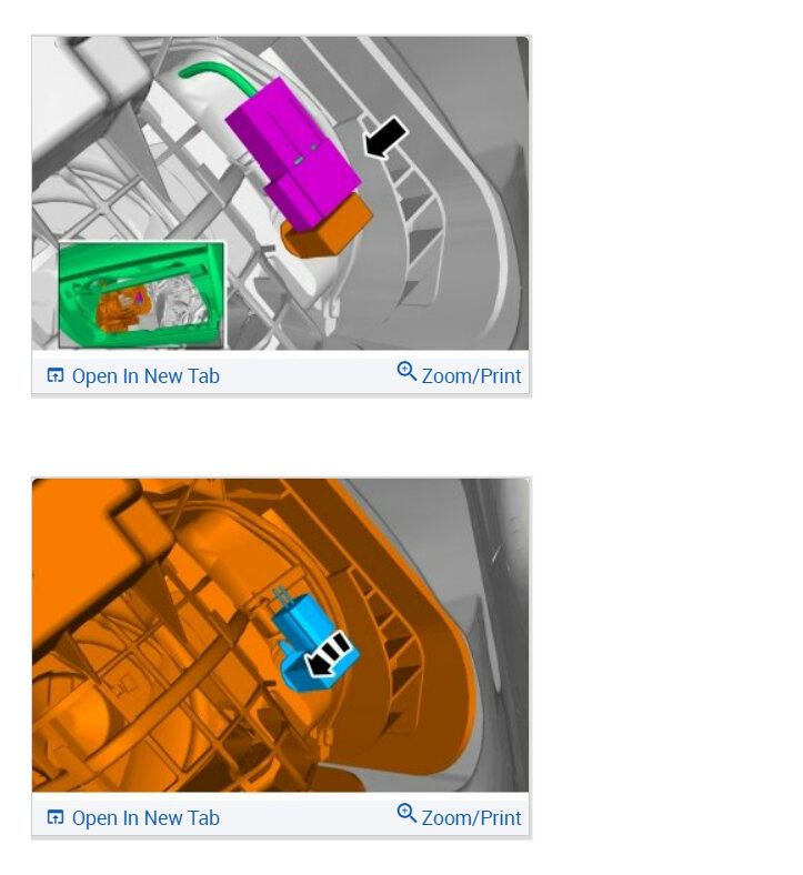

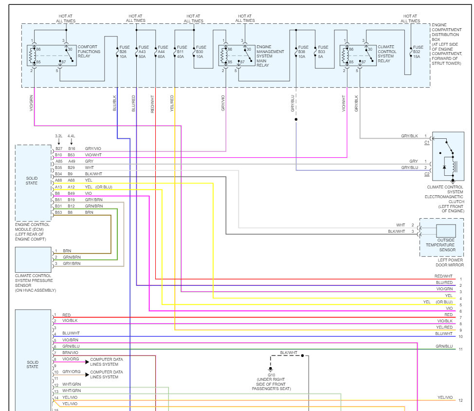

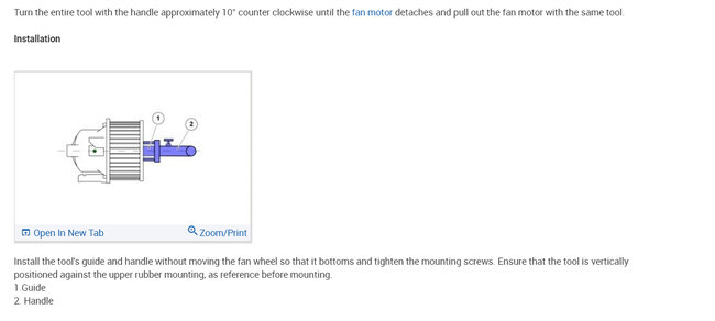

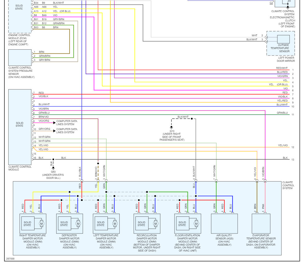

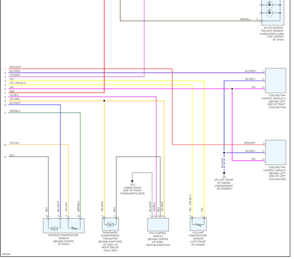

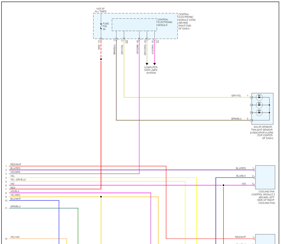

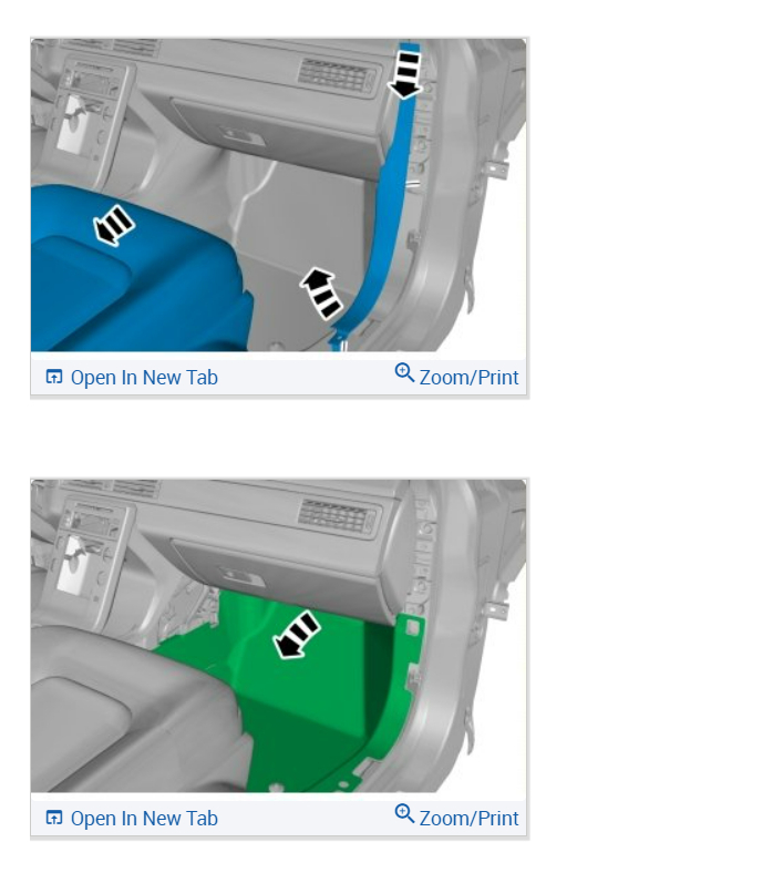

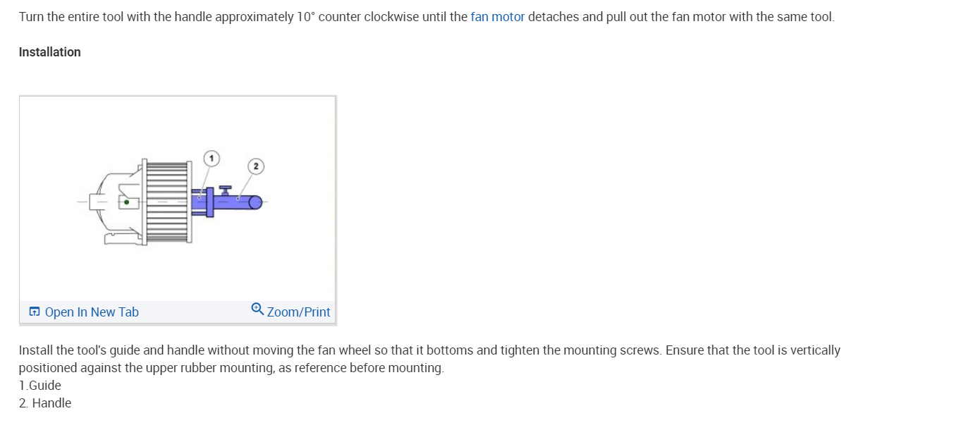

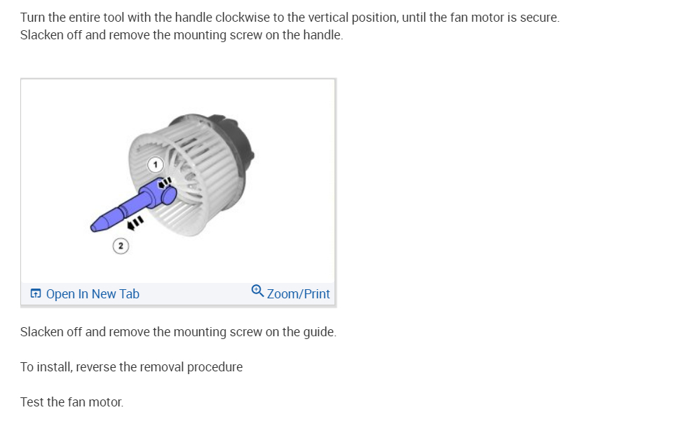

It looks like the fan resistor is on the backside of the HVAC housing. Here is a guide that will help you check the power and ground of the blower motor. I have included the wiring diagrams so you can see how the system works and the location of the blower motor and resistor so you can check them out.
https://www.2carpros.com/articles/blower-fan-motor-works-on-high-speed-only

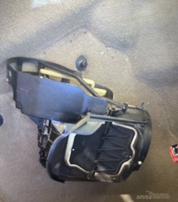

Got it out and installed new one, tried it and it works. Now the damper case unit was damaged, pins cane off and broken. Am having hard time finding it. What is it called and if you can find me the part number for it?
It looks like this, has the flaps inside with pins and stuff
May 25, 2023 at 1:52 AM
BHAMDOC1973
  • 2,007 POSTS
got it repaired and all is good.
May 25, 2023 at 8:35 AM
  • 110,248 POSTS
Thank you for the update. I'm glad to know it has been repaired.
