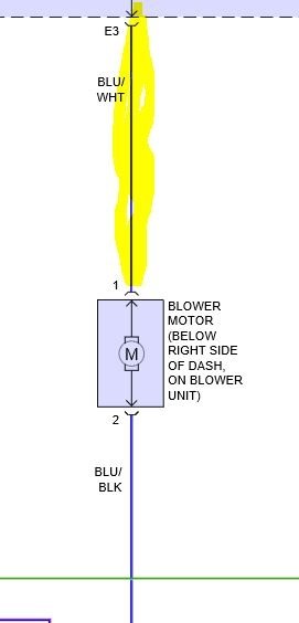

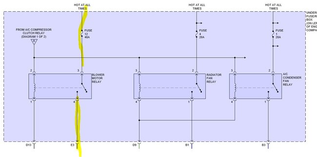

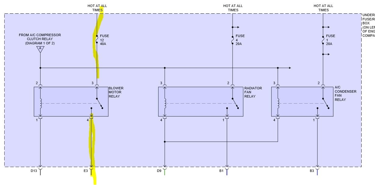

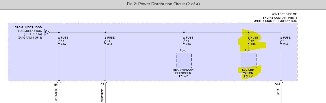

AC blower stop working. Replace the resistor still is not working. How do I test the blower itself?
Jul 5, 2018 at 9:54 AM
AL514
  • 5,700 POSTS
Hello there, Here are a few wiring diagrams to help get you started. You can see in the second diagram the power wire for the blower is the blue wire with a white tracer. You can put a test light or multi-meter on this wire and should have 12 volts. The blower motor should be located under the dash on the passenger side.
