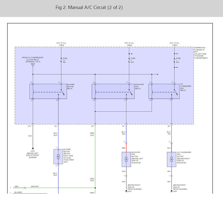

The fan blower motor is not working and you need to find out why.
See if the following is of any help.
A Problem in the Blower Motor Circuit

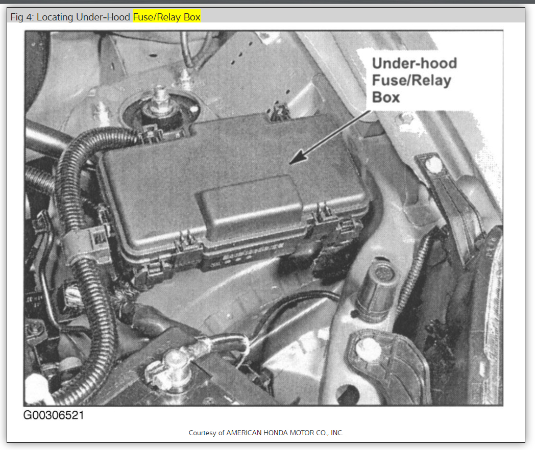

1 . Check the No. 12 (40A) fuse in the under-hood fuse/relay box, and the No. 14 (10A) fuse in the under-dash fuse/relay box.
Are the fuses OK ?
YES - Go to step 2.
NO - Replace the fuse(s), and recheck.

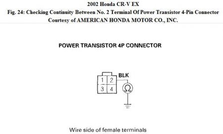

6 . Disconnect the power transistor 4P connector.
7 . Check for continuity between the No. 2 terminal of the power transistor 4P connector and body ground.
https://www.2carpros.com/forum/automotive_pictures/192750_BlowerMotor02CRVFig24_1.jpg
Is there continuity?
YES - Go to step 8.
NO - Check for an open in the wire between the power transistor and body ground.

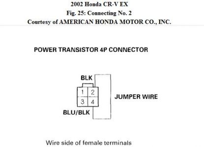

8 . If the wire is OK, check for poor ground at G501. Connect the No. 2 and No. 4 terminals of the power transistor 4P connector with a jumper wire.
https://www.2carpros.com/forum/automotive_pictures/192750_BlowerMotor02CRVFig25_1.jpg
9 . Turn the ignition switch ON (II).
Does the blower motor run at high speed?
YES - Go to step 10.
NO - Repair open in the wire between the power transistor and the blower motor.

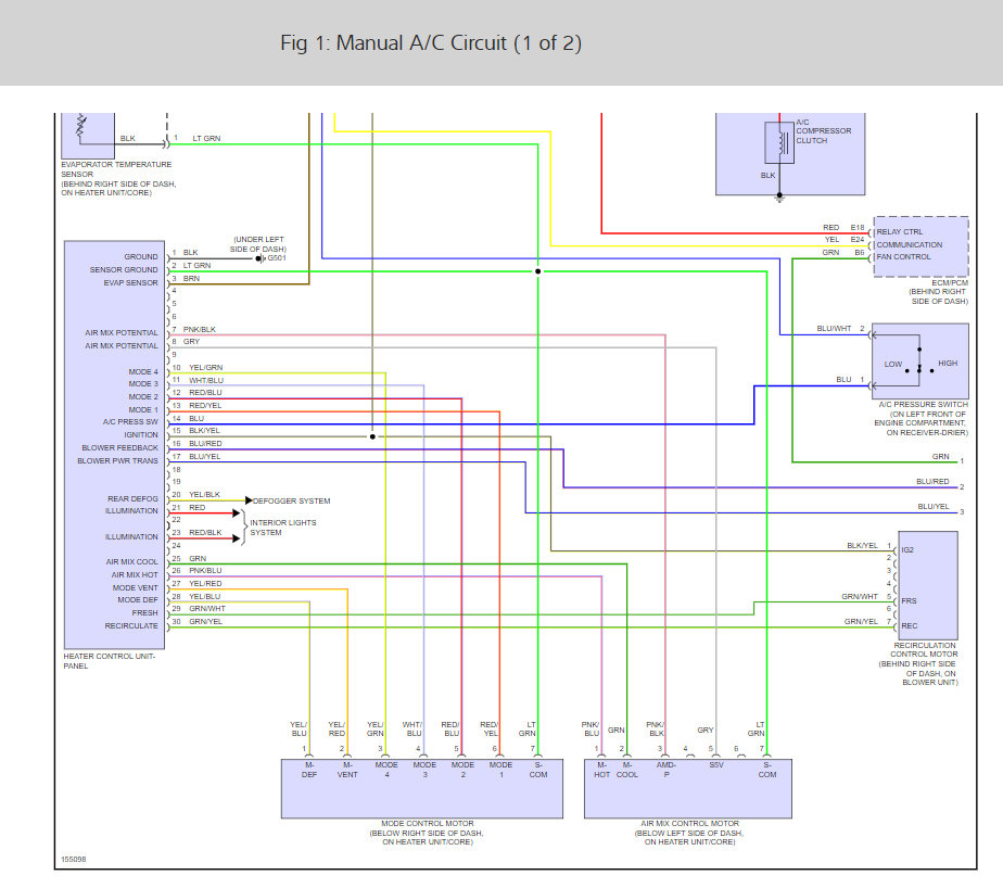

12 . Disconnect the heater control panel 30P connector.
13 . Check for continuity between the No. 16 and No. 17 terminals of the heater control panel 30P connector and body ground individually.
https://www.2carpros.com/forum/automotive_pictures/192750_BlowerMotor02CRVFig26_1.jpg
YES - Repair any short to body ground in the wire(s) between the heater control panel and the power transistor.
NO - Go to step 14.

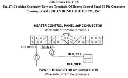

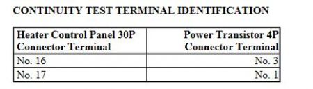

14 . Check the continuity between the following terminals of the heater control panel 30P connector and the power transistor 4P connector.
https://www.2carpros.com/forum/automotive_pictures/192750_BlowerMotor02CRVFig26a_1.jpg
https://www.2carpros.com/forum/automotive_pictures/192750_BlowerMotor02CRVFig27_1.jpg
YES - Go to step 15.
NO - Repair any open in the wire(s) between the heater control panel and the power transistor.

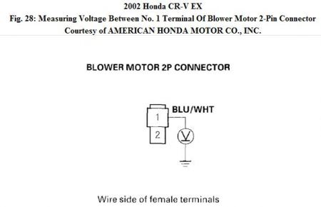

17 . Disconnect the jumper wire.
18 . Disconnect the blower motor 2P connector.
19 . Measure the voltage between the No. 1 terminal of the blower motor 2P connector and body ground.
https://www.2carpros.com/forum/automotive_pictures/192750_BlowerMotor02CRVFig28_1.jpg
Is there battery voltage?
YES - Replace the blower motor.
NO - Go to step

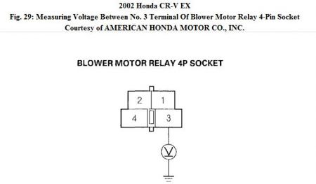

22 . Measure the voltage between the No. 3 terminal of the blower motor relay 4P socket and body ground.
https://www.2carpros.com/forum/automotive_pictures/192750_BlowerMotor02CRVFig29_1.jpg
YES - Go to step 23.
NO - Replace the under-hood fuse/relay box.

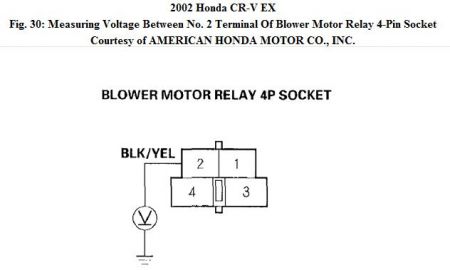

24. Measure the voltage between the No. 2 terminal of the blower motor relay 4P socket and body ground.
https://www.2carpros.com/forum/automotive_pictures/192750_BlowerMotor02CRVFig30_1.jpg
YES - Go to step 25.
NO - Repair open in the wire between the No. 14 fuse in the under-dash fuse/relay box and the blower motor relay.

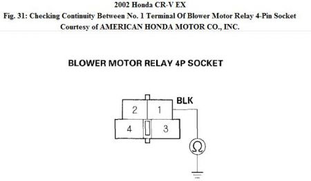

26 . Check for continuity between the No. 1 terminal of the blower motor relay 4P socket and body ground.
https://www.2carpros.com/forum/automotive_pictures/192750_BlowerMotor02CRVFig31_1.jpg
YES - Repair open in the BLU/WHT wire between the blower motor relay and the blower motor.
NO - Check for an open in the wire between the blower motor relay and body ground. If the wire is OK, check for poor ground at G301.

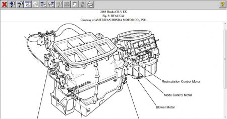

The Fan does not work either on the AC or the heater. I check the fuses both under the hood (left side engine area) and under the dash (right side steering column. All fuses were good. I was told to rap on the blower motor to see if it would start.

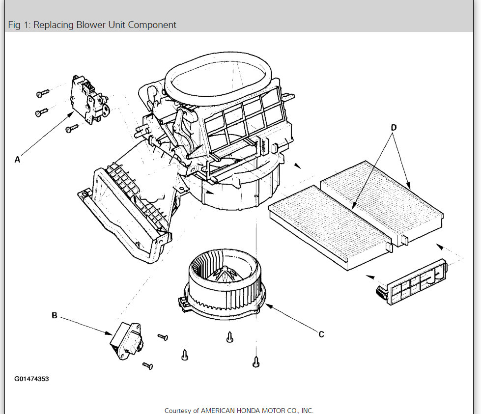

Where is the Blower Motor located? Do you have any other T/S recommendations?

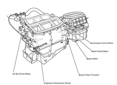

The blower motor is below the right side of dash on AC blower unit. Check the blower motor relay too.
https://www.2carpros.com/forum/automotive_pictures/12900_blower_18.jpg

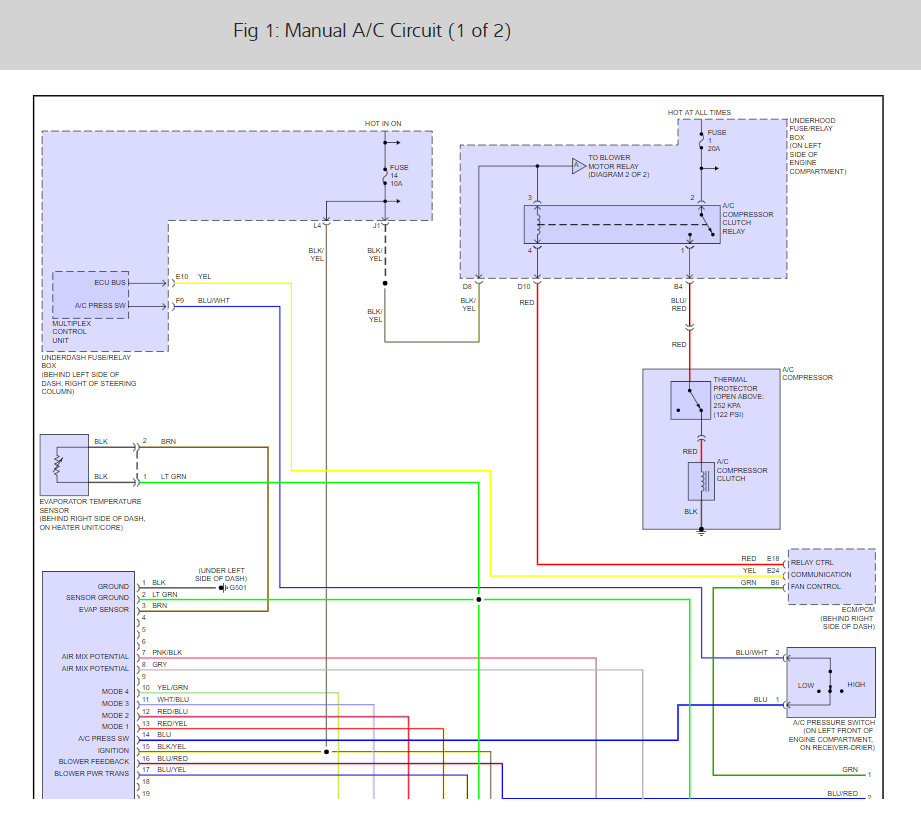

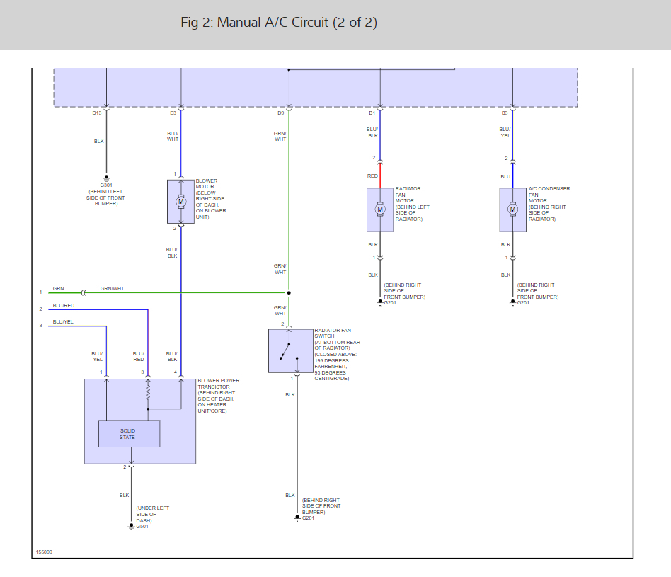

Here is a guide that can help tell what the problem is with the blower motor wiring diagrams so you can see how the system works with the fuse locations as well
https://www.2carpros.com/articles/blower-fan-motor-works-on-high-speed-only
and
Check out the diagrams (Below). Please let us know what you find. We are interested to see what it is.

Could be a bad transistor
