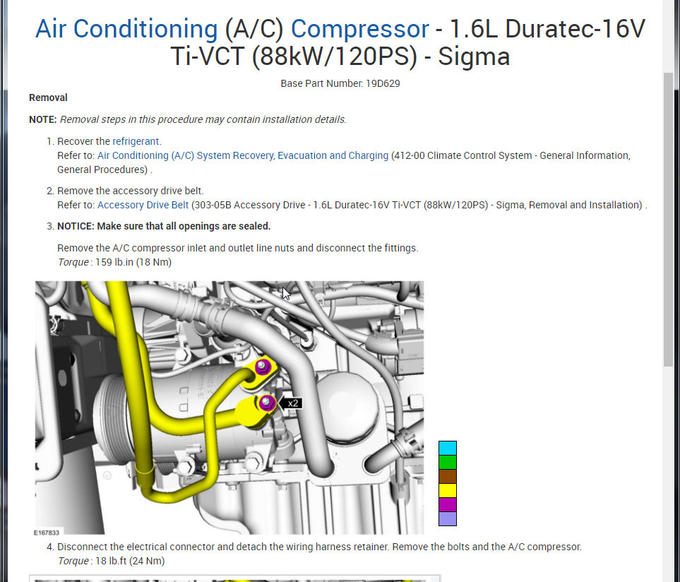

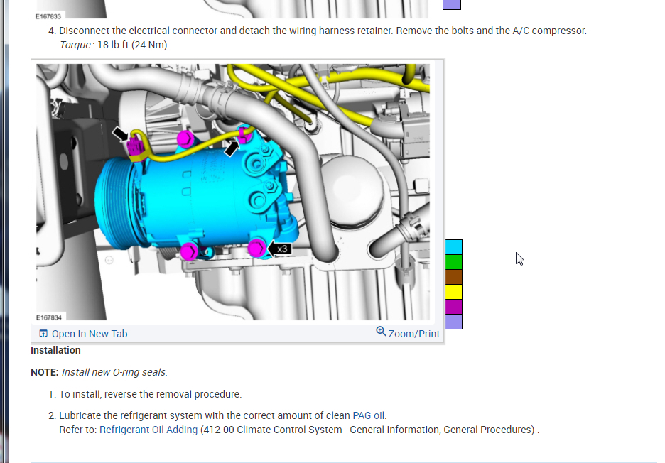

Below is the process on how to replace the compressor from the manual if it is properly charged and has power.
Please let us know if you have questions on this and we can go from there. Thanks
