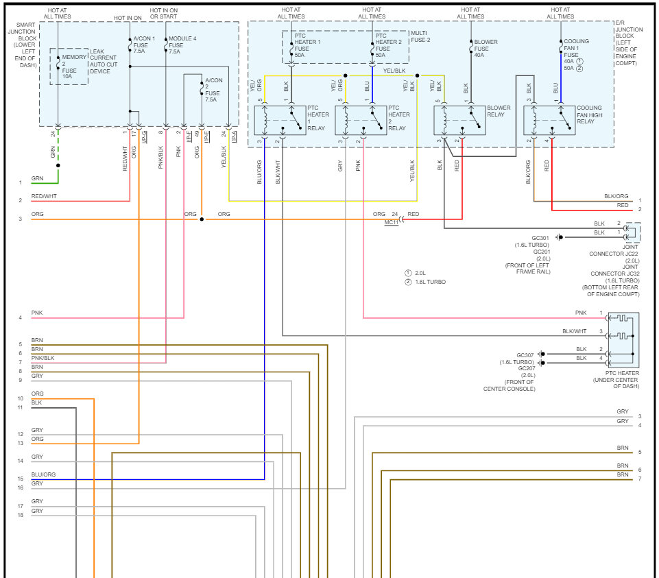

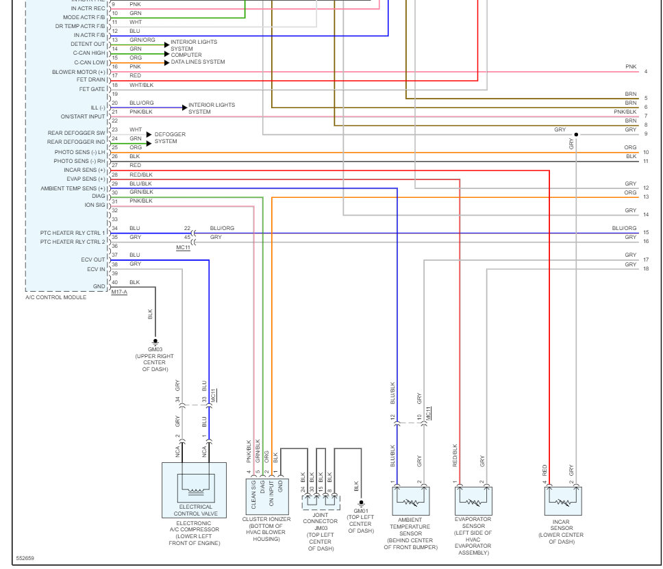

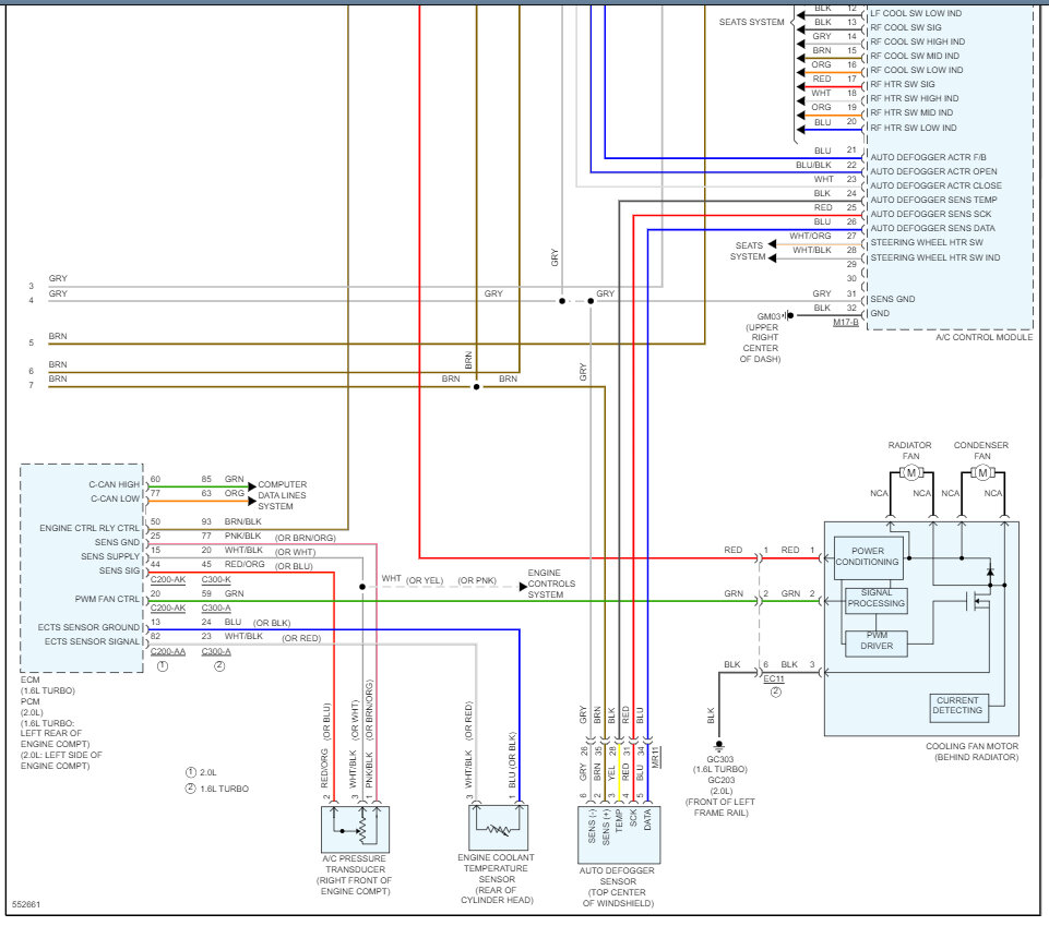

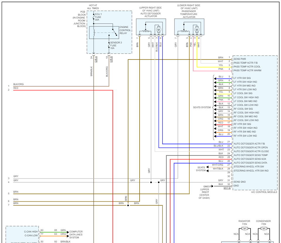

I'm noticing that my coolant fans will not operate. I'm not overheating, and I tend to idle for long periods of time, and they never turn on. I understand that if they don't turn on then the A/C won't turn on in most cases. When I turn the car on and select the A/C from the HVAC module I'm only getting 2-5 volts at the compressor which I think would be high resistance in the circuit or its the module not allowing the compressor to come on due to the fans not turning on. I replaced the evap thermistor near the gas pedal and I've swapped out A/C relay under the hood of the vehicle. My gauges are reading static pressure at 100 high and low since the compressor isn't turning on.

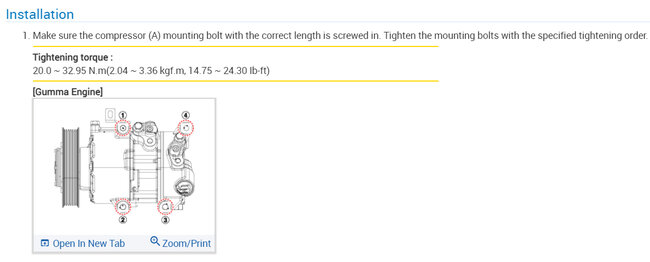

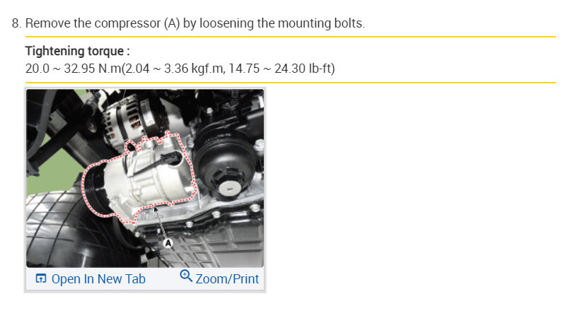

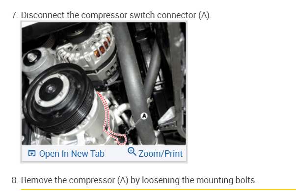

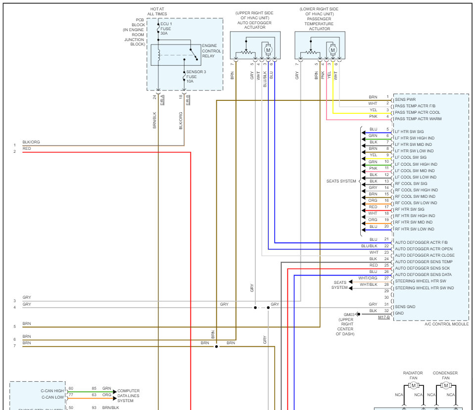

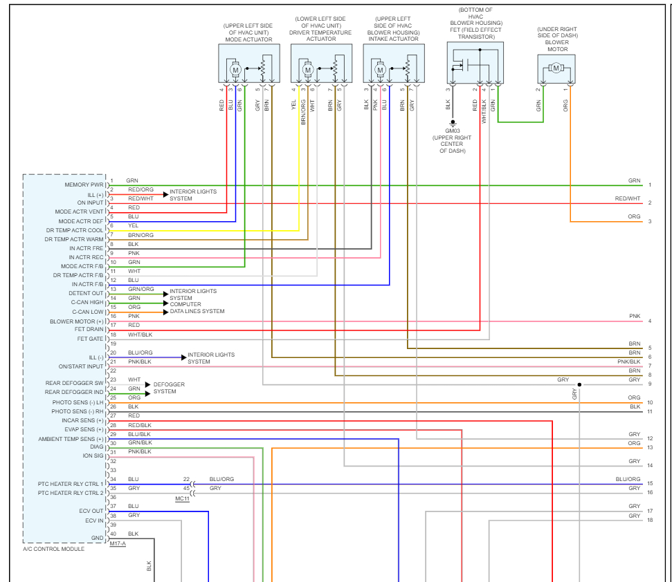

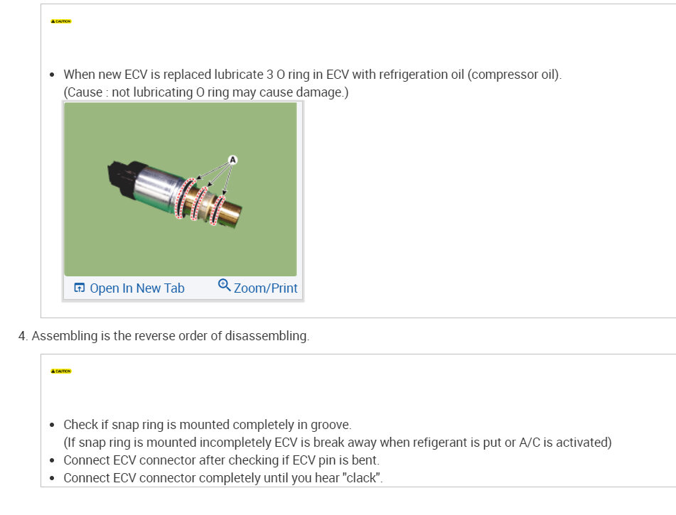

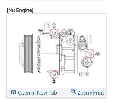

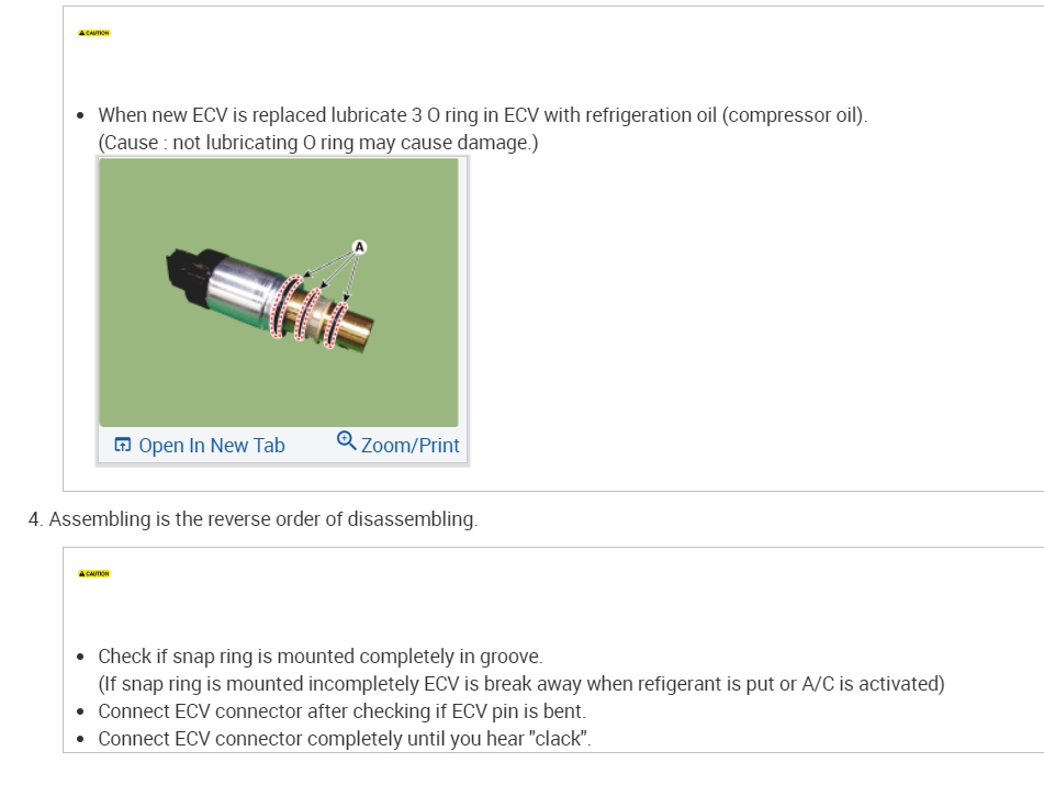

There are 9 fuses that run the system. We need to check those first, also please remove the power lead at the compressor to see if it goes to 12 volts, if so, you have a shorted A/C compressor ECV Valve. This is not the typical clutch style compressor; it uses a variable valve. Here is a guide to help you test the fuses and the AC/HVAC wiring diagrams so you can see how the system works and which fuses to test:

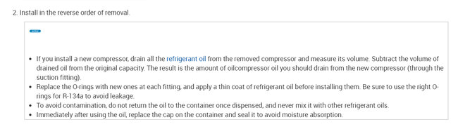

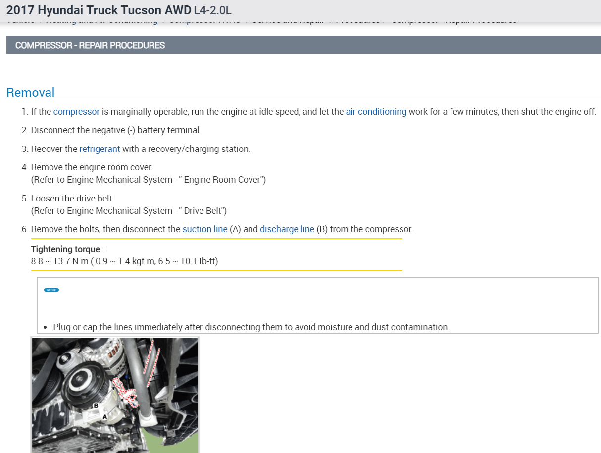

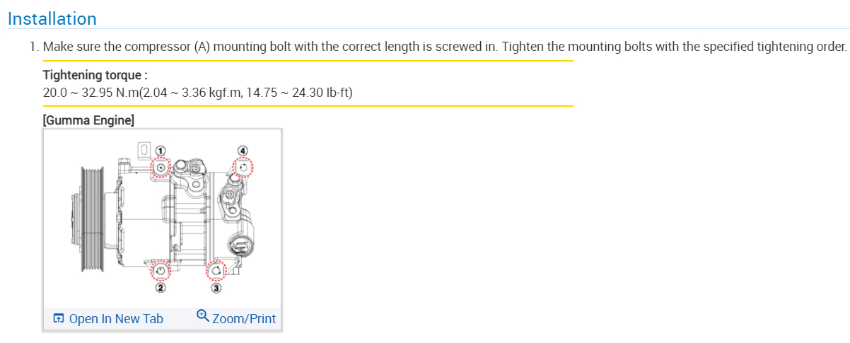

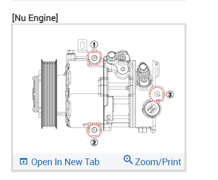

If the voltage jumps to 12 volts here is how to change the AC compressor it out as well. You will need to handle the refrigerant as well; this video will help:
https://youtu.be/4EqdrBVb0sY
