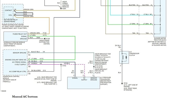

I have two problems with the vehicle listed above limited model, 4.7 with hydraulic fan. overheating which I am still working on it and now the AC stop working. I energized the clutch manually through the relay it engaged. What is missing is the signal from the computer to the relay. I checked refrigerant static pressure. it was 75 psi at 70 degrees F.
Any suggestions about the A/C?
Also, I would like the A/C wiring diagram.

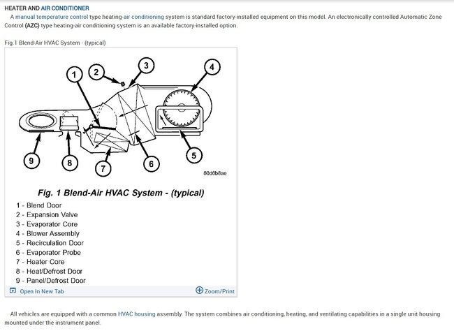

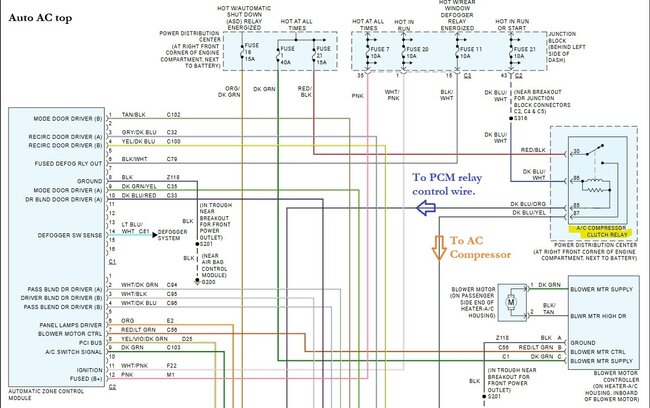

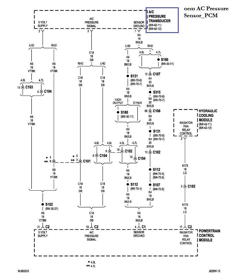

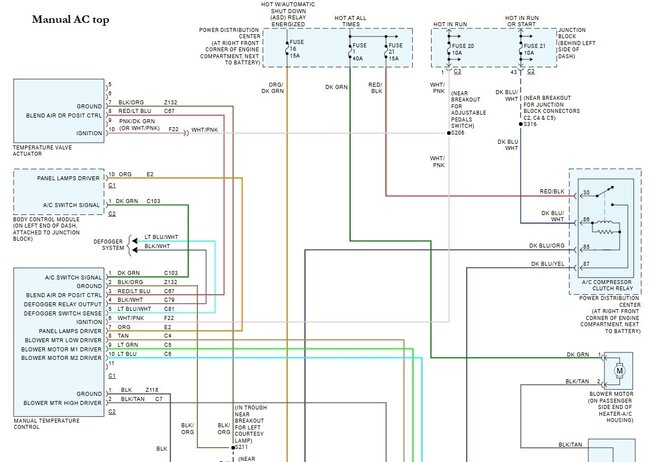

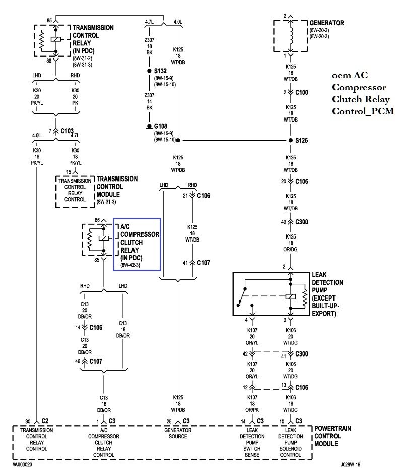

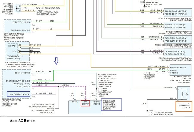

Here are the wiring diagrams, 1,2 are for the Automatic AC setup top and bottom.,
Diagrams 3,4 are the Manual A/C system top and bottom, Diagram 5 is the OEM A/C Pressure sensor to PCM, Diagram 6 is the OEM A/C Compressor Relay to PCM.
And the last 4 diagrams is some HVAC operations info that might be helpful.

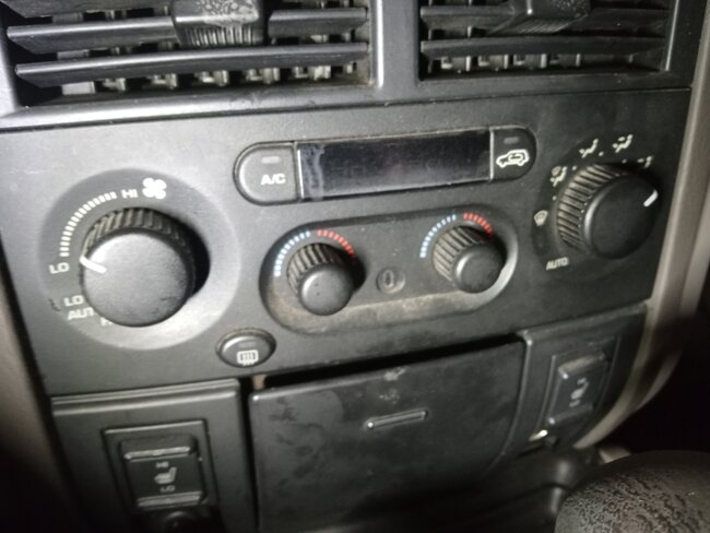

please see picture what I have. I have a code reader. it does not show me the transducer signal. However, I back probe the signal wire at the sensor connector. It was 0.9 V, after that I turned on the engine and manually engaged the compressor (run it for few seconds) by jumping the relay load side. the voltage of the transducer went up to 1.3v. So far what i know is that i have refrigerant in the system 75 PSI on low side did not check on high side which i will do. The clutch works. The transducer changes voltage but i do not have control from the computer. I am not a mechanic, but I learned by watching YouTube videos
So, what the PCM needs as input to send ground (dark blue/org wire) to the A/C clutch relay?

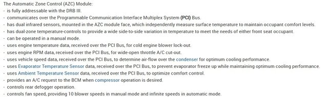

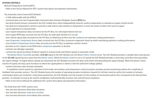

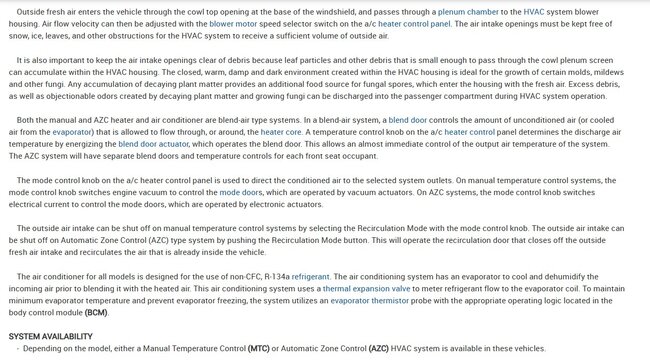

So, that looks like you can set the temperatures different per each side of the vehicle, so that would be the Automatic AC System. It sounds like there might be a restriction in the system, if 75 PSI is with the compressor engaged, that's a pretty high reading for the low side. At around 70f, and I assume this is R134, you should see about 30-40 PSI roughly, and around 150 on the high side, so you may find that the high side is low in this situation, I know that sounds a bit confusing, but with a restriction in the system your pressures will be off.
This is the list of sensors and how data is used for an automatic system, there's a number of temperature sensors, and if you have a scan tool that can read BCM trouble codes or other module fault codes there might be some set that you're not seeing with a basic OBD2 scan tool. A full system scan may reveal other trouble codes and usually does. I rarely do a full system scan and see a clean report with no codes set. Even engine temperature is used, so I would get that under control first.

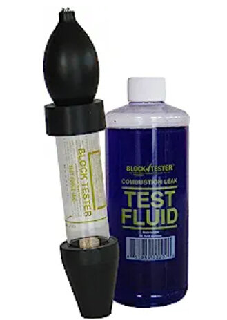

If you suspect a head gasket issue, you can run a chemical head gasket test, or most of the time I just open the radiator in the morning when the vehicle is still cold from overnight, and watch for bubbles of compression gases coming out of the radiator opening once the engine is started. (2nd picture is a chemical head gasket test).

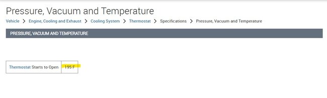

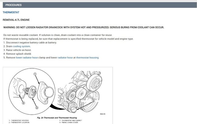

What is normal operating temperature of a Jeep?
What is the thermostat OEM recommended temperature?
When I was driving the engine temperature went +220 degrees. I had to turn the heater on to cool it down. and after shutting it off the engine the coolant was boiling in the reserve tank.
I did not replace the thermostat yet.
The jeep is equipped with hydraulic fan.
Oct 17, 2024 at 6:50 AM
AL514
  • 5,685 POSTS

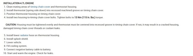

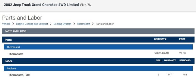

Here's the OEM part number if needed, it should open at 195f. Along with the replacement procedure as well. On the 3rd diagram, notice the position where the small hole on the thermostat is located, it's for letting air bleed out of the system after you replace it. Just make sure the new thermostat is positioned the same. You don't want to keep driving it in that condition, with over heating so much it will eventually warp the cylinder heads from such high temperatures and cause other problems.

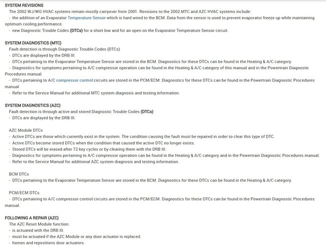

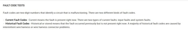

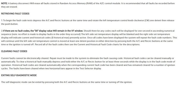

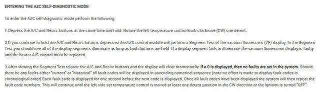

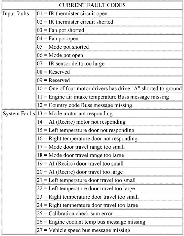

I pulled codes from Ac/heater unit by pushing simultaneously on A/C button and recirculation button. the codes are:
12
29
30
32
52
I don't know if some of them cause A/C not working. Also, FYI yesterday i disconnected the transducer to check for 5 v reference and ground. also, i disconnected the A/C clutch relay to check powers and grounds.

Okay, cool. I didn't even know you could pull codes with that method, good deal, there is a list of two-digit codes for the Automatic zone control system, which is the HVAC control unit in this vehicle. This is the self-test method if you need it for future use. I'll post the list of codes next. I assume your 5v ref and ground were good.
Oct 19, 2024 at 4:09 AM
AL514
  • 5,685 POSTS

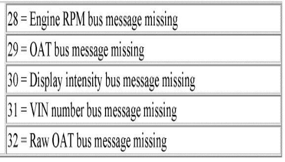

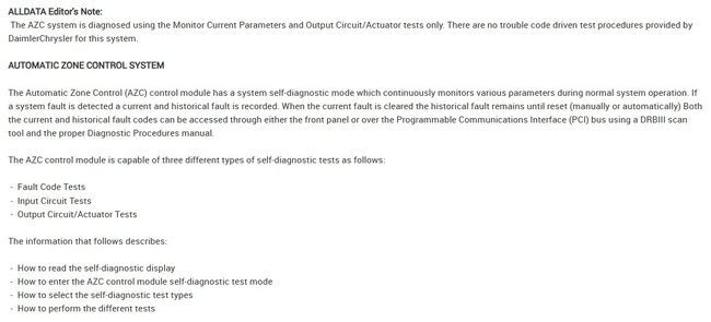

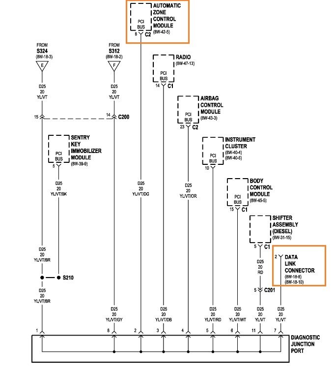

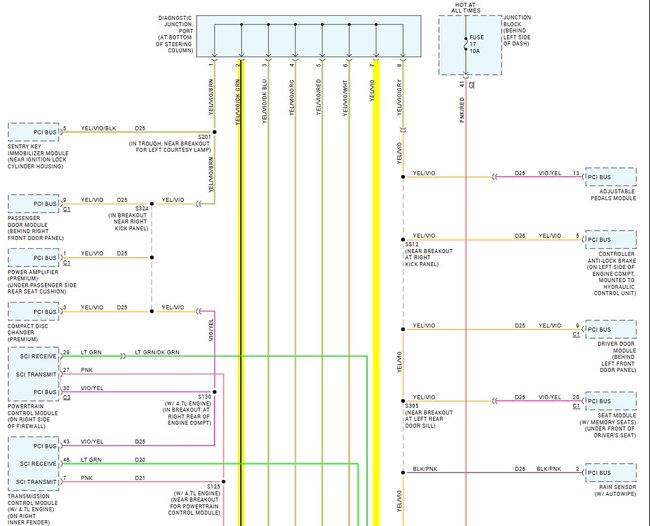

Okay, this is pretty crazy, but you can actually run self-tests on the HVAC system just by the same method you did to retrieve the codes, this is the first section that came up so read through these carefully. Some of the 2nd section is repeated I think but that's okay, I'll post that next, But the code 12, 29, 30, and 32 are the codes that are in the "Current" List, so happening right now, from codes 33-60 they are Historic codes, so stored in memory.
Oct 19, 2024 at 4:33 AM
AL514
  • 5,685 POSTS

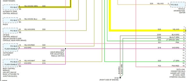

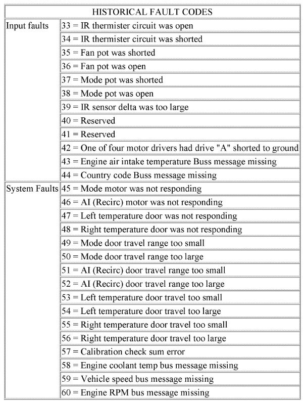

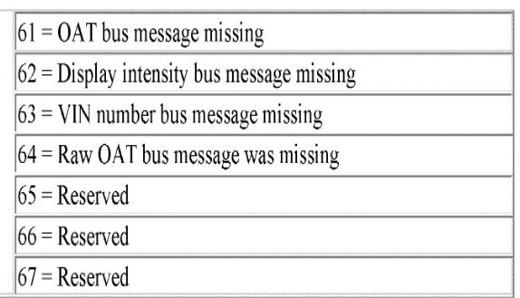

This is the list of Current codes, and it looks like there is actually some sort of network issue with that hvac controller. So these can be either a wiring issue which is only on a 1 wire PCI bus. Which is just a 0-7v roughly message. 0-7volt square wave signal, which you wont be able to see with a multimeter but you could check the network for either a short to ground in which it would read 0volts, or a short to power in which it would read battery power (12v) or 5volt if it is shorted to a 5v Ref.
12 being Country code buss message missing,
29 OAT bus message missing
30 Display intensity bus message missing
32 Raw OAT bus message missing
Oct 19, 2024 at 4:41 AM
AL514
  • 5,685 POSTS

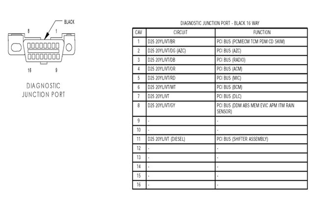

These are the Historic codes, the 60 is the Engine RPM bus message missing, but this can be caused by just network activity missing altogether.
There is a huge list of self-tests you can run through the HVAC controller, but with these codes you're not really looking at a one component fault, these are all communications codes setting, which will cause the system to go down apparently.

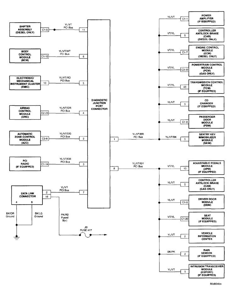

They have the Data link connector and this large splice pack "Diagnostic Junction Port" labelled as the same thing, so you'll have to look and see if there's actually 2 connectors or just the one DLC. According to their diagrams everything on the PCI bus goes to pin 2 of the DLC (diagram 7). It's a bit misleading.
Oct 19, 2024 at 4:58 AM

sorry, I am lost. Winter is coming so i am not worried about A/C. The biggest problem now is the overheating and the most important is now all power windows are not working from all doors i cannot roll up or roll down windows. door locks and mirror work from all doors.
i fixed on the driver door jamb side the harness the power and ground were broken but still no power windows from all doors . i do not know how to proceed .i guess i need a wiring diagram, sorry.
Oct 19, 2024 at 9:46 AM
BENEFITS1976
  • 38 POSTS
Okay, updates. I disconnected battery negative .after reconnected it guess what ac is working and power windows are working again.
do you think why is overheating too . maybe the PCM does not send enough signal to the hydraulic fan solenoid to turn the fan faster.

no need of diagrams power windows are working. thank you. I believe it was a network problem. because the AC and power windows stop working at the same time and the ac had those codes . After disconnecting the battery everything went back. What can causes that a bad ground or one of the modules or what else ?. i ordered a thermostat and a water pump i will replace both . the one on the truck is a GMB brand water pump i heard bad things about it. also, i believe the thermostat installed in the truck is faulty because when the temp of the coolant was 207 the upper hose was hot the bottom was cold.
Oct 21, 2024 at 4:41 AM
AL514
  • 5,685 POSTS
Networking issues can happen for any number of reasons, I had a 2017 Ford F350 yesterday that was setting all kinds of strange codes after a wire repair, and just clearing the codes and then key off for a few seconds, and everything was back to normal, this truck has a couple of bad batteries though as well, they lose voltage quick with the key On, but you could go around the engine compartment and check the grounds on the engine block and to the body/frame. If they look dirty or have any green corrosion, I will usually just clean them up really good and bolt them back down, grab some electronics cleaner from AutoZone, it's really good for corrosion and just cleaning terminals in general. When you take the thermostat out, take a couple pictures of it so I can see if there are any of the sticking type of marks on the middle section.

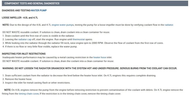

Okay, I will check. However, I will replace it with one that has a metal impeller. GMB brand has plastic impeller. a guy on YouTube said his Jeep Commander overheated because of a GMB water pump that was installed by a Jeep dealer. the plastic impeller was slipping on the water pump shaft.
Oct 22, 2024 at 1:13 AM
AL514
  • 5,685 POSTS
It's a terrible design for water pump to have plastic impeller. Hope it goes well with the change.

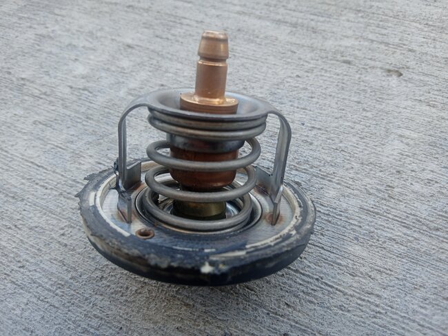

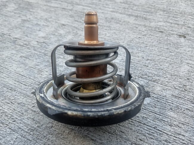

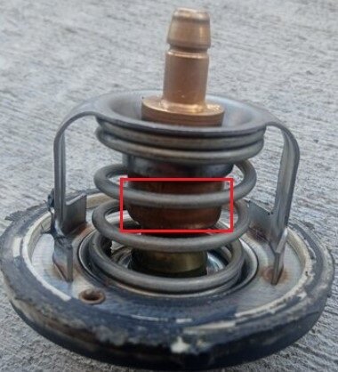

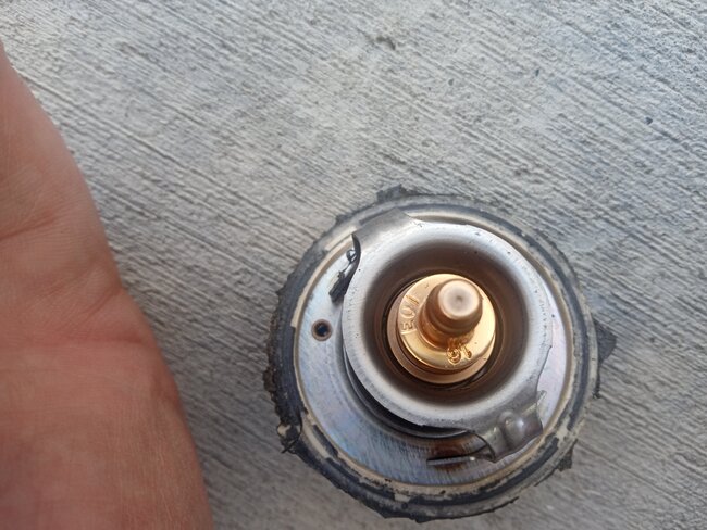

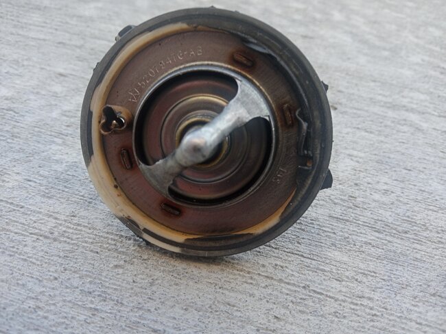

these are pictures of the old thermostat. it's Chrysler part#52079476ab
Oct 23, 2024 at 9:26 AM
AL514
  • 5,685 POSTS
So, I look for any scratch marks around the area (in Red) where that pintle moves threw that upper section, if it was sticking closed at some points there are usually vertical scratch marks where it jams up when trying to open. You can always boil it in a pot of water as well, water boils at 212f so it should open fully just before boiling point. Looks like some nasty gasket material there too. But let us know if you are still having an over temp issue. Hopefully a new T-stat should resolve the problem.

I took the car for a short drive uphill. same way before when engine temperature went up to 220. The maximum today I saw was 208. However, today's weather is cool 53 degrees. so, i do not know if it is fixed or not. I replaced the water pump and thermostat. I used OEM thermostat from dealer and a Gates water pump with aluminum impeller.

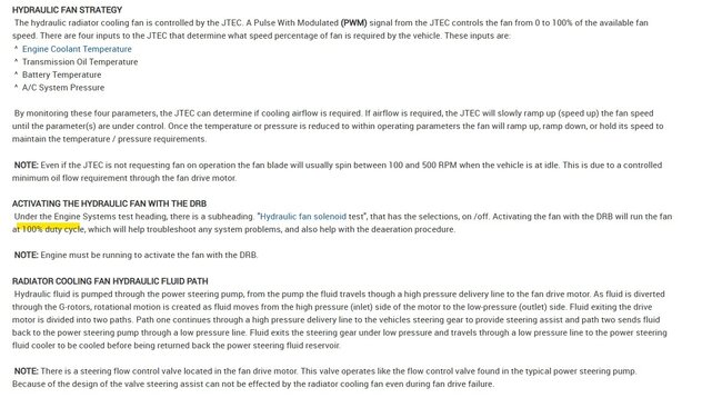

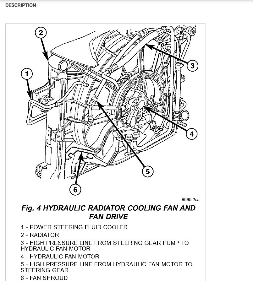

so what is the operating temperature of the jeep aka the maximum temp that can go before the fan speed up and cool it down. btw it has a hydraulic fan .which run with power steering fluid which i replaced with Chrysler fluid.
Oct 27, 2024 at 6:37 AM
AL514
  • 5,685 POSTS

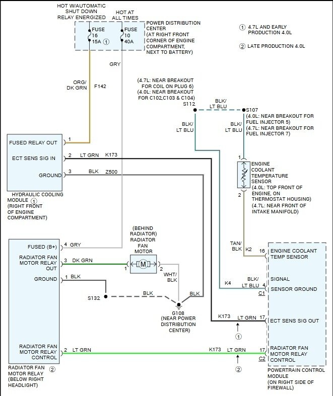

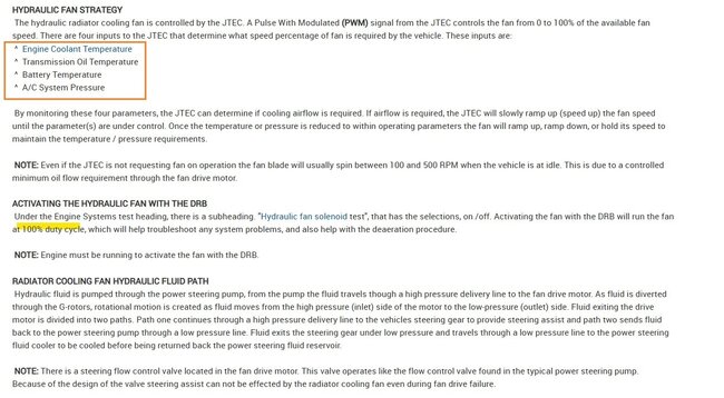

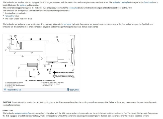

I'm not seeing a spec on that temperature, but if the engine is reaching temperatures that high the fan should be on full high speed. There is a bulletin for an updated Hydraulic Fan Solenoid, it should be setting a code for this bulleting (diagram 1), the hydraulic fan can also be bi-directionally controlled with a scan tool, and be set to 100% duty cycle for testing. That is what service info instructs to do. There should also be a live Data PID for the fans current duty cycle and the speed it is running at the time of monitoring. Have you done a chemical test yet to rule out any head gasket possibilities yet? Or any bubbles coming out the radiator opening?

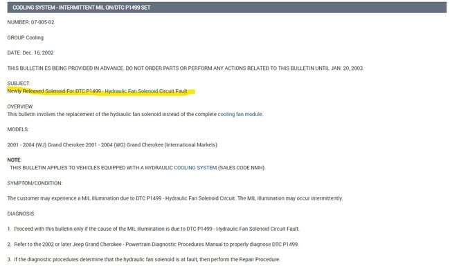

The wiring for the Hydro Fan only shows power, ground, and the control wire from the PCM which is going to be a pulse width modulated control signal (Duty Cycled) to operate the Fan Solenoid.. With this system you need scan data to see what the PCM is seeing, and this should show if a skewed sensor is causing the fan to not operate on High or if the PCM is commanding it at 100% and it is not reacting to that command, obviously it is reacting to AC pressure, but there are 3 other inputs the PCM is monitoring when it comes to fan operation. I would have a full system scan done to see if there are any other codes stored in other modules. At 220 to 230 the fan should be on high, if the thermostat is only a 195f degree, it should be wide open and the fan should be blasting on high speed. Are both the upper and lower radiator hoses getting hot?
And do a head gasket test.
Oct 28, 2024 at 6:35 AM
BENEFITS1976
  • 38 POSTS
there is no code for the hydraulic solenoid. I disconnected the engine temp sensor connector when the engine was running. the fan went on very high speed. When I bled the coolant at first was bubbles in the funnel but after that they stopped. even if head gasket is bad the fan should run faster, right? however, what I saw yesterday when I was watching the engine temp. that the temperature on the code reader went for a fraction of second from 210 to -0. yes, both houses are getting hot.

So you may be dealing with a wiring issue to the coolant temperature sensor, usually in scan data when you unplug a temp sensor, the live data will read -40 degrees, its the reading the PCM will detect when the circuit goes open, such as when unplugging the sensor, you can try wiggling some of the harness and watching the temp sensor data for any glitches or drop outs. Yes the fan should be running on high at those temps, if you have a temperature measuring tool to see if its actually getting that high, I would check that.
You can also unplug the coolant temp sensor and check the voltage across the 2 pins in the connector for the sensor, when unplugged and Key On, engine off it should read 5volts. The sensor works off a 5volt reference. It possible youre not getting the actual temperature if the sensor is bad or the wiring to it has a problem, just dont spread the pins inside the sensor connector when testing,.

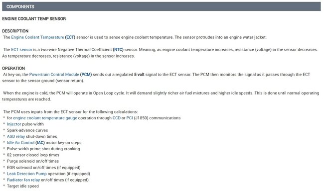

225 seems a bit high to me, heres a little more info on the ECT sensor operations. Does your scan tool have the ability to graph the sensors voltage signal? I have a very old OBD2 scan tool from way back that only reads engine data but surprisingly is able to graph sensors, that way you might be able to actually catch a drop out in the sensors signal.
You can also try a wiggle test of the sensors harness when its plugged in and the engine is running. You may see it glitch out more in that case. Going to a negative number like that is usually almost always the circuit going open, Which is why I asked about the sensors data going to -40 when unplugged. Thats a default temperature that thermistors go to when unplugged, even the intake air temp sensor should do the same for example.
