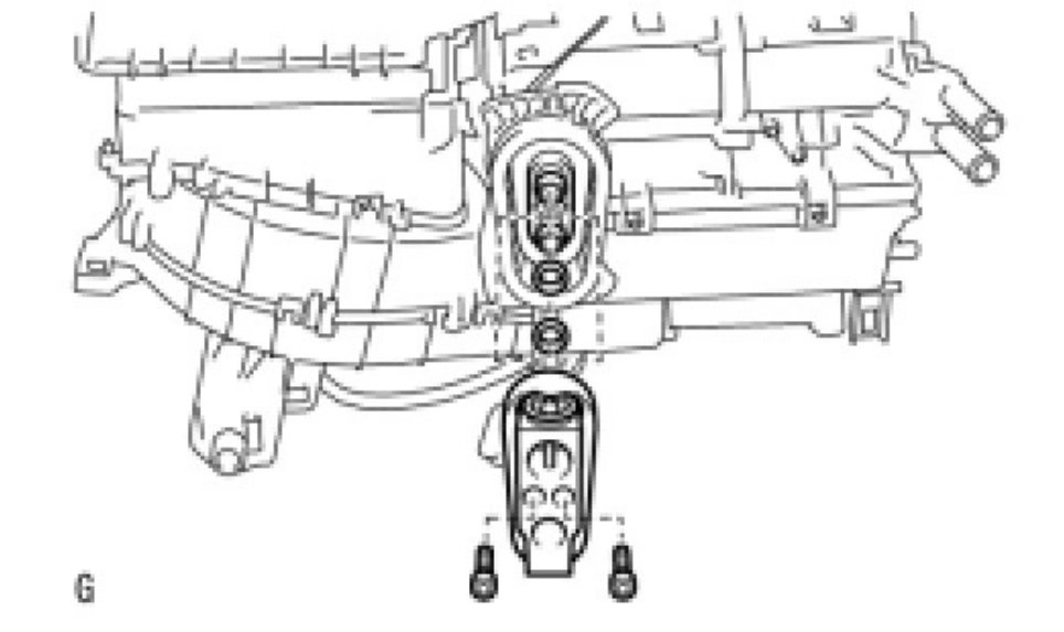

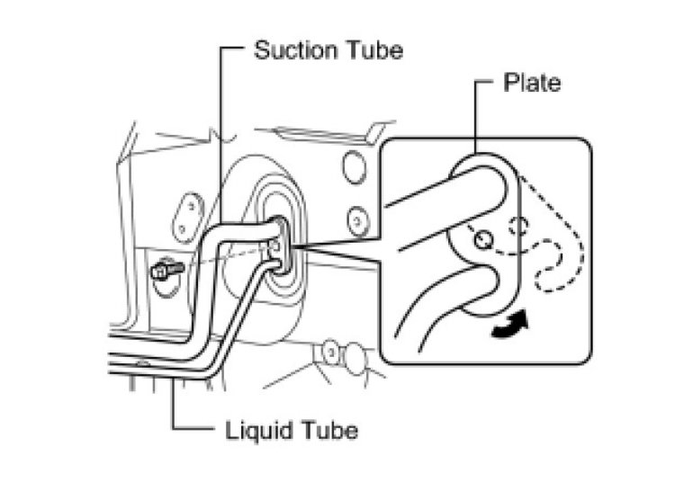

It is done from under the hood at the firewall. Recover all the Freon, remove the bolt that secures the two lines to the expansion valve and then remove the two bolts that hold the expansion valve to the EVAP core.
Make sure you change the dryer as well.

Great. Does not look too hard. Thank you for all your help! I will order the parts and report back when I get it done!

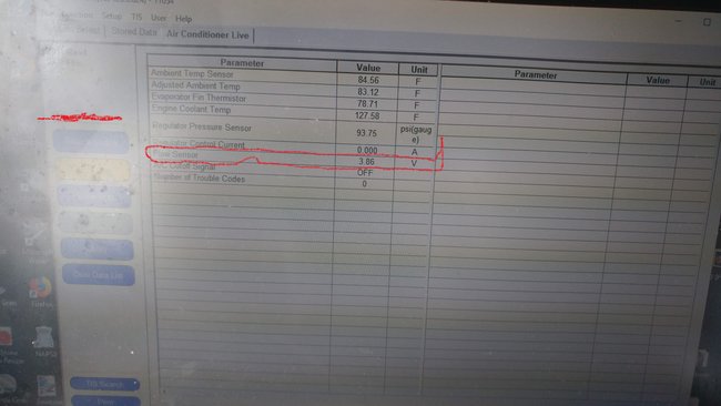

2011RAV4
  • 10 POSTS

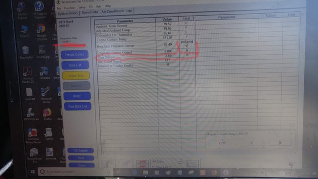

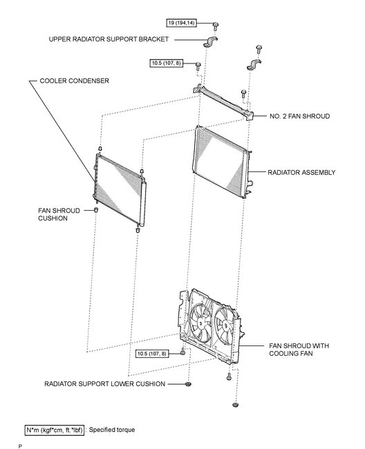

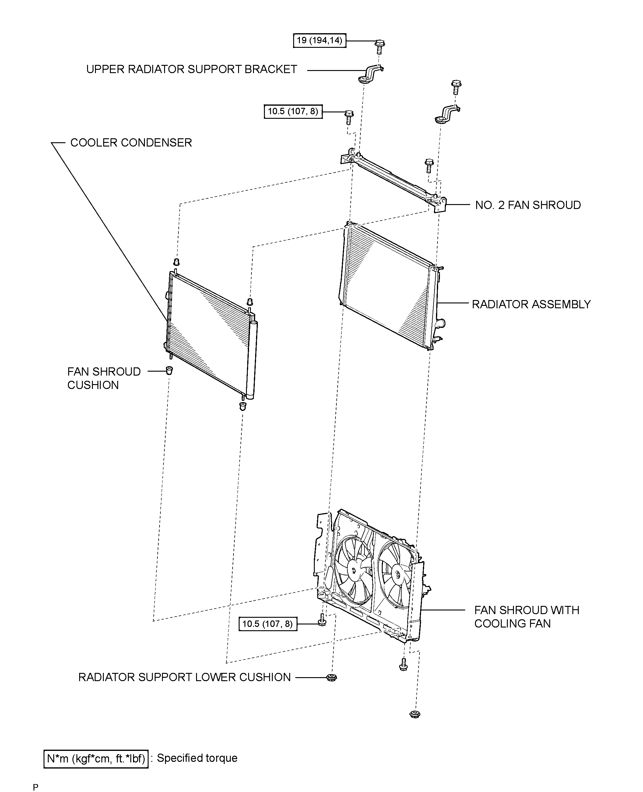

Hi, Sorry it took so long for me to get back to you! I changed the Expansion Valve and the Compressor still didn't turn on. After researching the problem so more I found someone who had a Lexus who had the same problem and also got the B1479 code. Toyota has a TSB about it T-SB-0084-13. The Flow sensor has to have 3.8v with the AC OFF in order to have the amplifier tell the compressor to kick in! (mine was 3.59v) Toyota recommend changing the compressor because they don't sell the Flow sensor! I was able to find the Sensor on ebay for $50 and decided to try and change it myself!
I had to take off the front bumper, ac condenser(replaced drier) and radiator to get easy access to the Flow sensor on the compressor ( you may be able get to the sensor by just taking out the radiator) . I took the snap ring off the sensor and tried to lift up the sensor but it was frozen and broke off when I pulled up on it. I had to use a chisel to get the rest of it out. I noticed there was a lot of what looked like white rust or corrosion there so I scrapped out what I could and sanded it down so the new one would seat properly ! ( maybe The white rust was making the sensor not read correctly?). I got the new one in and put the snap ring on and then I checked it with Techstream and got a reading of 3.86v.(above the 3.8v min needed)! My old one was 3.59v!
I put everything back together and charged the system and the AC works now. A lot of work for such a simple part! I read the problem is with many Toyota models and years starting in 2009! Crazy how they let the problem last so long without addressing it and making people pay for a new compressor!
I just thought I would let you know in case someone else runs into the same problem!
TSB https://static.nhtsa.gov/odi/tsbs/2013/SB-10061590-2280.pdf
Here's a couple of pictures of the before and after Techstream Flow sensor readings!

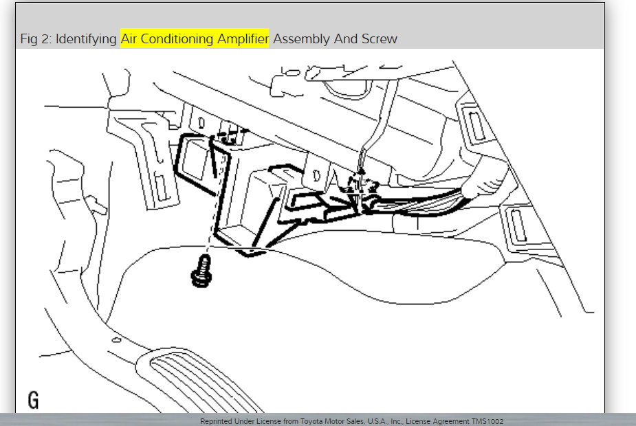

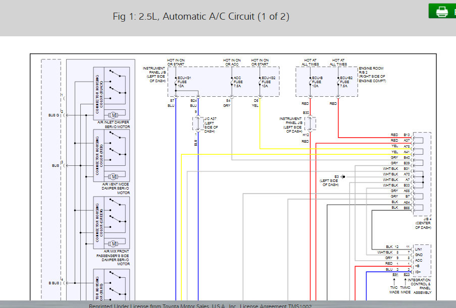

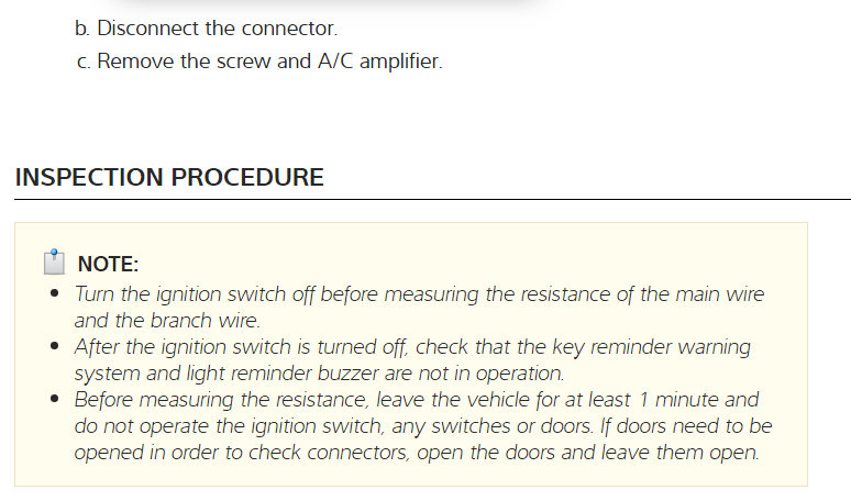

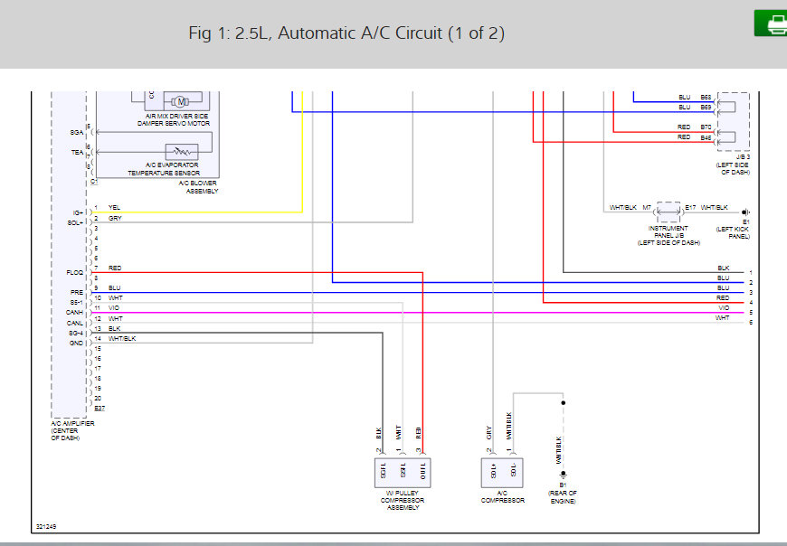

SCGRANTURISMO
  • 4,897 POSTS
Hello again,

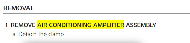

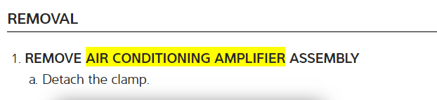

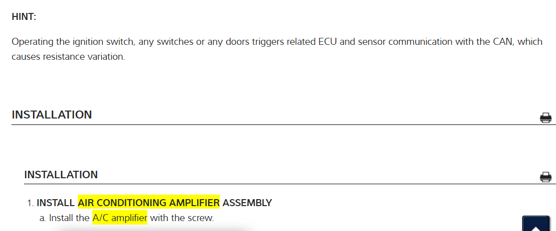

Okay, the problem could be in your vehicle's A/C Amplifier. In the diagrams down below I have included a wiring diagram of your vehicle's A/C circuit as well as directions for the removal, inspection, and installation of the A/C Amplifier, which is located in the center of your vehicle's dashboard. Please go through these guides and get back to us with what you are able to find out.
Thanks,
Alex
2CarPros

Good job.
I was more concerned that with the high going up to high, it would effect the signal voltage and that is why you had a bad reading with the old one.
If it did not change after the expansion valve replacement then the sensor was the next step.

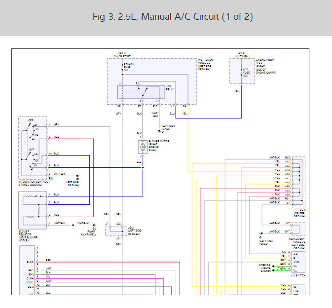

GARY HARTUNG
  • 5 POSTS

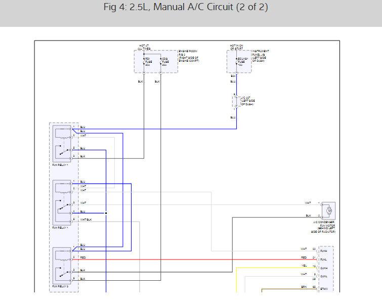

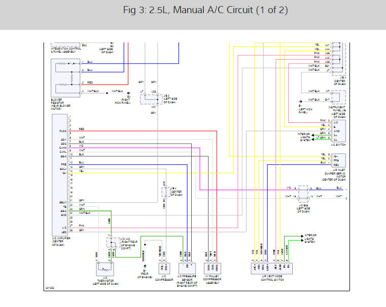

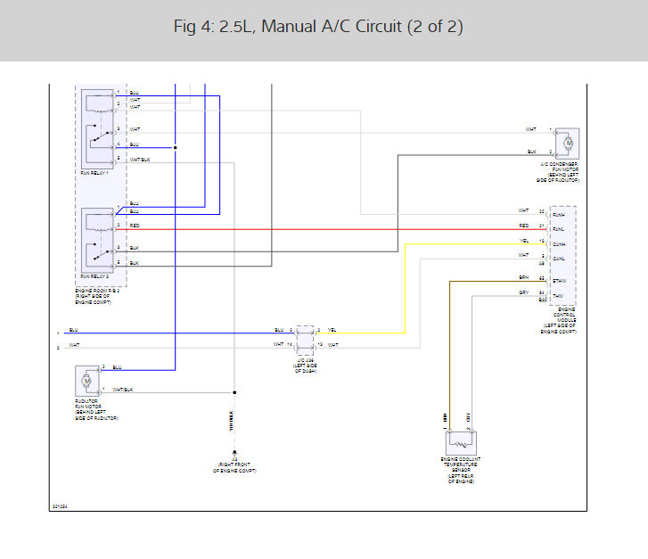

Checked everything still no A/C the diagram says automatic A/C is it the same for manual A/C?
Tuesday, April 13th, 2021 AT 10:17 AM (Merged)
2011RAV4
  • 10 POSTS
Just a clarification. The Flow Sensor needs to be checked with the AC off! Voltage has to be between 3.8 volts and 4.2 volts. If below that then the flow sensor is bad.
Thanks for all the help.

SCGRANTURISMO
  • 4,897 POSTS
Hello again,
I'm sorry about that. Here are the wiring diagrams for the Manual A/C. They are located, as usual, in the diagrams down below. Please go through them and get back to us with what you are able to find out.
Thanks,
Alex
2CarPros
