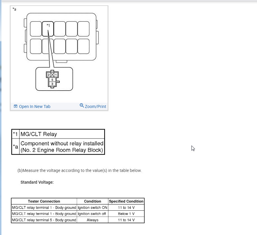

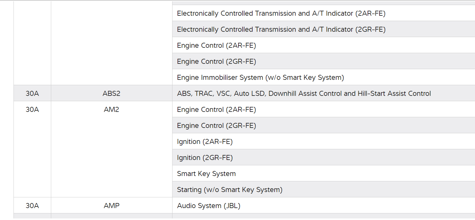

I was told to check relay no relay in spot (empty). all fuses okay. stuck don't know what to do.
May 30, 2020 at 3:47 PM
We need to start with checking pressures. If your system is low then the compressor will not come on. You need a gauge set that will test high and low side pressure. Let me know what they are and we can go from there.

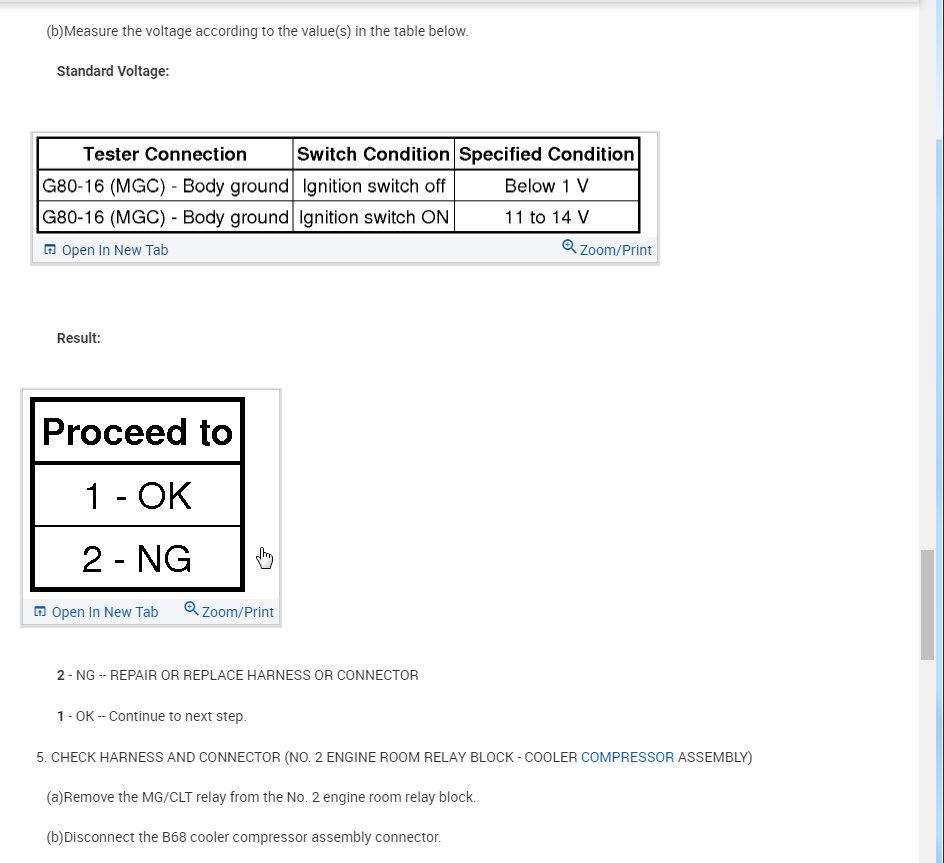

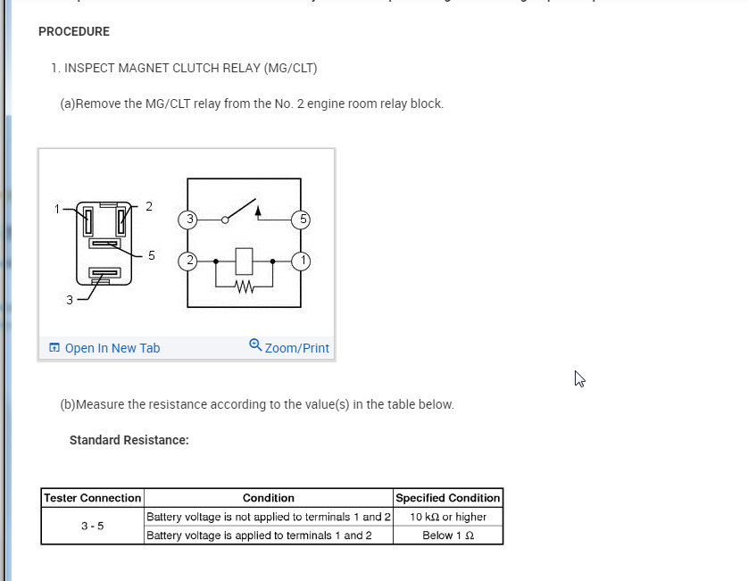

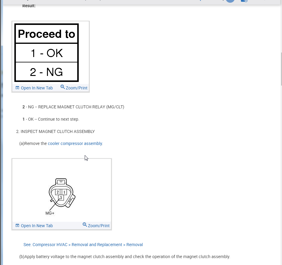

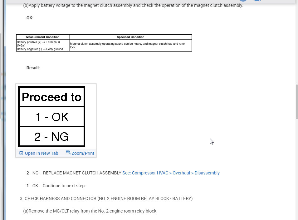

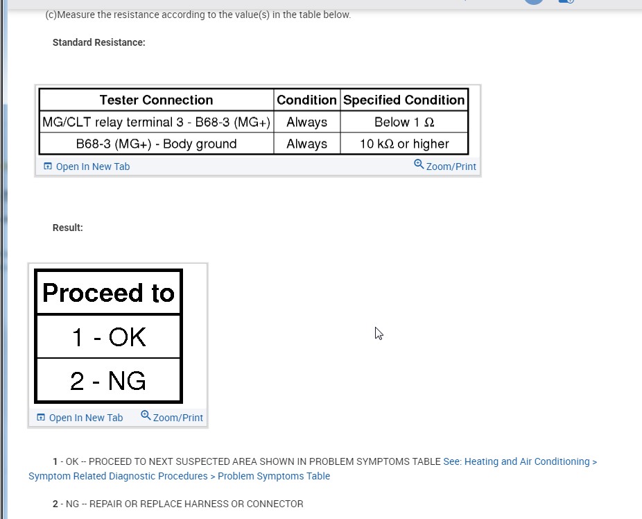

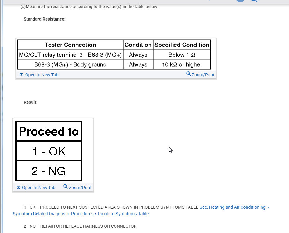

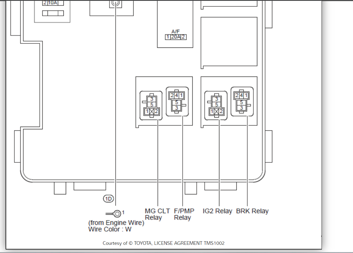

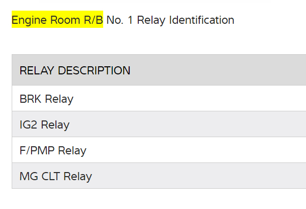

It appears your vehicle doesn't have a traditional AC relay. It calls it a MG/CLT relay. If you can locate this relay in the engine compartment fuse box (right side of the engine) we can check that as well.
I attached the info about this and the process to test it. If this is the one that was empty then we need to put a relay in and retest the system.

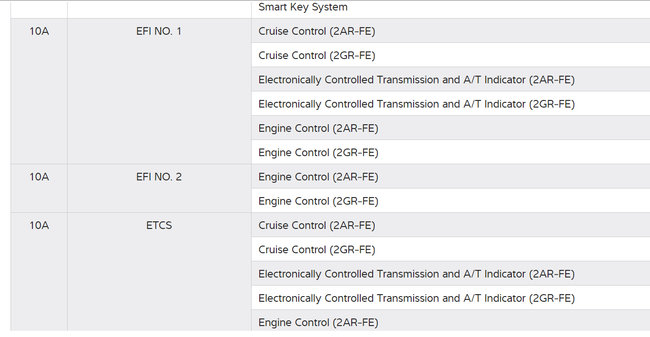

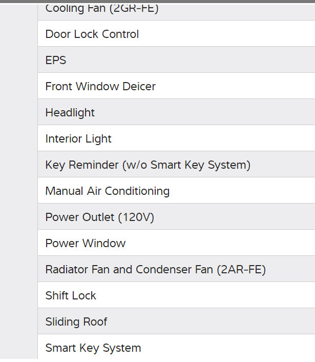

Did you check all fuses with a test light for power on both sides?

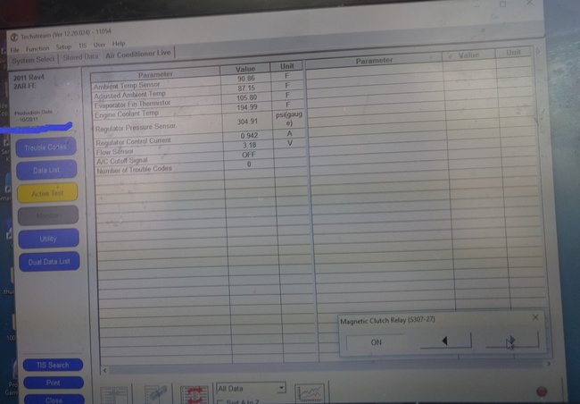

2011RAV4
  • 10 POSTS
Hi, sorry it took so long to get back to you. I checked all the fuses with the test light and they all looked good.

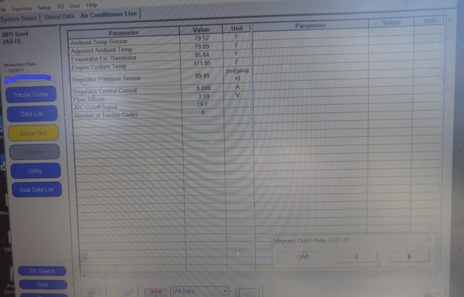

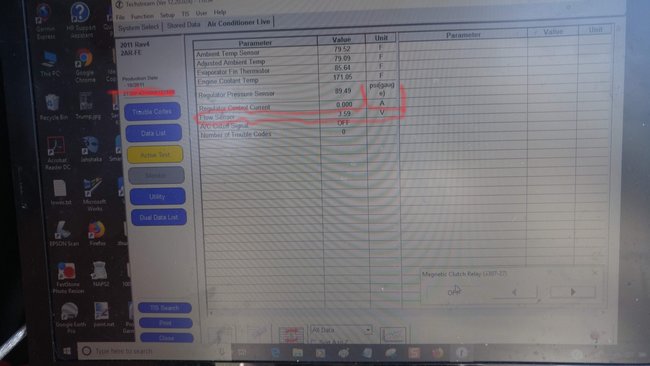

I was able to get a couple of pictures from Techstream that might help you.
The first one is with the ac on full but the clutch not engaged.
The second one is when I forced the clutch on with Techstream.
I noticed the pressure going up a lot on the second picture so I shut the clutch off. Also, both the fans on the radiator did not turn on at all and the air was not cold. I checked both fan fuses and they looked okay. I did not test them with the light because they are 30 amp box type and not sure how to test them. Any help would be appreciated!
Apr 13, 2021 at 10:17 AM (Merged)
Okay, that does not give me any pressure readings. I need pressure readings on the high and low side.
The AC may be off due to low Freon level or the low side pressure is below 20 lbs.

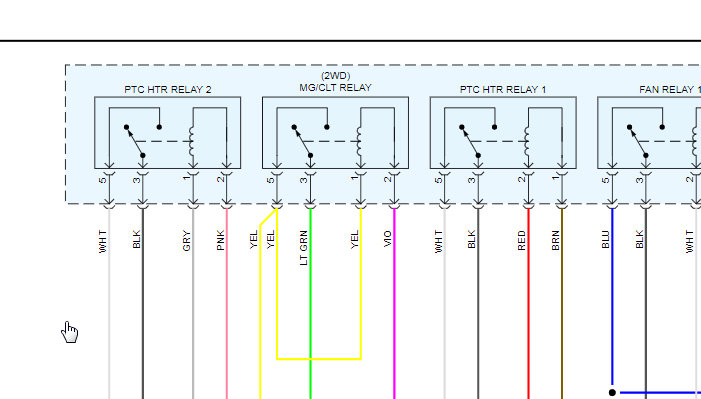

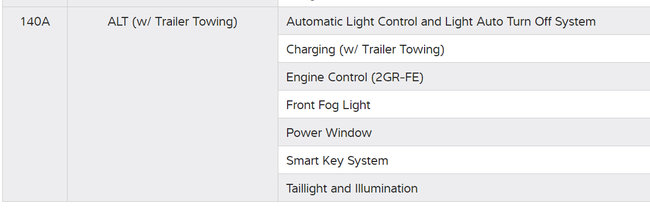

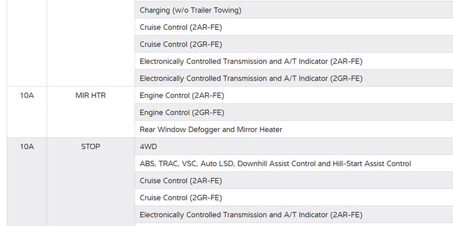

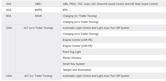

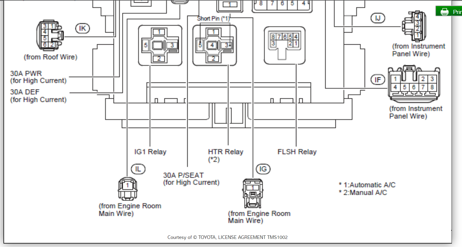

GARY HARTUNG
  • 5 POSTS

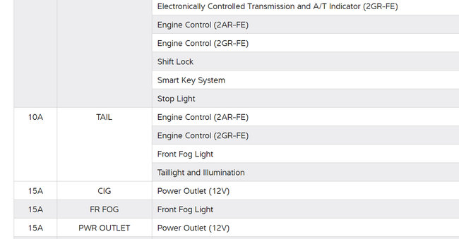

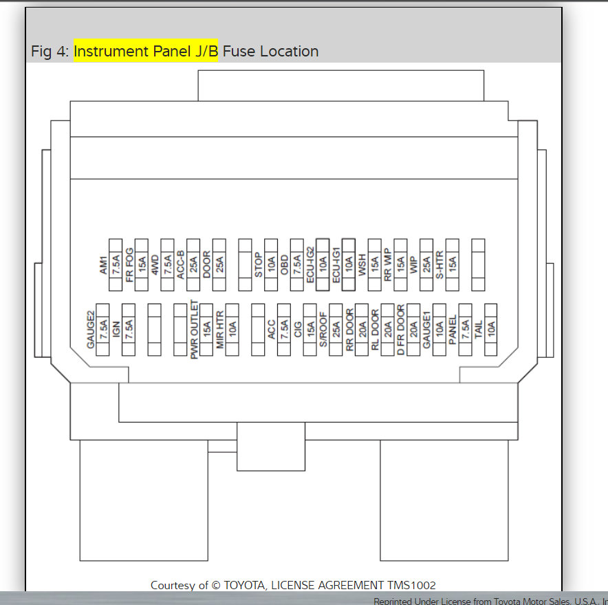

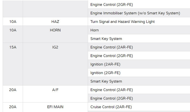

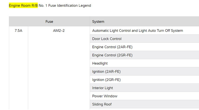

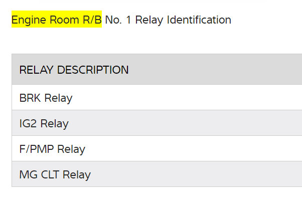

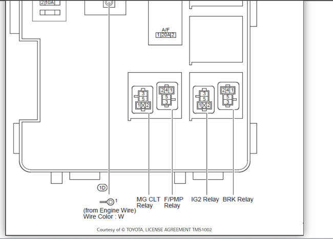

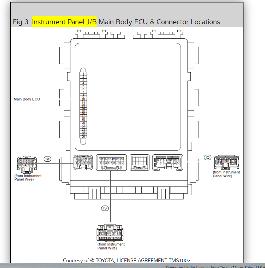

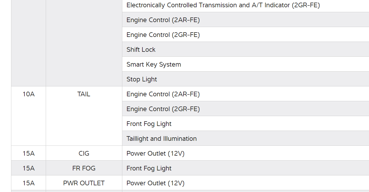

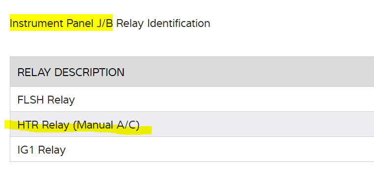

Looking for magnetic clutch relay where it’s supposed to be in fuse box is empty.
2011RAV4
  • 10 POSTS
Changing the expansion valve looks like a big job!
What about the trouble code of B1479. Would the flow meter cause the pressure to go up? I read about someone who had a similar problem on a 2010 rav4 with the clutch only going on with the Techstream program and they told him it was a bad compressor?

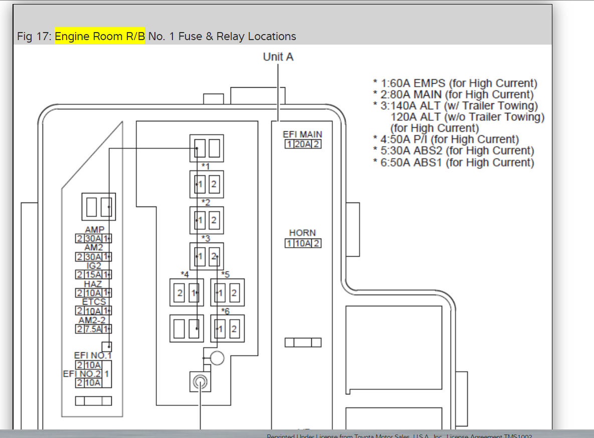

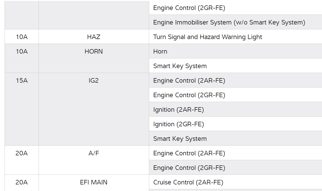

SCGRANTURISMO
  • 4,897 POSTS

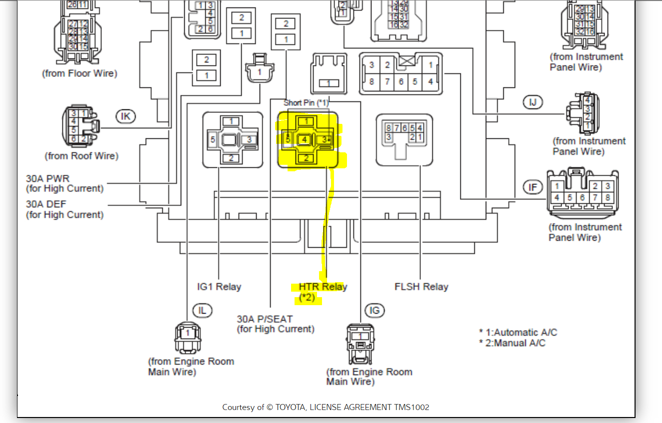

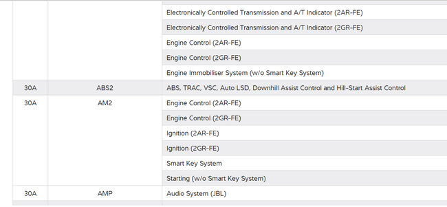

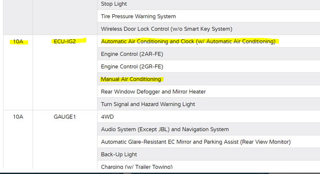

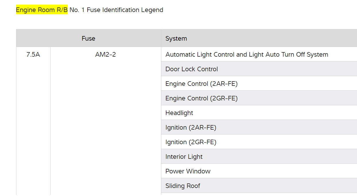

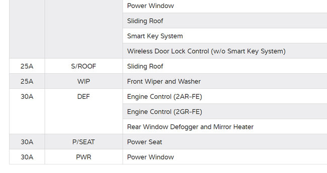

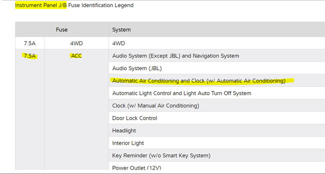

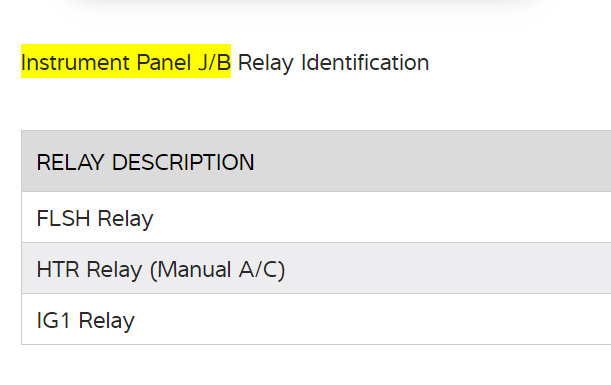

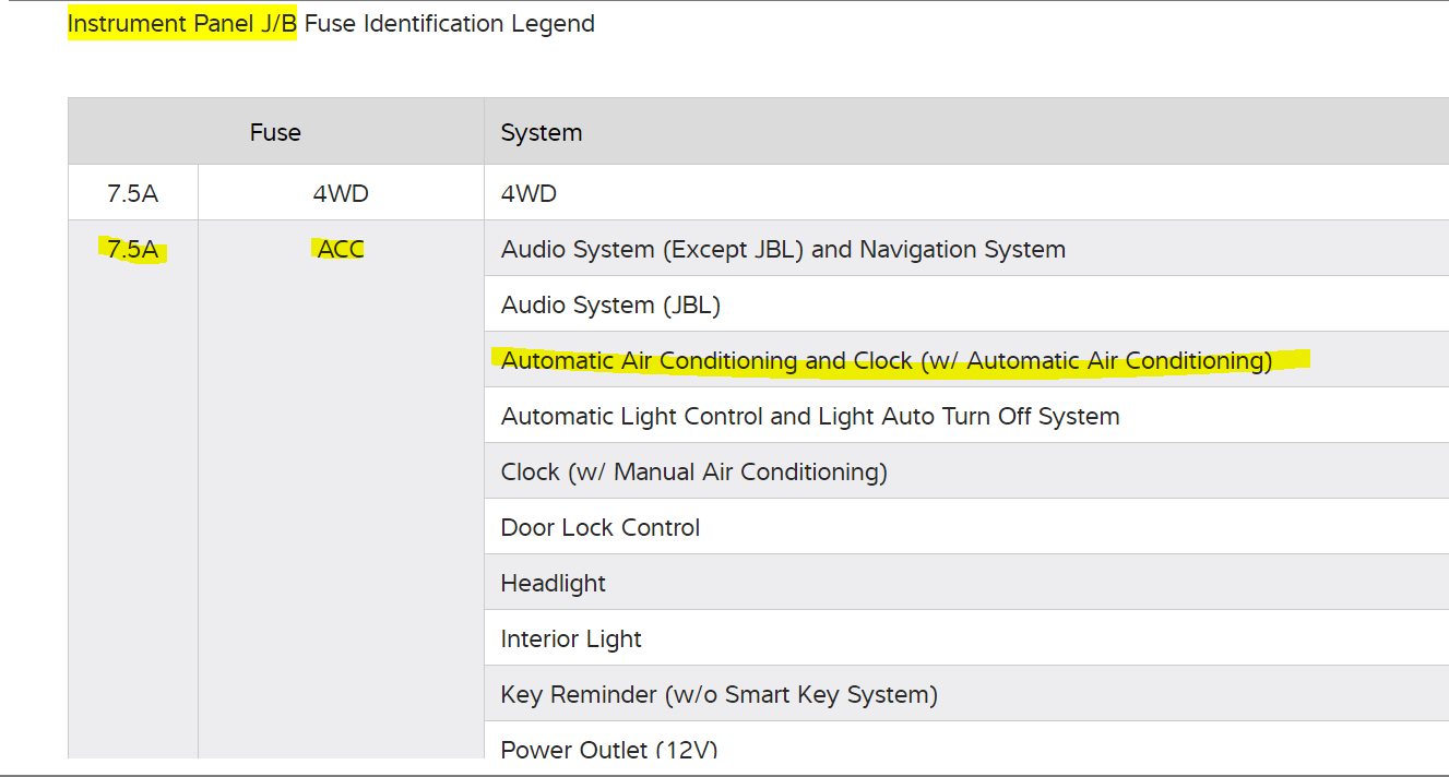

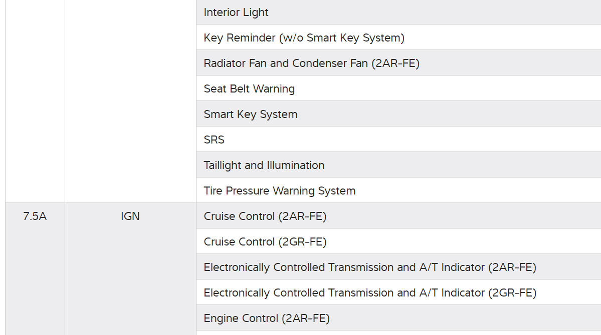

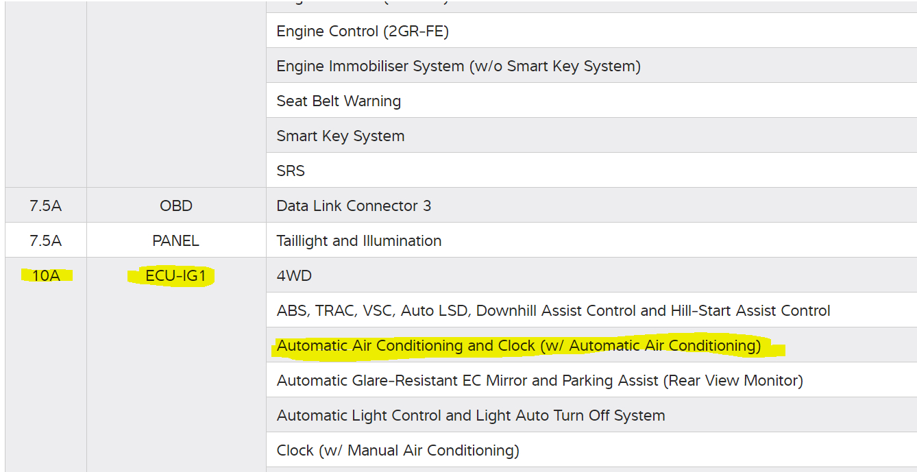

I have included in the diagrams down below your vehicle's J/B relay block where the A/C relay is located. I have it highlighted for you. It looks like it is a 5 pin relay that can be purchased at any auto parts store. Purchase the relay and plug it in. It only goes one way, and it should restore your vehicle's A/C system to operating conditions again. Please keep us informed.
Thanks,
Alex
2CarPros

That is not possible. If you command it on, then the compressor is good. It is the signal that is not activating the compressor.
B1479. I believe this set because you commanded it on and left it on. Doing what you did was intended as a test with key on engine off, not leaving the compressor run while the engine is running.

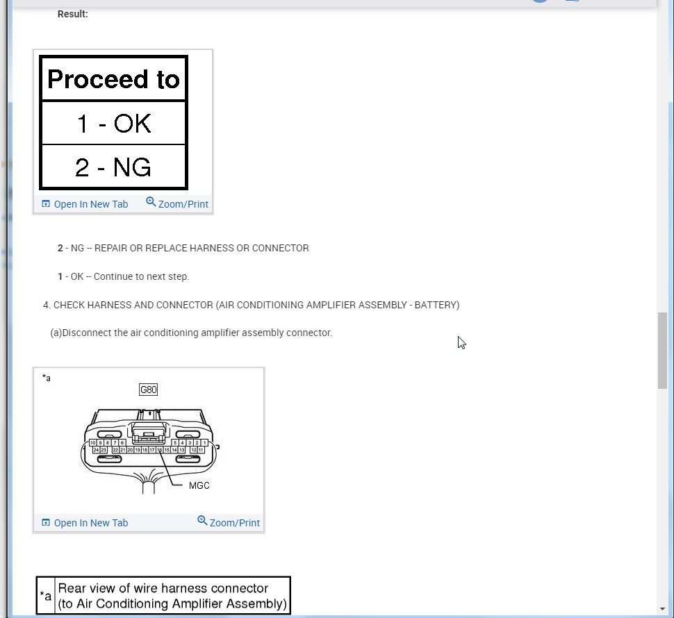

Air Conditioning Amplifier
Flow Sensor (Compressor and Pulley)
Harness or Connector Between Flow Sensor And Air Conditioning Amplifier

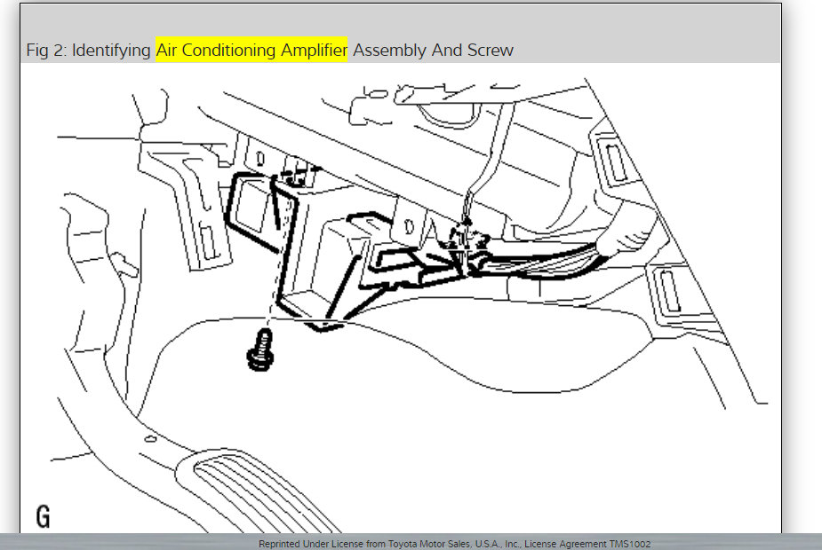

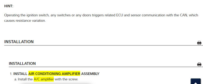

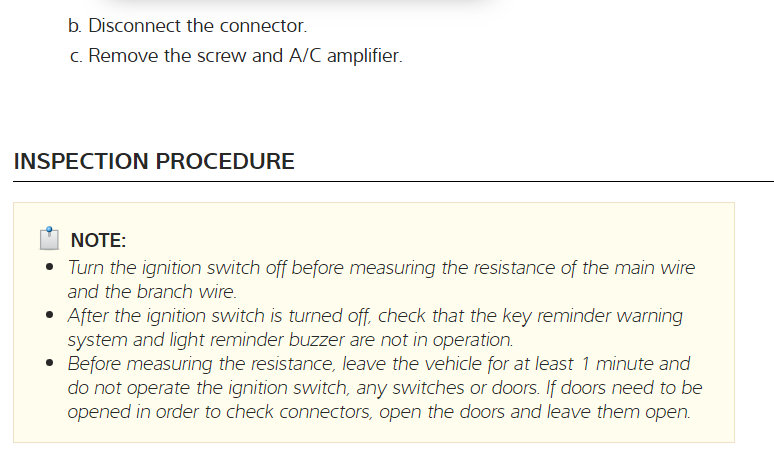

GARY HARTUNG
  • 5 POSTS

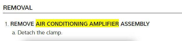

That didn’t work. where is the ac amplifier located?

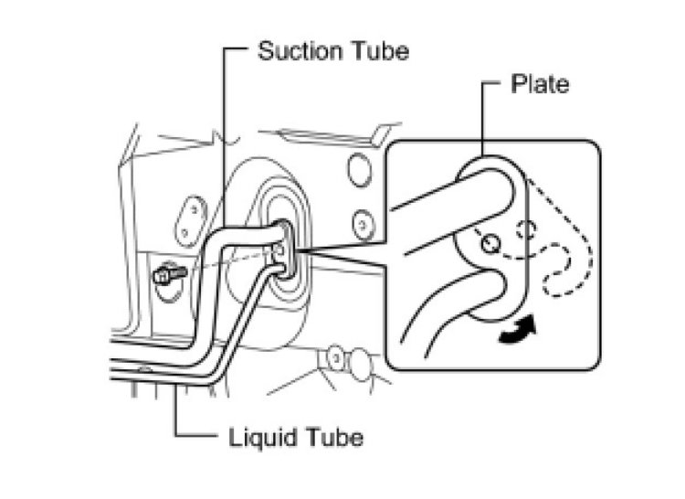

2011RAV4
  • 10 POSTS
Thanks again.

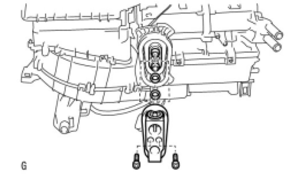

Do you know if the expansion valve on my vehicle can be taken out from the firewall side?
I could not find any videos on my make and model specifically, but some other ones show the bolts to get it off can be accessed from the firewall side while others show having to take if off from inside the car!

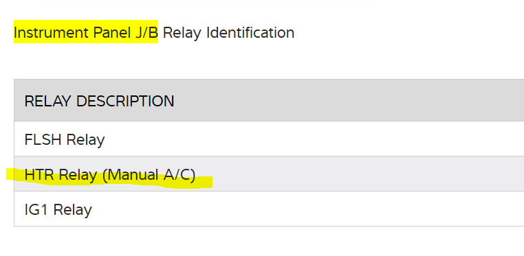

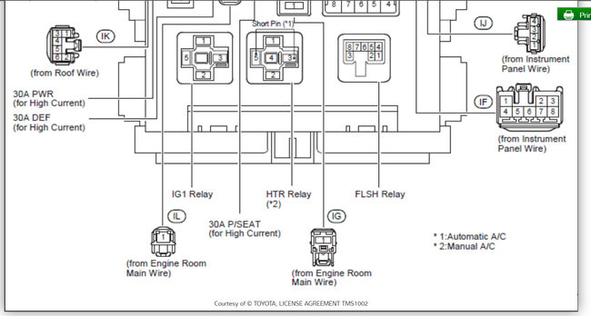

SCGRANTURISMO
  • 4,897 POSTS
Hello again,

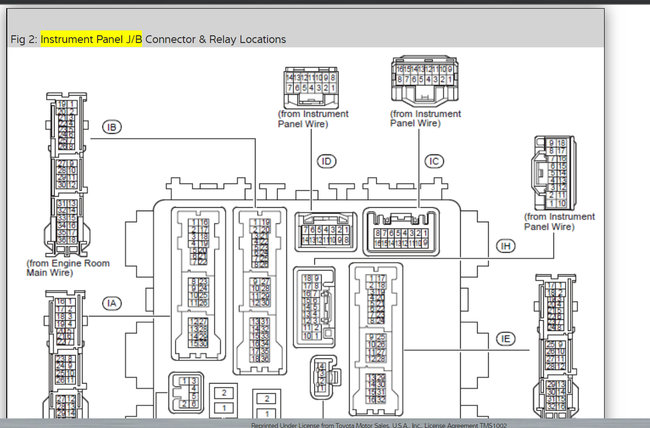

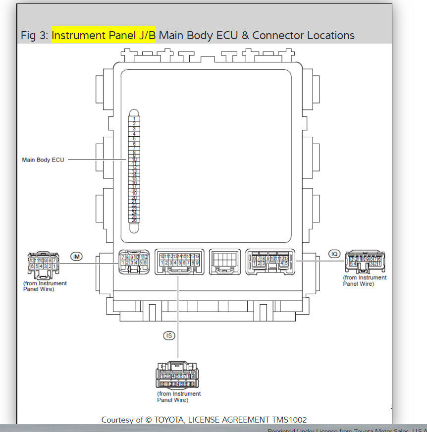

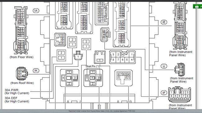

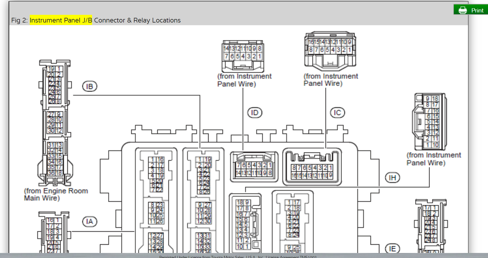

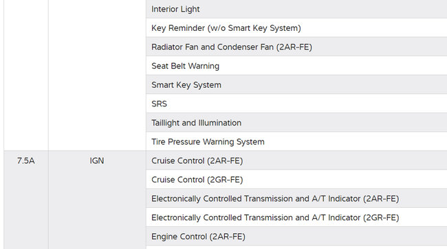

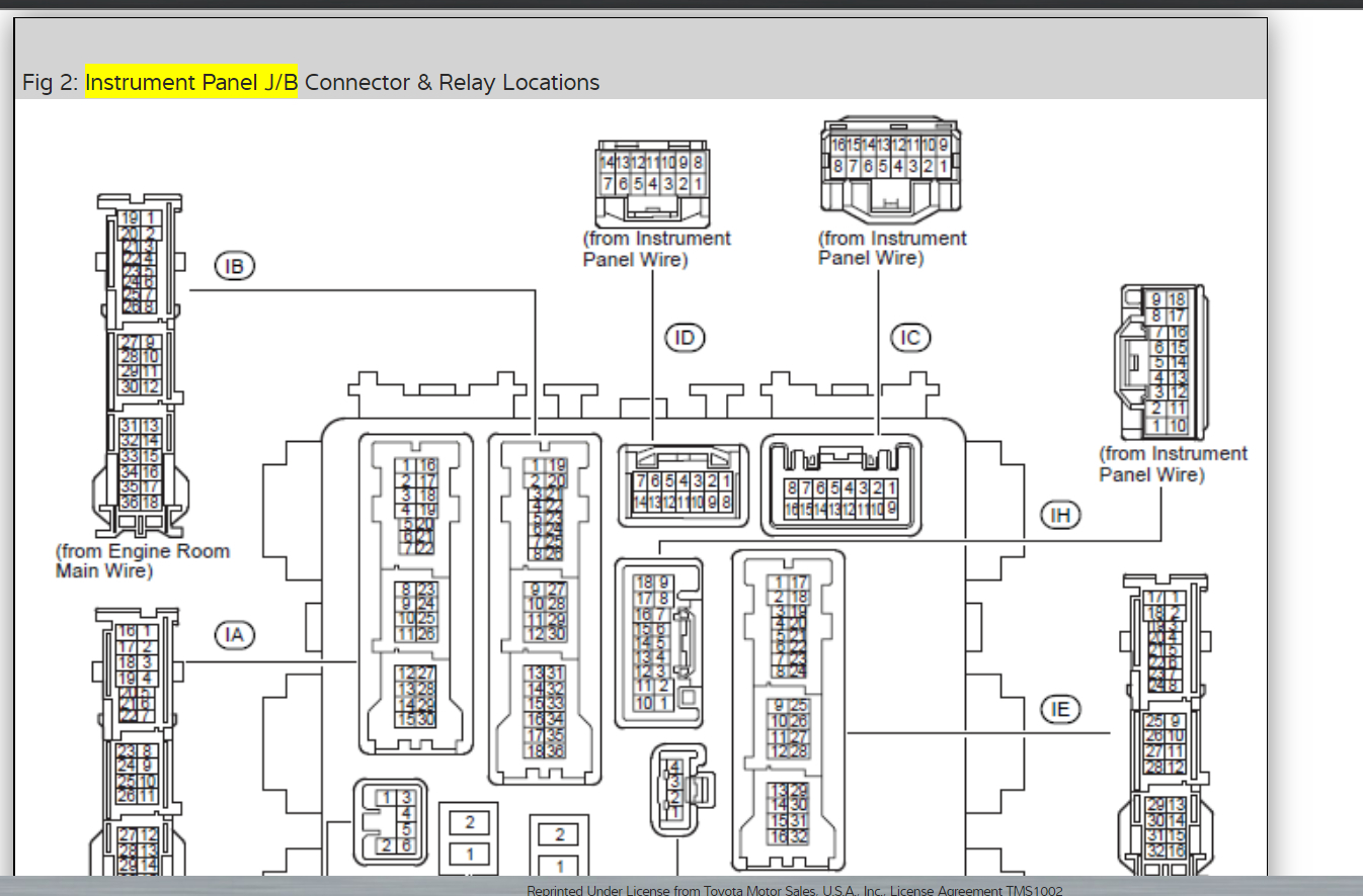

I have provided both the Engine Room R/B diagram and callout but also the Instrument Panel Junction Block diagram and callout for you in the diagrams down below. I have highlighted all of the fuses that have anything to do with your vehicle's A?C system. Please go through them and get back to us with what you are able to find out.
Thanks,
Alex
2CarPros
It is done from under the hood at the firewall. Recover all the Freon, remove the bolt that secures the two lines to the expansion valve and then remove the two bolts that hold the expansion valve to the EVAP core.
Make sure you change the dryer as well.

SCGRANTURISMO
  • 4,897 POSTS
This sounds like it could be the relay that controls your A/C compressor has gone bad. I have already given you the relay information in the fuse and relay panels diagrams and callouts earlier, so you should be able to find it there. Here is a link for you to go to that will help you, if needed, bench test the relay:
Please go through these guides, if necessary, and get back to us with what you can figure out.

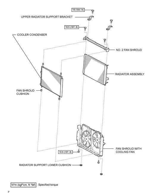

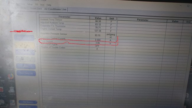

Hi, Sorry it took so long for me to get back to you! I changed the Expansion Valve and the Compressor still didn't turn on. After researching the problem so more I found someone who had a Lexus who had the same problem and also got the B1479 code. Toyota has a TSB about it T-SB-0084-13. The Flow sensor has to have 3.8v with the AC OFF in order to have the amplifier tell the compressor to kick in! (mine was 3.59v) Toyota recommend changing the compressor because they don't sell the Flow sensor! I was able to find the Sensor on ebay for $50 and decided to try and change it myself!
I had to take off the front bumper, ac condenser(replaced drier) and radiator to get easy access to the Flow sensor on the compressor ( you may be able get to the sensor by just taking out the radiator) . I took the snap ring off the sensor and tried to lift up the sensor but it was frozen and broke off when I pulled up on it. I had to use a chisel to get the rest of it out. I noticed there was a lot of what looked like white rust or corrosion there so I scrapped out what I could and sanded it down so the new one would seat properly ! ( maybe The white rust was making the sensor not read correctly?). I got the new one in and put the snap ring on and then I checked it with Techstream and got a reading of 3.86v.(above the 3.8v min needed)! My old one was 3.59v!
I put everything back together and charged the system and the AC works now. A lot of work for such a simple part! I read the problem is with many Toyota models and years starting in 2009! Crazy how they let the problem last so long without addressing it and making people pay for a new compressor!
I just thought I would let you know in case someone else runs into the same problem!
TSB https://static.nhtsa.gov/odi/tsbs/2013/SB-10061590-2280.pdf
Here's a couple of pictures of the before and after Techstream Flow sensor readings!

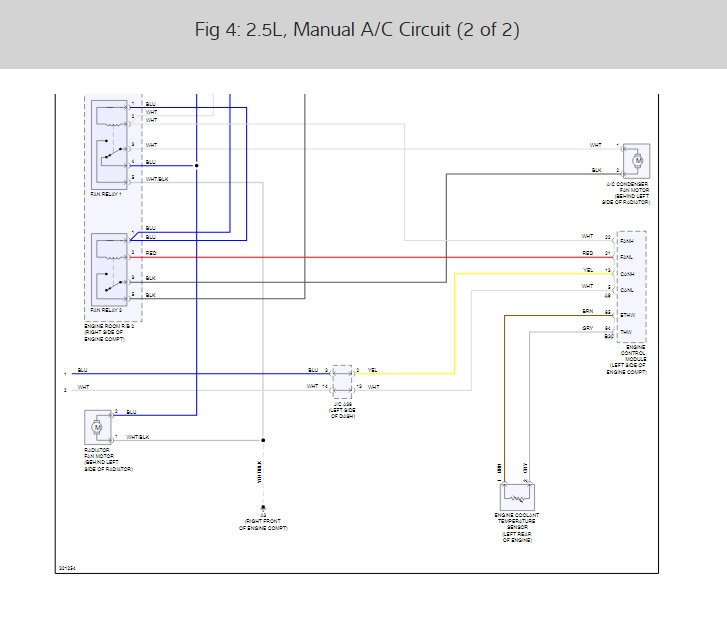

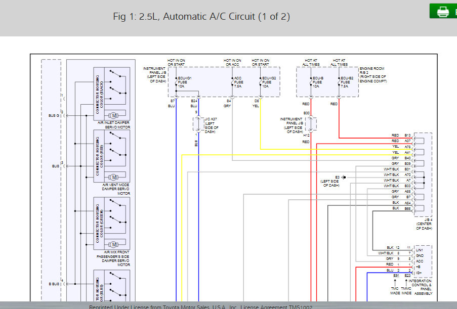

SCGRANTURISMO
  • 4,897 POSTS
Hello again,

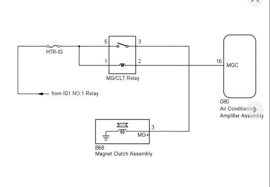

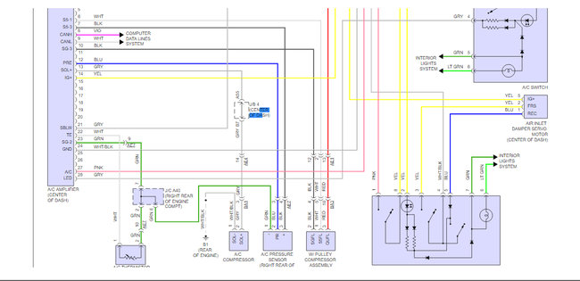

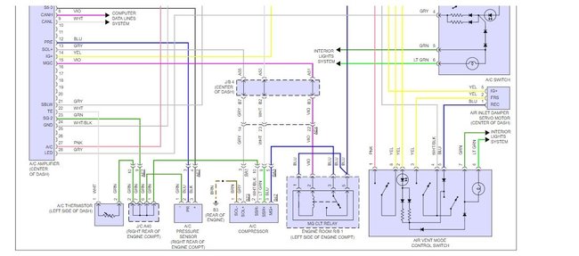

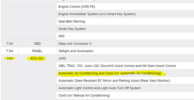

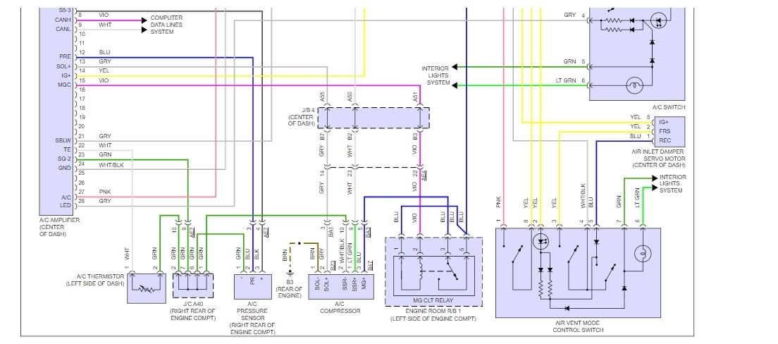

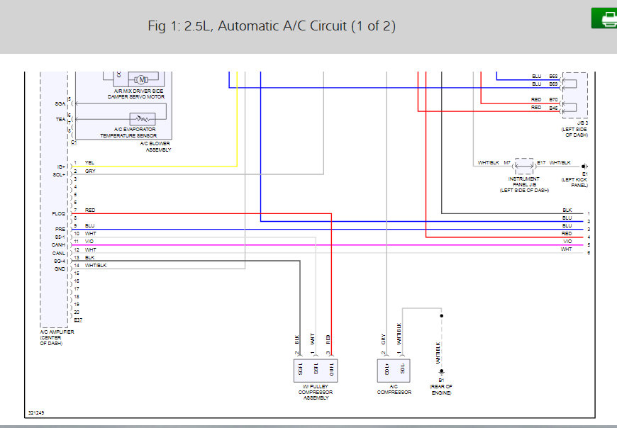

Okay, the problem could be in your vehicle's A/C Amplifier. In the diagrams down below I have included a wiring diagram of your vehicle's A/C circuit as well as directions for the removal, inspection, and installation of the A/C Amplifier, which is located in the center of your vehicle's dashboard. Please go through these guides and get back to us with what you are able to find out.
Thanks,
Alex

Good job.
I was more concerned that with the high going up to high, it would effect the signal voltage and that is why you had a bad reading with the old one.
If it did not change after the expansion valve replacement then the sensor was the next step.

GARY HARTUNG
  • 5 POSTS

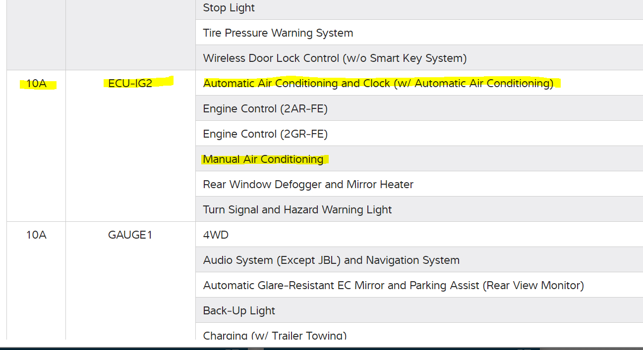

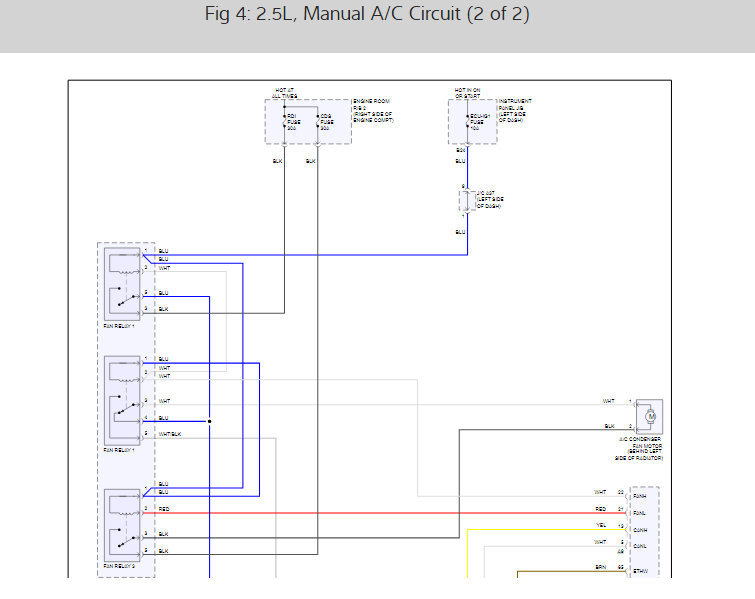

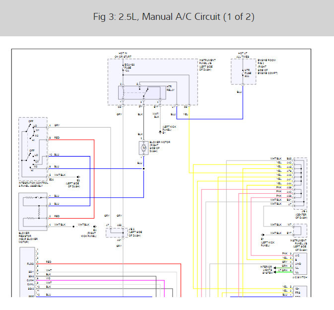

Checked everything still no A/C the diagram says automatic A/C is it the same for manual A/C?

2011RAV4
  • 10 POSTS
Just a clarification. The Flow Sensor needs to be checked with the AC off! Voltage has to be between 3.8 volts and 4.2 volts. If below that then the flow sensor is bad.

SCGRANTURISMO
  • 4,897 POSTS
Hello again,

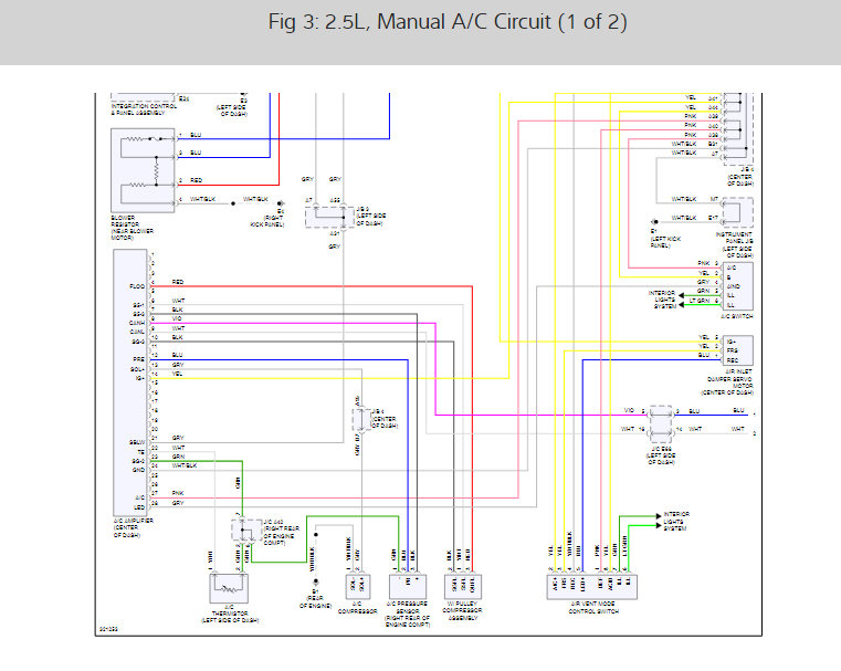

I'm sorry about that. Here are the wiring diagrams for the Manual A/C. They are located, as usual, in the diagrams down below. Please go through them and get back to us with what you are able to find out.
Thanks,
Alex
