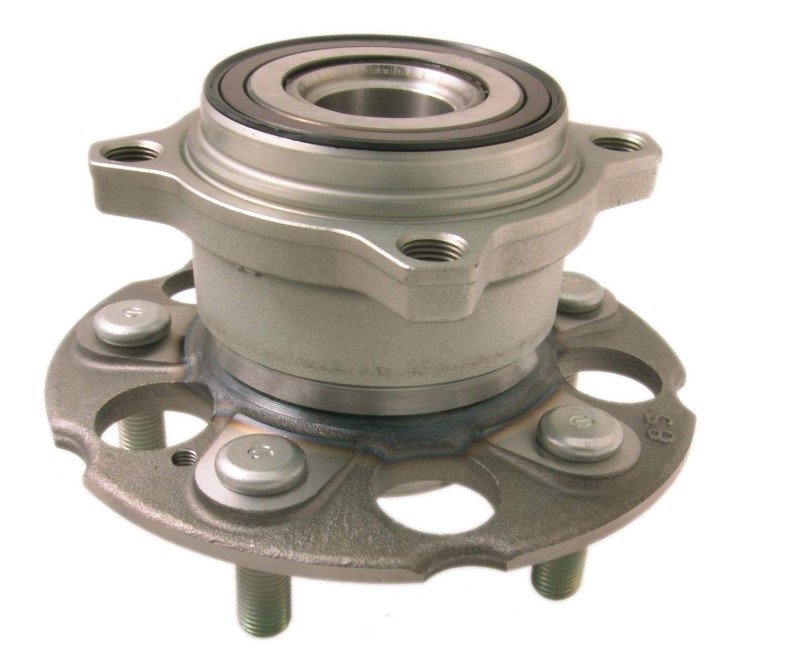

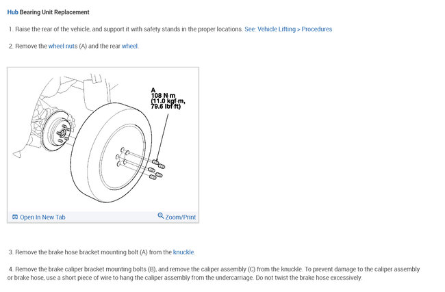

My ABS system was working until I had my rear bearing hub replaced. Since then, when I start driving I get clicking noises, as if the computer is trying to read the sensor. At 35 mph the clicking stops, and the ABS warning light comes on and stays on. I've had the mechanic re-do the hub installation, without success. I've also tried a new sensor cable, also without success. Any suggestions would be appreciated.

Hello, inside those wheels bearings is a reluctor ring that triggers the ABS wheel sensor. And they are directional. So either the wheel bearing he put in is the wrong one (missing the reluctor ring) which would be for a car without ABS or he put the bearing in backwards and the ABS sensor isn't getting a reading. If this happened right after a wheel bearing replacement then I think that's what's going on.
These videos will help us.
https://youtu.be/Pb6nXV-iamI
and
https://youtu.be/rTtAnsOlZU4

Thanks for your quick reply. I didn't provide sufficient detail so I would like to add some clarification in case it helps:
--The hubs for this vehicle are the same for left or right side.
--The bearing is not separate from the hub so not really possible to install backward.
--The reluctor is an integrated magnetic sensor ring.

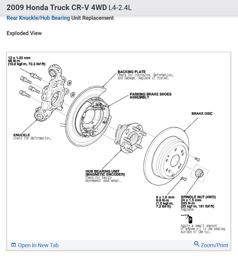

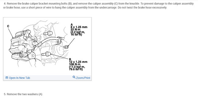

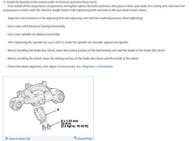

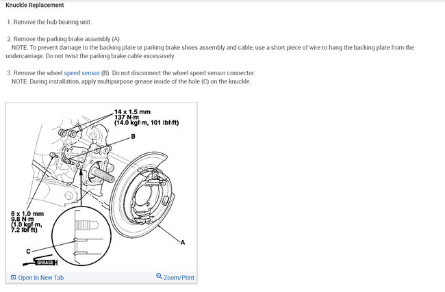

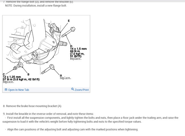

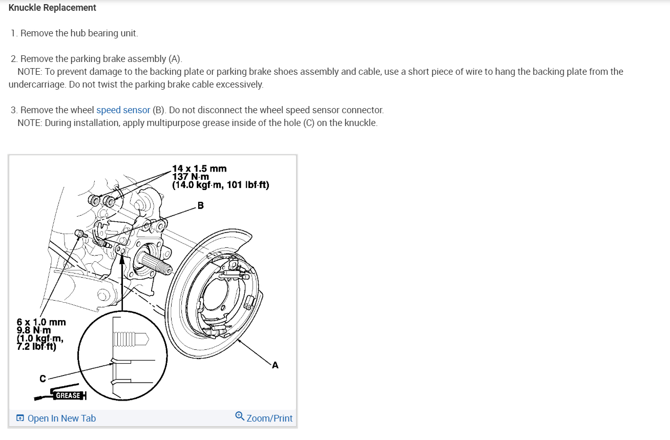

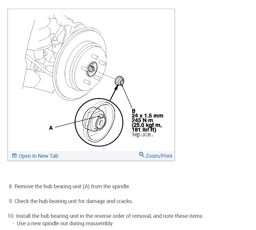

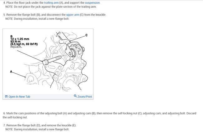

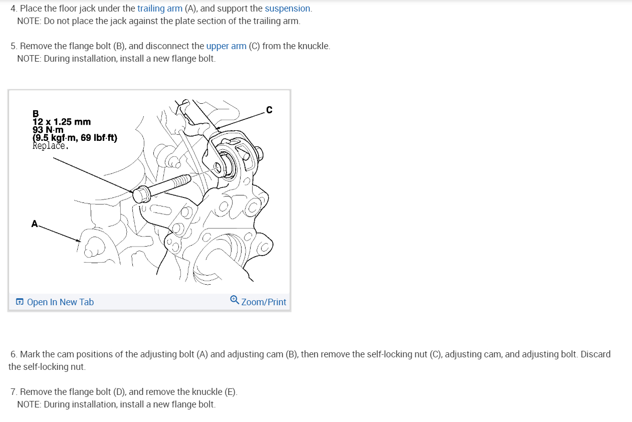

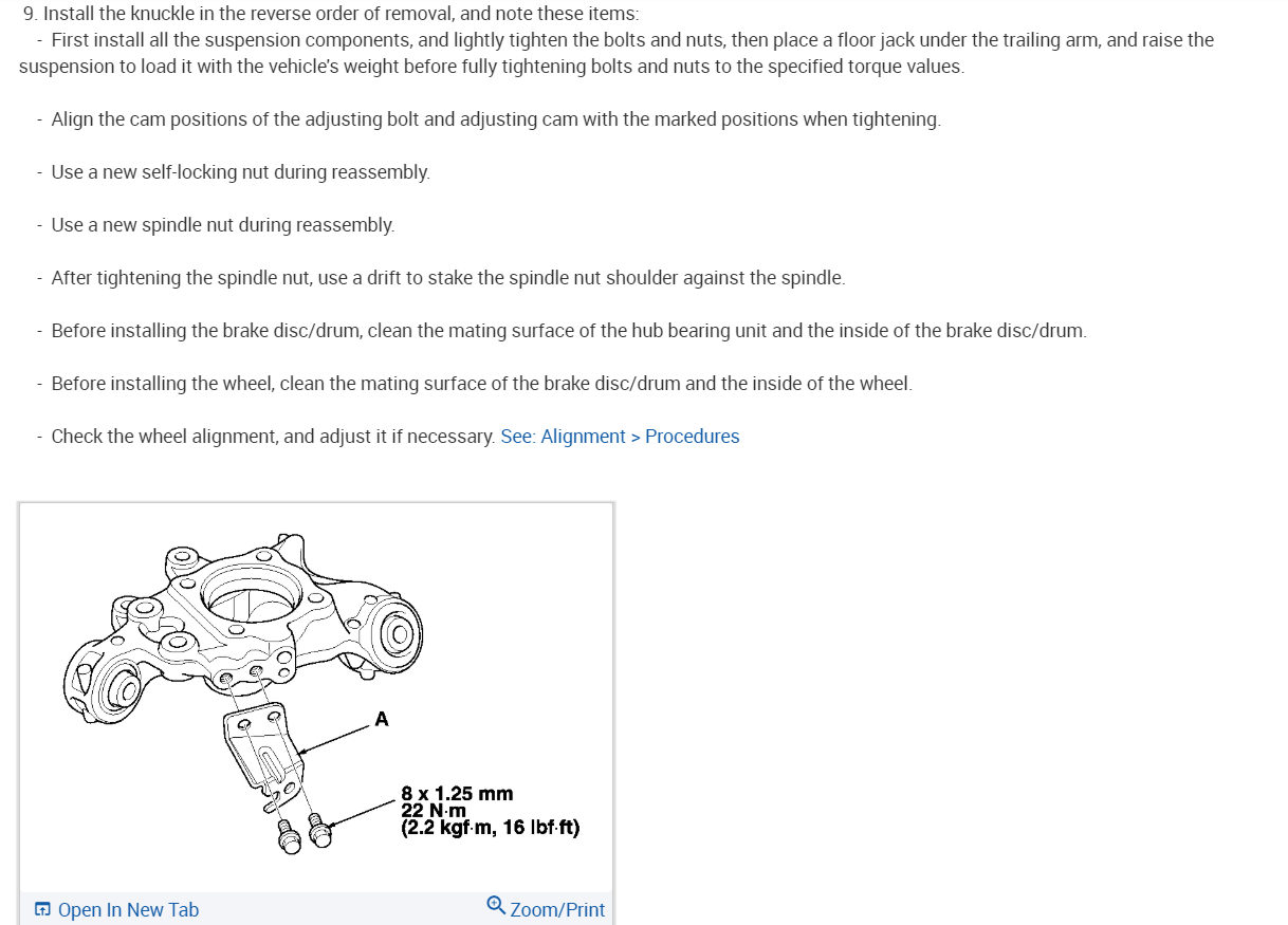

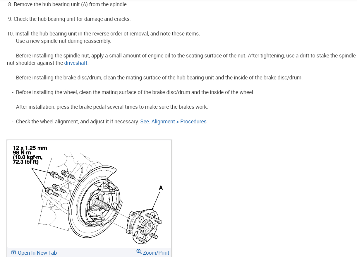

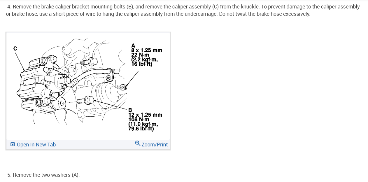

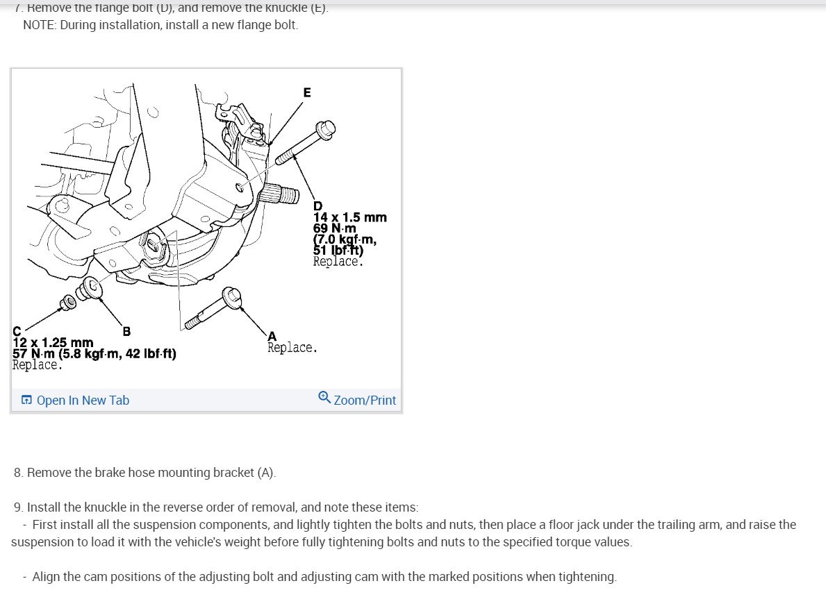

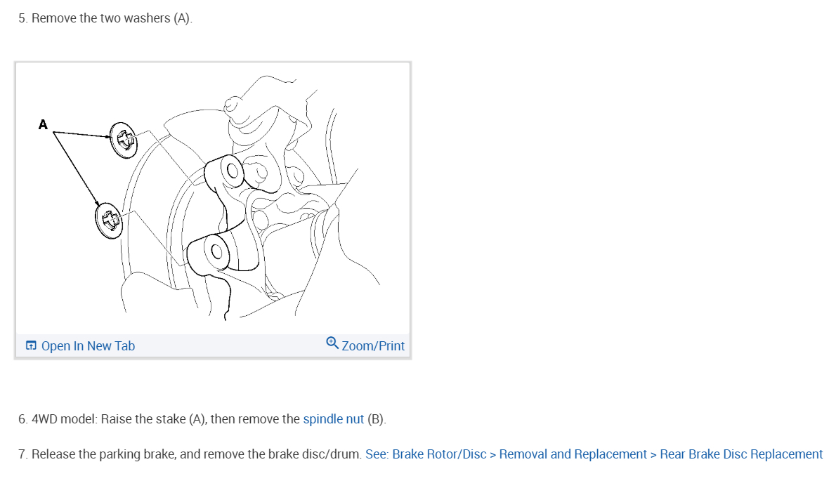

Here is a guide to help us see if in fact that hub is the problem with the ABS light with details on how the hub should be replaced in the diagrams below:
