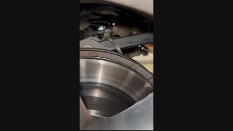

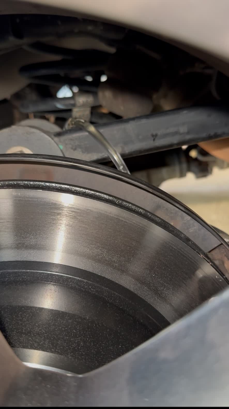

I thought about this after I asked the question earlier, the video below is the rear passenger caliper being bled using the bottle method with the end of the line submerged in brake fluid. In the video, the line goes upward from the bleeder valve then downward into the bottle that is sitting on the floor. That’s when I was seeing the air bubbles. If I raised the whole bottled up (sat it on the axle, making it be completely above the bleeder valve) the bubbles stopped. Should I have just left it sitting on the floor until the bubbles stopped?
This was the only brake line I have had air bubbles like that—none of the others did no matter if the bottle was above or below the bleeder valve.

Are you pushing on the brake pedal when you get the bubbles? If not, air could be getting let in from the threads of the bleeder. Also, did you remove the master and bench bleed it? A scanner will be needed to open the ABS module valves.

Okay, I figured that part out, It was coming from around the threads. So, this morning I took to Midas, and they did the auto bleed and it didn’t help. They said it’s either the master cylinder or the ABS module. The ABS module kicks in when I hit the brakes hard, so I don’t think it’s that.

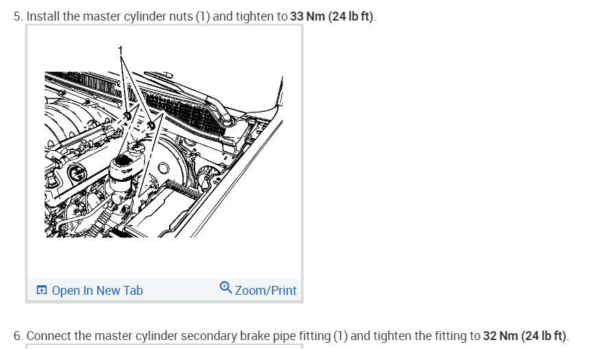

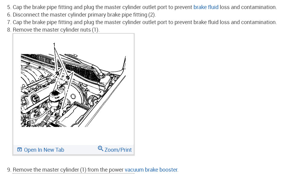

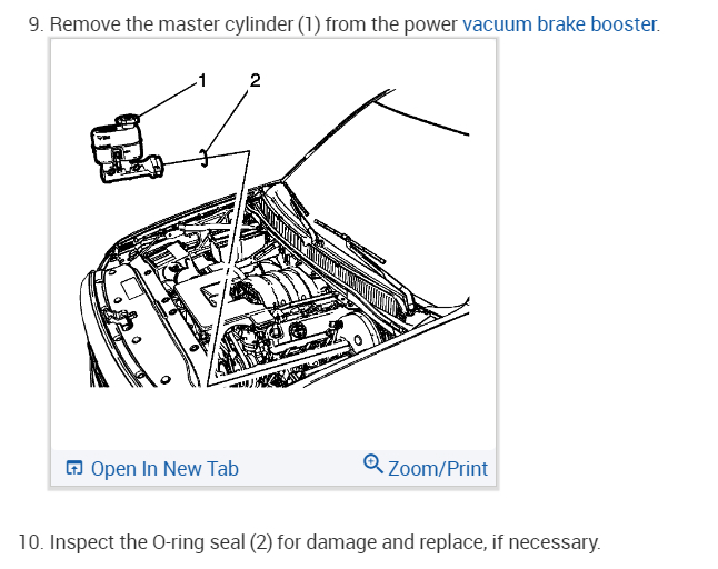

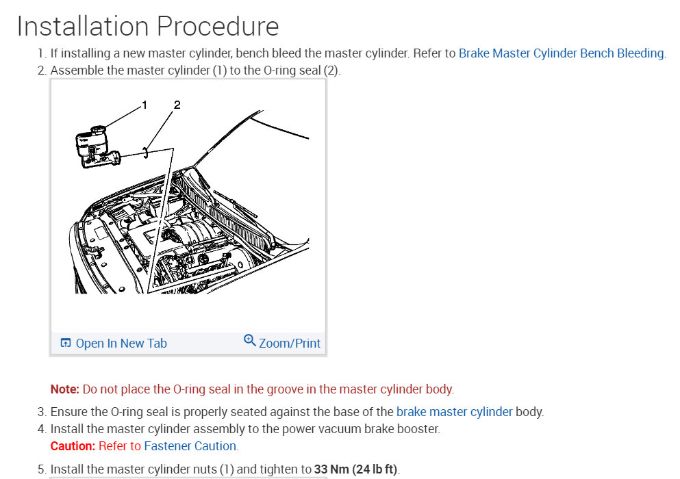

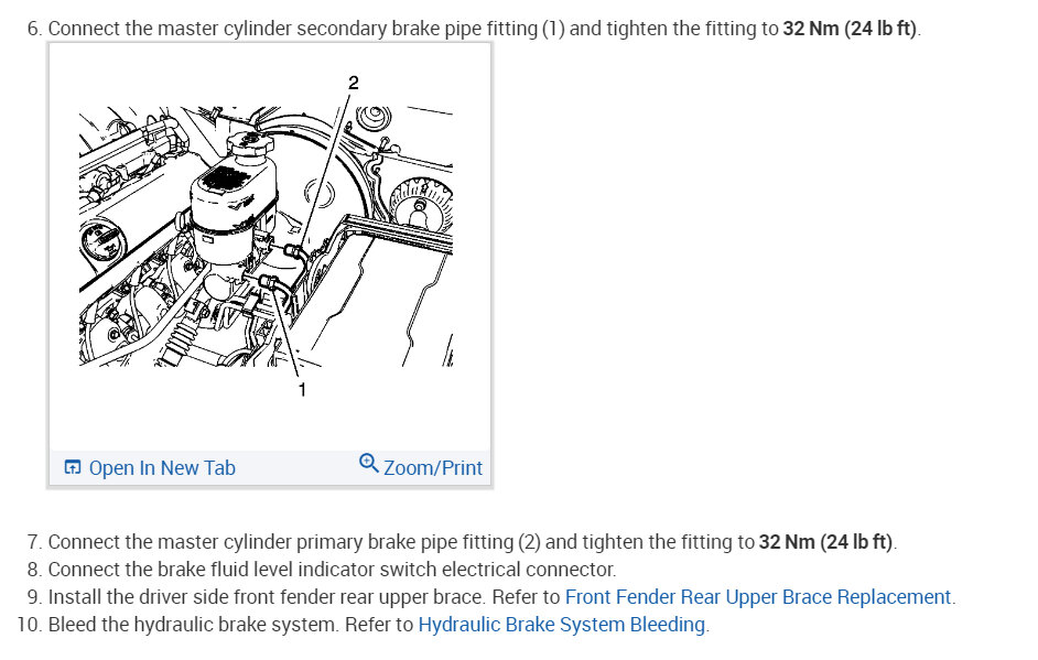

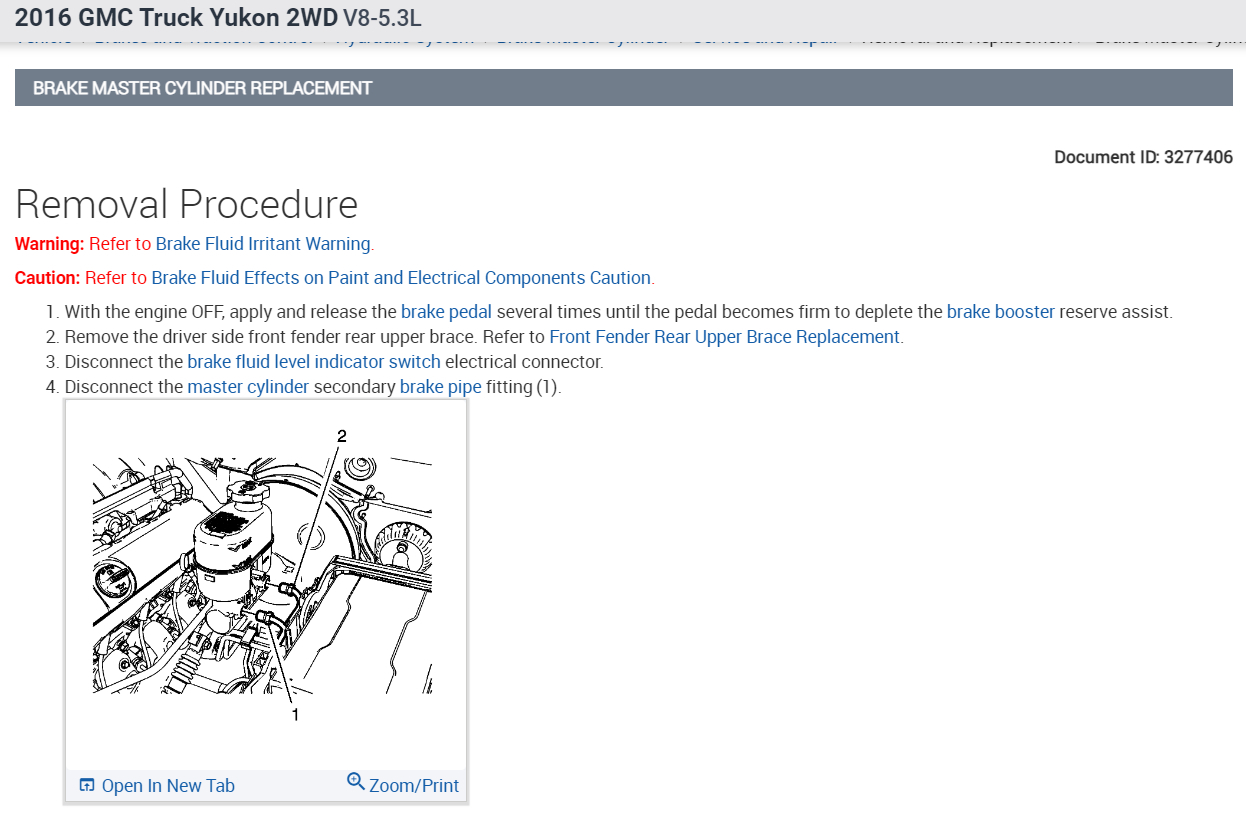

Nice work learning about brakes and cars in general, they play such a large role in our lives. Yep, that sounds like a classic brake master cylinder failure. Here is a generic guide to help you step by step with instructions in the diagrams below to show you how on your car:
https://www.2carpros.com/articles/how-to-replace-a-brake-master-cylinder
and this video will show how to bleed it before installation:
https://youtu.be/WDxvEQrMkBg?si=ePoyGIJ1NoJn2SOg
Check out the images below. Please upload pictures or videos of the problem so we can see what's going on.
