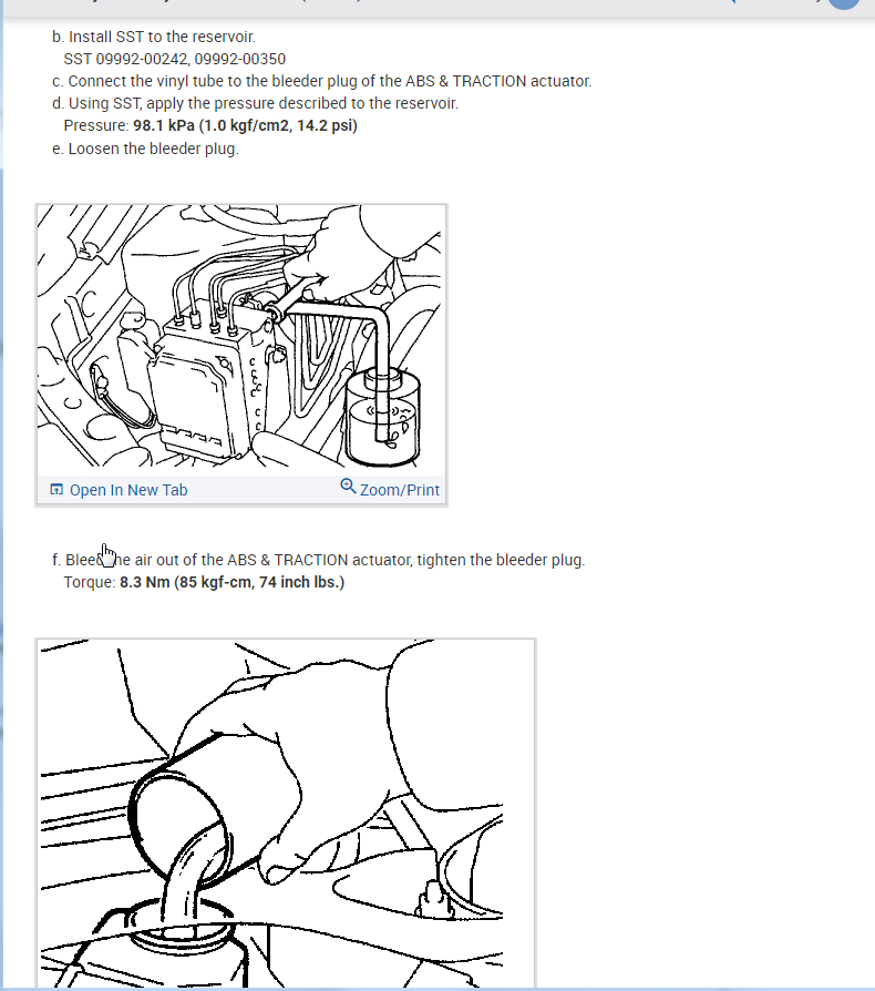

I think thare is air in the lines bleed brake system?
185,000 MILES • 2.4L • 4 CYL • 2WD • AUTOMATIC
JEFF HERMAN
  • 486 POSTS

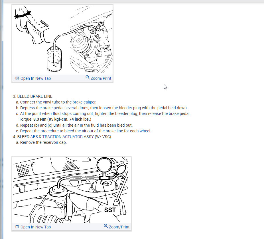

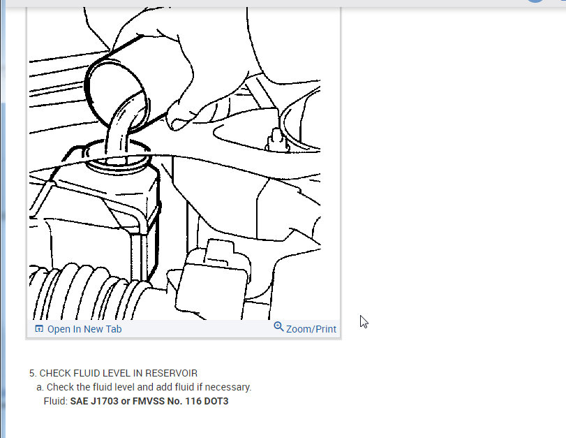

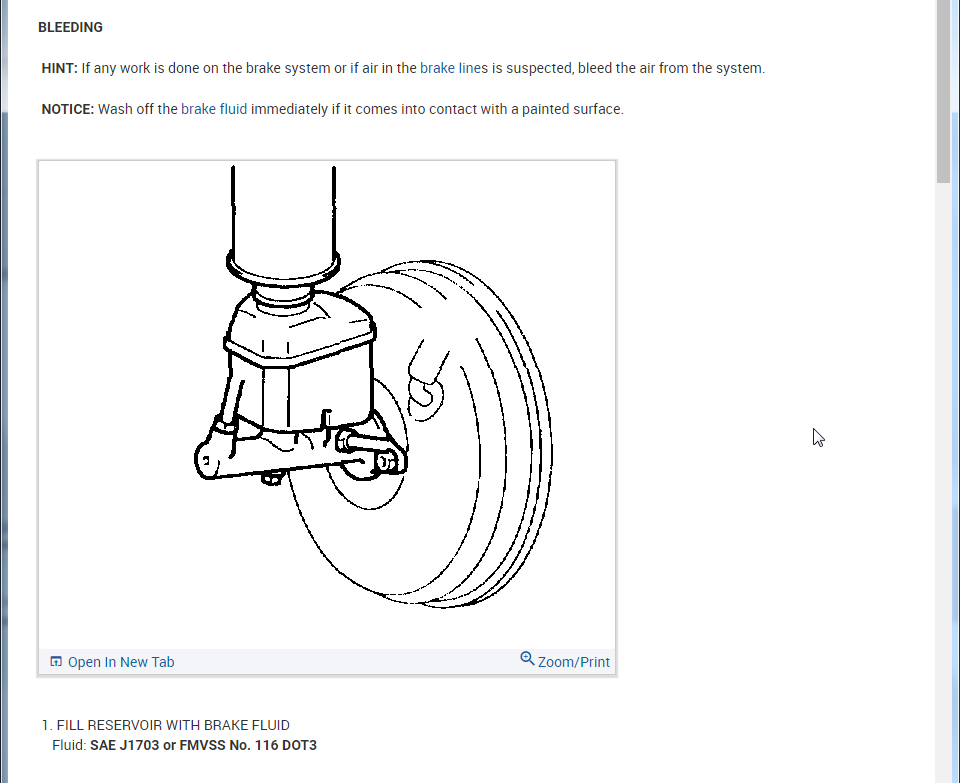

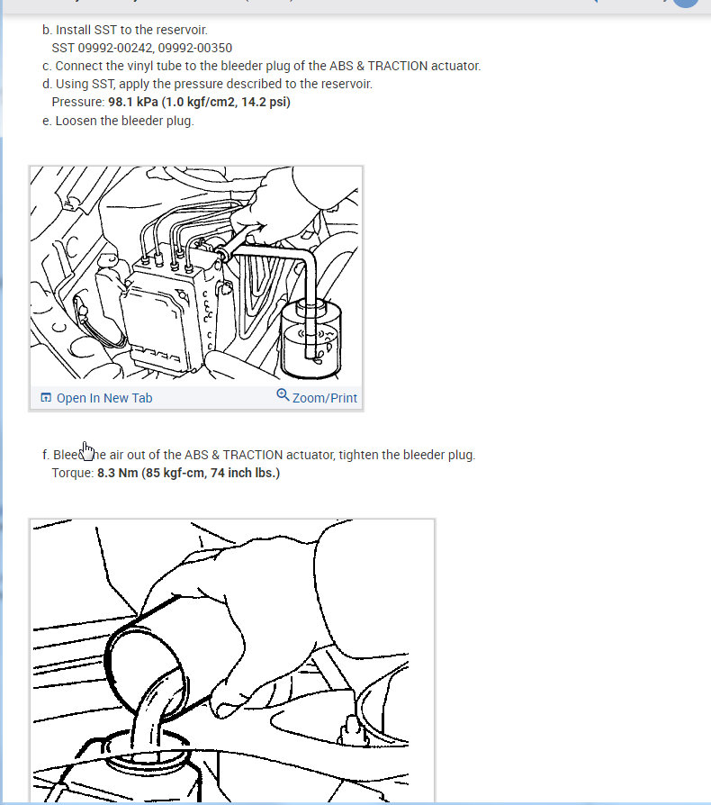

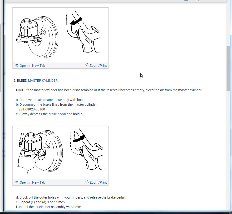

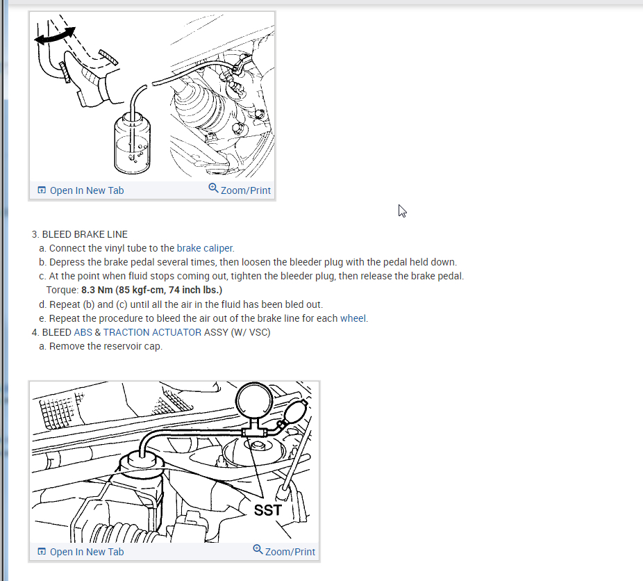

When driving in the snow the ABS engages too easily and the car does not stop. I have rolled through the intersection more than one time because of this. I think thare is air in the lines can you help me bleed them?
Jan 17, 2020 at 11:23 AM

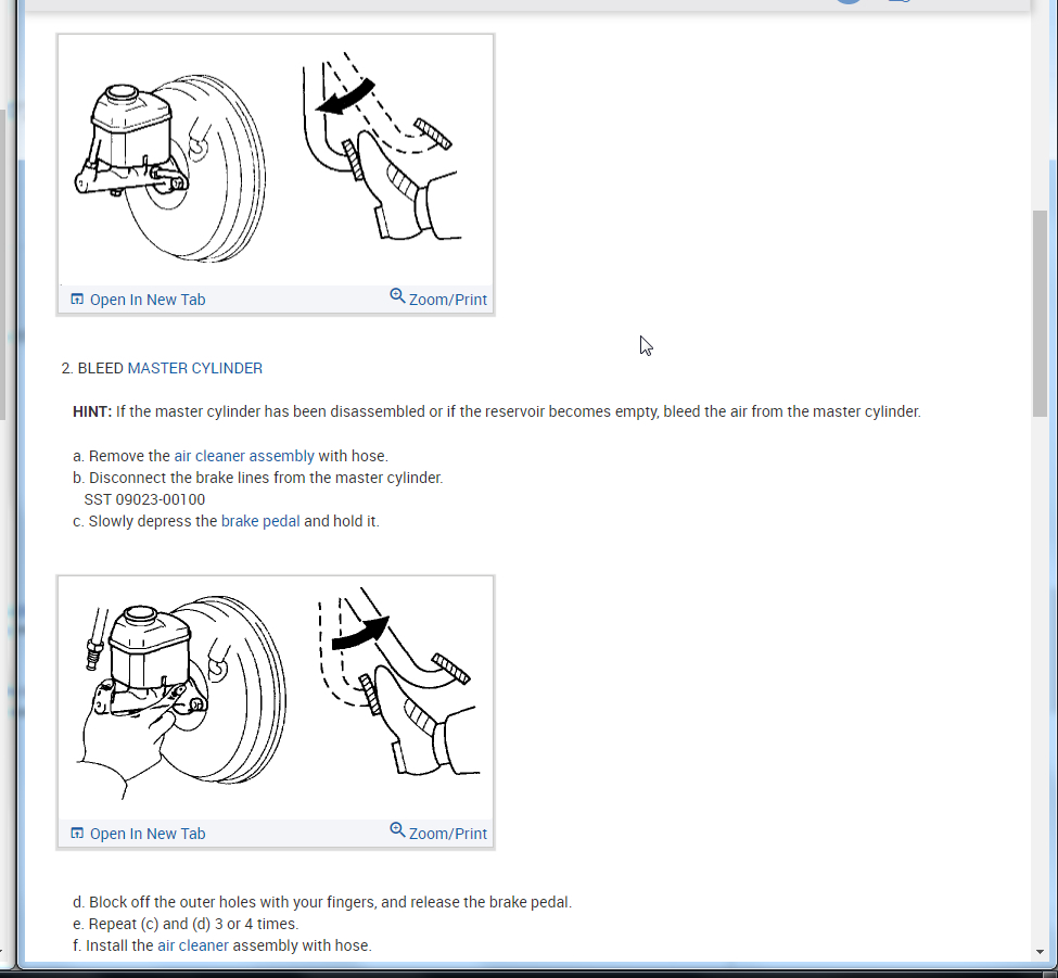

Here is a guide that will help with this:
https://www.2carpros.com/articles/how-to-bleed-or-flush-a-car-brake-system
Plus below is the process from the manual that will help with this. Please let us know if you have questions.
Thanks
