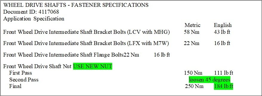

I forgot to mention that I have long suspected the high repeat failure rate might be caused by insufficient tightness of the axle nuts. 180 foot pounds was a common value for many vehicles, but some GMs called for as much as 240 foot pounds. I posted the specs below and was surprised to see this procedure. They want you to use a new nut. That means it's a "torque-to-yield" design. The threads peel a little as the nut is tightened. It won't develop the needed clamping power if used a second time.
The surprising part was the step to back the nut off, then tighten it to specs. I haven't seen that before in this application.
If you're going to replace the axle nut, another point to be aware of is there must never be any vehicle weight on the wheel bearing when that nut is not at full tightness. Doing so will instantly make them noisy. They'll make a buzzing noise like an airplane engine. A lot of competent do-it-yourselfers install the wheel / tire and set it on the ground to hold the axle from turning so they can tighten that nut. That's too late. The damage has been done. Instead, just drop a punch or screwdriver into one of the cooling slots of the rotor to hold the axle while the nut is tightened. If you're putting on a new nut after everything else has been reassembled, just jack up the one tire off the ground, then do the job. If left in "park", the other tire will hold the axle you're working on from spinning.

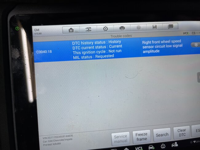

Yes, i couldn't find the live data to watch the sensor but i found the code which was for front right sensor signal low or something like that, which is the sane code before i changed the sensor.

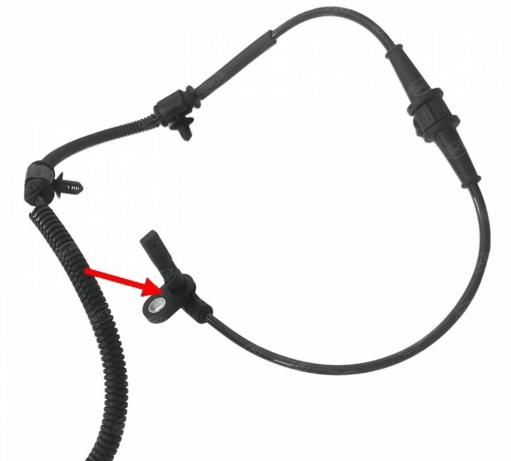

I apologize for not looking at this earlier. The story I gave you refers to older models with the speed sensor pressed onto the back of the bearing assembly as a round coil of wire. The photo below shows your front sensor. It's the same design GM used on their trucks since at least the late '90s. This design develops the same symptoms of loss of speed signal at low speeds, and "false activation" at low speeds above 9 mph. The solution is much easier. My red arrow is pointing to the mounting surface where rust builds up under that tab. That rust pushes the sensor up just enough for the signal to become too weak for the computer to read it by around 15 - 20 mph or less. At those speeds the computer is still watching each wheel, so a weak signal will get interpreted as a wheel has locked up and the tire is skidding.
Look for a layer of rust under that tab, and see if any scale can be chipped off the bearing. Also clean off the end of the sensor in case there's any metal chips. Those interfere with the development of a strong signal voltage. If you find scale on the bearing, be careful that as you chip it off, none of the particles fall down the hole. Even though it's rusty, it's metal that can stick to the magnet on the end of the sensor.

Here is the code.
