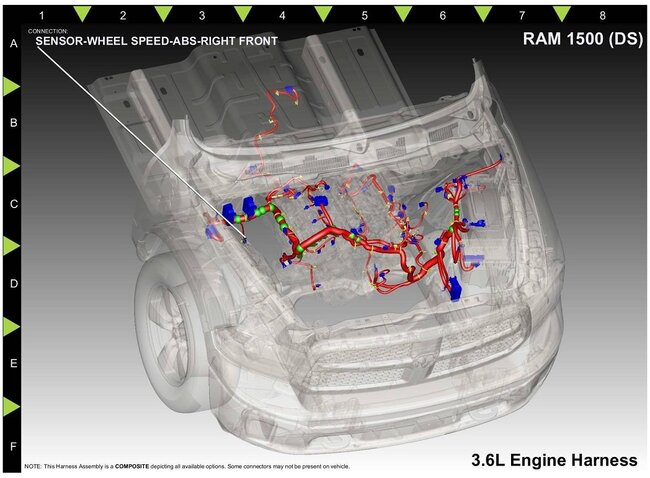

Where is the passenger side ABS sensor connector on the body side to the harness located?
180,000 MILES • 5.7L • V8 • 4WD • AUTOMATIC
ROBERT LUTZ2

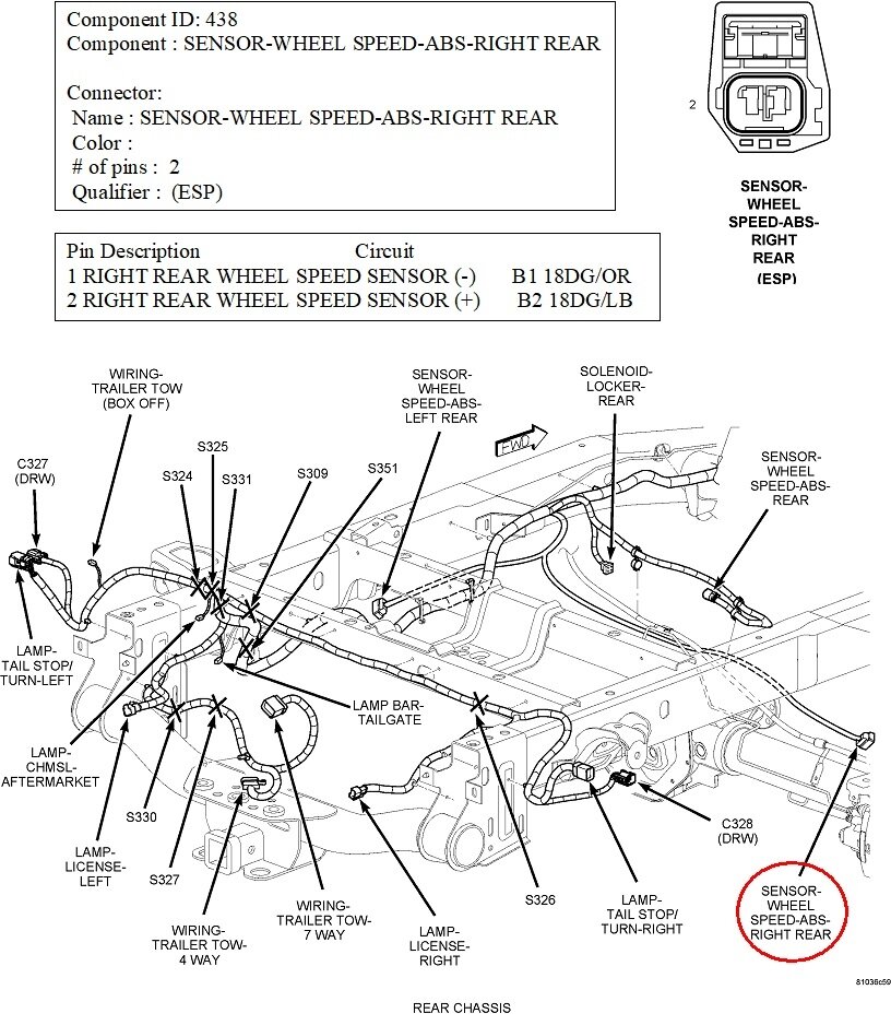

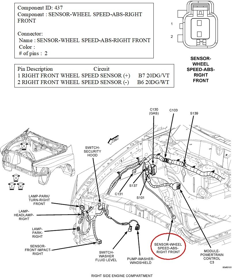

Having a problem locating the right passenger side abs sensor connector on the body side to the harness have the brand-new ABS sensor. I found the old one ripped out with no trace of the body side connector. What color wires are for that side ABS sensor? The ABS light is on and stays on. I'm thinking this would be my problem.

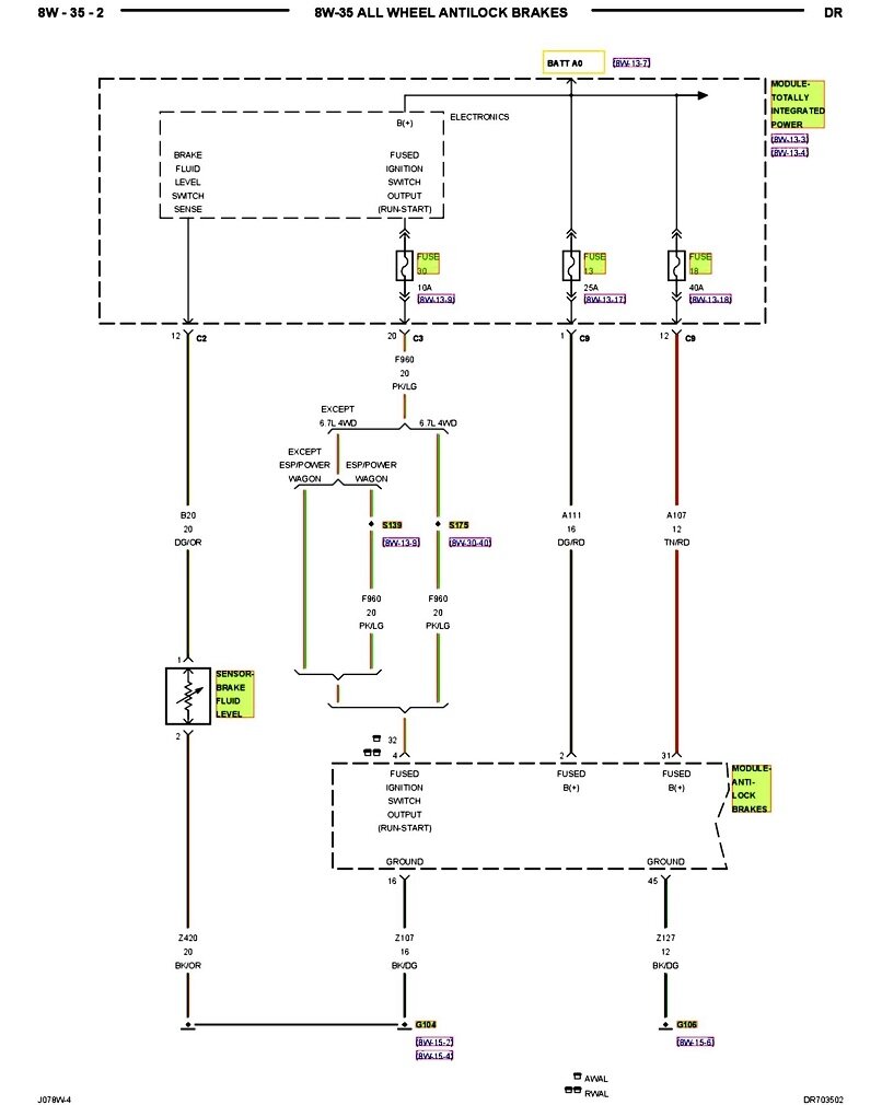

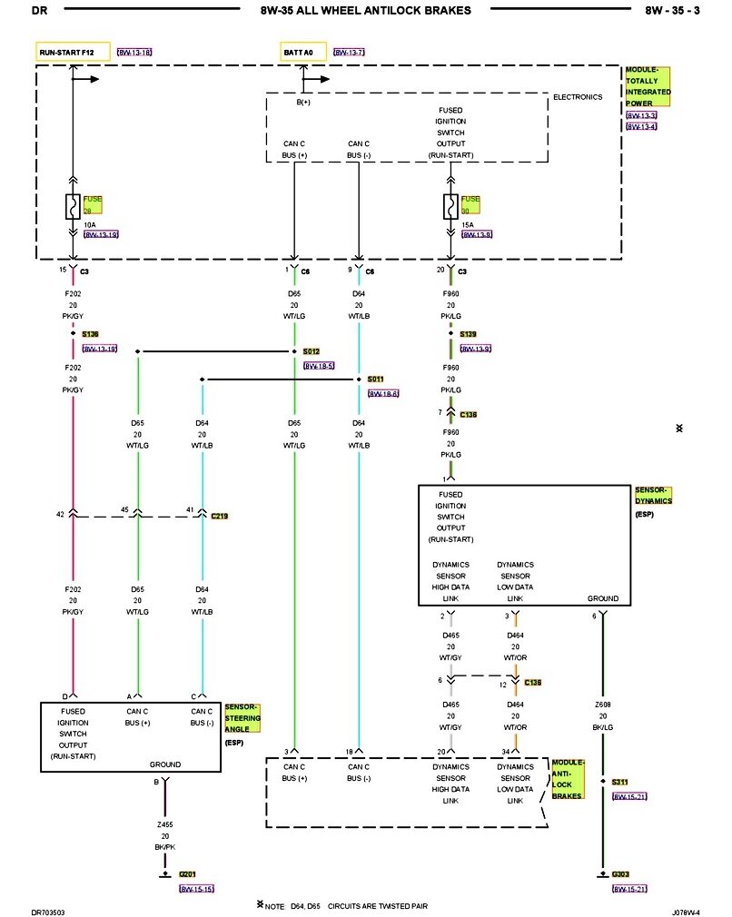

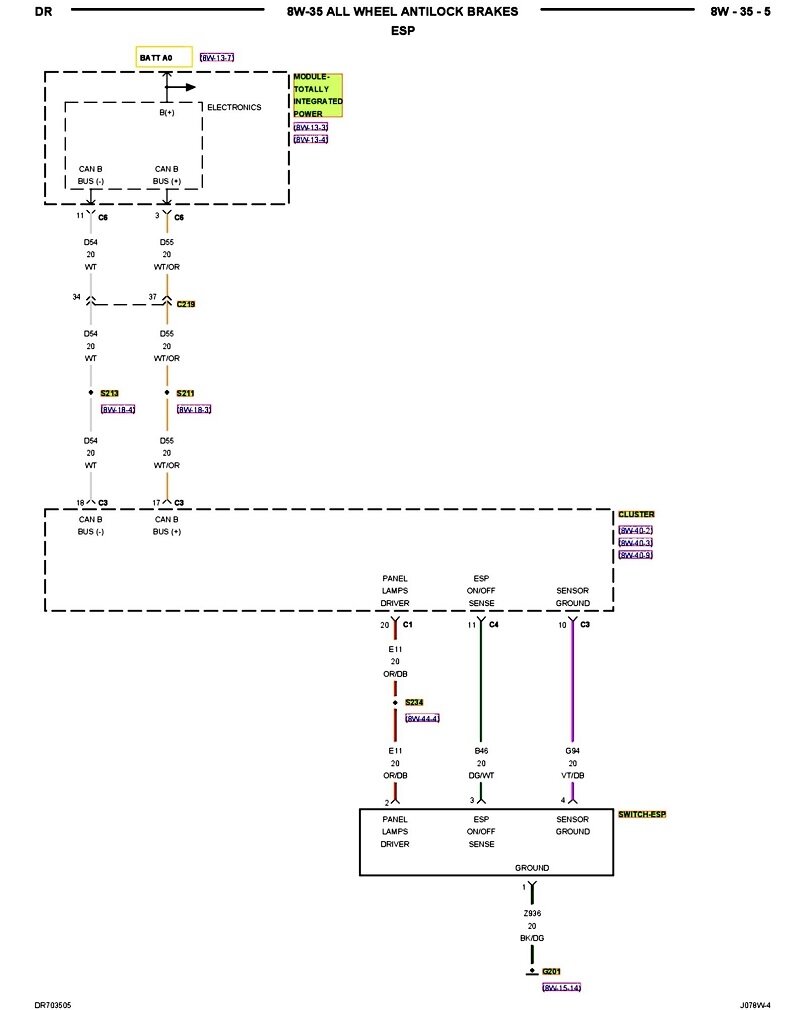

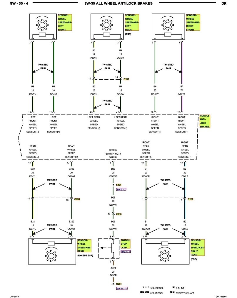

These first four diagrams are for the entire ABS system. The wheel speed sensors are shown in the third diagram. The fifth drawing shows the location of the right front sensor connector, and the sixth one is for the right rear sensor. If these are too hard to read, you can copy them into a typing program such as MS Word where they can be expanded, or tell me which one you need and I can expand it for you.

Thank you that helped a lot but the right-side ABS wires the photos say they are a twisted pair of wires drg and vol and drg white but the only twisted pair I see are drg vol and yellow org would they be the right side the plug for the right side abs isn't there at all.

You aren't likely to see those twisted wires. They should be wrapped up in black wire wrap. That looks like electrical tape, but it isn't sticky. Those wires also may not be twisted everywhere. They do that in areas where other sources could cause electromagnetic interference. When a voltage pulse could be "induced" from the pulsing current flow in an adjacent wire, by twisting them, the same voltage gets induced into both wires, then those pulses cancel each other out. We used to do that years ago with the flat tv antenna wire.
I noticed last time they seem to show the right front connector half way across the truck. It's not clear if that wire harness is traveling across the cross member to the driver's side, or if it's going down along the inner fender to just in front of the passenger's front door. I would expect to find it toward the rear, and above the inner fender liner.

Here's a different drawing for a 2013 model, but it should be similar to yours. Maybe this will help.
