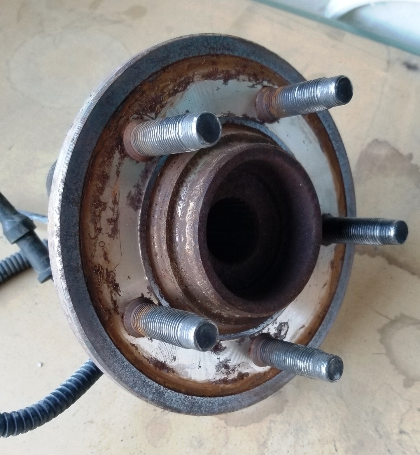

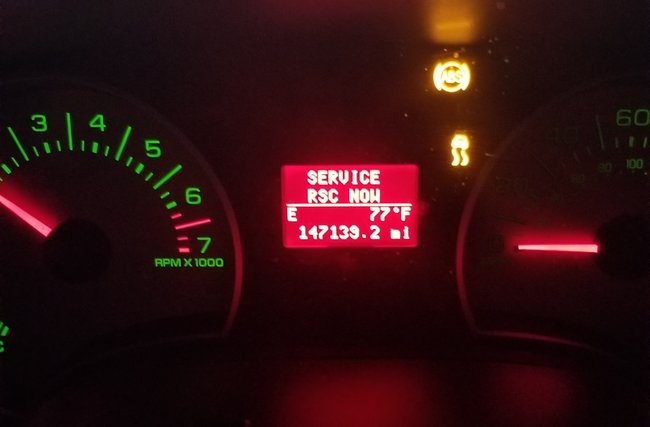

So I replaced the right front hub on my SUV. Took it our for a test drive and lights and alarms started going off. The ABS light came on and an alarm started when the RSC light came on. Is there a calibration period for this? Is there a reset? Do I really need to pay Ford to make the lights go away?

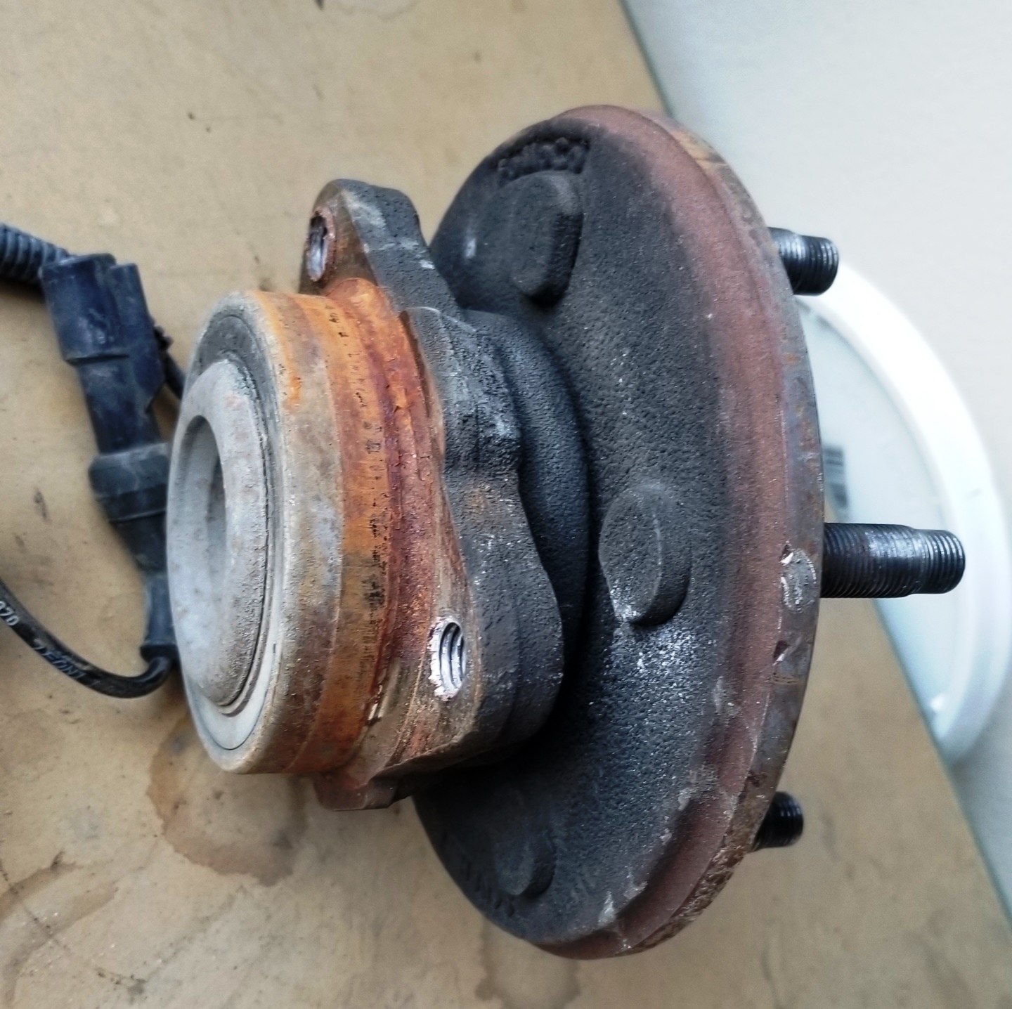

I know what the speed sensor that you are talking about is and I believe it is built in to the hub assembly on the 2010 Ford Explorer. I unplugged the wiring harness and reconnected it. Still has the light on on the dash. Besides the lights I get this warning "Service RCS Now". I also looked up how to do a soft reset of the codes and that didn't work either. Any ideas?
Sep 11, 2019 at 8:58 AM
Okay. RSC is Roll Stability Control and uses speed sensors to determine if a wheel is slipping.
All is pointing to an issue with one of the speed sensors but at this point we need a scan tool to do two things. First scan for codes and it should tell us which sensor or sensors are the issue. Second it will allow us to monitor the sensor to see if it is reading.
You are correct that the actual sensor is part of the hub. But I suspect we have an air gap issue with one of the new hubs.
