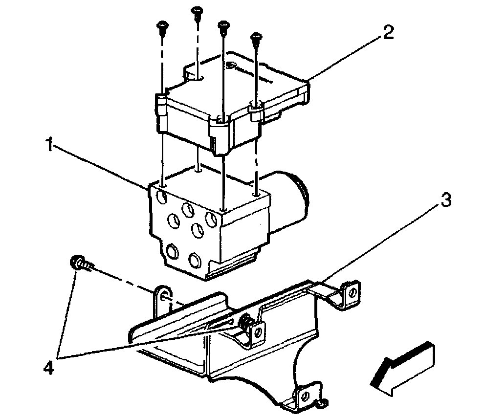

In your video what side is the screw to remove the ABS module?
Oct 29, 2018 at 5:37 PM
  • 110,194 POSTS
I have attached the directions specific to your vehicle for you to review. All attached pictures correlate with these directions and check this video out.

Brake Pressure Modulator Valve (BPMV) Replacement (w/o JL4)
Removal Procedure
Important: The area around the electric hydraulic control unit (EHCU) MUST be free from loose dirt to prevent contamination of disassembled ABS components.
1. Thoroughly wash all contaminants from around the EHCU.

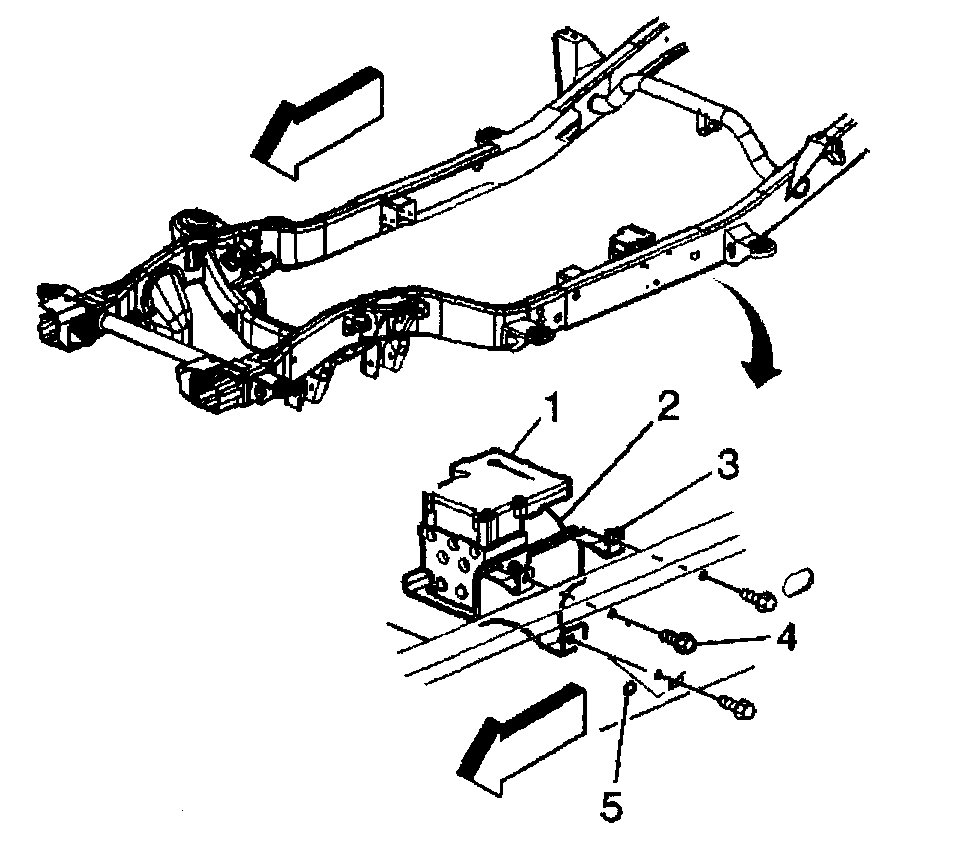

2. Disconnect the 3 electrical harness connectors from the electronic brake control module (EBCM) (1).
Important: Make sure that brake lines are tagged and kept in order for proper reassembly.
3. Disconnect the brake lines from the brake pressure modulator valve (BPMV) (2).
4. Remove the bolts (4) securing the EHCU mounting bracket (3) to the frame rail (5).
5. Remove the EHCU from the vehicle.
6. Remove the bolts (4) securing the BPMV (1) to the EHCU mounting bracket (3).
7. Disconnect the 2 way ABS pump motor connector.
8. Remove the 4 T-25 TORX bolts from the EBCM (2).
9. Remove the EBCM (2) from the BPMV (1). Removal may require a light amount of force.
Important: Do not reuse the EBCM mounting bolts. Always install new bolts.
10. Clean the EBCM to BPMV mounting surfaces with a clean cloth.
Installation Procedure
Important: Do not use RTV or any other type of sealant on the EBCM gasket or mating surfaces.
1. Install the EBCM (2) onto BPMV (1).
Notice: Refer to Fastener Notice in Service Precautions.
2. Install the four EBCM bolts.
Important: Do not reuse the old mounting bolts. Always install new EBCM bolts with the new BPMV.
Tighten the 4 bolts to 5 Nm (39 inch lbs.) in an X-pattern.
3. Connect the 2 way ABS pump motor connector to the EBCM.
4. Install the BPMV (1) to EHCU bracket (3).
5. Install the BPMV (1) to bracket retaining bolts (4).
Tighten the bolts to 9 Nm (7 ft. lbs.).
6. Install the EHCU to the vehicle frame (5).
Tighten the three EHCU bracket bolts (4) to 25 Nm (18 ft. lbs.).
