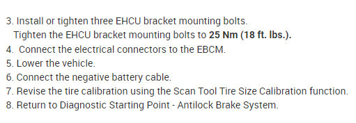

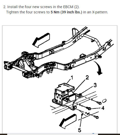

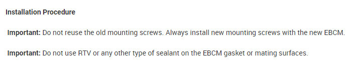

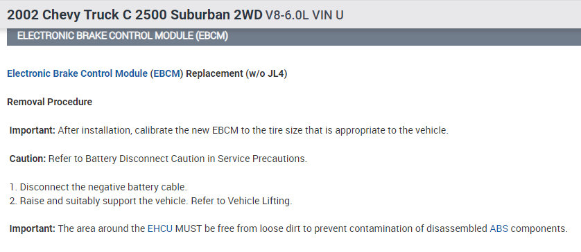

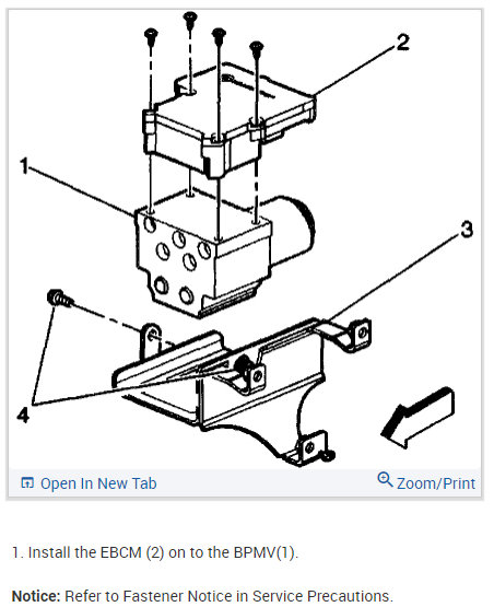

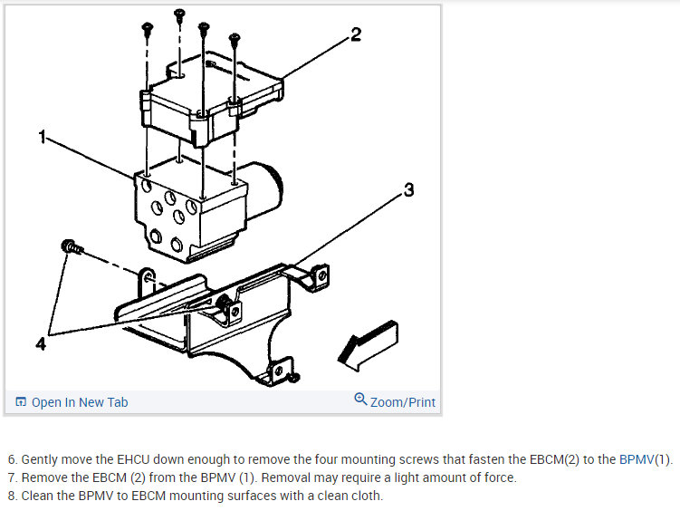

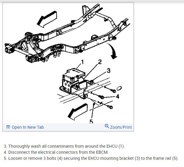

dealer says I need new abs module. is that the same as an abs modulator valve? should any other parts be replaced at time of repair.

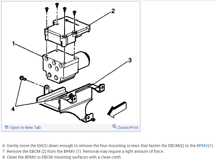

I've attached picture steps below as well show abs module replacement for your Suburban. You might have to have the abs module re-calibrated with a professional scan to for correct tire size. Hope this helps and thanks for using 2CarPros.
