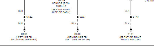

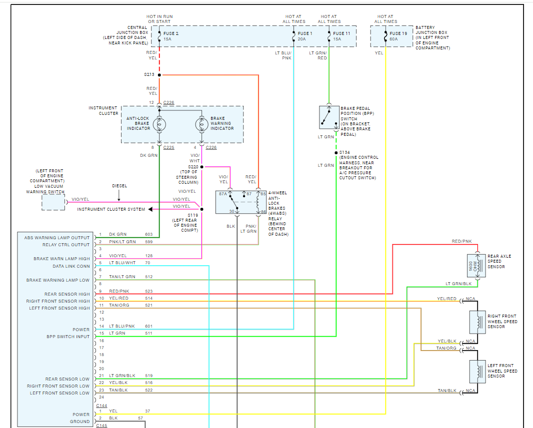

Here are the ABS system wiring diagrams so you can see how the system works. I would also check the fuses and grounds of the system which I have included as well. Check out the images (below). Please upload pictures or videos in your response to the problem so we can see what's going on.

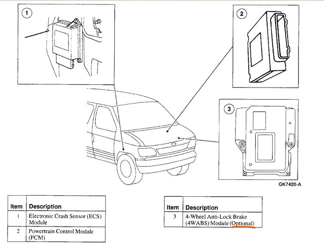

Okay, i sure will, and i am pretty sure the abs light will come back on too. In the meantime, does the 2000 Ford E-150 Econoline van have either of the following relays on them Anti-Lock Brake System (ABS) Indicator Light Relay or a ABS relay? Some friends of mine says it does but if it doesn't i can't seem to find it anywhere in the manual of the van.

It has an ABS relay but it's stuck behind the center of the dash (thanks Ford) which makes it a bear to get to.

The relay just powers the ABS system, won't turn the light on itself. That is done through the ABS module itself. Removing it would turn off the light because it would also turn off the entire ABS system.

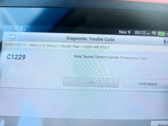

Oh, okay. Well, i finally had it scanned and the code it produced was C1229 - Rear Speed Center Coherency Fault. Its the only error code that was produced this time. Here is the picture of the scanner. Sorry the picture isn't too clear it was kind of bright outside this time. Sorry for 2 images of the same thing. I tried deleting one of them, but it wouldn't erase etc.
Nov 9, 2024 at 1:42 PM
STEVE W.
  • 15,351 POSTS

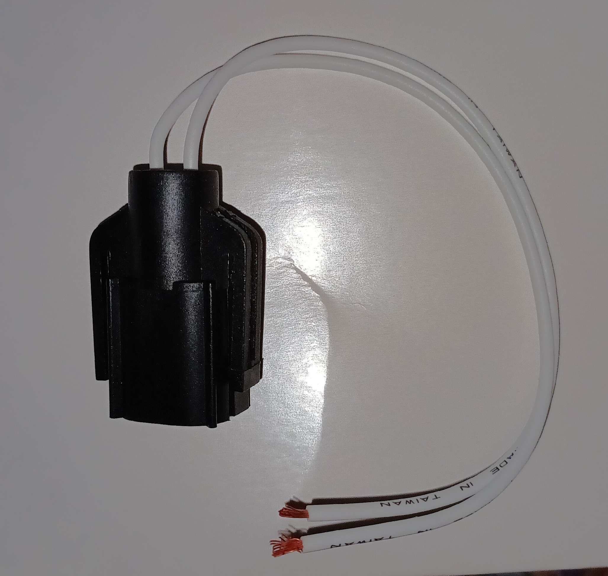

Okay, that code basically means that there is a problem with the signal from the rear speed sensor. It isn't receiving the signal as a steady thing. Commonly that means a broken wire in the harness to the sensor. Try this test, go into the live data on your scan tool and select the wheel speed sensor data. Now drive on a straight line at about 30 mph or so and watch the speeds. You should see them all saying 30 mph. I suspect the rear speed will be erratic and so drop outs. I know you posted that you got a new connector for that sensor, what was the reason for that? Damage? Corrosion? Both of those could cause this code. It is also the reason the ABS light comes and goes, sometimes the sensor signal is good then it drops out. That is usually the wiring and not the sensor itself. There are 2 wires from the sensor to the ABS module. If you know how to splice the wires you can just use two wires and replace the harness from the sensor up into the harness at the rear of the truck. They fail normally because the wiring has to flex as the rear suspension moves. If I had it here, I would take the new plug you have and de-pin it and add new longer wires to it and then splice it into the harness where I circled in the image.

Hello there, sorry for the long delay in writing you back. And ok i will try that test you where talking about. But first i will answer your question. The reason why i connector is because i thought it might have been lose connector like you said (and others on the list too). And i have been trying and trying to get some to put that new connector on my van for the last 6 months or so. But, but nobody seems to want to mess with it. But i will try and do the test and let you know what happens. At least i can try and do that. I'm in a wheelchair so i just can't look under the van to see if any wires are broken or have rust on them etc. Very nice diagram..i like that..
Nov 12, 2024 at 1:35 PM
STEVE W.
  • 15,351 POSTS
Yeah that would limit what you can do if you don't have a lift. I'm surprised that nobody is willing to replace a simple connector. What part of the world are you in? Maybe someone can recommend a shop.

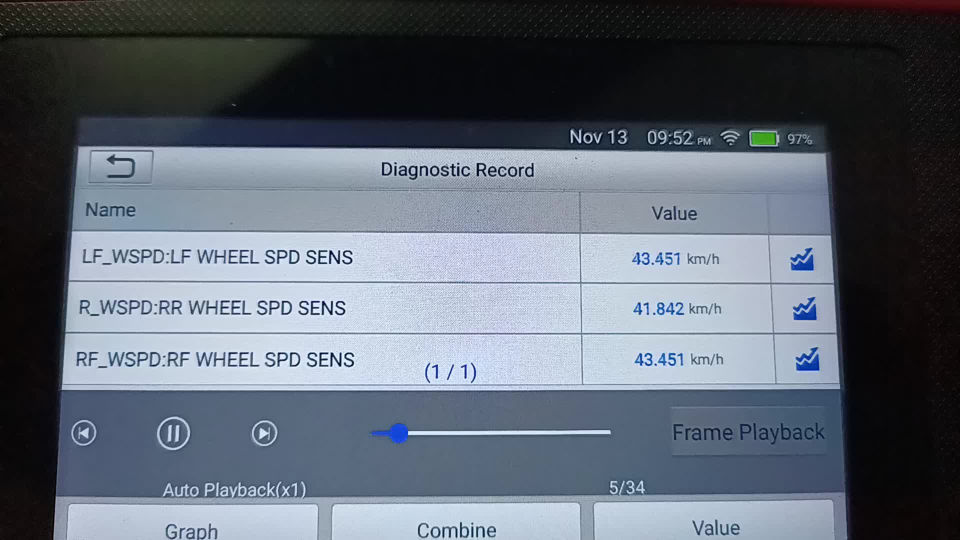

Yeah what some car shops will work on one thing and not some other things USA Oklahoma. Well i did that test.. here are the pics i managed to get while at the stop light.

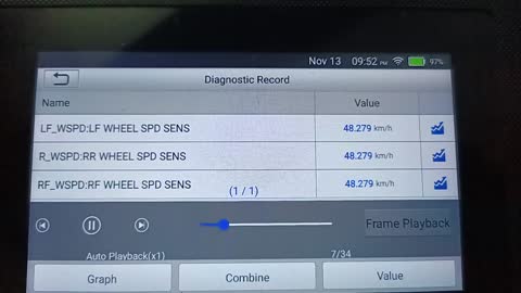

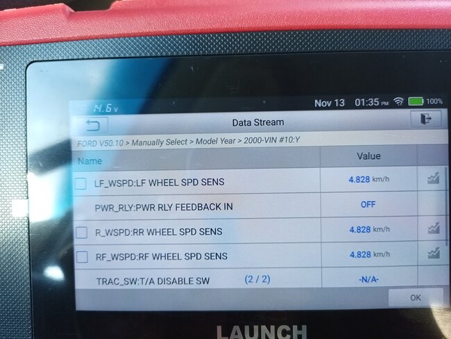

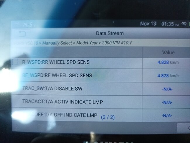

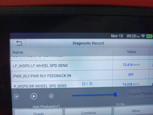

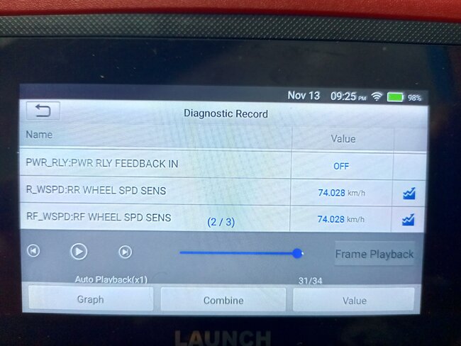

I'm sorry i forgot to post the pictures. In the first picture is when i stopped at the stop light. I have a short video on my scanner but i don't know how to get it off of there etc. And thank you CARADIODOC for your comment and you make some very interesting points too. I never thought about that.
Nov 13, 2024 at 10:07 AM
WARREN1814
  • 210 POSTS

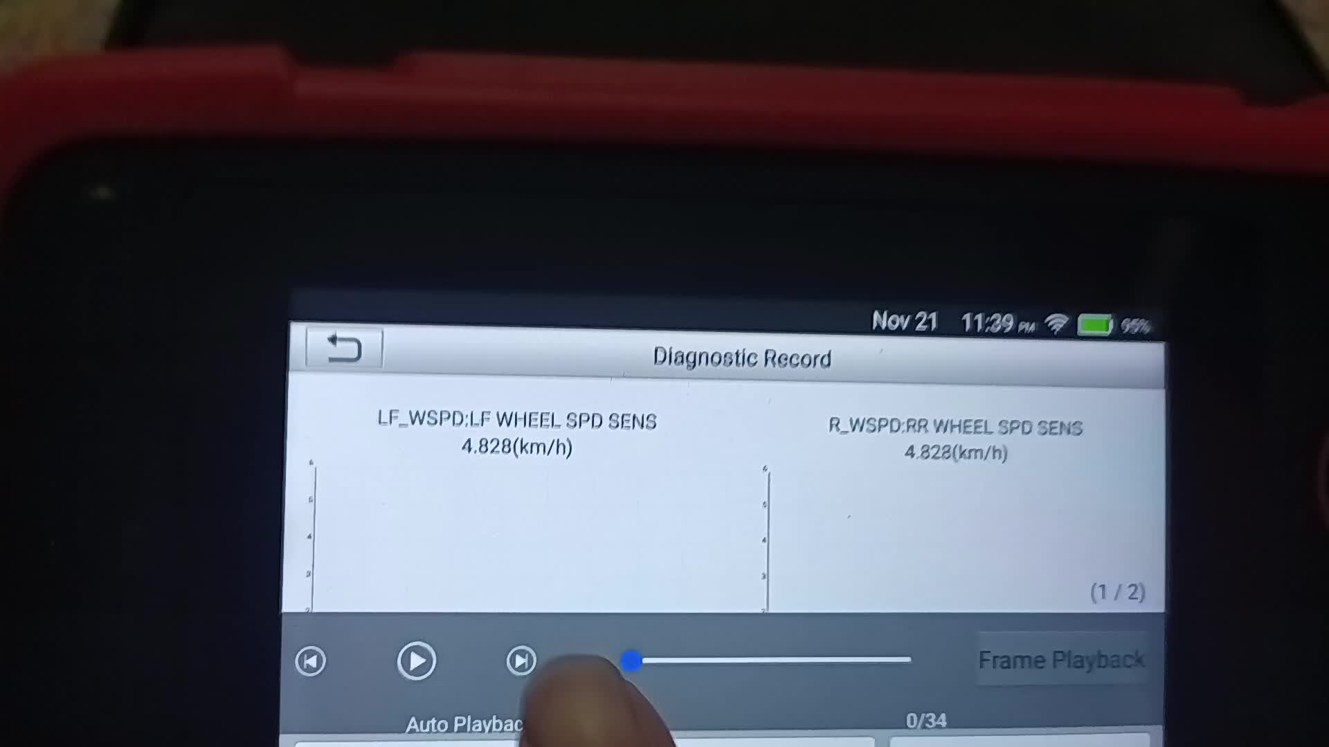

Last picture and here is the video too (sorry for so many post etc.) In the video you will see the speed sensors read 4.8 that's when i stopped at the red lights etc. But you guys know that already.

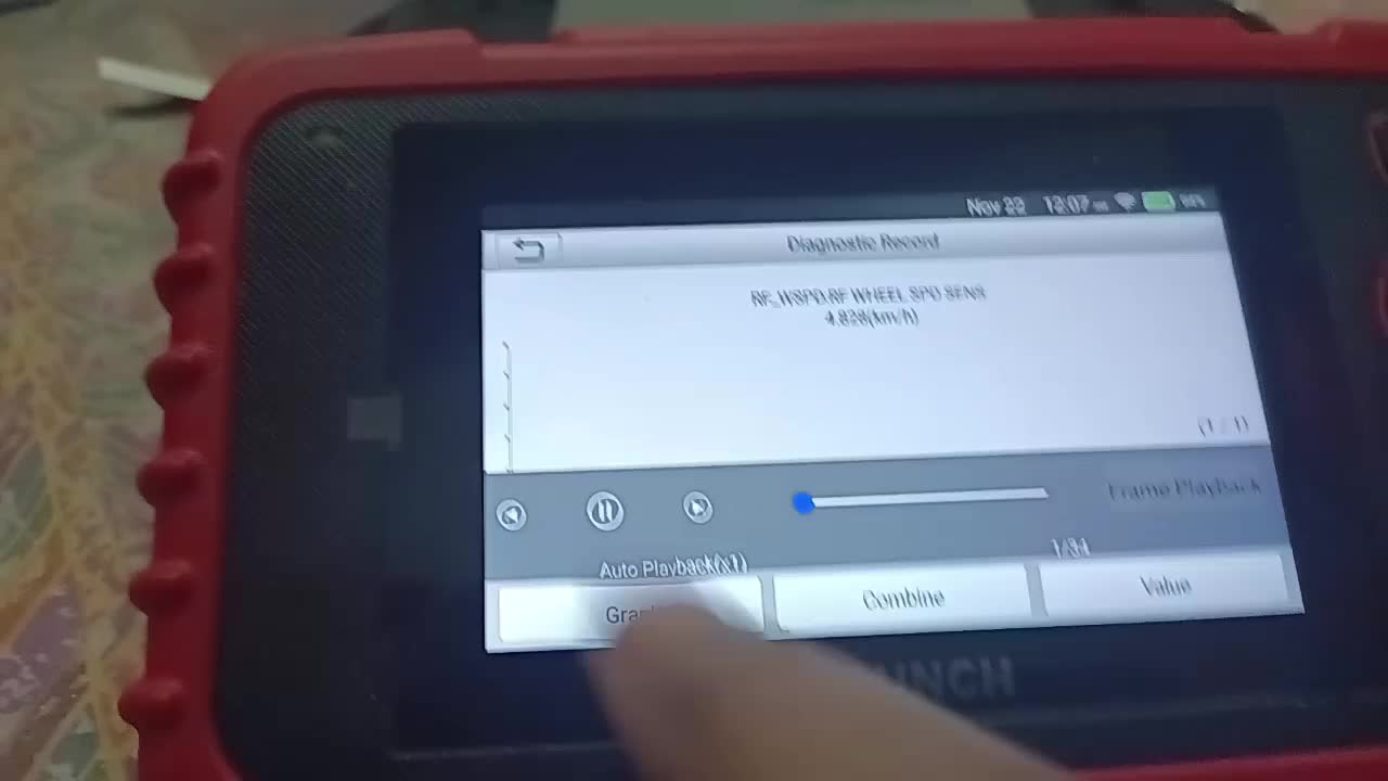

Okay, now that I know what you have for a scan tool. Select just the front sensors and the rear and switch them to graphing mode (the little hill looking thing on the right) now go drive on a rough road and then stop and look at the graphs. What you are looking for is drop outs in the signal, which is all that is needed to cause this. Then we can discover why. If there are no drop outs but the light is still on, then it could be the module itself not reading the signal internally.

Okay, here is the graphic of the LF and RR speed sensor. The right front does the same thing... as the LF.... etc., I hope it's not the ABS module, because if it is. That's the end of that. Ford discontinued the ABS module for the 2000 Ford e-150 Eco van. And so far, i know of no auto parts stores that carry it. At least not where i live anyway. My last guess could be wrong with it is the brake booster or the ABS module.

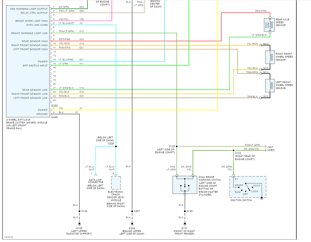

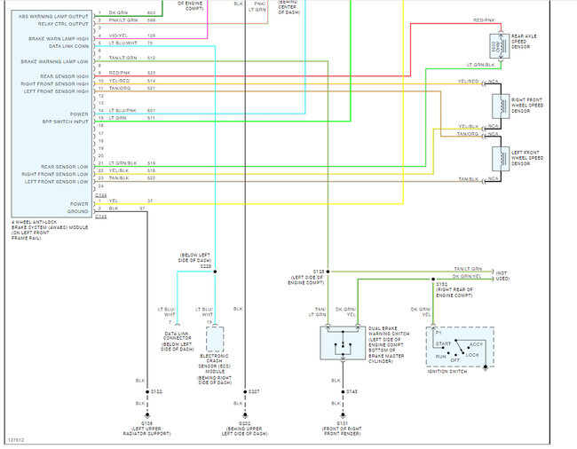

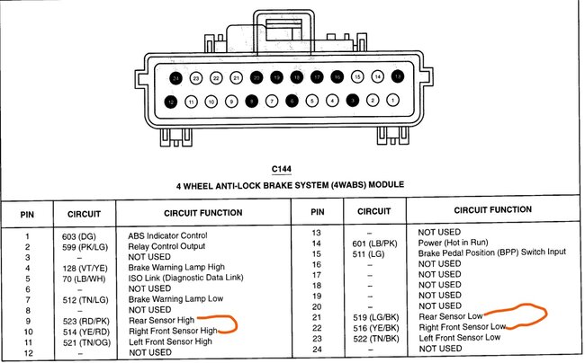

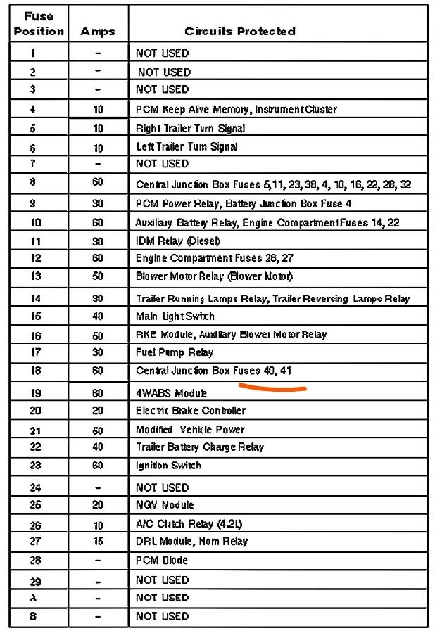

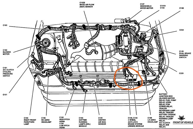

Yeah that doesn't look good, but we have another test that should tell you once and for all. It is a substitution test. You know the fronts are good and the rear is suspect. So, what we will do is "swap" the sensor inputs at the ABS Module. Basically, you know the sensors are sending data, but if you were to take the right front signal and send it to the rear input and it still showed the rear as the problem you know it's the module. Which can be found used,
To do that we would find the ABS module harness and swap the wires shown in the picture, either by cutting them or depinning. If you still see the same issue, then it's the module.

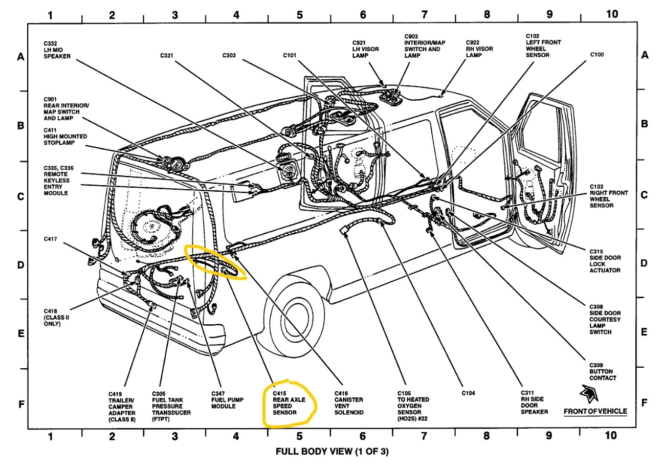

Now there is another option but I'm not going to tell you, but if you look in the location picture you might see something underlined. You had the brakes repaired and they work, while the light is on the ABS is off and it drives like a van without the optional ABS. If you can deal with that it's possible to turn off the ABS and the light in one step... Remove the optional ABS. I drove a lot of vehicles that way because I grew up on RWD and no ABS so many got the connector unplugged in my GMs.

Wow, that is a lot to remember good thing you wrote that down on here. And i forgot to tell you when i put on my brakes it makes a hissing / some kind of weird sound. While the van is trying to stop it acts like its trying to stop the van in steps if that makes any kind of sense to you. first step it slows down smoothly. second step it slow the van down more aggressively. And on the last step it locks up the wheels and you can hear the tires makes that good old sound it makes when the wheels has locked up and you know you are sliding and leaving black marks on the street lol Now getting back to what you said. I won't be able to get to that is because of course i'm in a wheelchair and my reach is limited. I do go to reach the scan port for the scanner.
Nov 22, 2024 at 8:59 AM
STEVE W.
  • 15,351 POSTS
Hissing is usually a sign of a vacuum leak in the booster, unless it is momentary. Like you step down and hold the pedal and it stops it's likely just a valving issue, if you step on the pedal and it hisses the entire time that's a leak. It sounds like the ABS is intermittent as well. If you were to pull fuse 19 in the under-hood fuse box it should deactivate it and let you see if it is the ABS causing the jerky stops.

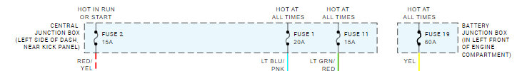

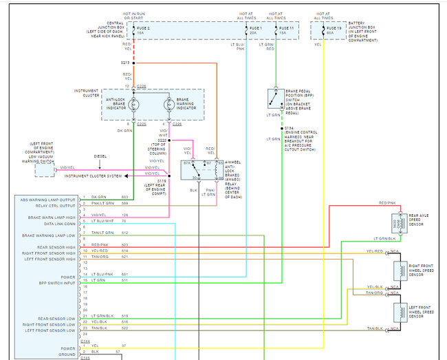

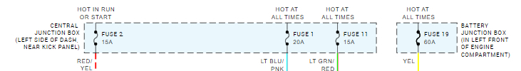

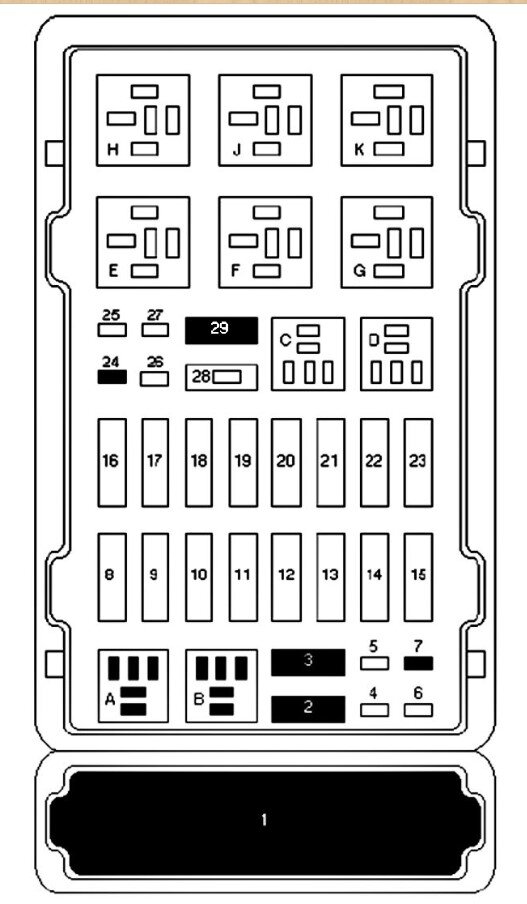

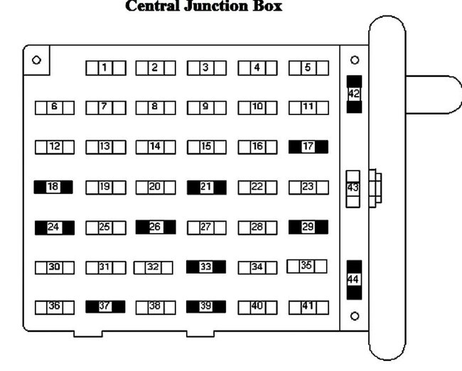

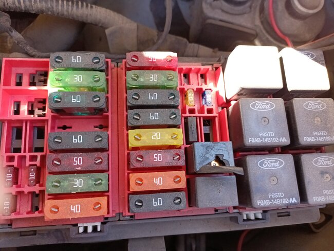

Okay, let me see if i can get someone to check this for me. Okay, i pulled the fuse 19 under the hood in the fuse (the fuse wasn't blown either) box like you said (and just did a short drive etc.,) and yeah, it stopped jerky when putting on the brakes and that sound i was telling you about went away too. I can live without the ABS system if i have to. But now the ABS light stays on all the time now. Also too. i seen a fuse under there that had a hole in it. I don't know what fuse it was related to as i forgot to write it down. But i will go back out there and look up what fuse that was. Well it was one of those big relay looking fuse is the one that had the whole in it. Someone covered it up with a piece of duct tape.
Nov 23, 2024 at 3:23 AM
STEVE W.
  • 15,351 POSTS
Well, that relay isn't very secure any longer, I suspect they tried to remove it and damaged the case. That is the trailer running light relay. Removing fuse 19 would have disabled the ABS system (not the light but the ABS module and sensors). As that stopped the jerking and the hissing then it sounds like the ABS control module is the faulty part. With it partially operating it is trying to engage and disengage while you stop. Doing the sensor swap would pin it down but with your situation it may be a while before you can find a shop that can actually do the testing without just swapping out expensive pieces for you to pay for.
As such you can still drive it until you get it repaired but to turn off the light would require you to remove fuse 19 and Fuse 1. That should turn off the ABS system fully. It may not turn off the light, Ford did some strange wiring with it and used another fuse to power the light. If the brakes now work without the jerks and noise, then it is the ABS module itself that you would need to replace. You might try www.car-part.com to see if some yard near you has a used one, they could ship.
There is also the option of bulb removal to turn off that light if fuse one doesn't but that would be entirely your choice.
