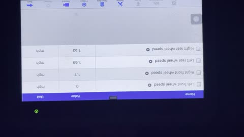

Drive the car while looking at wheel speeds, one of those that was showing 0 is now working great, but it is saying it is the right one, not the left that I changed. Ugh.
-So, is it possible that the one on left is showing on right?
Does not make any sense that after a new bearing and sensor that the right one starts to work and not the front left. This is crazy.

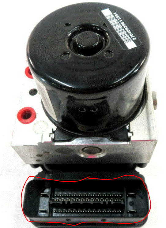

Corrosion can certainly cause electrical connection issues. As far as the DSC module, it is mounted to the rear of the ABS pump. There is one large connector to it. That is why I don't feel the wires got switched. See pic below.

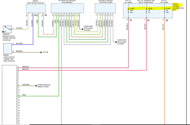

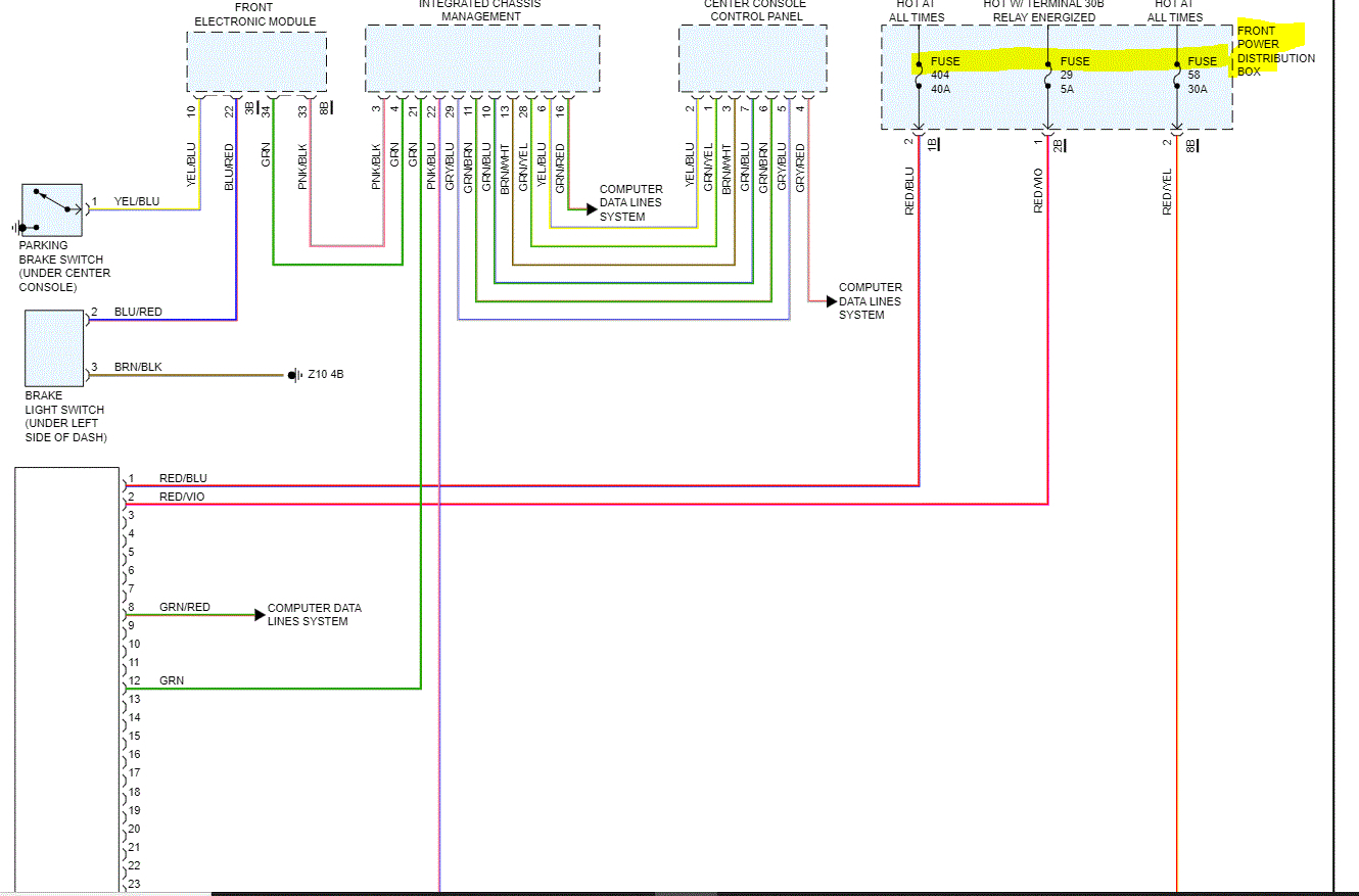

As far as power, the DSC receives power from three different fuses. They are located in the under-hood fuse box.

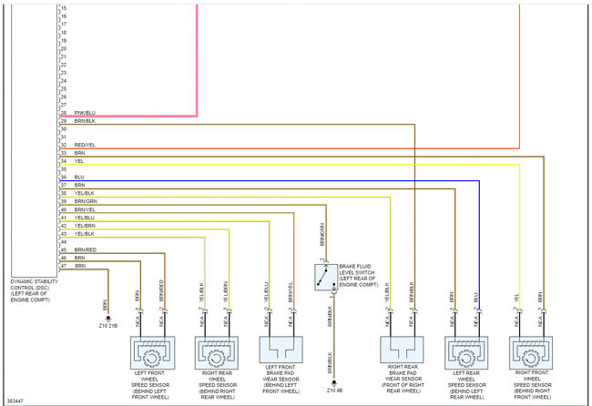

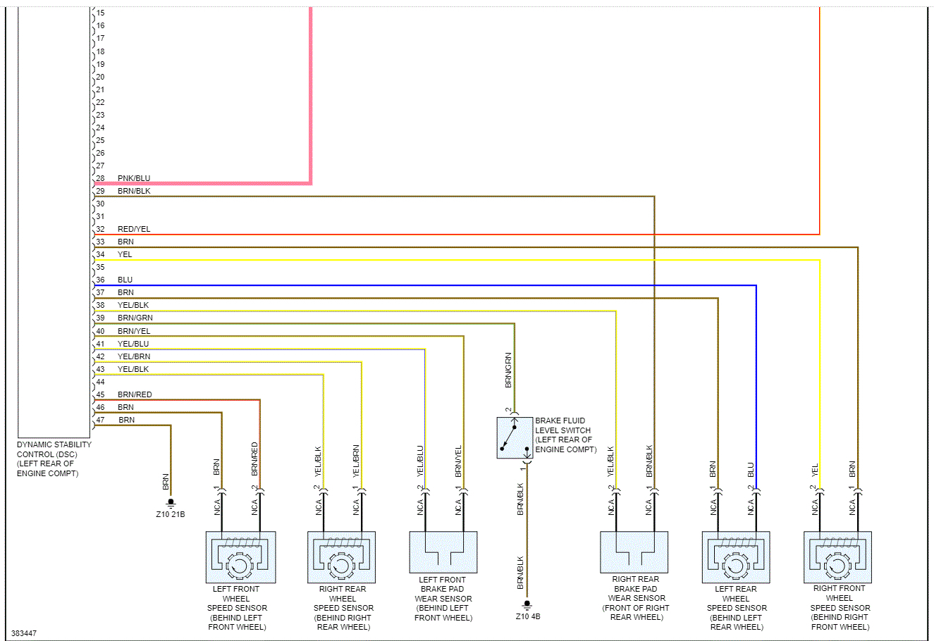

If you look below (pics 2 and 3), I attached the entire wiring schematic for this circuit. I had to cut the pic in half to make it readable, but I did overlap the two so you can follow from one to the next.
Let me know if this helps. At this point, I'm not 100% sure what is happening. There is even a chance that someone changed coding somehow and it's causing issues. Coding is basically the ability to make minor changes to the vehicle's software to unlock features BMW makes available in some of its vehicles. I don't even think the DSC is codable.
If the new sensor works, let me know. If it doesn't make a difference, you may need to send the DSC module out for repair or at least inspection. That is just a thought at this point.
