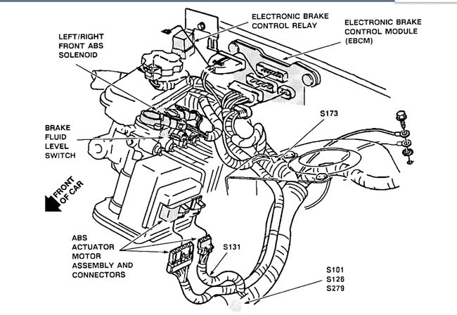

to make a long story short, a little more than a week ago i installed rear shims on both sides because the toe was off and i aligned it and it straightened out the rear (note: there were shims already installed but were removed and installed with the corrected ones) a week later my ABS, trac off,service wrench and brake light all come on. its very random timing as well.usually first the ABS, trac off and brake light will come on,then randomly the ABS and brake light will go out and the service wrench will come on but the trac off just stays on.then randomly the ABS and brake light will come on.
Sep 12, 2016 at 8:11 PM
HMAC300
  • 48,601 POSTS

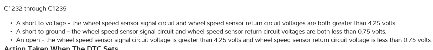

see picture for causes. these wires are very fine and may be broken or getting wet when it rains. your voltage is too high. ABS light on
These guides can help us find the problem or code and fix it

thanks for your help its much appreciated, today i was able to replace the ABS module that fix it thanks for the videos and guides they helped me find it.

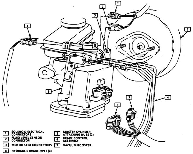

  • 110,193 POSTS
Here are the directions for removal and replacement of the module. The attached pics correlate with the directions.
____________________________________________________________
1993 Chevrolet Cavalier/Z24 L4-134 2.2L
Master Cylinder and Hydraulic Modulator Assembly (with ABS)
Vehicle Brakes and Traction Control Hydraulic System Brake Master Cylinder Service and Repair Procedures Master Cylinder and Hydraulic Modulator Assembly (with ABS)
MASTER CYLINDER AND HYDRAULIC MODULATOR ASSEMBLY (WITH ABS)
ABS Hydraulic Modulator Assembly Removal
Pic 1
Brake Pipe Connections
pic 2
WARNING: To avoid personal injury, due to a retained load on the modulator assembly, the "Gear Tension Relief" function of the TECH 1 scan tool must be performed prior to removal of the brake control and motor assembly.
Remove or Disconnect
1. Using Tech 1, performing "Gear Tension Relief Sequence".
2. Two solenoid electrical connectors.
3. Fluid level sensor electrical connector.
4. 6-Pin and 3-Pin motor pack electrical connectors.
5. Move air cleaner cover and/or intake duct assembly aside.
6. Four brake pipes.
^ Place shop cloth on top of motor pack to catch any dripping fluid. Take care not to allow brake fluid to enter the bottom of the motor pack or the electrical connectors. Plug open lines to prevent fluid loss and contamination.
7. Two nuts attaching hydraulic modulator/master cylinder assembly to vacuum booster.
^ It may be necessary to remove vacuum check valve from vacuum booster to gain access to the nut closest to the check valve.
8. Hydraulic modulator/master cylinder assembly From vehicle.

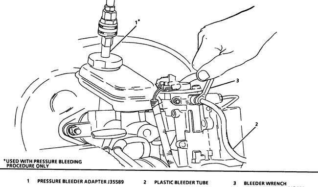

Here are the directions for manual bleeding of the abs module.
Manual Bleeding
Vehicle Brakes and Traction Control Hydraulic System Brake Bleeding Service and Repair Procedures Hydraulic System Bleeding ABS System Bleed Procedures Manual Bleeding
MANUAL BLEEDING
Manual Bleeding
Note: Use only DOT 3 brake fluid from a clean, sealed container. Do not use fluid from an open container that may be contaminated with water. Do not use DOT 5 brake fluid.
Note: In the following steps, use a suitable container and/or shop cloths to catch fluid and prevent it from contacting any painted surfaces. Clean fluid reservoir cover and surrounding area.
1. Remove fluid reservoir cover.
2. Inspect fluid level in reservoir and add to the correct level if necessary.
3. Install fluid reservoir cover.
Hydraulic Modulator/Master Cylinder Assembly
Attaching Bleeder Tube

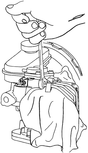

pic 3
1. Prime hydraulic modulator/master cylinder assembly.
2. Attach bleeder hose to rearward bleeder valve and submerge opposite hose end in clean container partially filled with brake fluid.
3. Slowly open rearward bleeder valve 1/2 to 3/4 turns.
4. Depress brake pedal and hold until fluid begins to flow.
5. Close valve and release brake pedal. Repeat procedure until no air bubbles are present.
6. Repeat procedure for forward bleeder valve until fluids begins to flow.
Note: Once fluid is seen to flow from both modulator bleeder valves, the hydraulic modulator/master cylinder assembly is sufficiently full of fluid. However, it may not be completely purged of air. At this point move to the wheel brakes and bleed them. This ensures that the lowest points in the system are completely free of air and then the hydraulic modulator/master cylinder assembly can be purged of any remaining air.

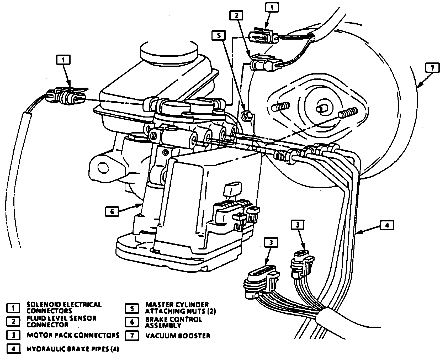

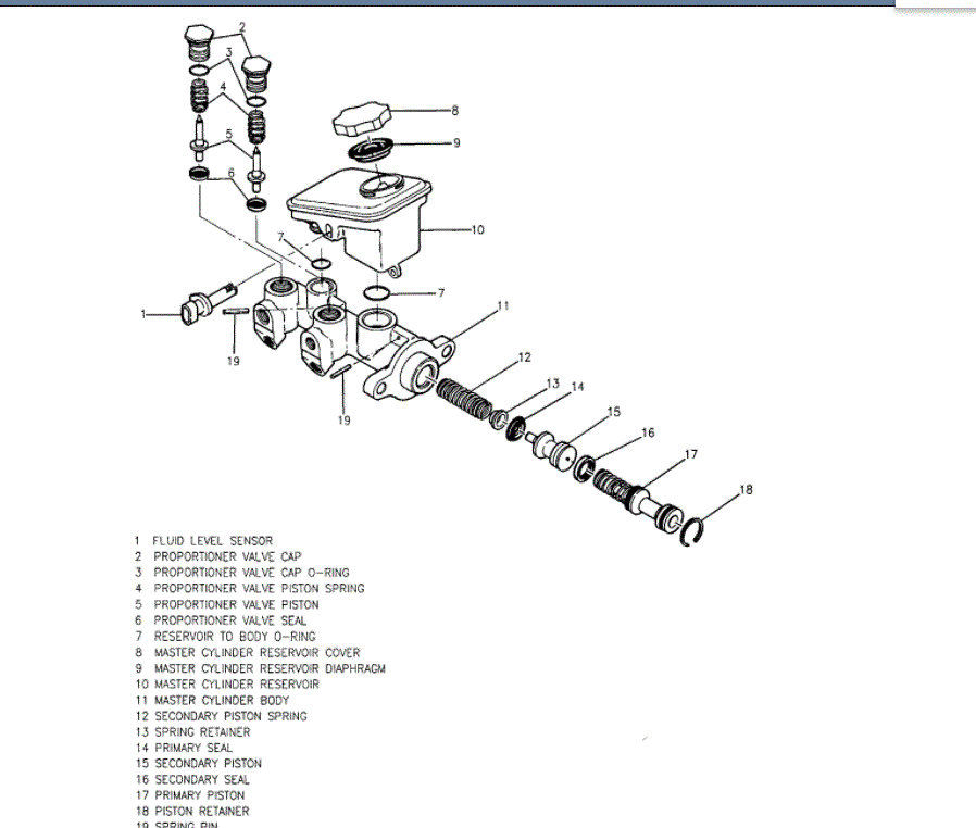

I attached two pics. The first is the master cylinder (exploded view) The second shows the ABS pump, module and other components. See the pic and let me know the name of the component is.
