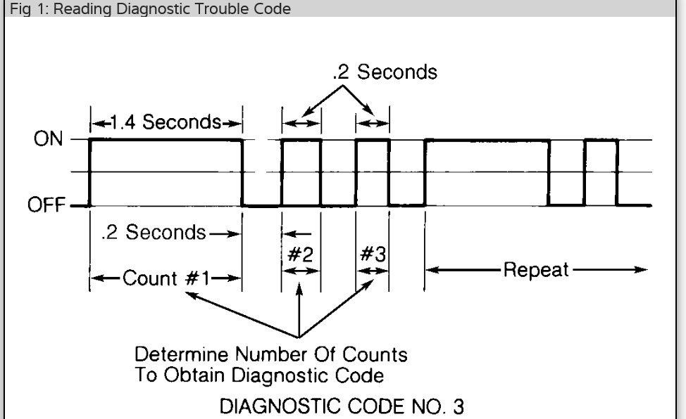

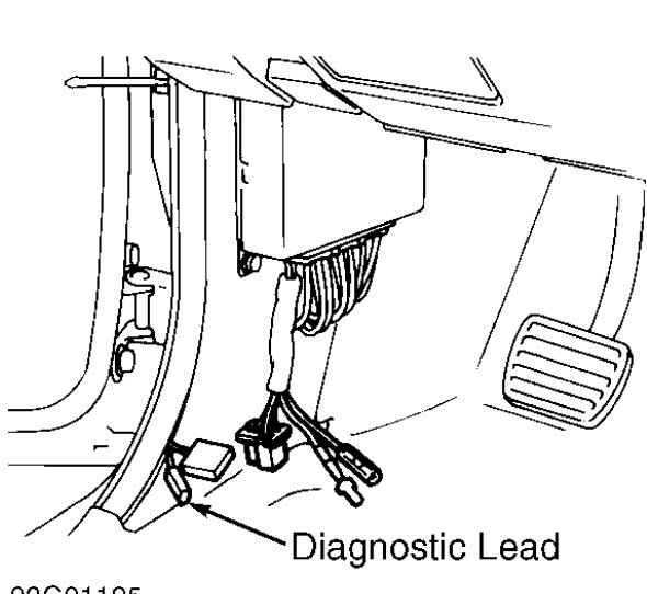

Being ODB1 no one around here has a scanner. I called a few places, but no one had any idea. Old school mechanics are becoming scarce. I heard there is a way to read the code from the check engine light blinking, but I'll need to find the correct data sheet that has the codes listed for this vehicle. As well as the procedure to get the ECM to tell me.Thanks for responding.
May 1, 2017 at 5:21 AM
HMAC300
  • 48,601 POSTS
for check engine light cross A&B on aldllower left dash and count flashs like 1 then 2 is 12 etc. see pic on how to get codes for abs and get back to us with codes....
