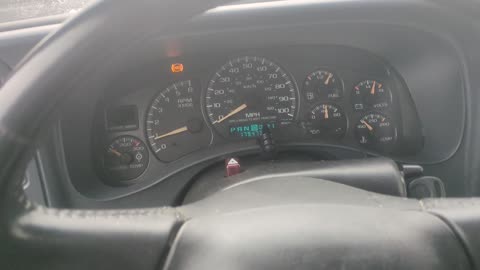

I replaced the ABS and Speed sensors on both the driver's side and passenger side wheels. I used the ACDelco 19300584. I did this because before the ABS and Brake lights were flashing and I could hear a dinging sound. Now, after replacing the two sensors, I have the ABS and Brake lights come on and off randomly while I am driving. I hooked my code reader, and I didn't have any ABS codes. Before I had replaced all the break lines and the top of the ABS module that the brake lines attach to and bled the brakes, and the master cylinder is at the proper level. What could be causing this?

I don't have a scan tool that can collect live data. It looks like the ABS light goes off, then the brake light goes off, then they both come on. I have attached a video showing what I see driving. I don't know what Toner rings are, can you please explain what they are?

I watched the video. That seems to be consistent and not a random issue. By chance, could you get your hands on a live data scan tool or a scanner that can retrieve can-bus codes?
CAN stands for controller area network. That is what I would try.
