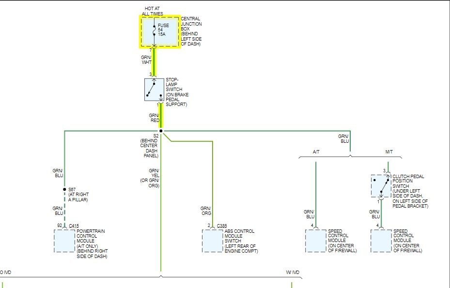

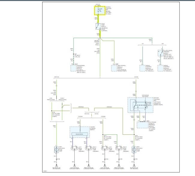

Fuse is good. Brake lights are not working
Jun 19, 2019 at 4:09 PM
Good morning,
I attached a wiring diagram for you to view. Test for power at the switch on input and output on the switch itself with a test light or voltmeter. Check out the diagrams (Below). Please let us know what you find. We are interested to see what it is.
