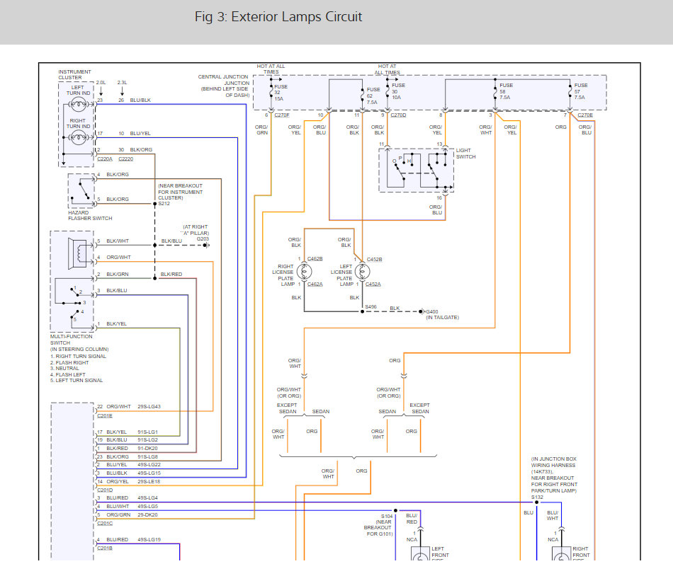

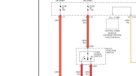

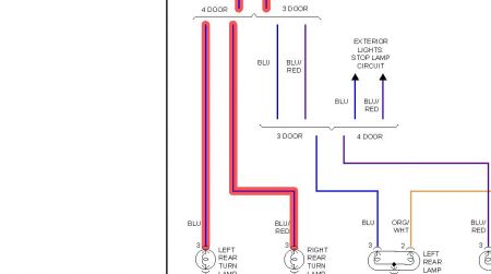

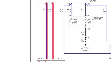

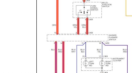

I have seen the GEM go bad causing the brake lights not to work but to be sure here are the brake light wiring diagrams so you can see how the system works and a guide to help test for power.
Check out the diagrams (Below). Please let us know what you find. We are interested to see what it is.

[quote:7fa2819297="shawn_laha"]2003 Ford Focus 4 cyl Front Wheel Drive Automatic
The driver side brake light does not work. The turn signal and the hazard lights work. Any ideas on what might be wrong?[/quote:7fa2819297]
Hi, These have a problem with the emergency flasher switch going bad. The brake lights are wired through this switch and if it goes bad, one or both of the brake lights will stop working. Please note that the hazard lights may still work. This is because several circuits are controlled by this one switch. This might be a good place to look after you have verified the bulbs and fuses are good. Hope this helps.

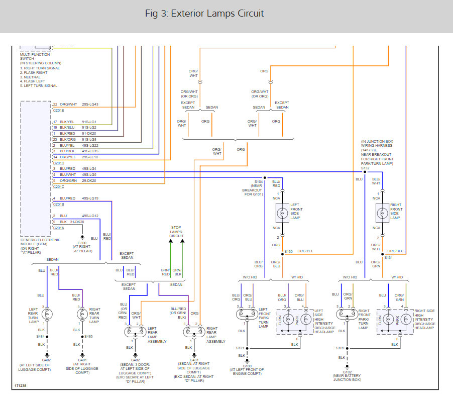

JDL
  • 16,098 POSTS
I'd have to get at the wiring circuits to the fuse box, under left side of dash. As you can see, green wire with red tracer carries voltage to several fuses, including fuse 54. The info I looked at was for Focus LX.
https://images.2carpros.com/forum/automotive_pictures/170934_focus_LX_wiring_circuit_1.jpg

  • 75,988 POSTS
Check fuse no. 33 15amp and no. 59 7.5 amp

JDL
  • 16,098 POSTS
Did you check for voltage to and from the brake switch? Dark green wire with white tracer is voltage to the brake switch. Green wire with red tracer is voltage from the stop lamp switch, for stop lamps. If you have IVD, there is a stop lamp relay, under hood passenger side rear, you'd have to check relay circuits, replacing relay may not help anything. If you have that relay, coil side of relay is controlled by electronic stability module. I can't troubleshoot that module from here, I'd have to look at it.

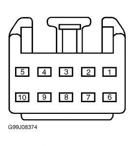

  • 19,053 POSTS
turn 4 way flasher on does it work? WARNING: Deactivate air bag system before performing any service operation involving steering column components . DO NOT apply electrical power to any component on steering column without first deactivating air bag system. Air bag may deploy. Steering column switches consist of a multifunction switch, ignition switch and wiper/washer switch. The multifunction switch controls hazards, turn signals headlight high beams, wiper/washers and flash-to-pass feature Multifunction switch resistance test Left turn check resistance between terminals 1&2 Right turn check resistance between terminals 2&3 resistance should be greater than 10k/ohms
https://images.2carpros.com/forum/automotive_pictures/99387_Graphic1_98.jpg
