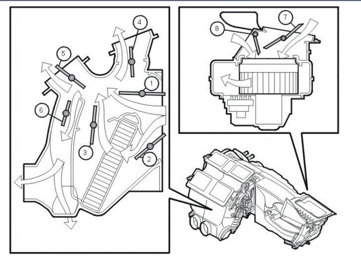

Based on your description, it sounds like one of the damper motors has failed. There are several of these under the dash which do several different things. However, all things are related to the HVAC system.
The damper doors are what determine airflow direction, fresh air intake, air temperature, and so on.

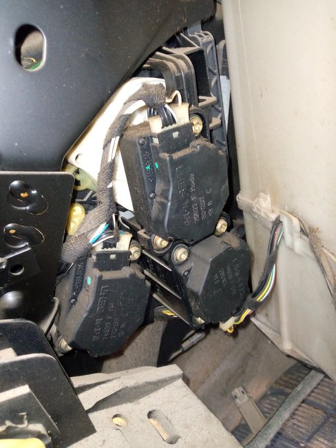

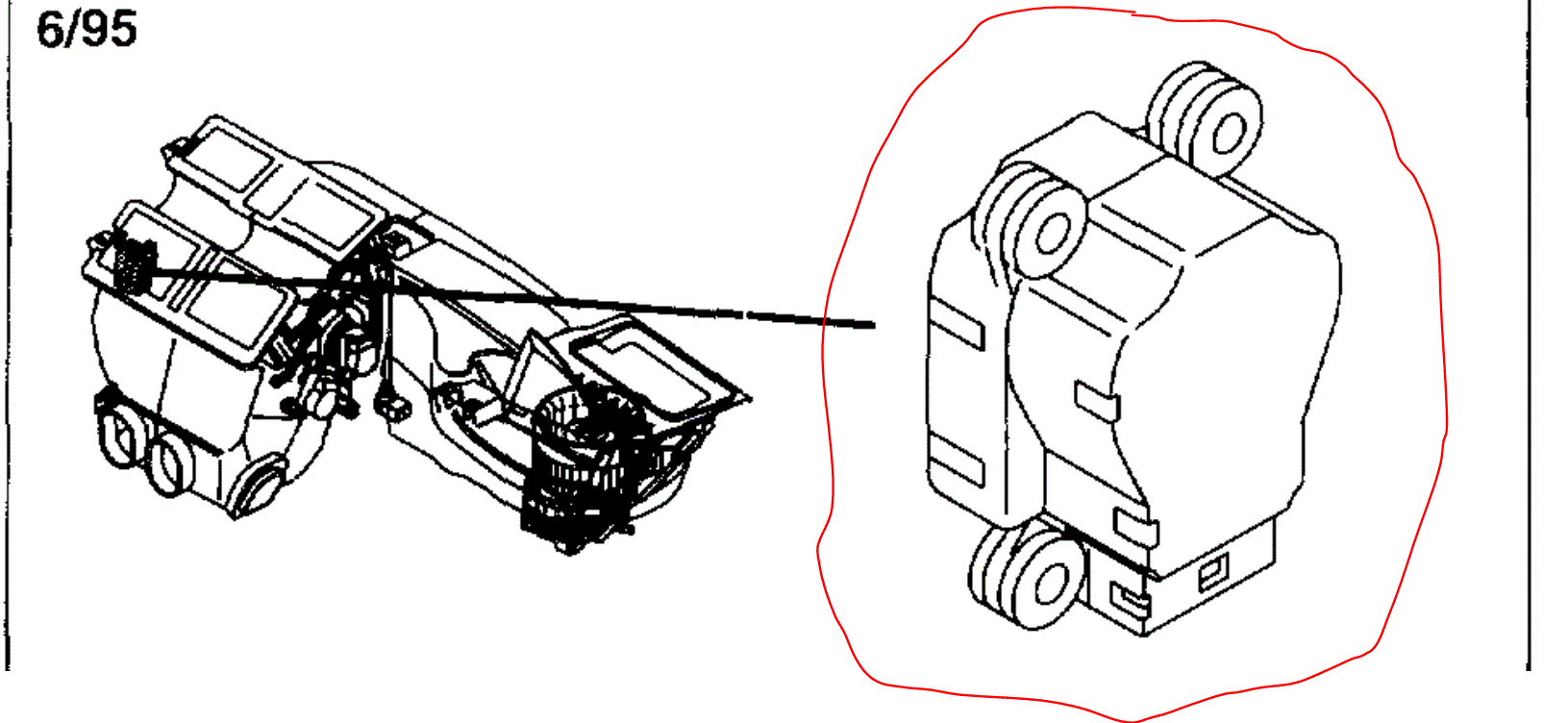

If you look at pic 1, it shows the different damper doors. Pic 2 is an example of one of the damper motors.
The motors have a small plastic gear in them, and the teeth can wear out or break. As a result, you hear a clicking/ticking sound as it tries to move.
Let me know if what you saw appears to be one of the things indicated below.

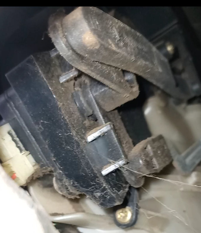

Alright, thanks Jacob. When I'm chanced again to work on the car, I will do the check and video the battery spark as well. Below is the position of the actuator's but I'm having 5 of them, one closed to the front passenger door side, while one at the driver side. Picture 1 and 2 is the passenger door side own. take a look.

Yep, just looking at them I can't tell for sure, but you should be able to identify it by touch or watching to see if they are not moving properly.
Let me know what you find or if there is anything I can do to help.
