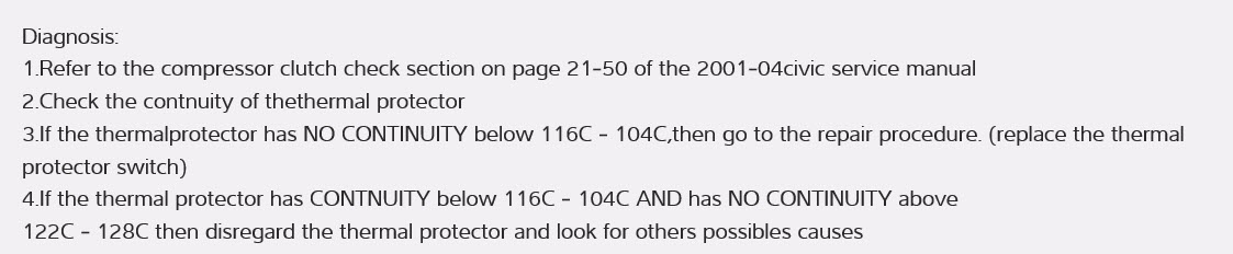

It may be the thermal switch on the back of the compressor kicking it off due to to a high pressure or maybe the multi plex unit in the dash. Also you should get hvac control scanned as it may be that as well. Then check relays for corrosion if they need to be cleaned off, you can and use dielectric grease on the prongs.

Hi, I checked the relays they look good and I switched one out to try that. If it was an expansion valve would it not freeze? How do you check the thermal switch? It is a pain in the butt to get to. My pressures are high side 185 low 28-32 any other suggestions? Maybe the electro-magnet? I am very confused and frustrated. Thanks for your help Neil

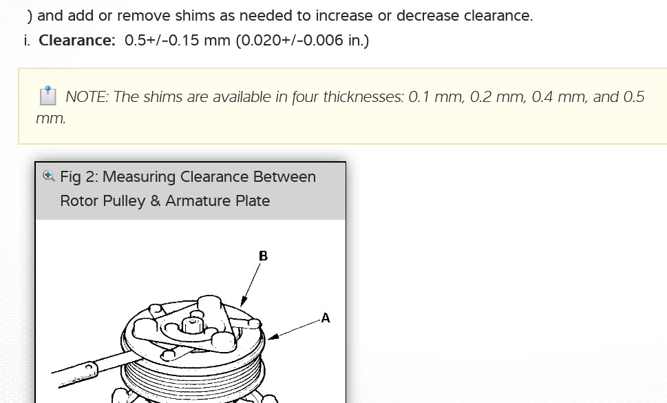

check these in pictures do not' pay attention to expansion valve.
Apr 24, 2016 at 8:49 AM

I have seen this problem before and it turns out the compressor clutch engagement coil is bad which you may or may out be able to replace separately depending on the compressor manufacturer. Here is a guide that will help you replace the compressor.
https://www.2carpros.com/articles/replace-air-conditioner-compressor
Let me know what you find
Best, Ken
